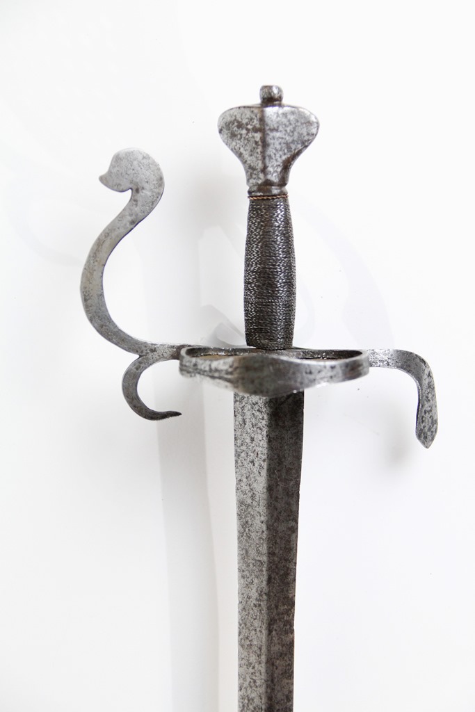

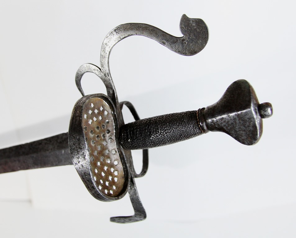

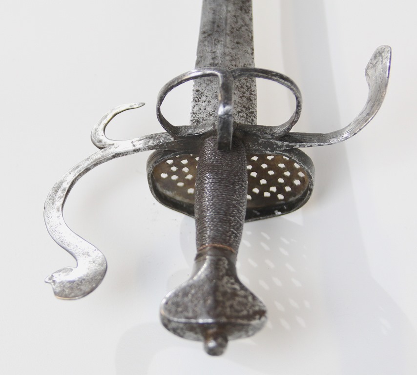

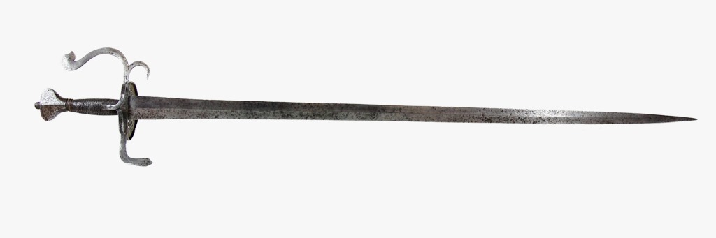

O.L. 104 cm ; blade L. 90 cm; blade width at hilt 3.5 cm
Blade of thick diamond section, tapering uniformly through its length
Pommel :Flat heart-shaped with strong button of type 43
Origin : used by troops from Sweden and the Netherlands very popular during the 30 Years War (1613-48)
Any comment on it would be welcome.

Hello Cerjak,
I would say this is a beautiful so called "Felddegen" (Field Epee) for military usage. The period you mentioned is ok but I would add Germany to the list of possible countries of origin.
Roland

Dear corrado,
Thank you for your post
It is a very nice sword from the same family but quite different ,it’s a sabre and you have a knuckle guard and also the quillions in my case are in the shape of a monster and it was one of the reason why I have bought this sword.
Best
Cerjak

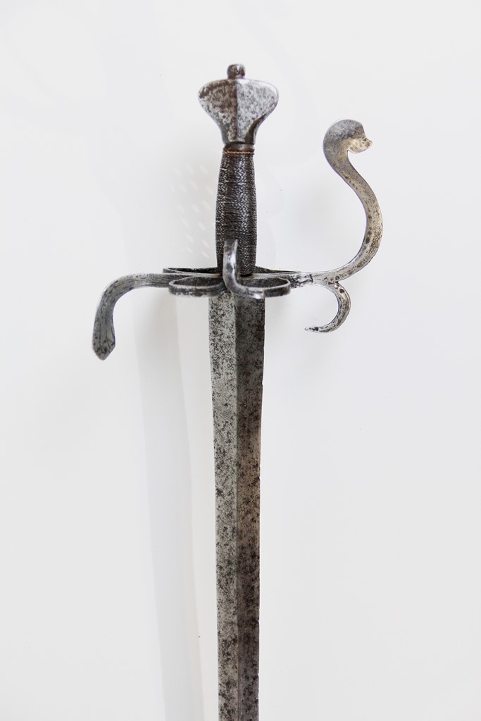

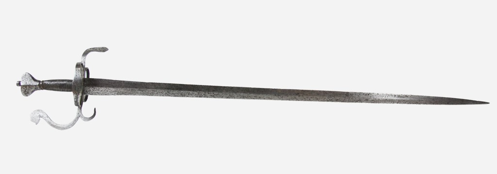

I had posted it earlier: My "Feldsäbel" is a very similar example to yours
corrado26
Corrado
This sword's hilt is more similar to yours

Nice sword Cerjak! The typically simple Dutch-Swedish type swords (S-shaped quillon and heart shaped pommel) don't have knuckle guards, but later during the 1640s some did although they tend to be attached to the pommel. Gustavus Adolphus had to import large quantities of these Dutch swords which were used from around 1620 and throughout the 30 year war. Many of the imported swords were fitted with Solingen blades. Expert Walloon sword smiths were also imported to Sweden, and domestic production began there led by the enterprising Louis De Geer. These type of swords were also produced in Germany and Switzerland. There are some of these swords in Edged Weapons in Sweden (2014) by Staffan Kinman, and Svärdet och Värjan som Armevapen (1955) by Heribert Seitz from which the pictures were taken.

My pleasure, Cerjak. Sorry I can't be more specific about your sword (the first one). In my eyes the knuckle guard design looks too elegant to be Swedish. Swedish weapons have an emphasis on functionality which gives them a particular charm of their own. There were also many Germans serving in Gustavus Adolphus army during the 30 Year War. I attach another photo from Seitz's book, this time of a sword more similar to your second one.

it can be a Dutch sword as well, the end of the knuckle guard has the same shape of an animal head as seen on matchlock muskets (fuse holder) from around the first half of the 17th century.
fe see http://www.vikingsword.com/vb/showthread.php?t=18207
