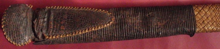

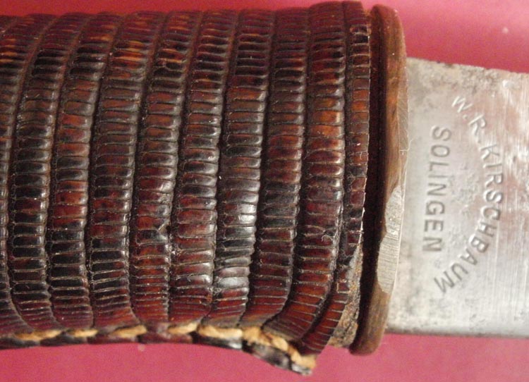

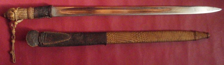

Hi All,
Because of the reptile skin and basket weave on the hilt and sheath, I assumed the civilian mounts were made in Africa. Given the the design of the sheath throat, I assumed that the piece came from a Spanish colony. Internet research revealed that the blade was from a German model 1871 bayonet made by W. R. Kirschbaum in Solingen. The internet also showed that the stamp on the other side of the blade (an "RA" inside a circle) meant that the blade was property of the Argentinean military. This appears to make the possibility of any African involvement unlikely. I have read that the Gauchos commonly carried a long knife/short sword on their saddles. Could this be an example? If it is, the condition of the sheath and the hilt is miraculous. The blade is also in superb condition.
Sincerely,
RobT

Hello
This is a "facon" (although it does not have "hawk") built from a bayonet blade. The RA by Argentine Republic. I can not see the work of the handle and the sheath, but I think it has a job of "touch" and applications of an iguana leather or live.
Affectionately. Fernando K

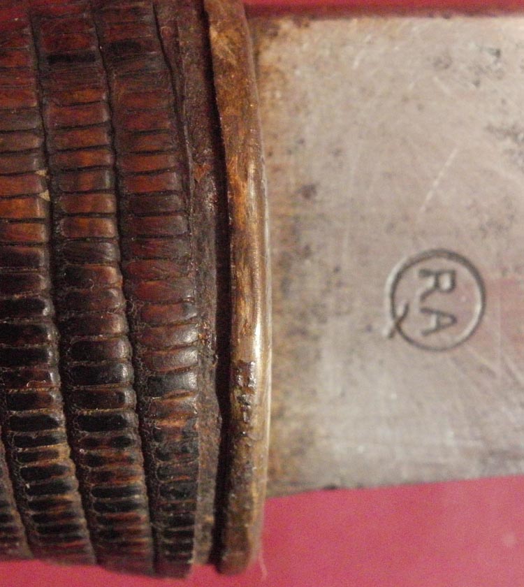

Hello
This is the bayonet for the Remington Argentine Model 1879 rifle, caliber 11.15 by 58 Rmm. The length of the blade is 471 mm. These bayonets were manufactured before 1883, the year in which they merged with Weyersberg. Anyway, I estimate that the facon is manufactured in the first half of the 20th century
Affectionately, fernando K

1. On the photos provided by Robert, the fourth down, there appear to be two small rotary grind marks of the handle near the ricasso. Robert, could you verify this please?
2. Sorry about the illegibility of the caption under the illustration. A much better version can be found here http://www.vikingsword.com/vb/showth...ghlight=gaucho

Chris, the tang is completely hidden by very fine basketweave. The striations on the metal oval are straight and were probably made by a file. The metal oval appears to be made of heavily patinated brass. It isn't magnetic. I don't agree with your suspicions about authenticity for three reasons. One: All the work on the hilt and sheath are too finely and carefully done for a piece intended for monetary gain. The workmanship clearly shows that the crafting was done either by or for a person who had a high regard for the blade. Two: if an individual had dressed an old blade specifically for profitable sale as a Gaucho facon, wouldn't have been more marketable and less time consuming to use the more typical and expected metal fittings? Three: I got this piece from a dealer who had obtained part of an old collection and I didn't pay more than the cost of dinner for two at a mid price restaurant.
Fernando K, I agree with your belief that the hilt and sheath work was probably done in the early 20th century but I wouldn't rule out something like 1890. The condition of the materials is too good for any earlier date. However, since the bayonet model was originally made in Germany in 1871, the current mounts may not be the first civilian hilt and sheath the blade has seen.
Sincerely,

Regarding your knife.
It is not a tipical "gaucho knife" or a facon or caronero, though I feel it was certainly made here in my Country. Except for the blade the handle is not the usual shape of these knives.
The blade is taken most probably from a bayonet for the Argentine Model Mauser of 1891 or 1909. These bayonets were imported from Germany and made by the famous firm Kirschbaum. The RA in circle is the military inspection mark.
There is also the possibility of this blade coming from a bayonet for the Remington Model 1879, depending the length. It was also made by same German maker.
You don´t mention the lenght but the Mauser bayonets blades are about 39 cms while the Remington ones are a bit longer around 45/46 cms.
The handle and part of the sheath (crude color) is made of raw hide woven in an interesting pattern which is a very popular technique which is very nice to view and handle but not practical as it is not very durable if it receives a very hard use, so it is usually reserved to knives made for collection or less use than a daily tool.
This technique was popularized during the 1930/40`s up to the present, and the thinner the threads used (which are made by cutting hides by the same artisan) more fine is the final work considered but also more fragile.
The technique is also used for handles of other objects like quarts or riding crops.
I would say this piece is very old but from the XX Century (may be from the 1940´s through 1960`s) and ordered by some country man to a local artisan and using the blade from a bayonet which was a type of blade often used in making facones and dagas here.
The use of a reptile skin in contrast adds a touch of interest to this piece.
I hope this little info is of your interest.
Best cordial regards, Abel Domenech
