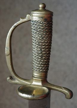

I found what I originally thought was an old hunting sword and was drawn to it because of the attractive hilt and evidence of some etching on the blade.
The hilt is brass and the grip is wound with braided heavy gauge brass wire. The pommel is faceted and the cross guard incorporates a solid concave disc that projects 90 degrees from the guard. The blade measures 22.5 inches/57.15 cm in length and 1.5 inches/3.81 cm in width at the ricasso. Overall, the sword is 28 inches/71.12 cm long. The blade is single-edged, except for the last 6 inches/15.24 cm, which is double-edged. The blade is very robust.

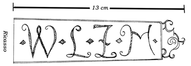

Both sides of the blade are etched with four letters -- either WLZH or WLZM -- in panel that incorporate some floral embellishments. The last letter looks like a capital H, but the cross stroke is an inverted arrowhead, so maybe it is supposed to depict a capital M. Which is letter is right, I can't say.
Though the etching has been worn away in different areas on each side, I used the visible portions from both sides to draw what the etching would have looked like whole (see sketch). The etcher placed a diamond-shaped motif on both sides of each letter, like this: <> W <> L <>Z <> H <> I think these diamond shapes serve the purpose of periods in a set of initials. The style of the letterforms makes me think late 1700s or early 1800s, but I am by no means well-informed on that topic.

I recall having read that the guard positioned perpendicular to the hilt was characteristic of early hunting swords and that, over time, fashion morphed the "90 degree" guard into the downward angled clamshell guard we see on 18/19th century hirschfangers. I have since solicited the thoughts of folks who dabble in hunting swords and hirschfangers, but the consensus seems to be it isn't an example of either.
I'm hoping some of you friendly forumites might share your thoughts on the origins and use of this weapon. Thanks in advance.

Concerning age, i would go for 18th. century. As for the guard, i would say it has a hunting sword (hirschfanger) attitude, grip profile concave disc and all. However the blade is beyond my bet; dare i guess it once belonged in another sword ? .

It's a German piece. "<> W <> L <>Z <> H <>" stands for "Wilhelm Landgraf zu Hessen", who was either Wilhelm VIII. (1751-1760) or Wilhelm IX. (1785-1806). His capital was Kassel.

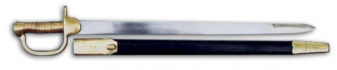

The blade is reminiscent of a Baker Rifle bayonet ... same length too

What is the width of the blade at the ricasso, and across the spine of the blade at the same point?
MacCathain is offline   Reply With Quote
Old 22nd April 2018, 11:31 AM   #10
Originally Posted by MacCathain
... What is the width of the blade at the ricasso, and across the spine of the blade at the same point?
Look HERE
... And HERE.
That's a very interesting observation, Thin.
On the one pictured it is 30mm wide at the ricasso and 9mm across the spine at this point .
Old 26th April 2018, 12:50 AM   #12
MacCathain
Join Date: Apr 2017
Posts: 68
Thanks for that, Thin, and for the links that you provided, Fernando.
The Hessian is 39mm wide at the ricasso and 10mm across the spine, so a good bit broader but about the same thickness.
I've read that the Baker rifle derived from German Jaeger rifles, so perhaps the DNA of the Baker bayonet has some hirschfanger genes.
