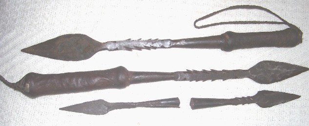

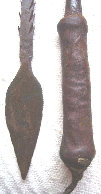

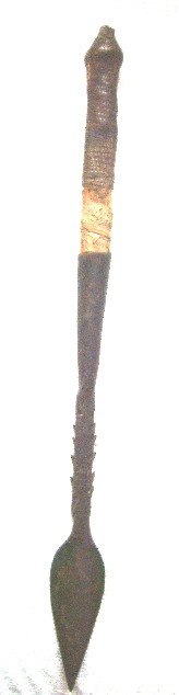

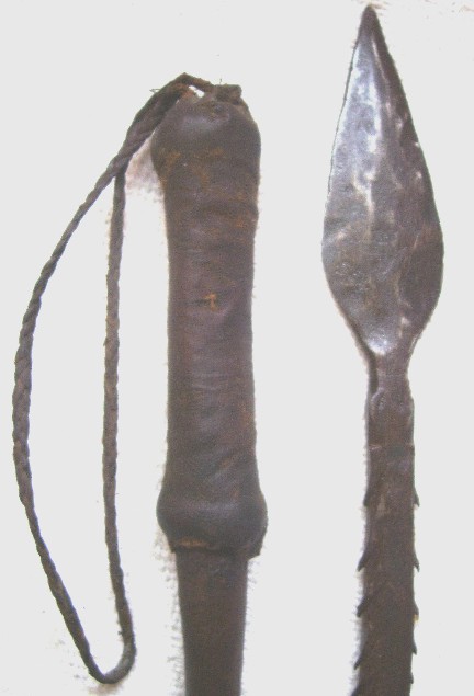

Received these today, I am assuming that these are Sudanese.
Three socketted spearheads fixed to handles. Two handles leather covered,the third,possibly Monitor lizard. Does this type of weapon have a name? Obviously it was used as a stabbing blade, where these improvised for 'close quarter' fighting?
Also with these pieces I have two arrow heads ? made in the same style with a socket fitting, surely too small for spears? Any suggestions gratefully received......

Interesting items! To figure out whether those points are arrow heads or dart/javelin heads, it would be useful to know a) their lengths, and b) the inside diameter of the sockets.
Just as a note, I've been reading some interesting books from the archeological recreaters--the guys who are into making stone weapons. They've learned quite a lot about throwing darts, javelins, spears, etc. with spear throwers, batons de commandment, cords, and what have you. I can expand on this in another thread if desired, but the basic point is that throwing spears, especially those thrown with a spear thrower, are better thought of as double-length arrows rather than as lances. Often, spears designed primarily as missiles can have diameters <1 in (1-3 cm).
The basic point is that there's a size overlap between arrows and thrown spears, to the extent that some American archeologists have stopped talking about "large arrowheads" and "small spearheads" and started talking about "dart points," basically because the smallest, slenderest throwing spears are the same size as the largest, heaviest arrows, and only the details of the shaft can be used to distinguish them (presence/absence of features such as feathers, nocks, etc).

I am not sure these items with the handles are actual weapons. Take another look at the thread started by Katius and the spear thread from Fernando. These in my opinion are all linked to Southern Sudan and North East Congo. No doubt they could be used as weapons. I feel they are more dance or society objects. I like them, lots.

you're right I should have included dimensions. Your comments are very informative. The dimensions of the 'arrow' heads are;
socket dia. 1. 11mm 2. 13mm
length 1. 15mm 2. 16mm
blade width 1. 19mm 2. 23mm
(widest)
The measurements suggest a shaft of arrow proportions. They (the heads) are very light, and probably would not give the weight needed to give a small spear the correct trajectory, when thrown. (Unless the shaft was weighted at the spearhead end.) I'm begining to lean towards these being arrow heads. However, the idea of a spear thrower would make sense, this would provide enough energy (as would a bow) to propel a 'light headed' projectile accurately. Spear throwers were common in the America's, Australia etc and are very ancient. Is there any evidence of their useage in Africa?

Thanks for the measurements. I think you're probably right about the small points being arrowheads. To my (admittedly imperfect) knowledge, there aren't any atlatl/spearthrowers from Africa.

I'll let the others argue about the short spears. Personally, in a world that holds the Okinawan timbe and the Zulu iklwa, I wouldn't be surprised if these short spears were weapons, used with a shield at close quarters.
