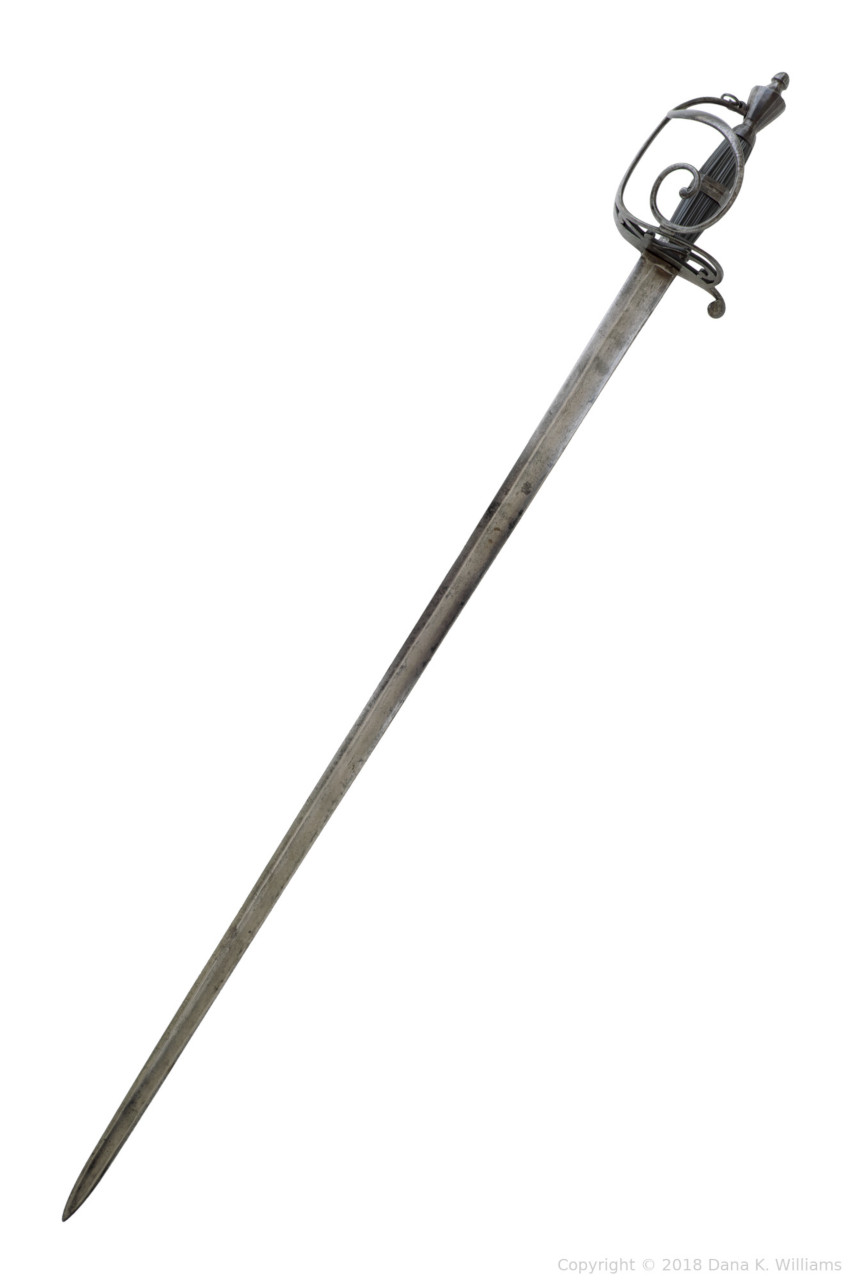

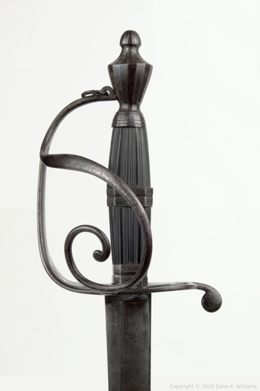

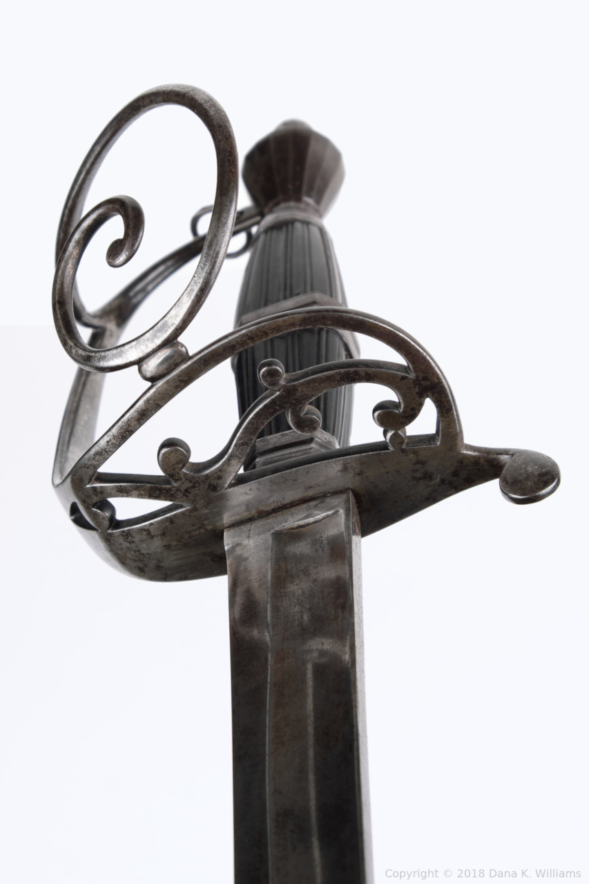

I spent some time yesterday photographing this beautiful sword. It has been suggested that it would best be described as a Spadroon rather than a Backsword, that it is likely British from the late 18th century, and that the ring indicates naval use. It has a half-basket hilt with what looks like a Horn or possibly Ebony grip. The overall length is 38 1/8 inches. The blade is 31 7/8 inches long and 1 2/8 inches wide where it meets the guard. It has a false edge that is about 5 1/4 inches long. At its widest point, the hilt is about 4 1/2 inches wide. I haven’t been able to locate any makers marks.
Corrections, comments, and suggestions are most welcome.

I think the ring does not so much mean naval but popular and a trend of the age. As we shall see in one example I attach, it is tough to say a ring must mean naval. I am not sure when we began with that as an absolute but I keep it in mind now.
The half basket look seems to start with infantry hangers and cutlasses back to the mid 18th century. The urn shape pommels last for some decades in various forms, with the 1770s/1780s about the beginning when found on these spadroon blades.
In general, I would put these in the 1780s as the best ballpark, based on traits and some of the blade decorations. The example you show is perhaps the finest furbishing work I have seen and archived and would think woods vs horn due to the crispness of the reeding. The horn grips reeded by steaming and pressing in a mold.
