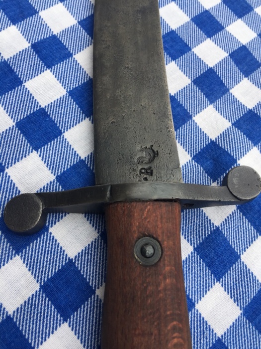

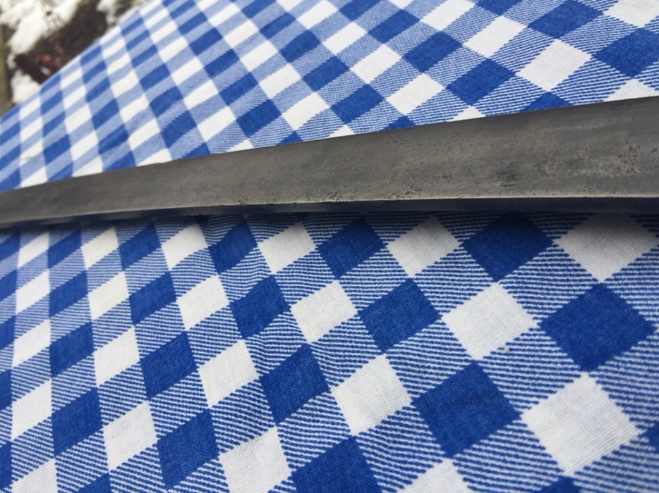

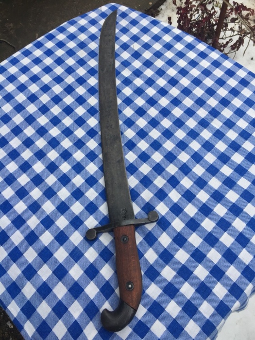

Good evening.What do you think of this sword? I know there is a short version of 1907 in Spain and another handle.It has 60 cm total length, the blade is 46 cm, the handle is 14 cm.Thanks.

I guess nobody recognizes the mark.

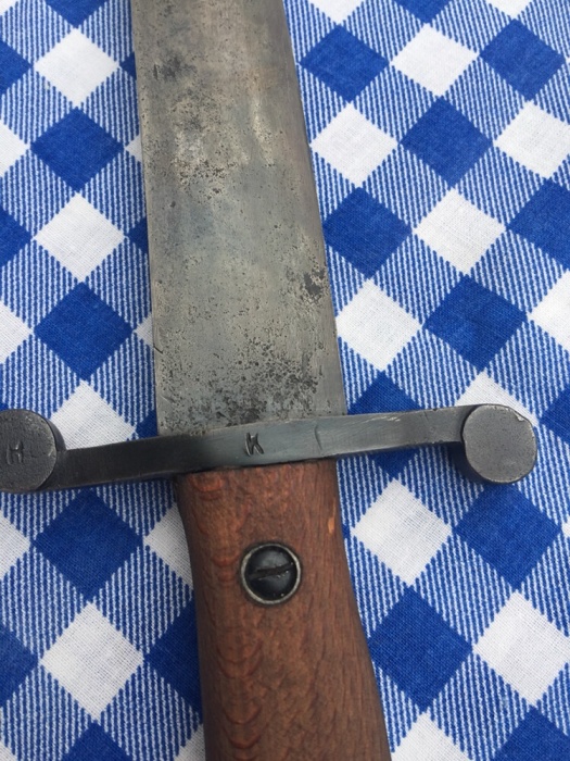

Show the rest of the mark and in an upright manner.

Looks like an earlier version of the Argentine 1909 machete hanger. The 1909 has more of a long bolo look and less hook to the pommel. Some of the brothers Weyersburg of Solingen used to use the rooster. I'll look in Bezdek next time I'm at the desk.

I am not stating that it definitively is, however there is the remote possibility that it is a current Chinese fantasy piece.

So, yes, one of the Weyersburg family used a rooster and also a Werth. The latter from 1887-1917. There was a fair amount of export from Solingen to the South American trade and as described previously the Argentine 1909 bolo has a quite similar grip but of a different blade profile. The short sword above fits that role of artillery fascine work quite well.
Perhaps a mention of where this sword surfaced might add a clue.

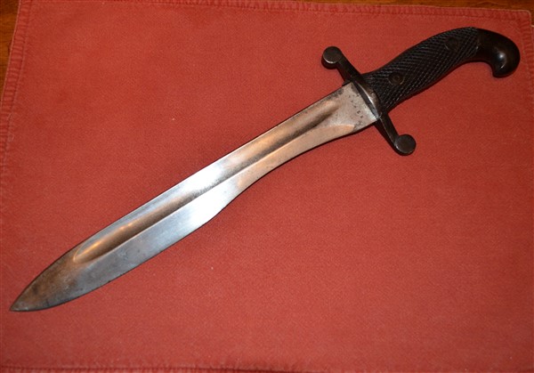

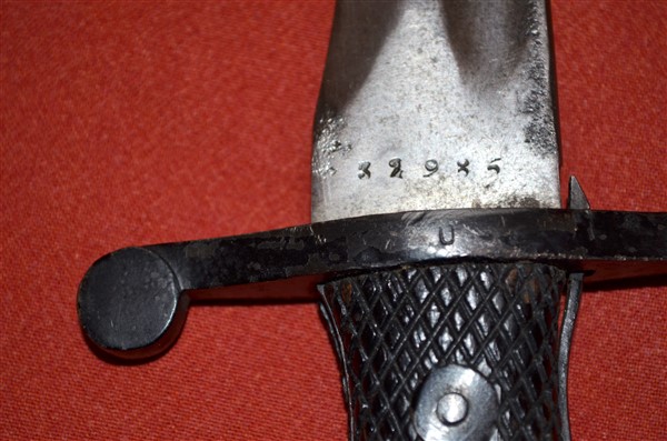

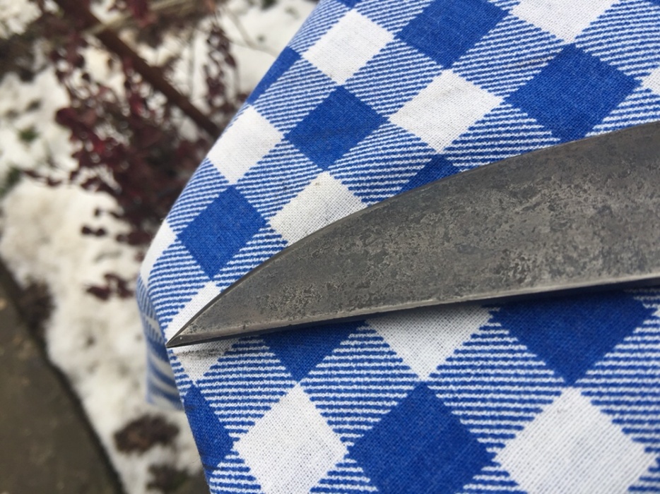

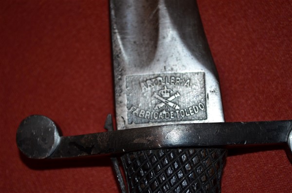

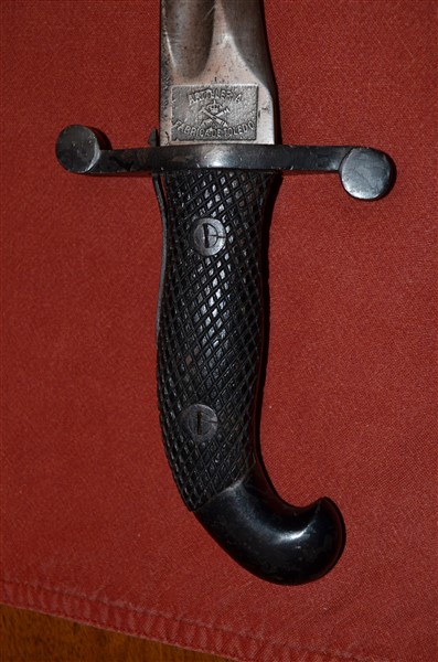

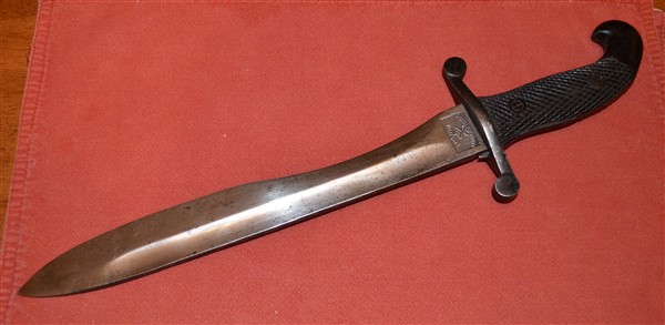

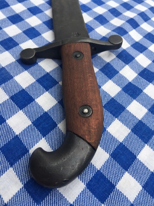

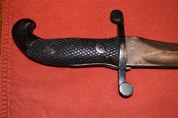

Here is a picture of the Spanish M1907 Artillery Bolo; as you can see the handle profile and the guard matches yours, however, there are some differences.The wood on your handles is roughly shaped and relatively clean and the rivets are cruder in my opinion.This could be explained by someone refinishing the handles.The blade bothers me as well, however, this is based only on intuition and not fact, so this is not a viable argument on my side.
The item could have been modified by some local South American blacksmith for someone's personal preference and as I acknowledged before I certainly could be wrong and I don't have it in my hand to assess properly, however, all this being said, I am still suspicious about the item.
