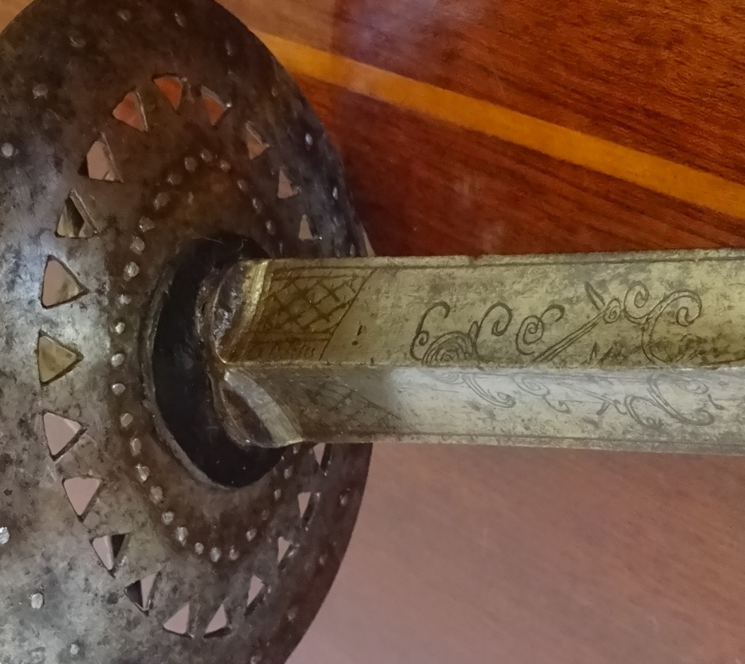

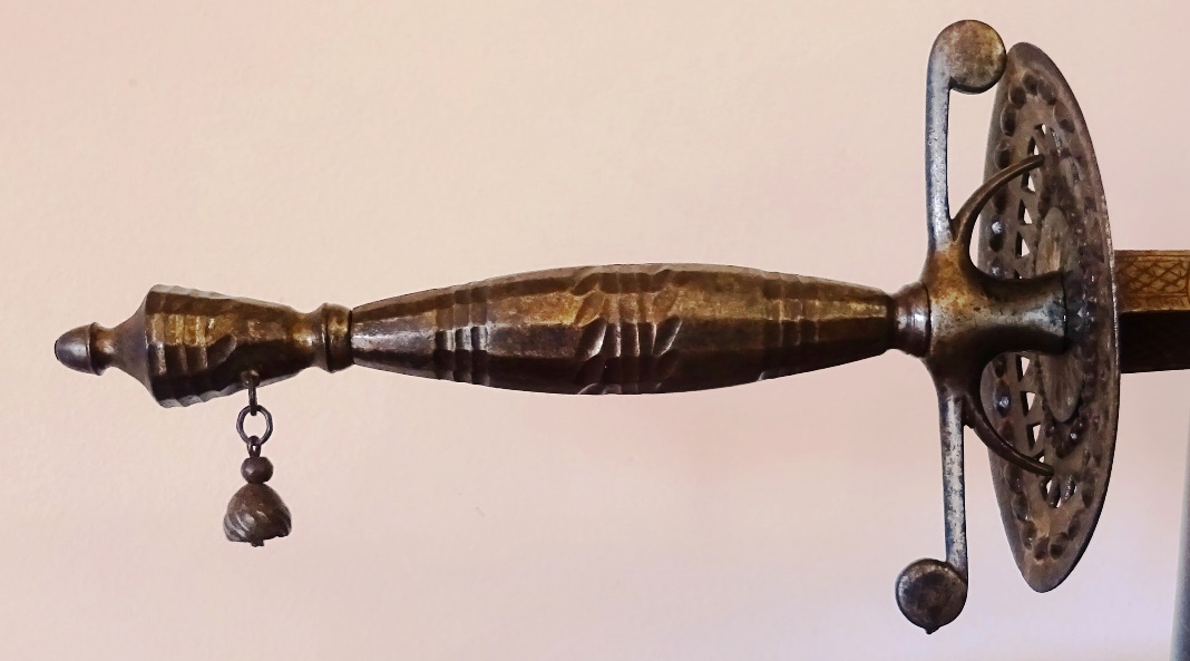

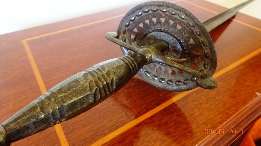

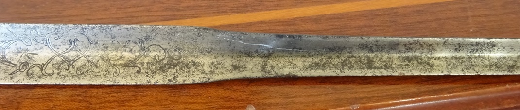

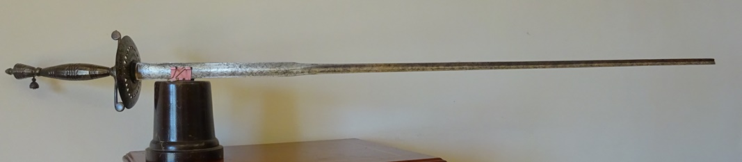

This is a small sword indeed, not only for the style but also for its small dimensions, with a blade measuring 26" which, if its point was not broken (to my despair) would be no more than a couple inches longer... i guess.
The hilt the cut steel type ... ma non troppo; as this is the simplest of the kind i find out there.

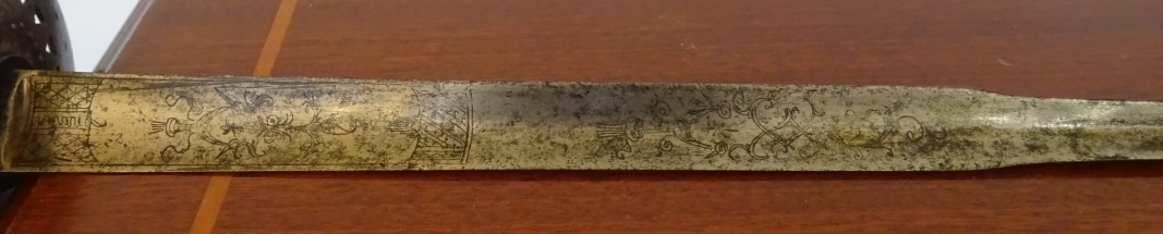

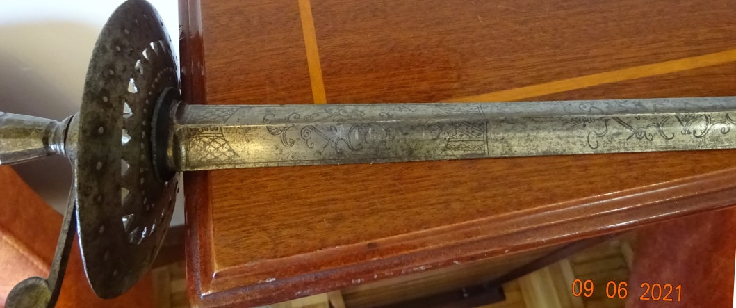

No doubt a Colichemarde blade, with its hollow ground three faces.

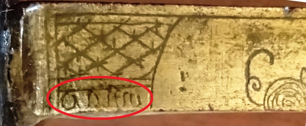

Interesting that it still keeps the leather 'washer' that softens the impact of the (missing) scabbard. It could be my imagination but, one of the arabescs in the decoration looks more like the name of the blade smith.
Culd you Gentlemen favour me with your comments, age and provenance included ?
Thsnk you so much in advance.

Hello Fernando.
A fascinating piece, not least because I suspect (I am open to contradiction of course) that it is a younger hilt: probably to preserve a much treasured blade.
Matthew Boulton was almost certainly the source of the hilt, but I am of the opinion that the true Colichemarde blade (with distinct shoulders) was out of fashion by then. Please correct me if I am wrong as informed details regarding the lifespan of the Colichemarde have eluded me to date.

A fascinating example, and indeed cut steel type maxime, probably English and 1790s. It was the sunset of the small sword, but its influences held in the hilt stylings in numbers of military swords in artistic sense as favored by fashion conscious officers.
As usual, the chain guard is missing, and very attractive etching in the blade, which is as noted 'colichemarde' (the widened upper portion of blade, said to be for parrying). While these were in use from mid 17th century into early 18th, they were regarded as 'out of fashion', at least in most civilian examples.
However, military officers always held to tradition, and these blades were well known on officers small swords well through the 18th c.
The 'cut steel' (some of these almost look 'steam punk') hilts were made popular in England mostly around London and Birmingham, and industrial revolution figures like Boulton were heavily involved in designs (Aylward, 1945).
This probably belonged to a British officer, perhaps with fraternal associations which might be identified with closer look at the motif and circled inscription.
**** Urban, we crossed posts!!! The hilt looks like the 1790s-1800 period hilts made as noted, but I am inclined to agree this is a way earlier, probably heirloom blade, and the motif may well go back into very early period, possibly into 17th c. and the blades we know so well !!!!

Guys, adding a picture of the no longer broken point and the comparison of all three face ricassos, where we can (hopefully) see that one is not an arabesc but the blade smith signature.

Some (silver) arrangement ... for the missing chain
Old 25th August 2021, 12:07 AM   #11
Posts: 10,862
This looks like an English chiseled steel type c. 1790-1800 with 'Adams' pommel, most fashionable.
