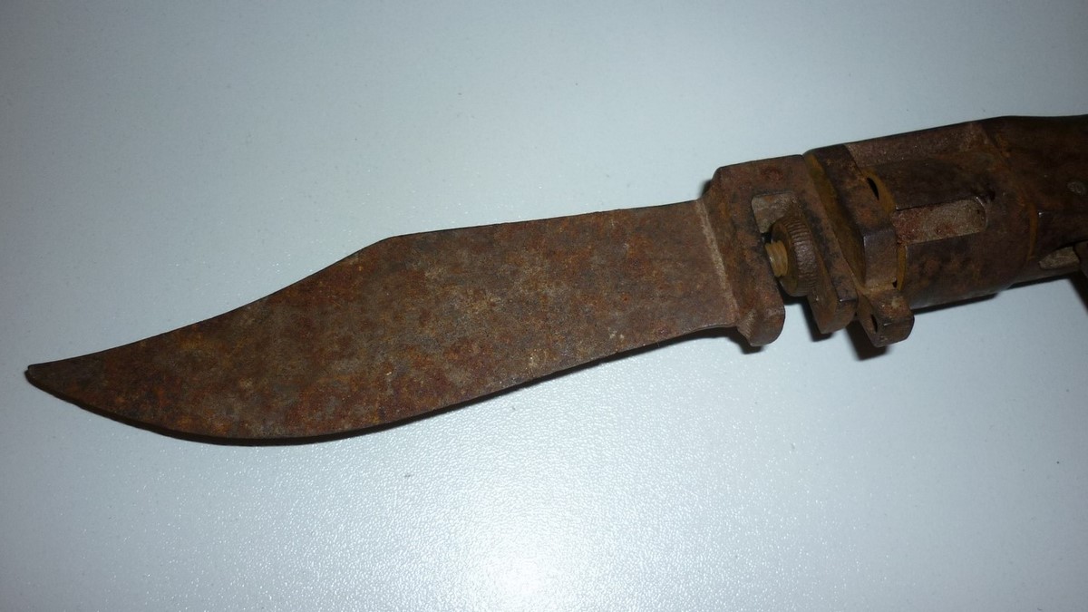

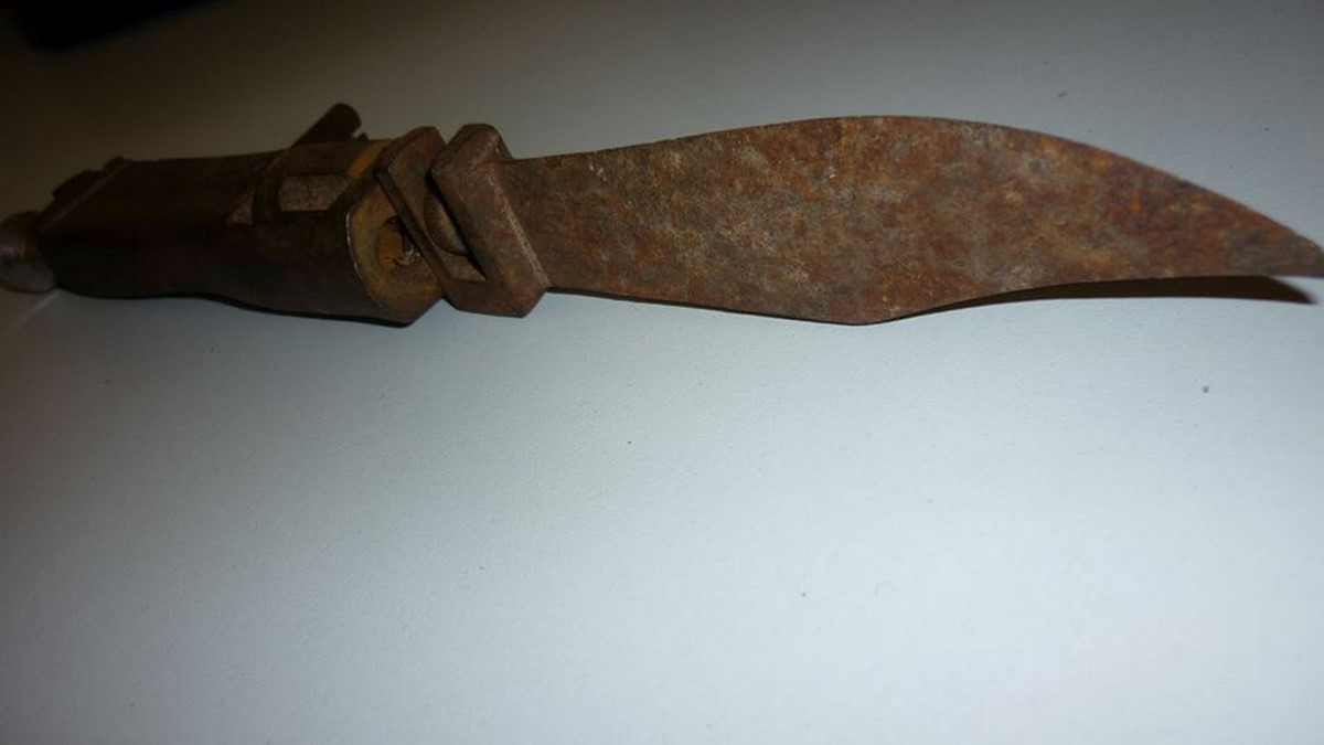

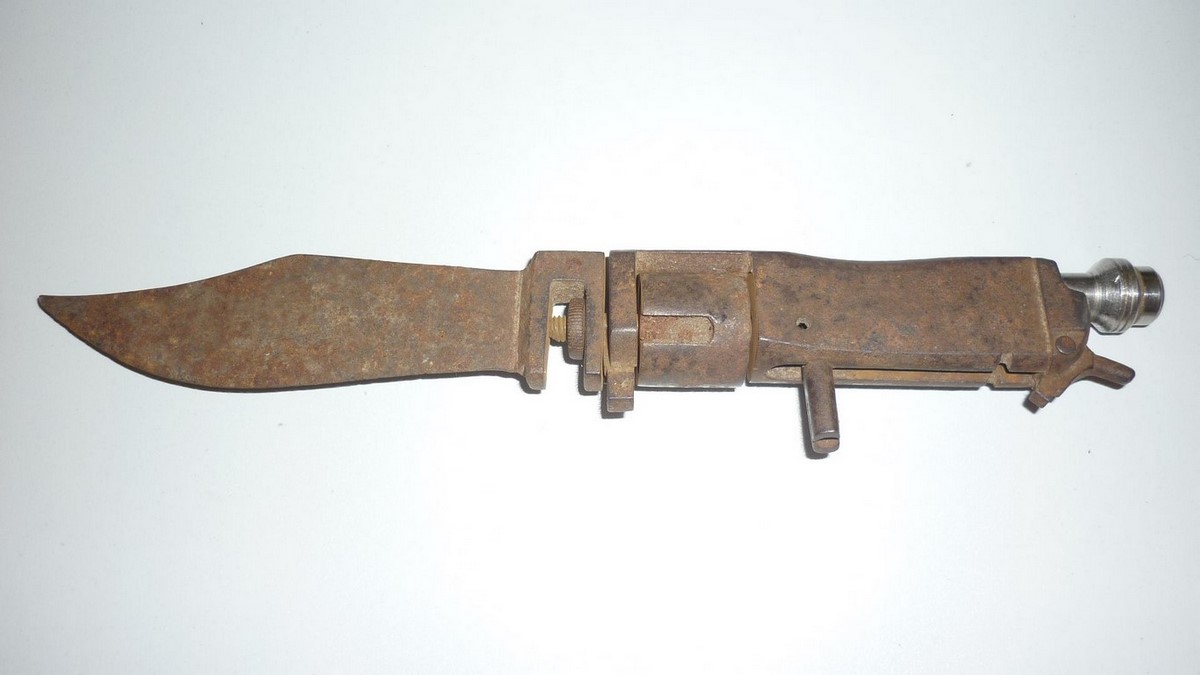

I have been sent these pictures of what seems to be a gun / bowie knife combination in the hope I could recognise it , well I have no idea whatsoever what it is or how it operates , but maybe it will make sense to another member .

looks a very interesting piece of work
well finished as well so i would think it came from a proper skilled manufacturer.
looks like there is some sort of slide and a hammer the pommel end
does the bullet come out where the modern piece of metal is
I would need it in hand to figure out what is happening
I would love to see more pictures
Thanks
Ken

Hi Ken ... unfortunately I have not had it in my hands either but the owner is of the opinion that the bullet comes out of the hole near the ricasso of the knife and that the 'shiny' part is a cocking piece ( and a modern replacement part )

Hi
It looks very tight between the cylinder and the ricasso for a round to fit into the chamber. The small hold in the handle I presume is for when cartridges blow out.
Why the grove is in the cylinder is confusing as well.
One thing to consider is that in my youth when making .22 guns is that you can set off a rim fire on crushing it from the front of the rim. This might explain the detonation method.
The slide bit with the bar protruding might be the firing pin that the hammer propels forward or Maybe this was cocked back, held by the hammer device and then flew forward to strike the rim of the round
I will try and take a picture f the picture and make some sketch.
R3gards
Ken

My idea

Hi
Guess work all the way
Do you have an opportunity to see and play around with or purchase?
I would love to know the full story
Ken
