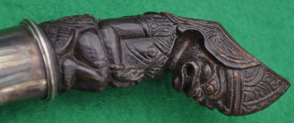

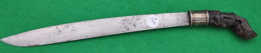

Just bought this very intersting knife, it's 39,5 cm (approx. 15,5") long overall, sadly no scabbard. I was listed as "Indonesian kriss dagger" but I strongly doubt this origin and have already an own opinion but don't want to influence any other opinions and want to read first what others think about this knife. So all comments are very welcome! The pictures are from the ebay auction/seller.

Thanks for that information. As far as the identification of the figure on the hilt, I wonder if it is a depiction of Hanuman from the Thai Ramakien. We had a discussion previously of how Hanuman is portrayed in the Thai version of the Ramayama here. The open mouth and canine teeth are common features in Hanuman's representation.
Old 13th September 2017, 09:07 PM   #11
Hi Ian,
very good hint and very obvious! This would also explain the "crown" he wearing. Thank you.

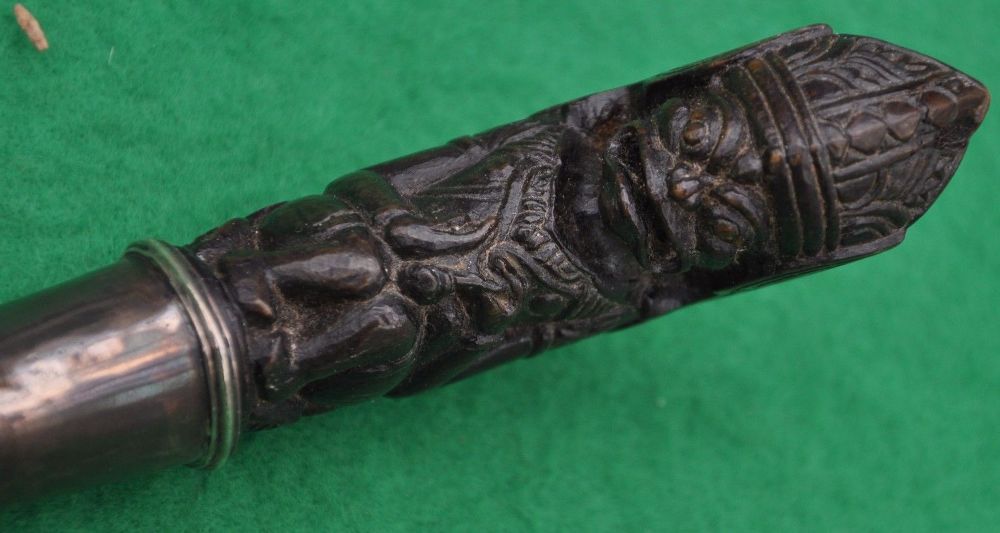

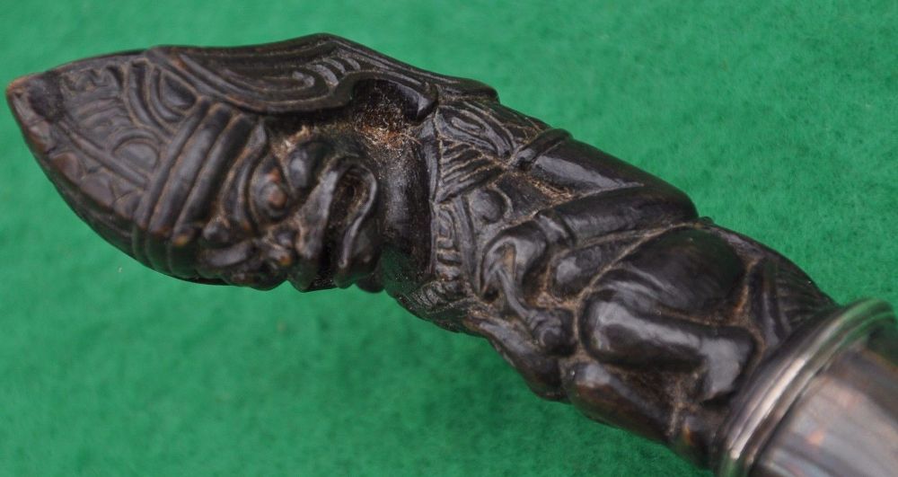

Have received the knife already some days ago. Sadly is the blade heavy and partly deep scratched from a previous owner by a grinder or something else, the tip of the blade was bended and the horn hilt is cracked in the back. The tip is straight again and I've started to repolish the blade on one side, it's possible but hard work. The blade seems to be laminated what let me think that the origin is South Thailand.
The deity hilt figure has no fangs so I don't think that it shows Hanuman. Soon as possible I will be able to show some better pictures but here a few fast taken ones which shows how badly the blade is scratched and some close ups from the hilt.

Thanks for the extra pics Detlef. I agree, definitely not the usual depiction of Hanuman in Thai work. There are, however, many other characters from the Thai version of the Ramayama that this figure might represent.

Originally Posted by Sajen
My first concern will be the blade and I think that I am on a good way to let look it nice again.
Here some fast taken pictures after the first side is polished and has received a mild etch.

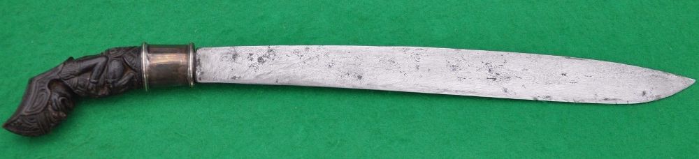

Old 5th October 2017, 11:31 AM   #19
The back side is polished as well, here a comparison before and after. Will post pictures from the complete knife when it is etched.

Old 8th October 2017, 03:53 PM   #24
Here the finished work, the blade is polished and etched with lemon juice. Excuse the picture quality, it's rather dark here in Germany.
Rolands and mine assumption was correct, the blade show only a hardened edge but not a contrast lamination.
