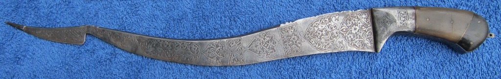

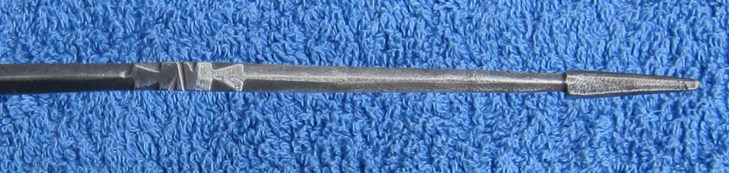

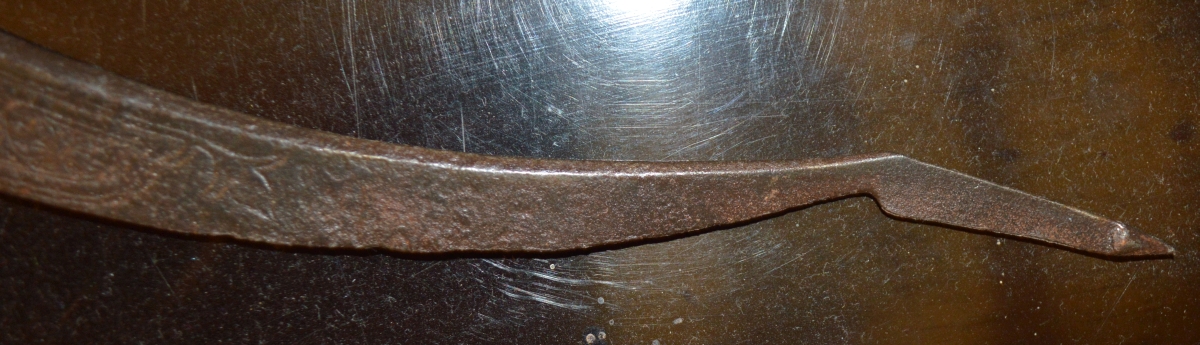

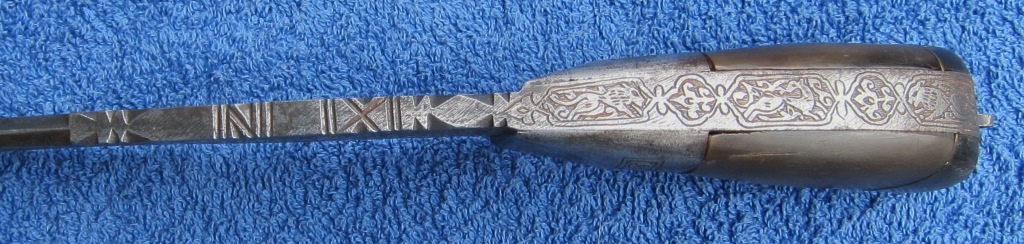

I have been following the thread on the "Karud" with much interest.
It has prompted me to dig this out and ask for name suggestions.
Mail-piercing, double pointed, curved, single-edged short sword or long dagger should cover it.

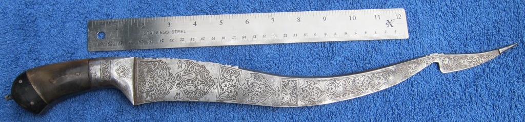

48 cm / 19 ins long with a 38cm 13.75 ins single-edged blade which is approximately 1/4 ins thick near the hilt.
Mail-piercing tip which is on the end of an "extra" or second tip.

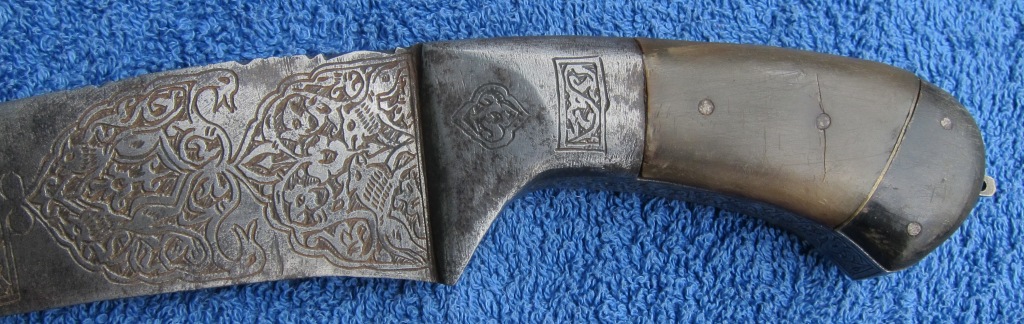

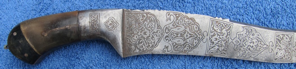

Heavily decorated blade with bird heads, lions ( or wolves ) and deer. The decoration is repeated on both sides of the blade.
Hilt is steel with two colours of horn as grips.
I think it is too good for a tourist piece so will call it a rich man's hunting dagger.
All comments welcome.
Roy

These come from Afghanistan I believe and are fairly new.

That tip looks very fragile to me to be a mail piercer. Looks like it would break off on first use. Otherwise an interesting blade.

I agree - looks unusable since it will break near the tip under stress and is more like a fantasy piece - maybe more like a modern custom dagger made to look old?

I have a very similar one...somewere.....I will try to find it, surprisingly the steel is really very strong but I think these are modern made, I have seen a few for sale in the last couple of years.

I agree also. Serious mechanical drawback in the design.
I've never seen anything remotely resembling this sort of construct, which is not to say it doesn't exist, obviously, but as to utility, meh.

Thanks Gents, you are probably right.
In it's defence though, I would say two things.
The tip is not flimsy, I think it would penetrate mail.
As to functionality, a quick look at the archives here and on google for any Indian weapon containing the words Flamboyant, Ritual, Temple or Malabar will produce equally "impractical" swords.
Not to mention a few Naga weapons.
Estcrh, if you find yours I will be interested to see a photoraph please.
Cheers
Roy

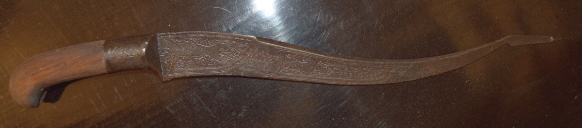

Roy, I will find it for sure but it will probably take a few days...or weeks...so many boxes!!! Your example is much nicer than mine, as it has wood grips that are not riveted but seem to be attached with some type of adhesive.

The mail piercing blades that I've seen typically have quite narrow and very pointed blades with a slight taper towards the hilt. This knife seems to have a rather thick point which might struggle to penetrate the mail. I could imagine the knife used to penetrate plate armour and then use a downward movement to slice it open like a can opener? But it seems the blade lacks a sharp edge?

the blade is tourist crap.

The sword n' gun makers in Afghanistan have been turning stuff like this out for ages ... The carvings whilst coarsely executed are reminiscent of finer work... actually the souk in Chicken street Kabul is full of these and similar, whilst down the road really good work is being made with Koftgari and all. In other shops close by you can find genuine old examples. I would agree on tourist material here, however, these are not weak blades and would go through most heavy leather clothing ...The blades are strong. After a while these are easy to spot as they have a look about them of late Qajar carvings naively done..interesting that they are being made in the same old way as the originals were... and often apprentice pieces ...

This is an interesting looking khanjhar (I cannot resist noting the broad use of this term as the concurrent thread on the karud term has been mentioned).
I typically try to avoid the 'tourist' moniker, and as has been noted, there are distinctly seen differences in quality of weapons produced in ethnic character which MAY be acquired by tourists, but in many cases by locals as well.
The curious and thickened 'barb' at the tip of this blade seems more for threatening 'effect' visually than practically intended. Burton (1884) described the folly of barbed or serrated blades in that these became imbedded in the victim and not being able to be withdrawn, left the user weaponless.
Naturally, no edged weapon was intended to directly penetrate plate armor, and those intended for armor piercing were thickened at the notably narrowed spear type point to enter mail through opening a link.
Plate armor was bashed to compromise it enough to possibly open a breech, but typically penetration of edged weapons was in areas not covered by the armor. In any case, in India and Central Asia, plate was not worn as a rule, and 'piercing' was directed toward heavily layered textiles or leather.
With the obvious matter of ingress and egress the point of this curious weapon, though dramatically threatening, renders it unlikely as a weapon, at least in the usual manner. Still, the prospect of having that nasty barb imbedded in someone is a dreadful consideration.

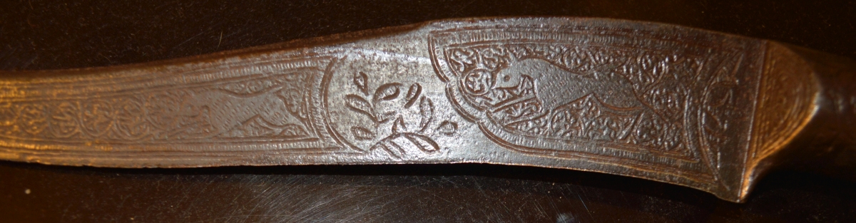

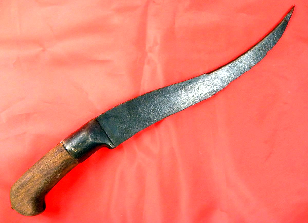

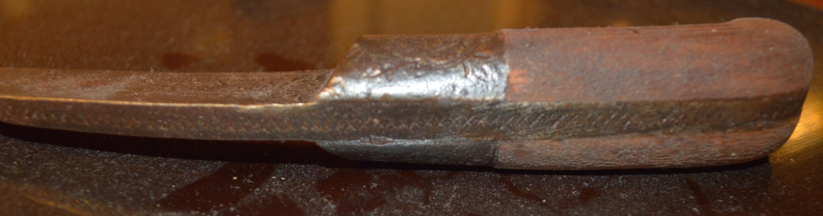

Roy as promised. A very similar one but much plainer and mine. Yours is of a much higher quality as I mentioned.
