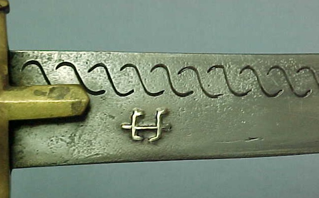

I have recently taken an interest in a supposed late 15th century Biedenhänder that is displayed at a local museum as having belonged to a historically significant person. The sword in question is so monstrously large (84", 14 lb 9 oz) that I cannot imagine it to be anything else than a ceremonial sword.
The museum's staff were not able to give me much information on the sword - their main interest is in preserving it as an object of cultural significance. I found some markings that I thought might provide a point of entry for some amateur sleuthing.

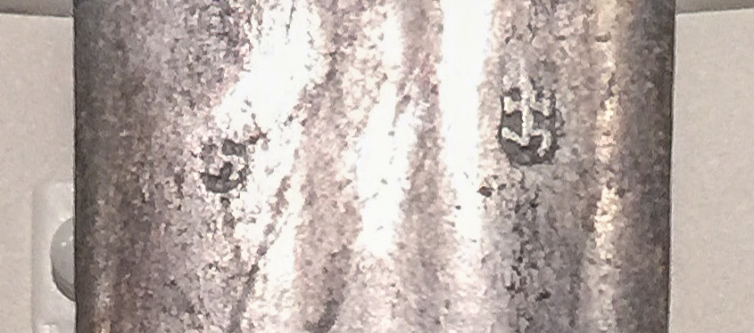

First, there appears to be a maker's marking near the hilt. I've examined every post in this thread and googled 'till my eyes hurt, but can't find anything similar. Does it ring a bell for any of you?

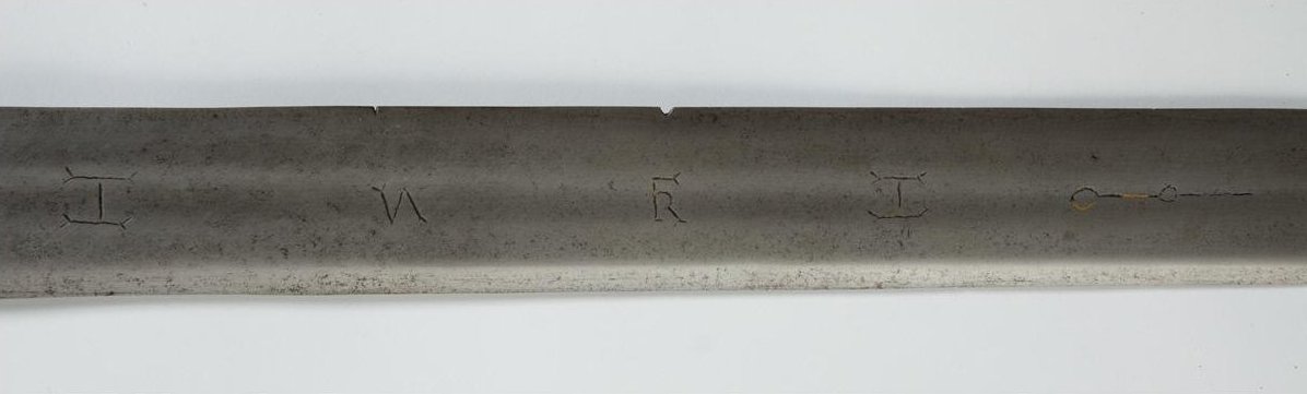

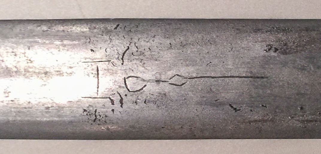

The second is an engraving next to a capital "I". I believe this "I" is the last letter in a widely spaced and crude "I N R I" engraving along the length of the blade, but I'm not 100% sure, as I can only make out "I N (unrecognisable) I". Is the needle-like inscription for decorative purposes, or do any of you recognise it?
Thanks a lot for your time!"

The mark on the first image resembles a Tatar tamga, but more probable references can be found in THIS POST

Presuming that this is a sword produced later, the markings stamped in the blade are in the manner of numerous makers, which are difficult to trace often as there are so many, but these seem authentically placed so were of course probably correct. The style of these geometric devices are much like countless variations used in Switzerland, Germany, and N. Europe, in many ways mindful of the 'fylfot cross' (or gammodion/swastika). The periods of these do seem to be in around 16th c. but without reasonable match it is hard to say.
The 'engraved' device which seems paired to the 'INRI' (as supposed) is very much like similar devices seen on blades from Passau in latter 15th c. and in the 16thc. These often have a heart (in place of the orientation of the 'INRI') and have lozenges placed in the same spacing on the line from the heart/INRI or whatever is there presumably (see Kinman, p.130).
It seems possible that this device was applied in imitation of the Passau type devices. These typically had religiously oriented talismanic value, as did most of these 'latten' (brass or copper) filled devices used in Passau.
That this does not have this filling suggests it is likely copied as typically this survives more durably than the rest of the blade.
I would suggest this is probably a commemorative and votive item produced in memory of this heroic figure, and probably much later, perhaps 17th ?

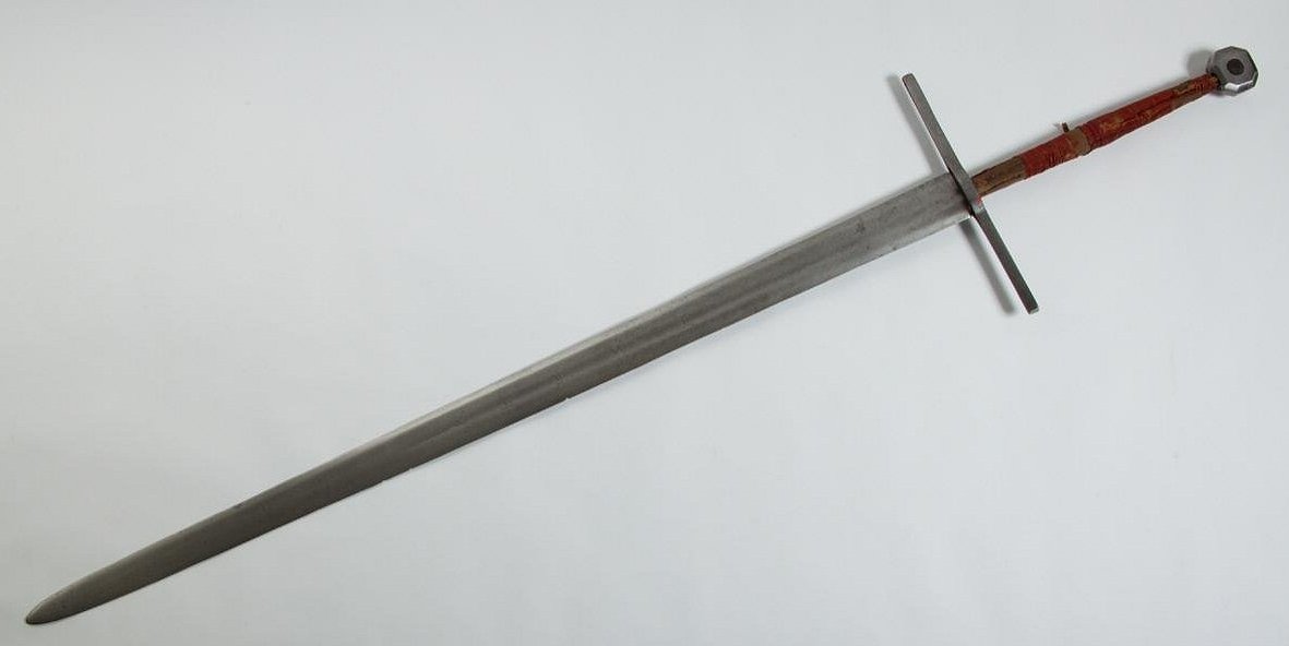

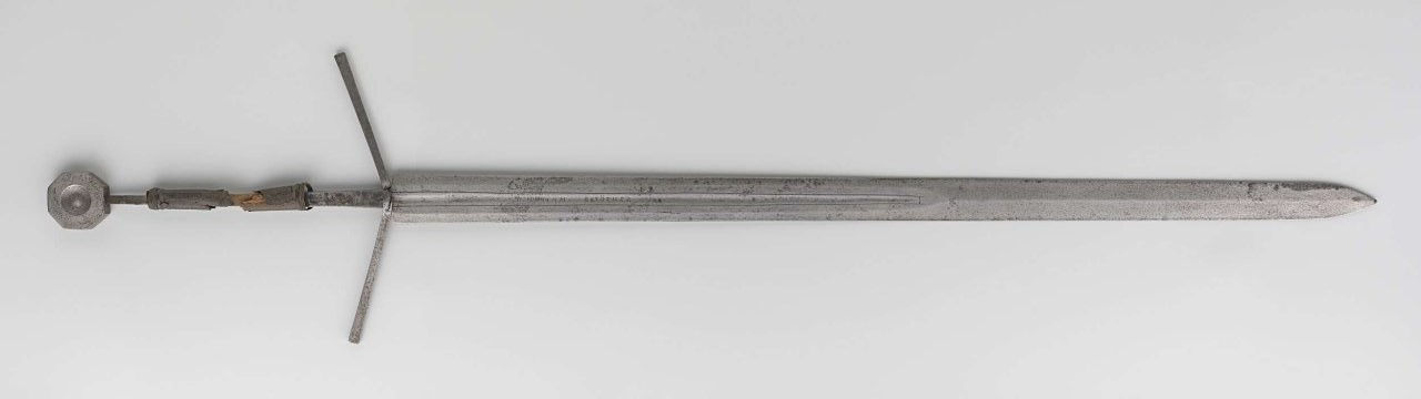

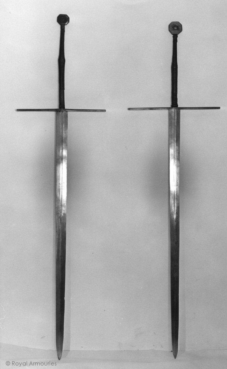

There are several other bearing swords of similar dimensions and physical features. Two in the Royal Armouries are generally identified as having belonged to either Henry IV or V, which would date them to the early 15th century. Other similar swords are usually not dated any more precisely than "15th-16th century". Note that the pommel of one of these is particularly similar to the so-called sword of Grutte Pier, as is another in the Rijksmuseum.

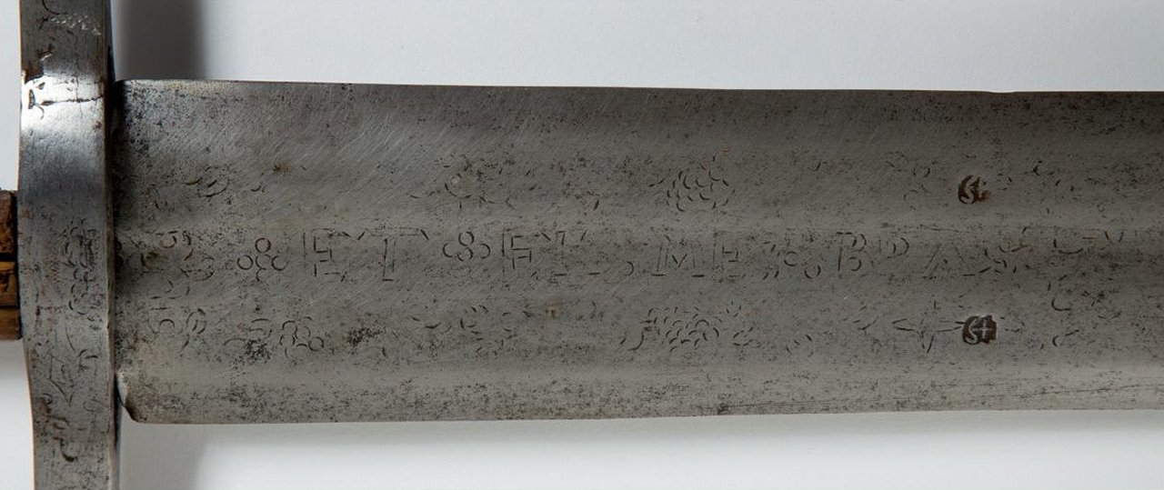

The suggestion of an "INRI" inscription is very plausible, this appears on a number of other examples. In particular it appears on another bearing sword that was formerly in the Higgins Armoury, as does the other mark, which is likely a representation of a bishop's crozier. As Jim says, this is one of the marks that is generally associated with Passau. This sword also has a pair of stamped marks very similar in style to those upon the sword in question.

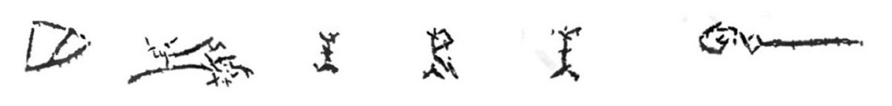

For comparison, I include a drawing of the inscription on a sword in Vienna which I would suggest is more likely to be a Passau original, and not an imitation. The crozier is more clearly rendered, the famous wolf-mark is included, as is the text "INRI" (though the "N" was forgotten!)

The photos did not appear in the order I intended them, to match my comments...
The first sword with the bent quillons is the one in the Rijksmuseum, then the second (with closeups) is from the Higgins, and is now in the Worcester art museum that retained some of the former collection.
