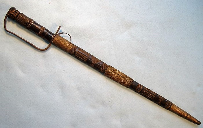

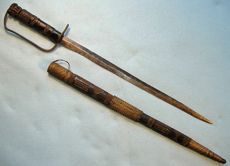

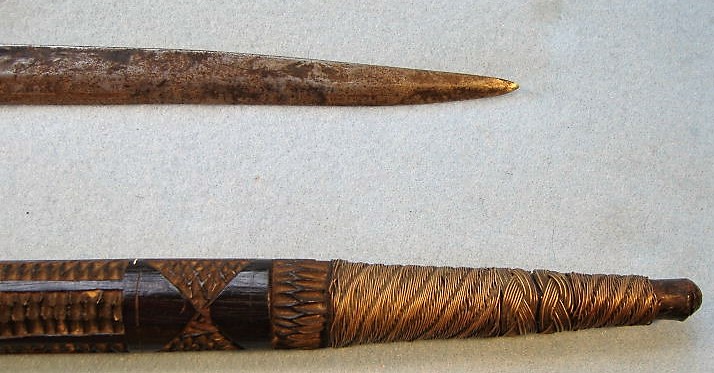

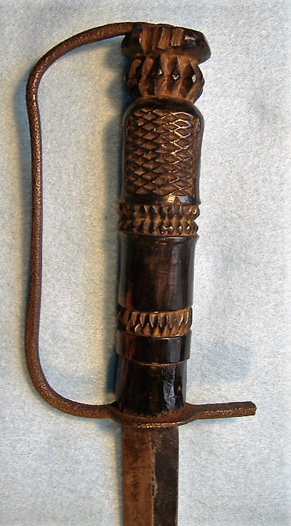

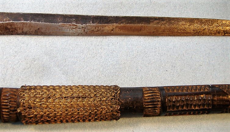

This is a not a typical Shona piece, and it clearly has been influenced by seeing European swords with the most obvious example being the iron handguard. Otherwise, it shows all the class is trademarks of a Shona piece. Note the carving style and the incredible brass wire work with the typical two toned iron blade(diamond sectioned). I love the old patina on this piece. I am assuming it is from the first half of the 20th century.
Dimensions:
Overall length: 23.25in.
Blade length: 16in.
Blade width at the forte: .75in.

Congratulations, a good piece ... I like it. The European style hilt seems to have been copied a lot in Africa.
It could be from other tribes as well as the Shona, however.

This is of course a fascinating weapon with its obvious European influence, the most notable feature the distinct knuckle guard.

One thing I do notice however, is that this blade appears to be of a socket type bayonet, probably a M1876 Martini-Henry. Looking into the possible Malawi provenance, I note that this region is to the NE of Zimbabwe, the key location of the Shona.
Apparently in the latter 19th century, the African Lakes Co. was situated there to ensure British interests, and perhaps the forces there, though small in number, might have been the source of this blade?
The European guard of course was probably seen on hangers or swords of these occupying forces as well. Interestingly, I have seen simple sheet steel knuckle guards used on various native edged weapons to the west as well.

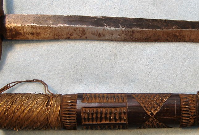

Jim, thanks for your input. While at first glance this does have the look of a bayonet blade, it is definitely a diamond sectioned native made blade and well within the abilities of the tribes of that region. Note the very inconsistent(non-industrial) line of the central ridge. The two tone "black and white" blade is also a common characteristic of Shona blades, especially on daggers. I'm thinking you may be seeing the blackened portion of the blade as an optical illusion fuller.

Thanks Charles, at second glance, that ridge is pretty wavy!
Wonder if they used the bayonet blade as a prototype? I do recall that Massai blades from Kenya have pronounced central rib, but again, hard to say exactly how these influences transmitted.
