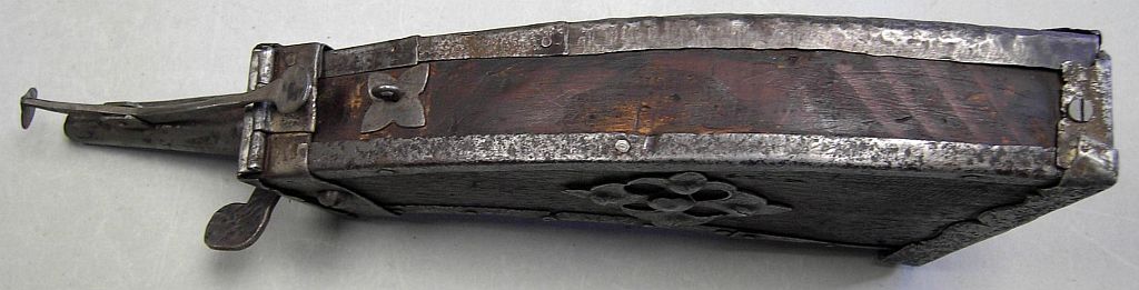

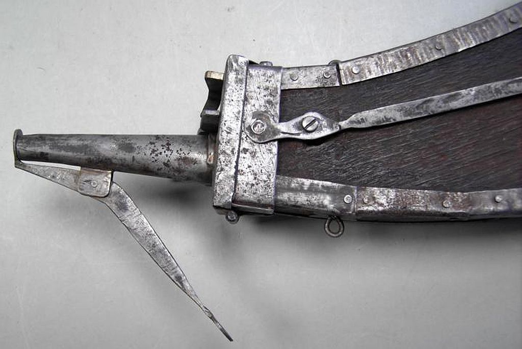

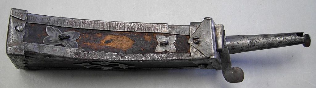

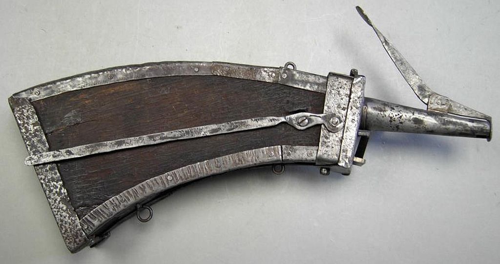

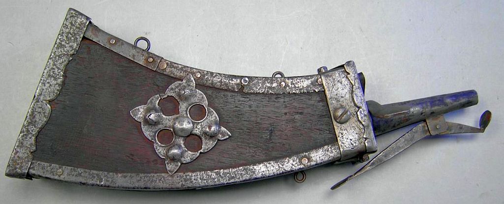

I got this powderflask last week and wonder if there are some remarks to make. Some screws have been apparently replaced, the spring on top of the cover is new and the spring at the spout is missing.

Hi Corrado,
Michael did a good thread on these "caliverman" flask and has a few examples nearly identical to yours dateable to 1580-1600s
http://www.vikingsword.com/vb/showth...man%27s+flasks

Hello, It appears to me that the Flask has been repaired in an enthusiastic manner rather than in a sympathetic way. The steel banding does not match or blend in. The hanging screws and backing plates in the photographs look new . The powder lever on the body of the flask , difficult to see from the pictures but appears to show little sign of an age. The lever on the spout again looks rather new and shows no sign of wear or a spring ever being riveted to it. I suppose the question is --- Was the flask a quick field repair from many years ago or just put together for a sale ????

The fact it has been repaired would rather point towards actuall use than to mal intent by the seller.
I have no idea if there is a provenance but it would be most likely used during the tthirty years war where everything ran low.
We know from Michael his threads that many haquebut barrels from the 1500s where reused in guns for the thirthy years war, beeing obsolete. Such was the need for arms.. i can imagine something similar for powder flask.
Fun thing with this piece is that it is hinged on the top. If you where to unscrew the screw opposite the hinges it would open up and offer an insight into the inner bowles of this flask.. maybe even proof of black powder
