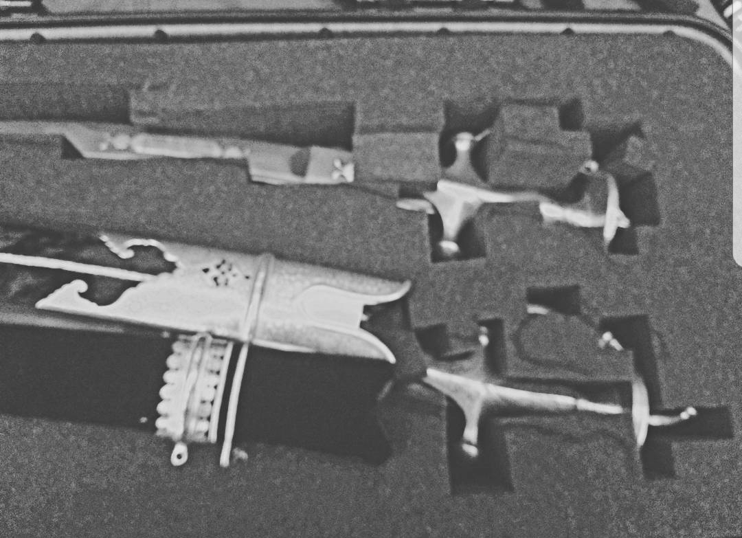

I am having a hard time finding the right storage case for some of my really nice tulwars. I tried the gun case with the foam that you can pull out based on the shape but I am still not super pleased with the results. Just wondering if anyone has any suggestions?

My experience is that foam attracts moisture and easily rusts items contained within.
For transportation I use a nylon zippered golf bag that has two wheels. The interior has adjustable straps and velcro.
I use gun socks for each sword then put them into the bag securing them with the straps.
Of course this is not for display but does make for easy storage and travel with the exterior handles and wheels.
I've never had a sword damaged or scratched using this method.

1) Reline the gun case (top and bottom) with egg carton foam. Don't worry about recessing a space for it. Just close the case on it with the new foam in place. It will conform to the shape of the piece(s) while closed and hold it very snugly in place. When opened and the piece(s) removed the foam should for the most part return to it's original shape.
2) Impress the pieces into floral foam (floral foam takes impression very easily). Then coat the impression with a few coats of spray on Plasti Dip. You may want to wiggle the piece in the impression a bit before coating to correct for the thickness that the Plasti dip will add. You can then easily dig out the foam once the plastic dip dries and having a perfectly conforming shell. Though personally I'd leave the foam in place.
