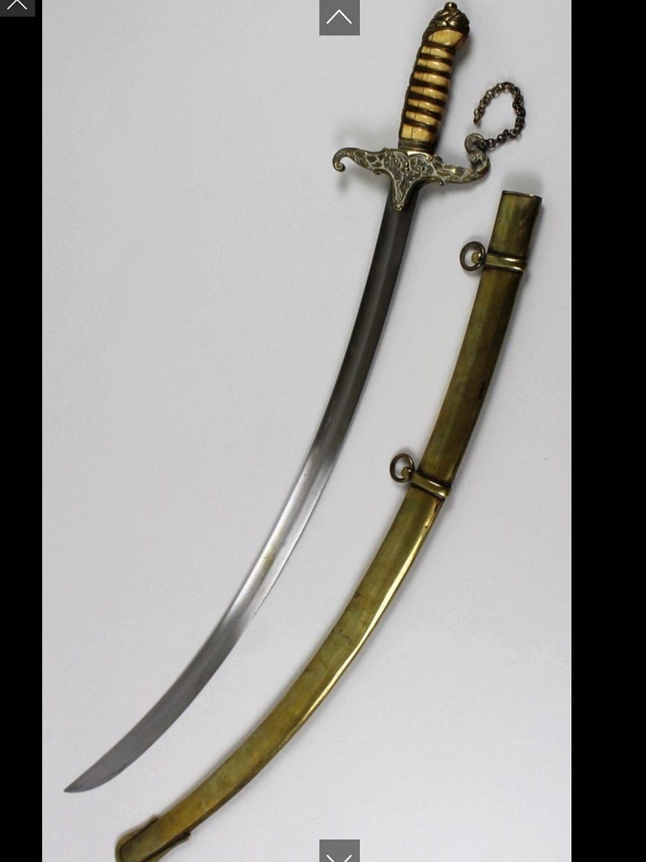

Hello All,
This is my first post, greetings to you all. I was wondering if you could help me ID this sabre.

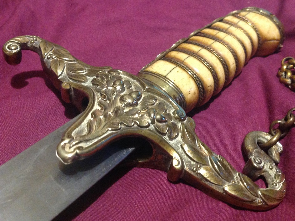

A few initial observations: The casting is of high quality. The blade is good steel, has been sanded before I got it, no markings anywhere. Wire bound bone grips. Pommel nut and threaded tang. Chain guard detached.
The suspension rings are designed such that the upper ring is the functional one, the lower for looks only.
I feel this is some sort of dress sabre, mid 19th C.
The laurel and oak leaf designs seem rather French to me, as does the high quality casting. Wild guess: Oversize French made US Naval Midshipman's dirk?
I bought it as I thought it would look nice on the wall. I usually go for 1795-1815 cavalry sabres.
Thanks in advance for any comments that could help with identification.

May i ask ... what makes you think the lower suspension ring is a fantasy ?
And ... can you tell us the length of the blade ?
One more thing: are there no marks at all ?

doesn't look 'naval' to me. naval/infantry swords usually did not have heavy metal scabbards, cavalry could as the horse usually carried it. blade looks very 1796LC-ish with the hatchet point.
looks like a private purchase officer's cavalry sabre possibly late 18c - early 19c like the dates you mentioned, when such were allowed prior to standardisation. if it's length is under 30 in. it could be a naval officers personal hanger. middies didn't carry swords, even the old ones that might be older than the other commissioned officers that passed their exams. (they might carry a ship's cutlass tho.). are you sure the lower ring isn't just stuck? was there once a ring to attach the loose end of the chain to the pommel? the pommel looks more like it has a keeper and is peened, has it any exposed thread? a photo of it would be cool. shame no other markings...odd there appears to be no wear or oxidation, the ivoryor bone looks aged tho.

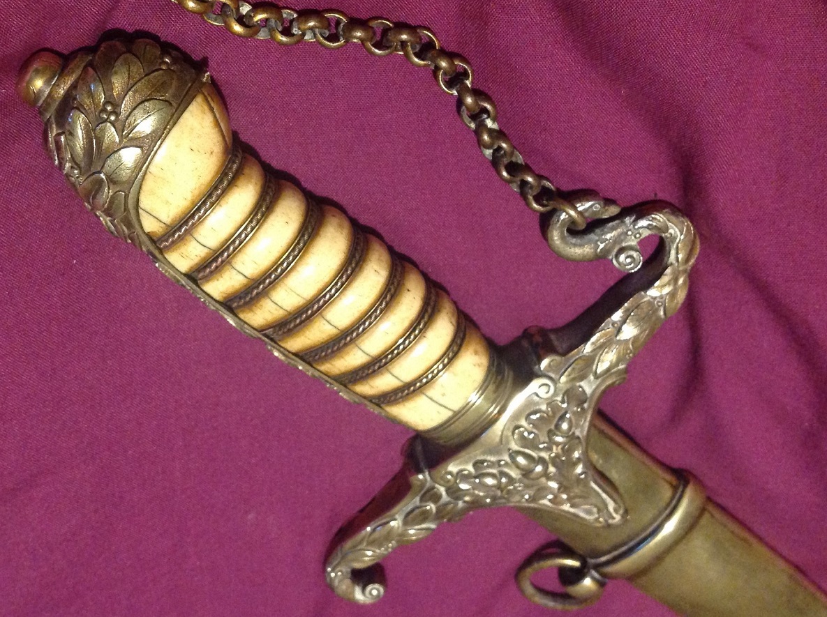

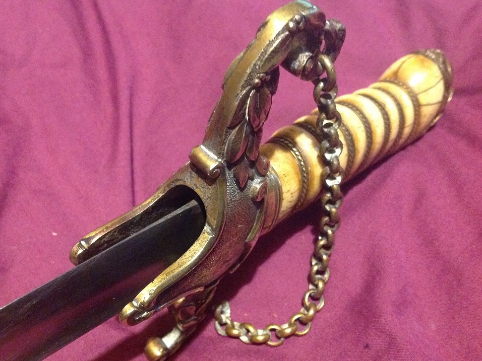

The sword knot has been added as an experiment, not suited, I know...
Anyway, pic of grip & pommel removed, by unscrewing nut at end of pommel.

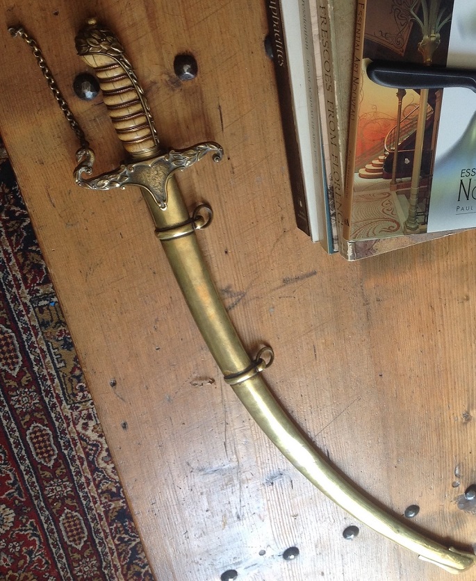

To me it looks unusually perfect
I have never seen such an unindented scabard and the blade looks pristine
The brass does not look rubbed at all with the ever so crisp casting
The only part that looks to be aged are the grips. Might it not be what it seems?
I have a good few 200 year old swords and this looks like straight out of the shop to me( bar the grips)
Jon where did you get the sword? Any story

Hi, thanks for helpful responses.
My comment on the lower suspension ring was only to say that I think it was the main 'load bearer', with the sabre intended to hang vertically, not at 45 degrees, (a-la-Hussard).
The chain anchor point came detached with the chain, it seems (formed as a half link, like those on the chain proper). A previous owner tried to glue it back on.
Overall length: 87 cm (34.3 inches)
Blade: 69 cm (27 inches)

Has age and appears British/Scottish(acorns), the snake hook is a British design used as their belt hooks but here for a chain as part of the guard.
Could be for a civilian appointment. The scabbard is also very British.

found the below online, looks like the disassembled grip has a correct pommel nut with the tubular extension and hemispherical termination unlike the hex acorn nuts used by the modern cheap repros.
be careful reassembling it, the threads look stripped and may be a bit fragile and also may need the attention of a good restorer.
