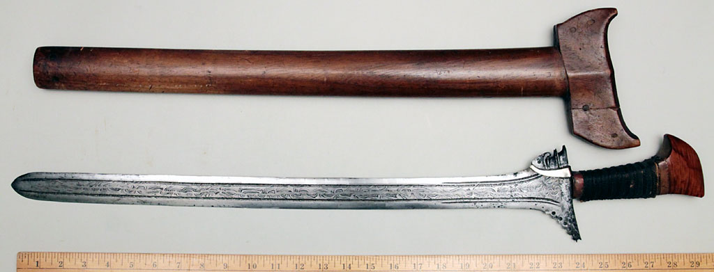

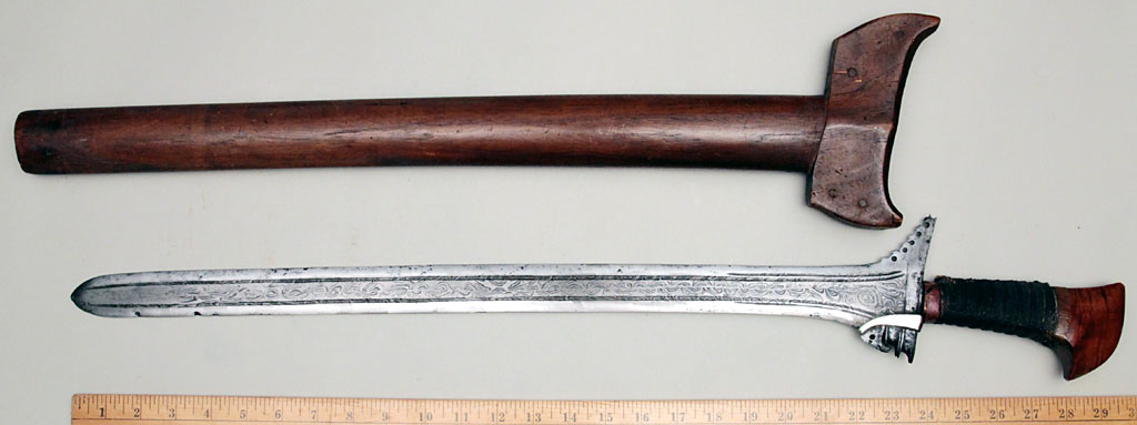

Default Pattern Welded Straight Kris

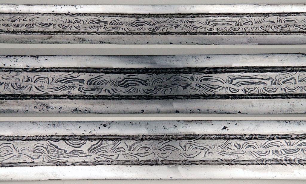

I had mentioned elsewhere on the forums that Moro and Sulu arms will often show pattern-welding reminiscent of that seen in European early medieval arms and that I would present this kris. The blade is just under two feet (60.7 cm) in length and is relatively straight (it is difficult to be sure whether re-honings might explain the slight concavity of the forward edge, though there is probably a very slight opposite convex curve on the opposite edge so it may be intentional. Most of the blade shows two bands of twist-core pattern welding in the central panel on each side between narrow fullers. Having it in hand, it appears that the same two rods are seen on both sides such that about 15 to 30% of the overall original rod thickness remains (thus around 35-40% ground away and lost to oxidation from each face). Where the blade is widest at its base, there are three rods, one of which appears to end in a swirl seen on both sides.
I acquired this example for the pattern-welding and I have suspected that it is one of the earlier examples in my collection. I am most curious for the opinions of members as to the origin and age of this kris.

Hi Lee:
What a lovely kris and I really like the complex twist core pattern on the blade.
If we believe Cato, then this appears to be a Maranao kris (based on the elephant trunk area). The shape of the scabbard would support that attribution also. The blade is a little slimmer than many Maranao examples which makes me think it is likely to be an older one, say early to mid-19th C. The hilt seems more recent, as does the scabbard which has been nailed rather than glued or wrapped.

Superb pattern weld! I believe it is the most beautiful I have seen in a Moro Kris.

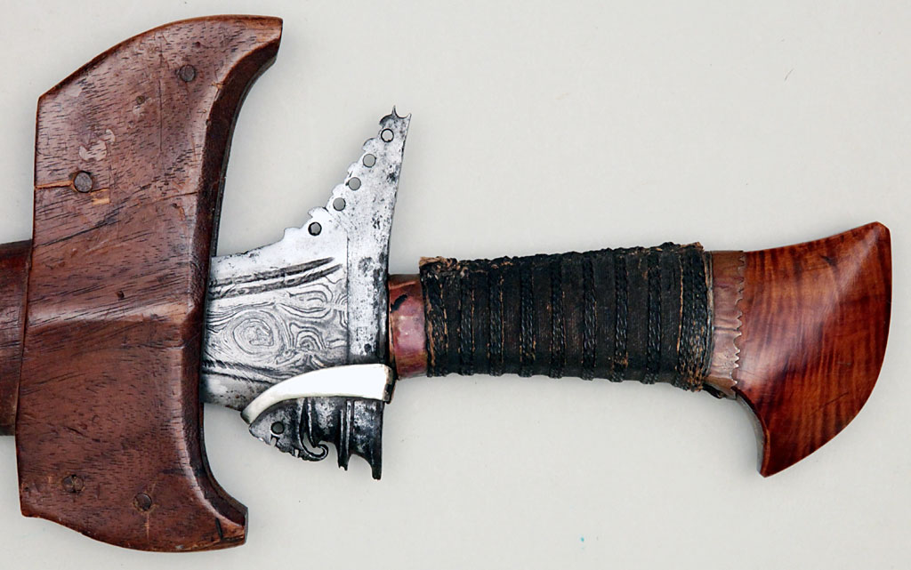

Lee, that slight curve in the blade is put there on purpose.
A very nice kris!
I also think the swirl at the base on each side of the blade has meaning.

Yes, I see the elephant - now that you mention it - and it is not even demanding too much imagination!
I think that you are correct about there being a slight deliberate curve. The photographs exaggerate this a bit as there is very slight 'fisheye'.
Those are wooden dowels holding the two halves of the scabbard together.

The slight forward curve of the blade is intentional and not rarely seen with "straight" kris.
And the swirl at the base of the blade is an additional pamor motif (kul buntet in Jawanese) - something I haven't seen before with any Moro kris! Could you please add a larger close-up of both sides of the base of blade?

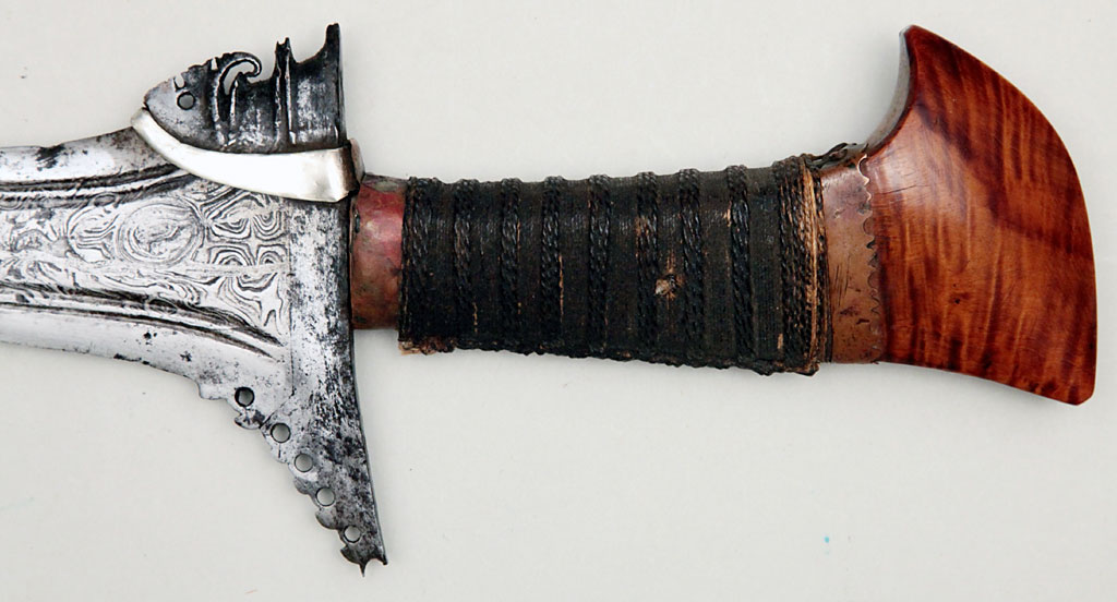

A top view on the gangya would be great, too!

Kai, I have noted your interest in a top view of the gangya and added it to the photo queue. Meanwhile, here are the requested close-ups of the base of this blade:

Those are wooden pegs holding the two halves of the scabbard together. There were also wooden pegs securing the end of the scabbard, but one is absent and the other broken (and the rubber band that has usurped their purpose was removed for the photographs).
The scabbard is made of relatively soft wood and it is bulkier than many of the kris scabbards I have encountered. The photographs are not optimal for showing a glued repair of the mouthpiece on one side and several cracks on the opposite side in the same area. Would this scabbard have stood up to a generation of regular use - I seriously doubt it. I even wonder if this was made as a 'resting' scabbard.
