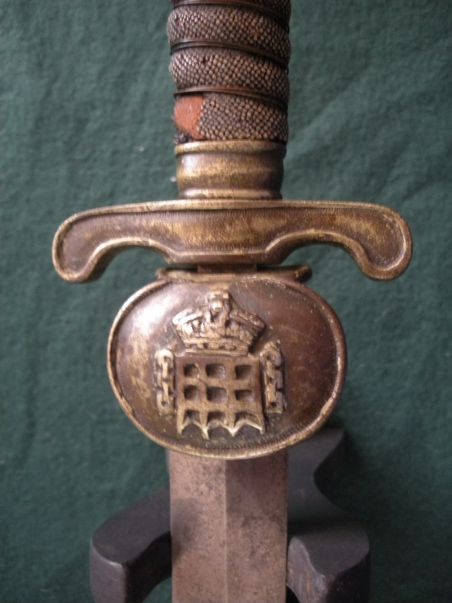

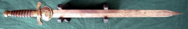

Hi Guys,
I have had this sword for a long while. Originally bough same as belonging to the "Tower Of London Beefeater" guards, but it doesn't seem to fit the bill, at least to me.
The blade was soiled to the point of blackness. Once cleaned, it evidenced faded and worn signs of its original etching. The words "Covent Garden" were eventually seen, very faint, at its ricasso. The half-shell guard's shield seems to correspond to the Portcullis in London's Westminster Abbey.
The etching and fish skin grips seem to suggest a post 1850s to early 20th C. manufacture date.
Any ideas, beyond what I already know? A coronation guard? An abbey grounds warden?
I know there were at least a couple sword retailers at Covent Garden: "Hamburger Rogers & Co" and "J & B PEARSE & CO".
(BTW, I hope this is not another of the usual cases where nobody else knows more than I do. )
Best
Manolo
Caveat: This, as any of any and all of the other blades in my collection, may be sold at some point in time in the future..!

The badge is the Customs and Excise/Revenue (British) badge, so presumably their Dress?? sword/dagger??

And yet, the portcullis and chains are the traditional Tudor and Westminster Arms, and in mine, the hat-piece over the Portcullis looks more like a miter than a crown. Even so, your suggestion seems very plausible. Now I need to research that venue.
Thanks for again coming to the rescue!

Manolo, what an exceptionally unusual item, which I believe may indeed be associated with the 'Beefeaters', who were termed Tower Warders, and I believe accordingly these may be considered one of thier swords. The style of the weapon is very much in accord with particular corps and departmental swords of the Victorian period, noting that Stuarts suggestion is quite plausible as well.
It seems of course that I have seen something similar in references on British military swords, although these guards are comprised of retired military men of considerable standing and this is unofficially a yeomanry unit. I have checked "Swords of the British Army" (Brian Robson, 1975), but no reference was found, therefore I think it is in one of the earlier books which I do not have with me. Possibly "British Military Swords 1800 to Present Day" by John Wilkinson-Latham (1966) or another one which I cant recall specifically, I think something with similar title, also by another of the Wilkinson's but cannot recall which.
It is possible that it was in the venerable "Sword, Lance & Bayonet" by Ffoulkes and Hopkinson (1938), but these books I have not seen for some time.
In any case, as you have noted, the Westminster arms are indeed with the charges of the portcullis and chains, so are not necessarily confined to the customs unit. The portcullis and chains on the shellguard on your sword would keenly represent the Tower warders as they indeed were in charge of prisoners entering through 'London Gate', the portcullis seen.
Hamburger Rogers were as noted outfitters located in Covent Garden, and I have seen thier etched panel on officers swords of c. 1860's-80's.
I hope this will help a little, and thank you for your candor in noting that this will be an item for sale in the future. It is a most interesting piece and I am glad we had a chance to discuss it here first. I have, as noted, it seems seen something like this at some point in a reference book, but cannot recall ever seeing one offered or discussed, as there cannot have been any significant volume of them.

The form of the Yoeman Warders sword from the early days of Queen Victoria's reign is as per the attached photograph. The crown on Manolo's sword is I believe the Tudor crown used before the Hanoverians, 1714, and more recently between 1901 and 1953, the Georges, William IV and Victoria used St. Edward's crown which is the one used currently by EIIR. Hope this is of some help.
Norman.

Thanks Norm for explaining the difference in the crown shape. The style of crown varies, and has varied thru the ages depending on the Monarch on the throne at the time. Sorry I was remiss in not saying this originally.
Regards Stuart

Thanks Norman, Jim and Stu,
I believe this sword was definitely neither designed nor made for a chicken-dodo outfit: It was relatively well done, an elegant fish-skin grip coupled to nicely etched blade.
While it was obviously not designed to be an effective weapon, it was most certainly an status-symbol, whose manufacture quality reflected well on the pertinent Corps, and whose bearer was quite probably honoured to wear it on Public appearances.
So far, we have three possible venues of research: 1. Westminster Abbey (The WA Chapter, Wardens, Coronations?) 2. UK Customs and Revenue 3. The Tower Of London's Beefeaters.
This is the fun-part of collecting: the sleuthing, the networking, the hunt for data !.
Pleeze, do let me know if any one finds anything of interest, specially our colleagues of British origin, and particularly those connected to London.
Cheers!
Manolo
BTW: Let me clarify that the reason I posted the "selling" caveat is because, some time ago, it was advised to warn potential contributors that their comments could be used to provide info on a sword to be sold. Since I never know when I'll trade or sell one of my babies, I figured it would be safer to simply always add the caveat, as requested.

I keep thinking bandsmans sword when I look at it... But its better quality than they usually are, almost a naval look to the handle.
Royal yeomanry Westminster Dragoons?

All of the british musician swords I have seen so far seem to be designed around a rather basic solid brass hilt, coupled to a simple blade.
Then, this could be an exception. The Tudor shield makes me think it could have some Royal ceremonial purpose, or perhaps religious and pertaining to the Abbey.
Another detail: This sword has an interesting end-point, straight edged. I have seen a similar point in German WWI-II replicas of medieval weapons, used for ceremonial purposes.
BTW, I forgot to mention it has an odd-looking hexagonal nut holding the pommel to the tang.
Curiouser, and Curiouser..

If the crown is Tudor, then it is likely to be because the era from which it comes, used the Tudor crown as the norm on Coats of Arms (as explained by Norm). IF you do not consider the sword as of practical use, then maybe my original idea that it could be a DRESS item is closer to the truth.
Suggest perhaps contact with the Historian at British Customs and Excise (I'm sure they will have one) and see what they have to say.
Maybe Gene could do this as he is at least in the right country.
Regards Stuart

LOL, I'd be happy to help. Have a looksee and I'll do the same later. If we can find someone to telephone etc, I can do that
I'll grab the pics now in readiness.
Did anyone check into the westminster dragoons?
The crowned portcullis is the symbol of both houses of parliament. With all the 'costume drama' aspects of our democracy, could it be a guard from there?
The only thing that makes me think it might not be completely ceremonial is the plain nature of the blade.
But the small guard reminds me or a court sword.
Hmmm, its a puzzler.

Yes the blade is plain, but it would probably have had a scabbard of some sort.

Here's one on the oldswords.com database...
The description given is:
"Item Description (Item Id: 103775)
Overall length 26.5 inches, and with a 20.25 inch blade, this is double edged and of shallow diamond section, it is etched with a panel with E.Woods & Son Bow St Covent Garden, the hilt has white metal mounts and the shell guard is cast with a crowned portcullis, the handle is covered with fish-skin and bound with wire, some areas of staining to the blade, otherwise good condition"
No reference to whom this sword was issued though.
Bryan.H is offline   Reply With Quote

Well, that proves one thing.
This is not a marriage or altered item.

Hi Manuel,
The Tower have been back in contact this morn:
"Reviewing it all the morning after – can I check – is your friend’s example yellow metal or white (I had it in my head as yellow, but all the other evidence is for white metal examples). I am chary about the Customs service identification – just because it is so different from the other customs’ swords. I’d like a bit more concrete evidence. Also from dim memory of the NMM (I started off there), the customs service is more often allied to the Navy than the Army, but it keeps changing its allegiance throughout the 18th & 19th C – however I am no expert in the field – hence do contact Liverpool. I would try Houses of Parliament too – if only to exclude the option.
I will keep an eye out for more info – although I paddle more along the muddy streams of Tower history nowadays. Please let us know if your researches expose more concrete evidence. Good hunting
The mounts ARE Bronze aren't they?
Old 21st October 2009, 06:18 PM   #27

Hi Guys!
G: I can't say if its bronze, I need to get back home and check. I do remember the hilt's shade is kinda' dark-yellowish, compared to the blade.
OTOH, I remember a hilt of silimlar shade becoming gray, once the oily residues were cleansed away with a solvent.
Below, more pics from a web-based photo depot, just click on the thumbs.:
celtan is offline   Reply With Quote

Originally Posted by celtan
Hi Guys!
OK, let me know as soon as you're sure, I'll email her and tell her.
They do look bronze in the pics.
