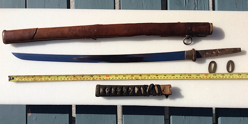

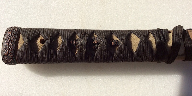

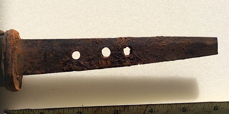

Sword one 22 1/2 inch blade, barely visible hamon but it is there, no proper polish. No tsuba but two leather washers in its place to make the handle a tight fit. Peg is lost. The metal icon under the distressed wrap looks to be of good quality and detail, missing butt cap on the end of handle. What may be interesting is the 3 holes in the tang so it must have some age two have been re mounted a few times.
No markings on tang at all bar the file marks.

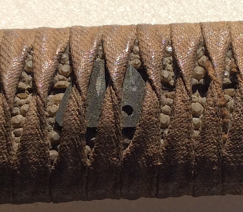

Second Wakizashi

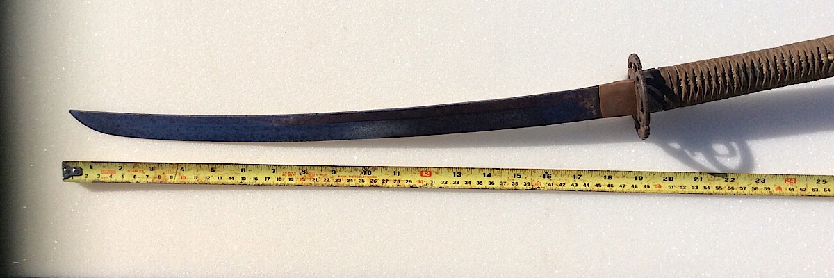

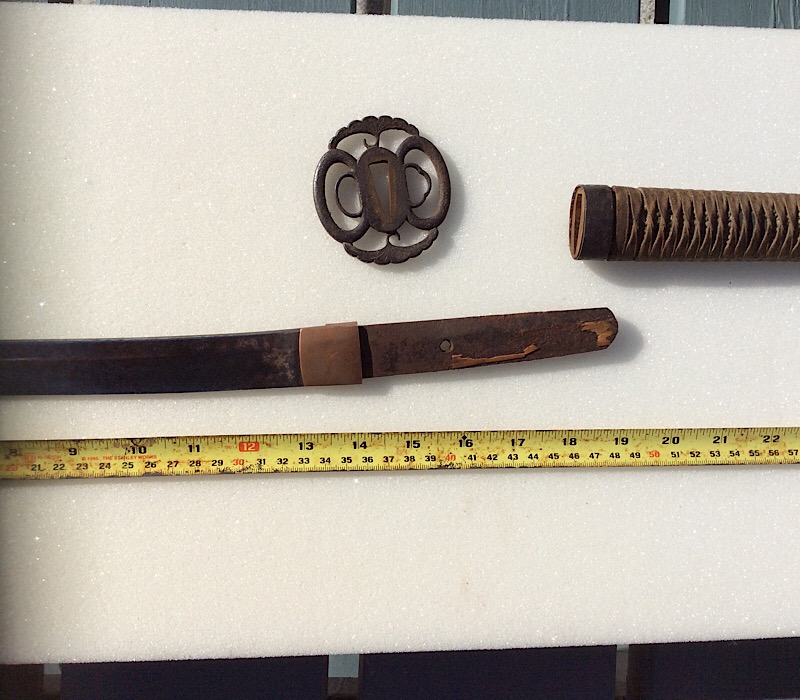

18.5 inch long in what I understand to be 1870's satsuma attire, simple wrapping on handle, iron mounts and basic tsuba, no scabbard.
The thing I am wondering about this is as follows.

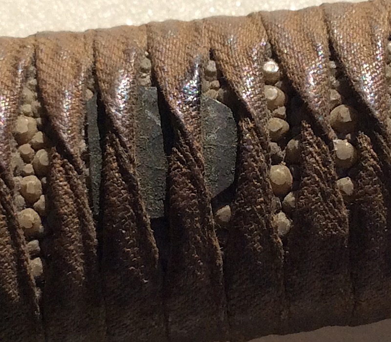

What are the two disc things under the wrap and is this a hand forged blade. It is in rough enough condition so I am unable to make out any hamon
Cheers

The scabbard of the first one is military WW2 (leather combat cover), but blade is much older. Nakago is shortened and indeed remounted several times. I can't see anything of the blade. I'm guessing blade might have been made during Muromachi period (15 or 16th century).
Please do oil the nakago, but never clean that part of the blade!
