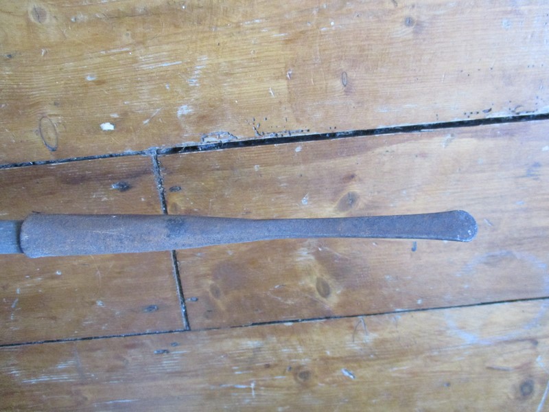

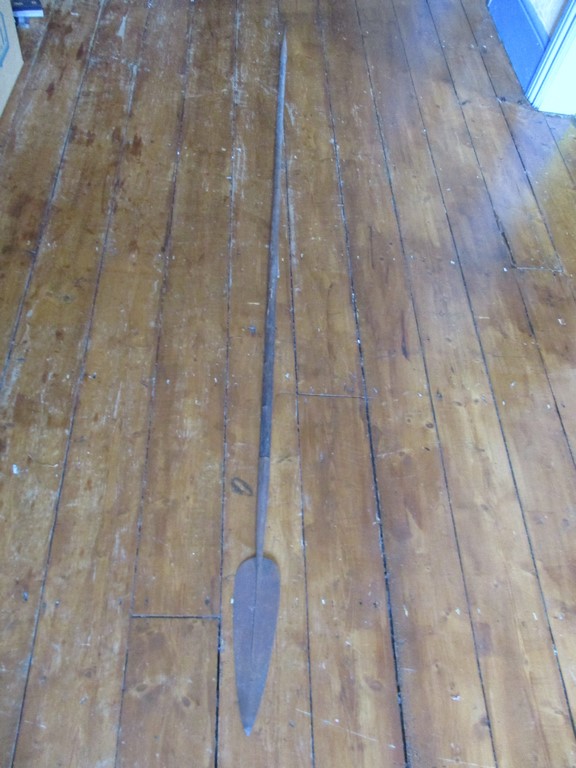

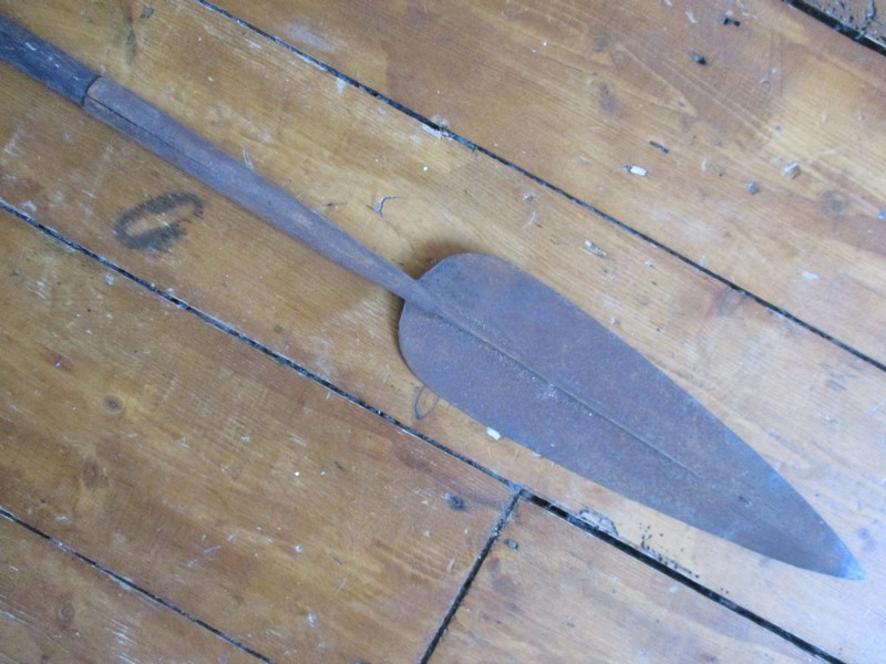

Started to have have another go at the 'heap' in the attic with a view to making some sense of it all and making hard decisions as to what to keep and what to dispose of . I am thinking this may be Sudanese . Total length of 2 metres , spearhead 45 cm and fish tail 'shoe' 20 cm . The wood looks like Acacia to me. Any opinions as to what region it is from would be most welcome .

Looks like the broad type seen in Sudan to me as well.

This type of spear is from the Somaliland/Somalia area. The well-made blade form and flat metal butt are distinctive.
But of course they could also diffuse to neighboring areas.

Thanks Colin ... in which case would you place this similar but larger spear from the same region ... http://www.vikingsword.com/vb/showthread.php?t=13013

No, I would place this spear in the Northern Nigeria area, perhaps Hausa. The blade form is a bit different and the cross-section is also different, being a flattened diamond and lacking the pronounced midrib of the Somali one. But to mention... Hausa spears of this type can sometimes be virtually identical to spears from Madagascar !

I would be surprised if this one is Hausa, spears from the Hausa and Fulani tend to be more lance like and even if broad, much more slender than Sudanese, Chadic or Somali examples.
But I have no major expert in spears, I've tended to focus on the Calvary lances and am a bit out of my depth on the multitude of other spear types in Nigeria.
