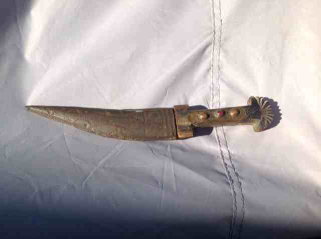

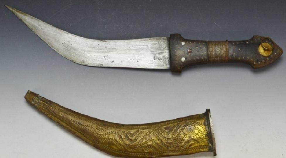

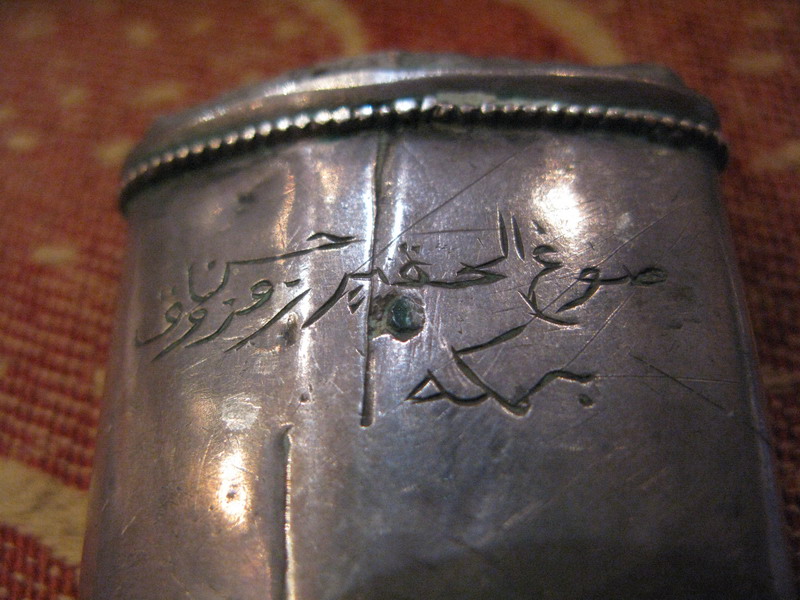

Thought this is a nice example to share. I found the images on an Arab website.
Inscription in the back says "the craftsmanship of the lowly, Hassan Zaqzouq in Mecca"

I have my doubts whether it can be addressed as shibriya. The blade is uniformly bent on both sides.
But in shibriya one side stays almost straight, but the other one suddenly tapers to create a needle pointed tip.
I think you have a classical Janbiya with a somewhat simplified blade ( no central rib).
Check Artzi's site Oriental_Arms: he has an enormous collection of shibriyas.

Ariel,
The name shibriya is a measurement by nature. Its the size that define a shibriya, not the shape of the blade.
Also, within its local context, it is named a shibriya and worn like one. And there are Jordanian shibriyas with the typical double edged, slightly curved blade.
I agree that most come with the blade shape you describe.

Hi, Ik don't really think it matters how you call it, but I like it a lot. It shows very nicely how regional styles merge where geographical areas meet. The main influence on the decoration and style are clearly of Jordanian shybriyas, but influences of Yemenite Khanjar and even more clearly, of Nejd ("wahabite") styles are apprent. The workmanship is far better than in avarage shibriya and the metal sheat looks thicker and of better quality (silver?) than in most shibriyas.

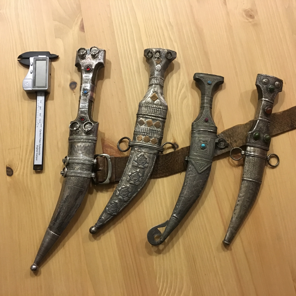

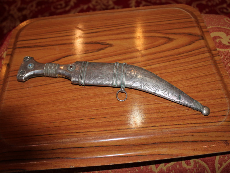

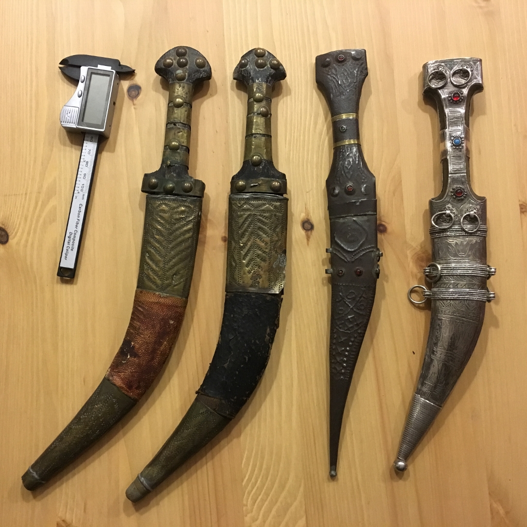

Here are more daggers from what is now known as KSA. The large, silver dagger with the well made blade is made by Ali AlBani who descends from a famous sword making family. They were originally in Ha'il but moved to Riyadh after AlSaud defeated AlRasheed. The rest are of Saudi craftsmanship telling from the style and decoration methods.

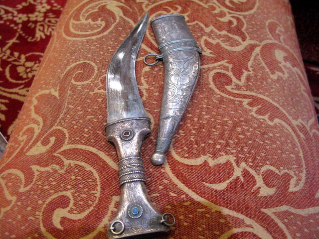

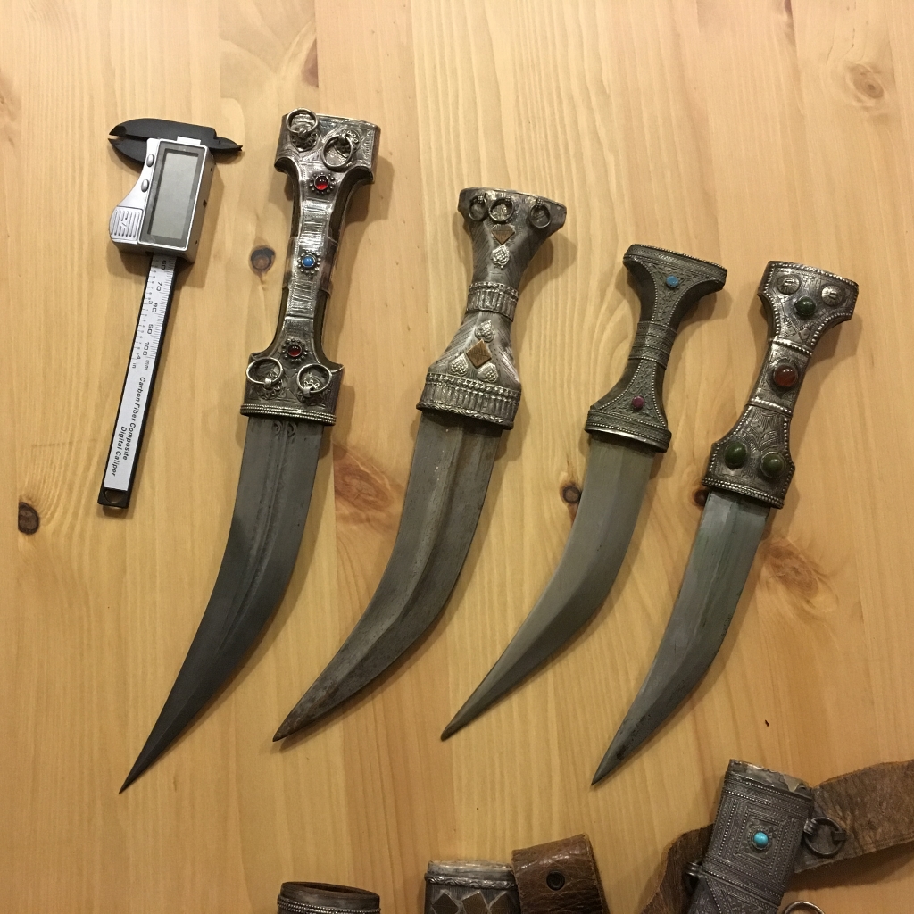

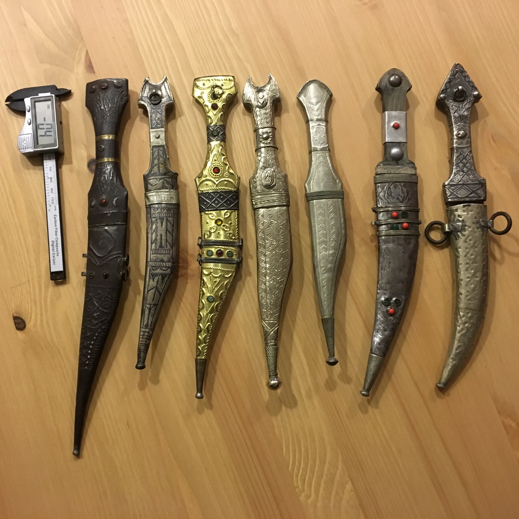

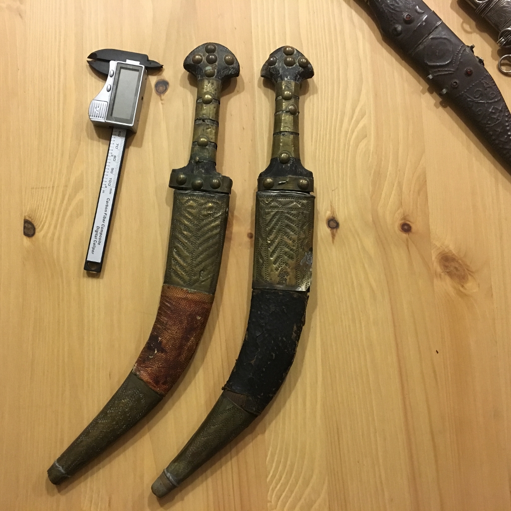

Now, when a shibriya is large enough to be at the size of a Persian khanjar or an Omani khanjar... is it still a shibriya? :-) Something Ariel would like...
Comaprison between multiple shibriyas and other types of daggers. The twins are of Palestinian/Sinai like craftsmanship... and similar craftsmanship is seen in images posted by Motan. The size though surprised me! they are big compared to the usual shibriyas.

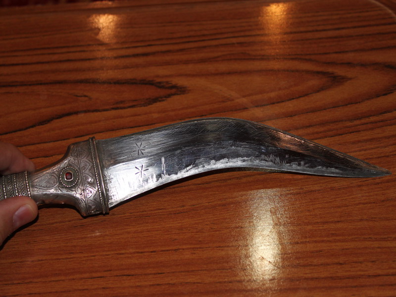

Thanks for showing this great group of daggers with a nice, but puzzeling mixture of traits. You obviously know more than I do about these Saudi Arabian daggers, but I can speculate a bit. To me, the name question is less important as names and categories were made up by collectors to order their inventory and often do not correspond with local terminology.
Wheather made in Mecca by makers from Ha'il, or made elswhere to the north, they definately reflect influences from Jordan.

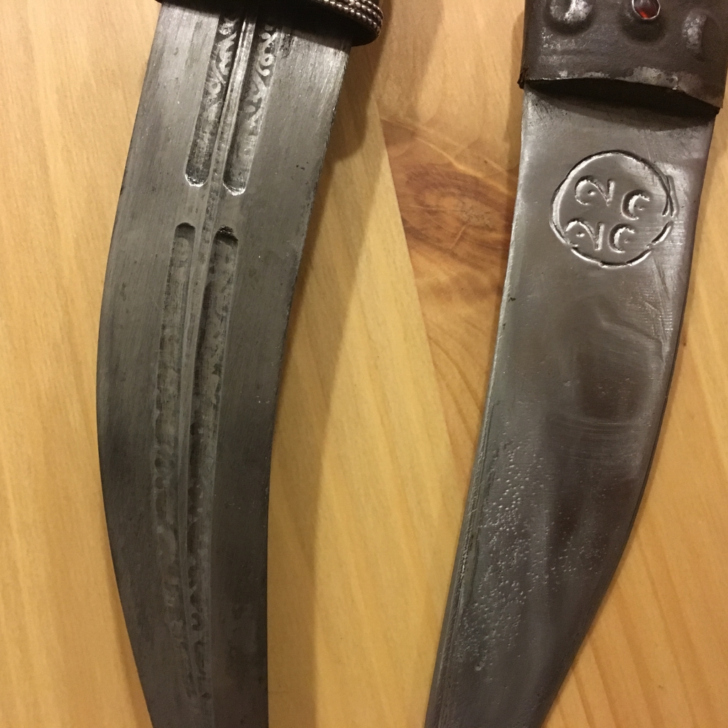

The style of decoration is not Jordanian/Palestinian, but many elements are, like multiple decorative rings, insets of stone/glass beads, central band on the hilt and more. The blades are shibriya (diamond cross-section) without the typical recurve) or Jambiya (second from left) and even show some dharia traits like the fullers on the leftmost one. I would think that this style originates in northern Saudi Arabia. In mecca, it overlaps with daggers and influences from the East (Dharia) and South (Janbiya).
The large, dark shibriya, second from left in your forth picture, is clearly a Jordanian shibriya, regardless the size. I have shown in a recent thread (http://www.vikingsword.com/vb/showthread.php?t=22301) a shibriya of almost 40cm and I am sure that even larger ones exist. The inferior quality of the blade, common in later Jordanian daggers is clearly visible in the 3rd picture.
The "twins" are a whole different story. I have seen several of them recently and I think that they are older than all the rest. Big metal studs are an early feature (see photos in my previous post in this thread). However, as far as I know, they are not similar to early daggers from Sinai or Palestine. They do show very general similarity to Marsh Arab janbiyas, so it is very possible that they are also from northern Saudi Arabiya, or alternatively from south-west Iraq, or even from the Syrian desert.
The last group is all Jordanian shibriyas, as you probably know. Some are early and good quality like the two "horned" ones. The oldest is the rightmost one which has a "normal" curved blade. The scabbard is an old replacement. I actually wanted this one, but the dealer refused to send it to my country. Thanks again. This is an original group that we all can learn from
