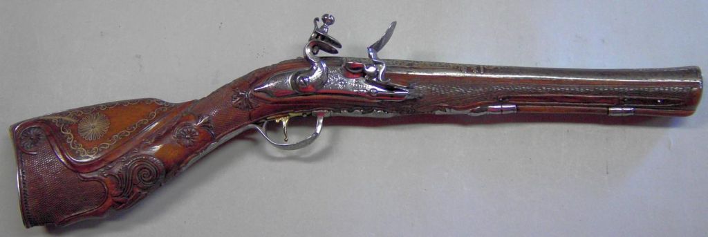

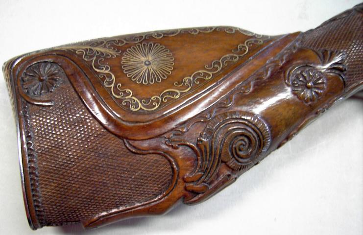

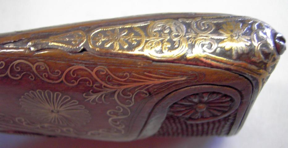

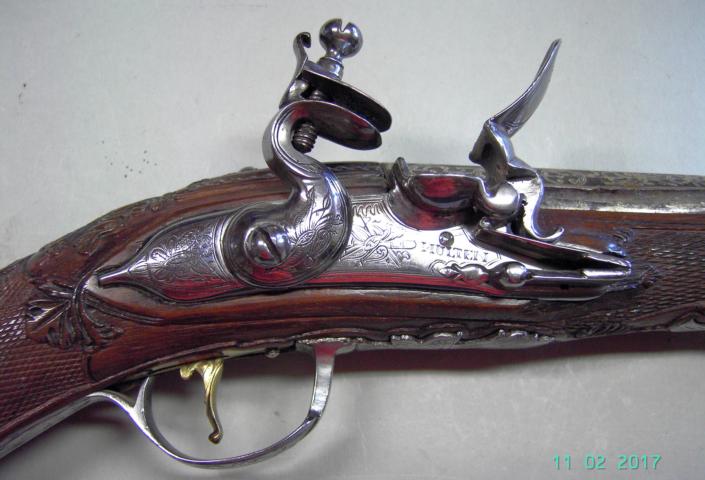

I have in my collection since a very long time this flintlock gun or pistol and I have been all the years without any success in finding out where and when and for which purpose this piece has been made.

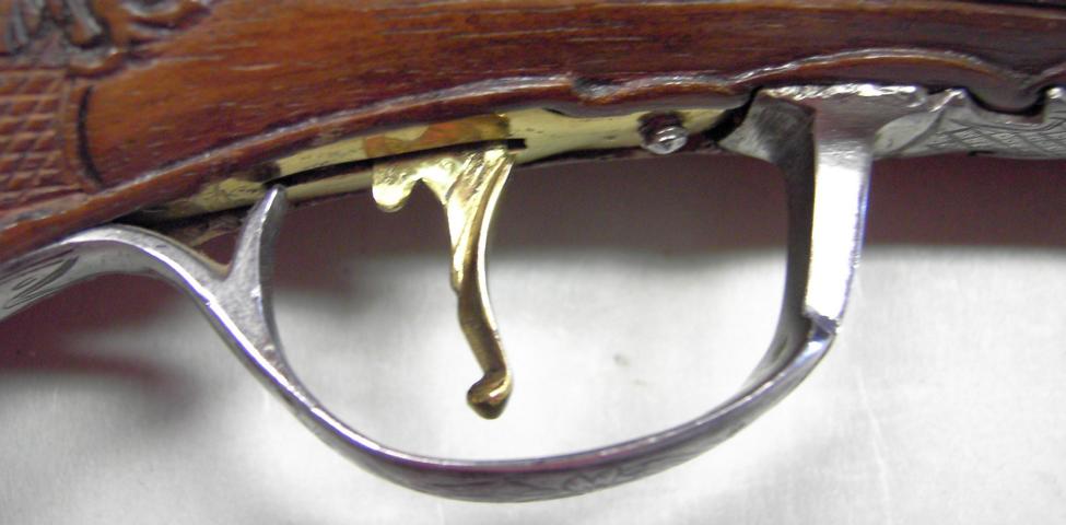

The mounts are probably of cast silver, the trigger and the trigger plate look like Gold, all silver wire inlays are complete and the wood is without any damage.

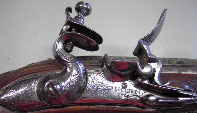

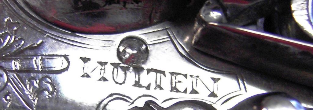

There is a signature "NOLTEN" or "NOLTON" on the lockplate, but the first "N" is written differently to the last one what seems for me to be very strange. There are no marks or stamps on the barrel or the inside of the lock.
The ramrod is not extendable, jus cut into the wood.
Thanks a lot for your attention

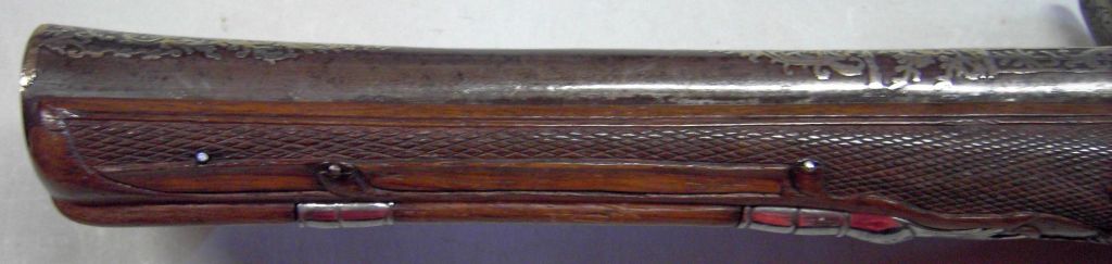

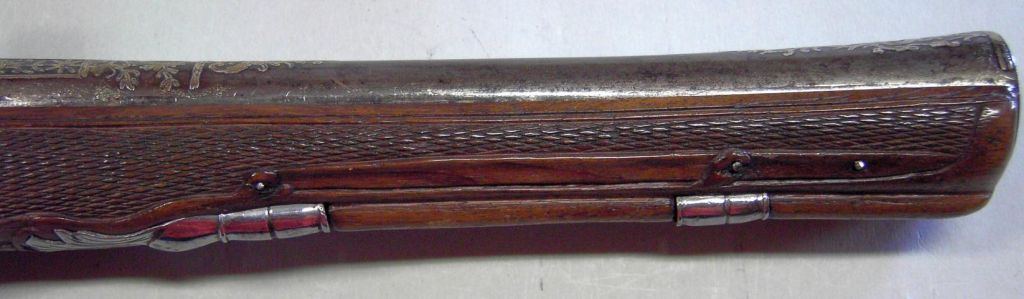

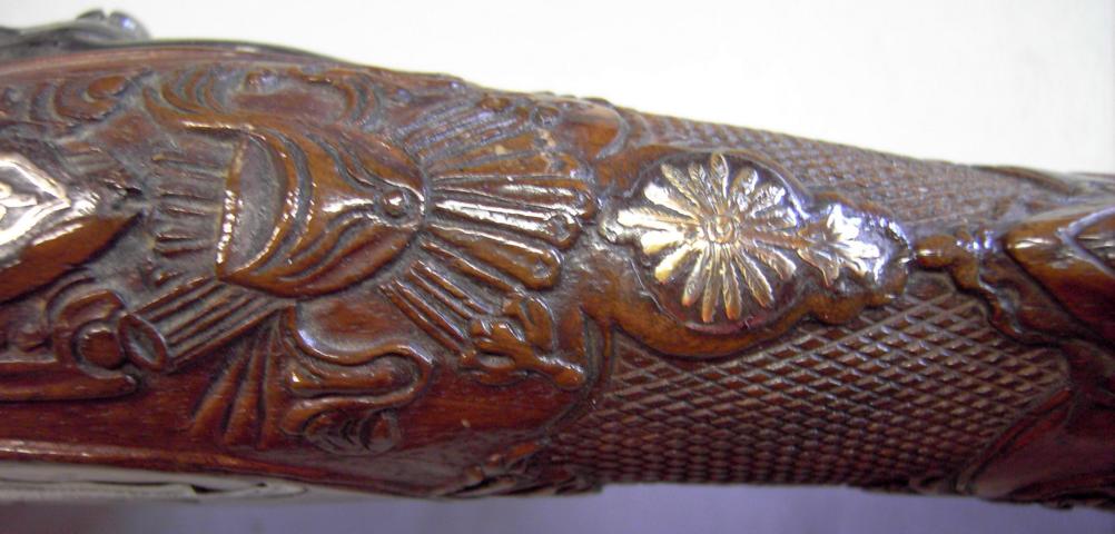

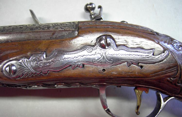

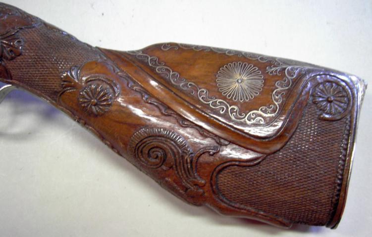

Some more fotos:

I see this was discussed at http://www.vikingsword.com/vb/showthread.php?t=20192 . It looks like an Ottoman blunderbus and perhaps the name is ZULTEN ?

Yes, as above, what we normally classify an Ottoman or sometimes a Turkish blunderbuss.
These appear to have originated in England, with this very short buttstock,
(See GBG 1540 to 1740.... Neil & Back)
This is an early one and Very high quality.
The lock and furniture appear in the style of late 17th C.
Very Nice piece and thanks for showing!

Yes, as you said previously it's an Ottoman blunderbuss.
I don't understand your question as you are clearly aware of this type of gun and flintlocks in general... Strange question unless you have another idea in mind... It's a beautiful piece, Ottoman. Your gun is too nice to be from the Balkans. I think it's a Turkish piece from the late 18th or early 19th c. The name on the lock is an attempt to imitate English locks, many Turkish barrels have LONDON with an inverted N.

Hi Corrado.
Also referred to as Ottoman/Turkish Knee Pistols. The reference being used while on horseback and fired with the butt stock positioned on the knee.
As Richard mentions, it probably originated in England sometime in the 18th Century, but never seemed to catch on. But they were very popular throughout the Ottoman Empire till the early-mid 19th Century. Most of the specimens remaining today (many) were made at one of the many gun making centers in the Balkans. But I agree with Kubur that this one is much higher quality, and probably Turkish made. Probably around 1800. But it looks more early than later. It's probably the best looking one I've seen. Very high quality. And the trigger guard looks to e pinned to the stock (ala European) versus being simply nailed to the stock as the Balkan pieces were.
It's a very nice Knee Pistol. I have a good original 19th Century photo of a warrior carrying one that I'll post when I return home this weekend.
Thanks for posting such a great example.
