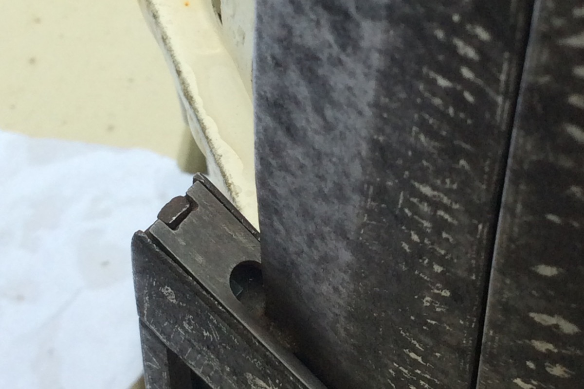

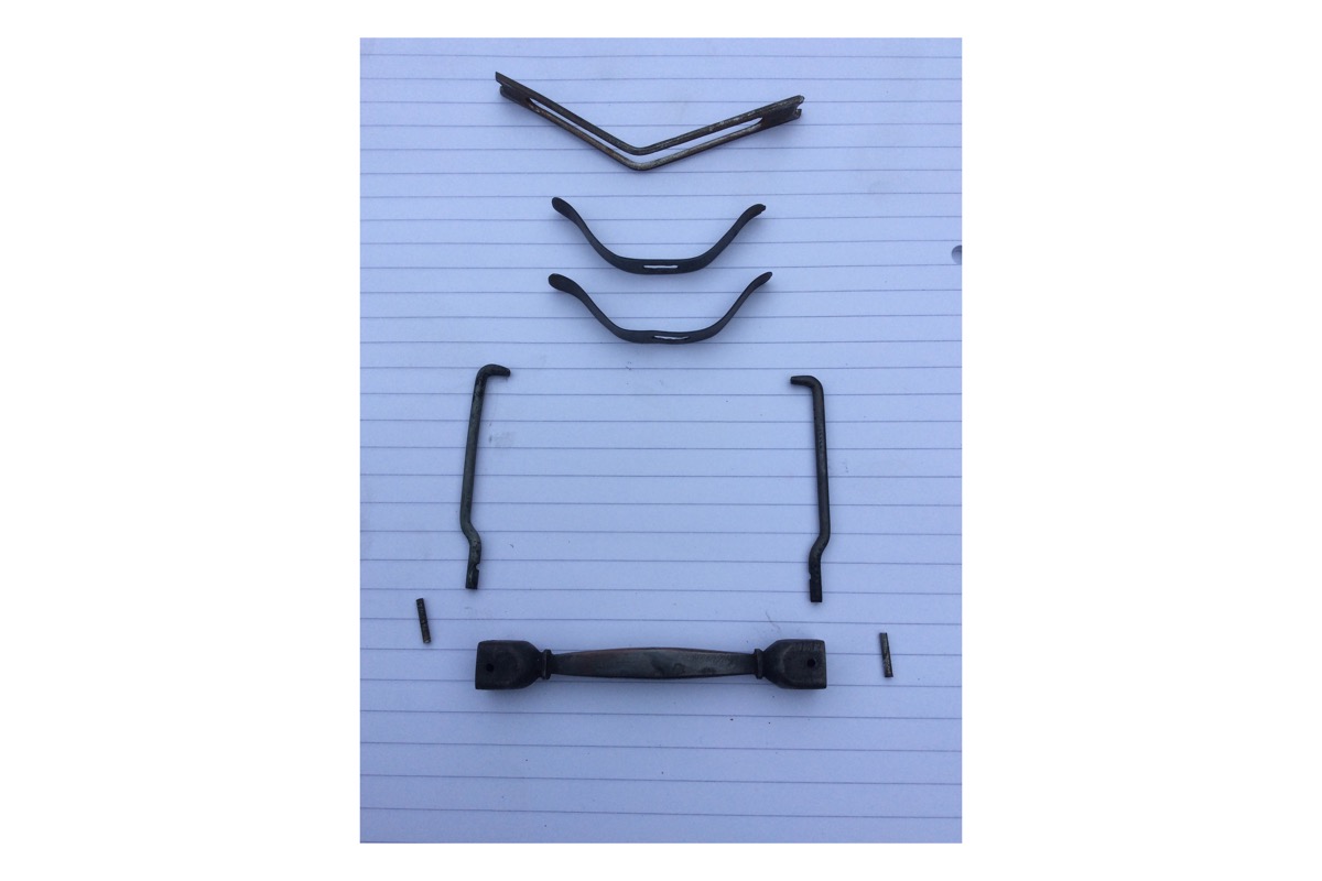

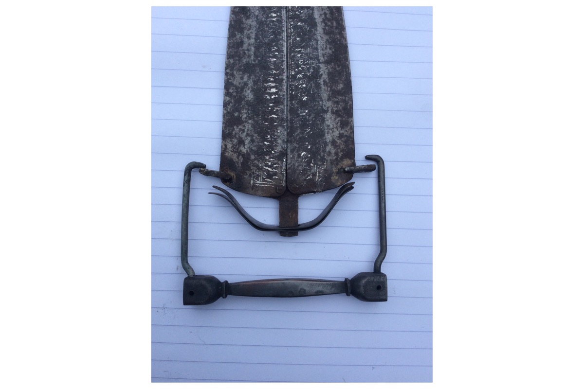

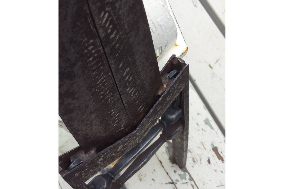

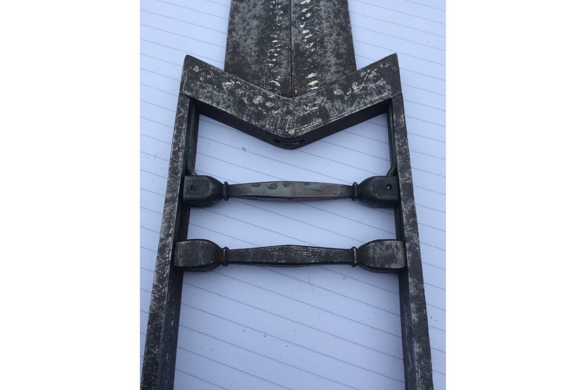

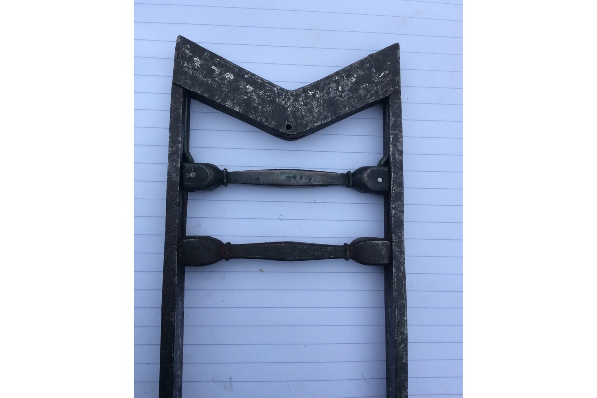

Hi all
Scissors katar project finished
The first picture shows all the new parts I had to make and the follow on's are the assembley stages in more or less the correct order
I taught people might find a series of exploded diagrams showing all the parts of the mechanism interesting and useful for reference
An interesting build and i am happy with how all worked out
Hopefully pictures are in order showing missing parts made and then gradually assembled together
A lot of work but enjoyable

Vandoo you asked about the springs, they were actully the easiest part to make
I cut a hacksaw blade into approx 60 MM lengths
Pre heated a beaker of sand to around 300 celcius
Then heated the blades to red hot and immersed them into the sand and allowed the whole lot to cool down slowly,
This de anealed the blades and made the steel mailable and I ground and bent them into shape of the springs
Them I drilled and ground the slit in the spring to allow the "tang" to go through
Once I was happy with the shape I then heated red hot and quenched in cold water, this then hardened the spring steel but it would be too brittle at this time to use as a spring so I polished the steel, important to do this as you need to see the colour of the metal for the next stage.
Once polished I heated up to blue hot, i.e. The steel was a blue colour and then quenched in engine oil,
Then I had tempered springs,
I made two as I wanted a nice snappy sissors.
