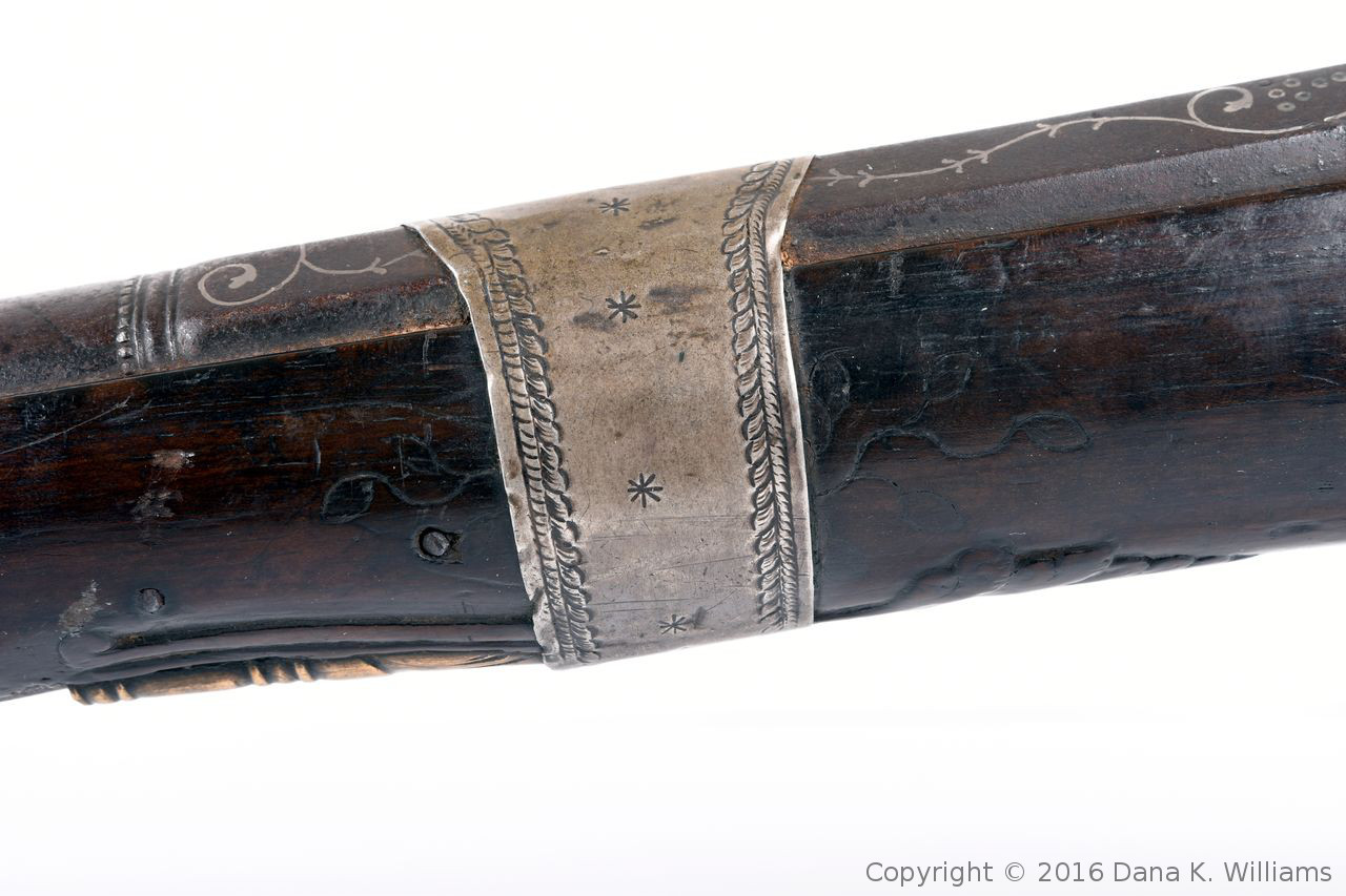

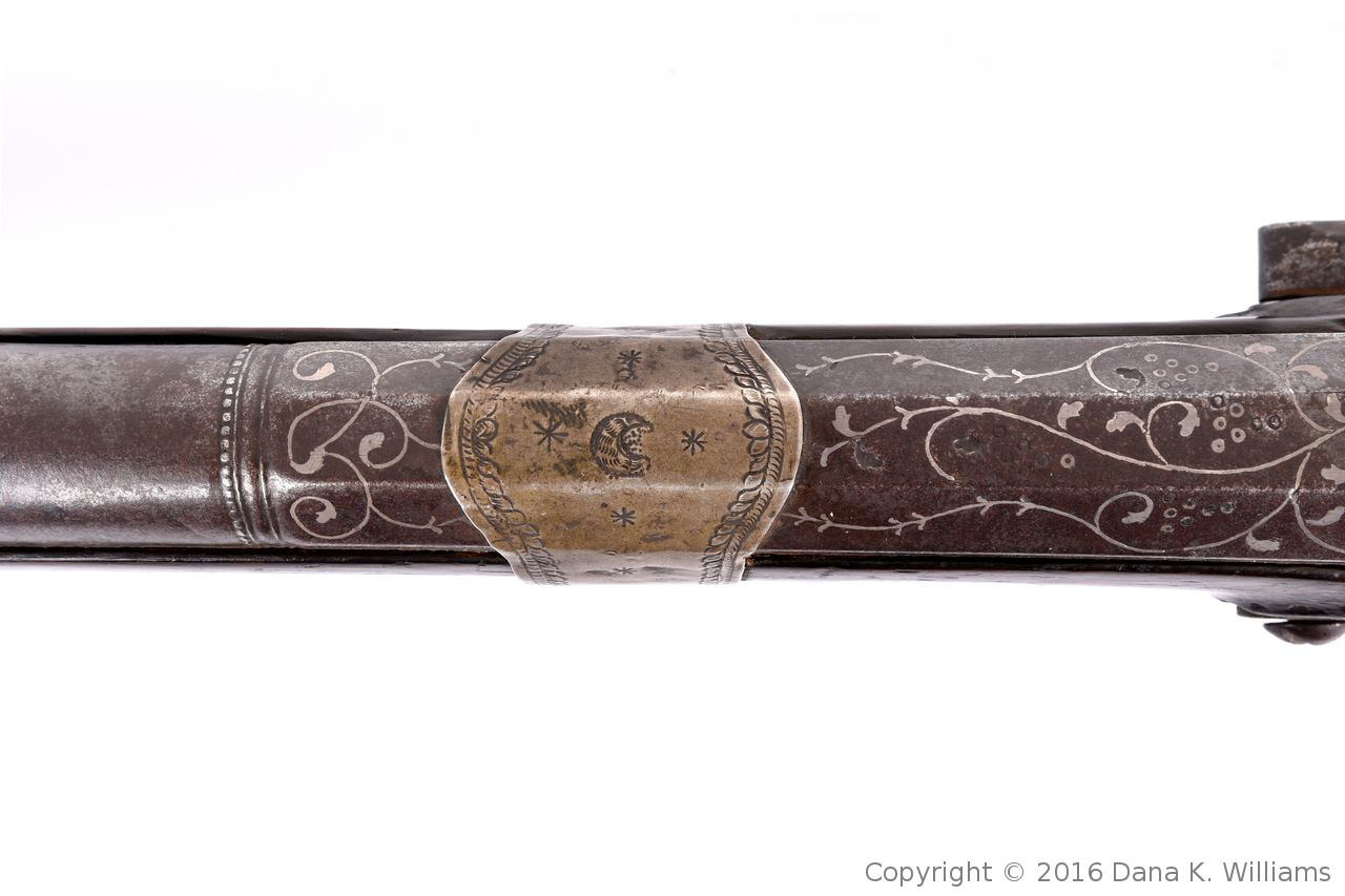

A friend of mine recently purchased this blunderbuss at auction. It was identified as being made for the Ottoman-Turkish market, but I have my doubts. It is 30 ½ inches long overall. The barrel is decorated with silver wire inlays with a inlaid double-headed crowned bird near the muzzle. The lock is marked JOAN.BOP.Y.SALA. The silver barrel band may be a later addition.
I’d guess the blunderbuss could date from as early as the mid 18th Century, but it might be much newer.

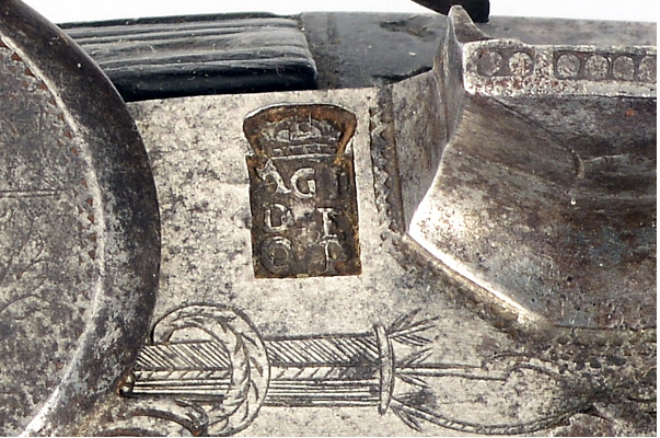

On the other hand, you can not discard the probability that the name in the lock plate was 'invented' to give the blunderbuss a Spanish taste. Also the barrel indeed transpires an Otoman/Tuekish look. Further, the letters on the maker's seal don't seem to match with the name in the lock.

That is a beautiful blunderbuss. And, a most interesting one. Myself, I can't detect any evidence that this was made for the Ottoman market. While it's true that the blunderbuss remained popular in the Ottomans well into the mid-19th Century, it also remained popular in Spain as a private purchase, personal protection gun up to the mid-1800's. There are many examples of Spanish blunderbuss made with latter percussion locks, even after the gun started to fall out of favor throughout the rest of Europe. A lot of Spanish private purchase long arms seem to have a single reinforcing band somewhere along the fore stock. Even though the barrel is pin fastened to the stock. Might be just for decoration (?). And the barrel on this one looks pin fastened. Also note the single sling swival for a shoulder sling to hang vertically down the side and hidden under a cloak. The ramrod grooves and ferrels look as though the gun may have originally come with a wood ramrod, with an iron one added later. The butt stock style and trigger guard scream Spanish to me. Even the carvings on the stock look very European. Nothing like you see on the Ottoman/Turkish exports. The lock looks a little similar to the 1757 Spanish musket lock. But it has a more straight (vs banana shape) lockplate and a brass pan. Brass pans were normally associated with the last part of the 18th Century onward. But with a private purchase gun, who knows. Also, the engraving on the lock with the boar's head and flags look decidedly European. Even with the silver inlay on the barrel, the engravings don't look generic Ottoman. They look European of some sort.
It's interesting to note that the Spanish military utilized the miquelet lock up until about 1750, where they changed to the French style of flintlock. Then, changed back to the miquelet style of lock around 1790. But in the case of private purchase guns it could have gone either way at the customer's descretion. So, in dating this piece: Hmmmm. Tough call. I would guess this was a private purchase piece from around 1800. Maybe a bit before or after. It sure is a nice looking blunderbuss. Would not mind having it in my collection. LOL

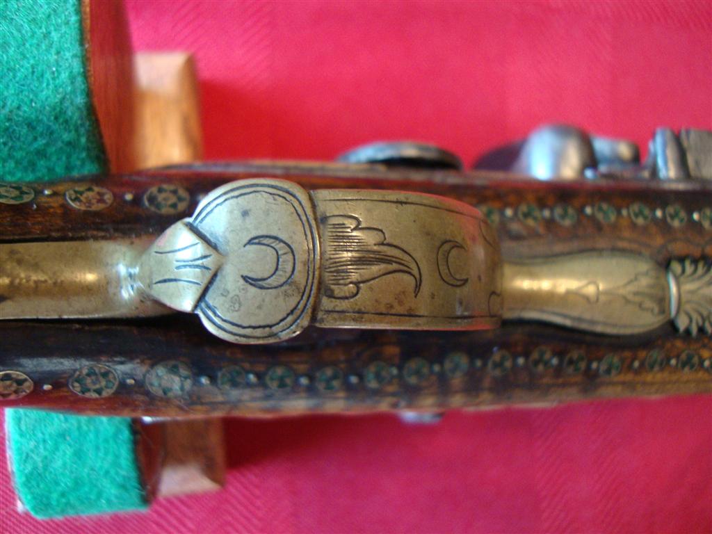

Rather pertinent points raised by Rick. I took some time to search for the name in the lock, which postponed my additional post in that i was going to comment on the swivel sling hook and the stock profile, the first very much the European style (Spanish and Portuguese as i recall) and the second also Iberian style ... that not the typical 'boot shaped' often seen in Catalonian 'trabucos'. However the name JOAN in the lock has a Catalonian spell; Castillian would be JUAN. I can find no name or tanslation for BOP; it just sounds strange.
I am not enough within this subject but, my doubts would remain about the general decoration. Is it a crescent moon on the barrel band ? In all this band doesn't seem to me a typical Spanish addition; but i wouldn't stand to oppose Rick's impressions. However i tend to be influenced by a determined taste that Turkish/Ottoman (and not only) have to give an European touch to (imported) guns.
