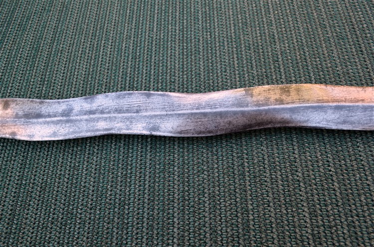

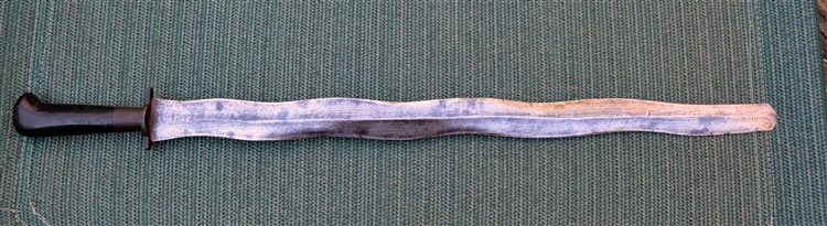

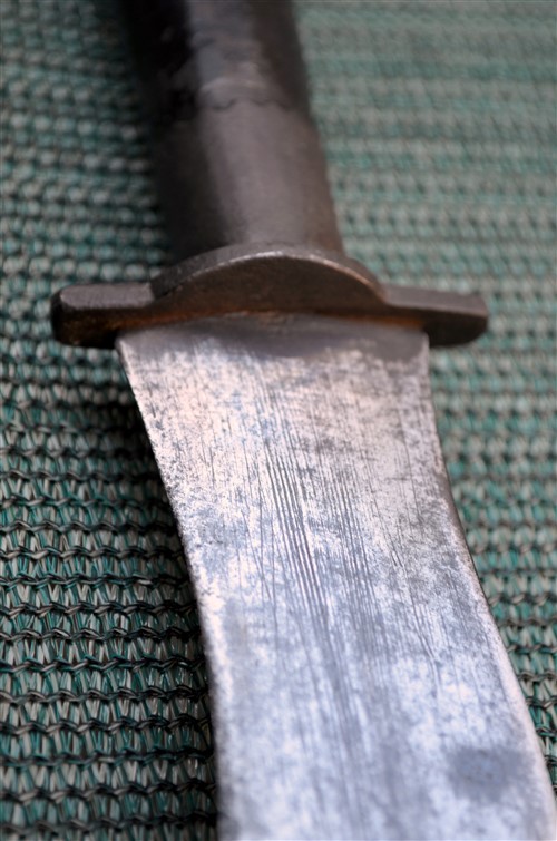

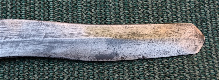

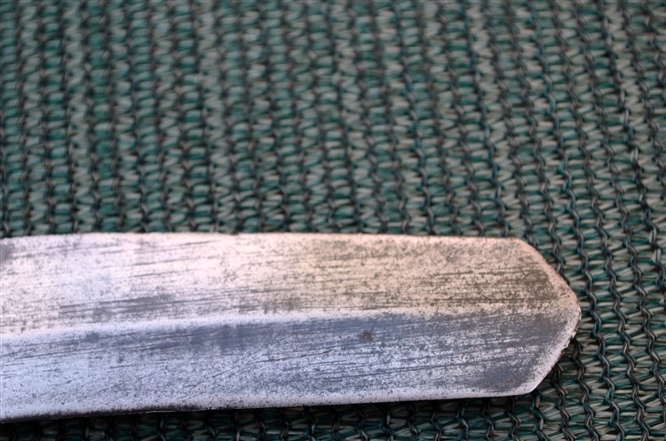

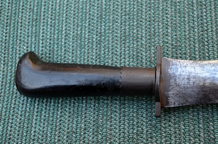

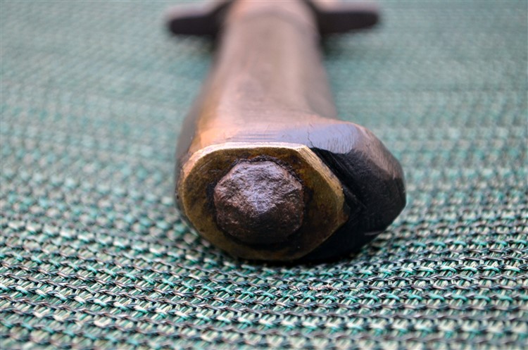

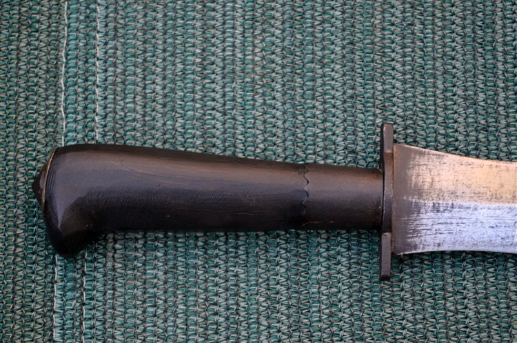

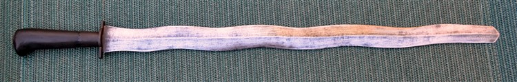

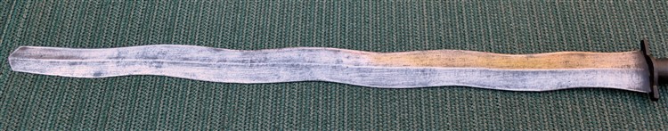

When I first bid on this sword, I thought someone had boxed the end and I would re-tip it, but now I'm not sure.The tip is not blunt, but it has a sharp,tapered edge.It is a heavy, sharp,26" long blade(1.75" wide at the base).The handle measures 5.5" long and is made of horn.It certainly feels like it would be very effective for slashing or chopping.
My question is has anyone seen a philippine sword with a similar end.Could the end have been reconfigured to become a lodge sword, or could it be like the German "Sword of Justice," with a boxed end , a symbol of status and justice ?
Any comments would be appreciated

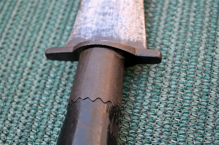

Hello Drac:

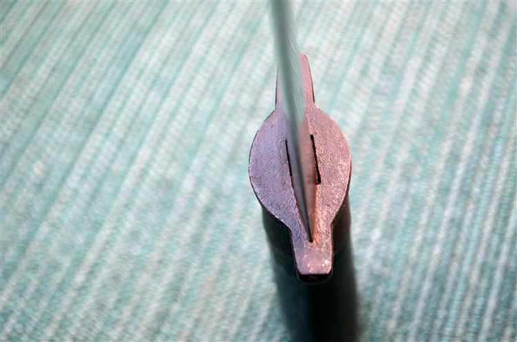

The full tang hilt treatment looks Luzon in origin, but the shape of the hilt and ferrule are atypical. The small cross guard looks a little like Ilocano work (N. Luzon) but hard to say from the pics.
The blade is not something I recall seeing before. This looks like a one off, custom made piece--or perhaps from a blade with a broken tip. A "flambé" style of sword is unusual among the Tagalog people, but there are a number of examples to show that it is not rare.
I know of no particular significance among the Filipino cultures for a blunt ended sword such as this one.
Ian.

Thanks for your insights.My dilemma is should I change the tip to the way I think it should look(in the fashion of a sundang), or leave it as it is; as you say, I am not aware of any Philippine swords in this fashion either.The tip, while not pointed,has an edge sharp enough to cut.

Has anyone considered that the tip may have been reconfigured to suit local colonial ordinances.

Interesting point, but if that were the case, then shouldn't we have seen other examples ?
This is a Tagalog sword, so strictly speaking it is not a sundang. Personally, I think it was made this way (for whatever reason), and you should leave it as it is.
As to Rick's question, I don't think the tip was altered to meet some regulation or decree. This sword post dates the late Spanish colonial period when such regulations were in place. I think it was made post WWII based on the ferrule and hilt, perhaps for a GI stationed in Central Luzon.
Ian.

Thanks for the input Ian, I will not alter it, however, I don't think that it is WW2 or later(I certainly could be wrong).The sword is not a "souvenir type fabrication" as it isn't particularly fancy or gaudy, or dated or named.It is too long and heavy to be used for anything other than fighting; it is very well balanced and made.The serpentine curvature isn't sharp and cut out, but appears to be forged.The ferrule and the guard are iron, not brass or aluminum which are much easier to work with and usually found on souvenir pieces. When I got this item it was dark with rust and as I was cleaning, I could see traces of an old museum number(or so I thought).
I do agree that some U.S. soldier probably brought it back.
My best argument is that it is too ugly for anybody but a collector to want.

I agree totally with Ian. In fact, I would even say that a wavy blade itself is not typical for a Tagalog blade. Yet I can't consider this Ilokano either since the midridge doesn't follow the waves.
And then there is the old blunt end - atypical of anyone except a janap in the Moro lands.
