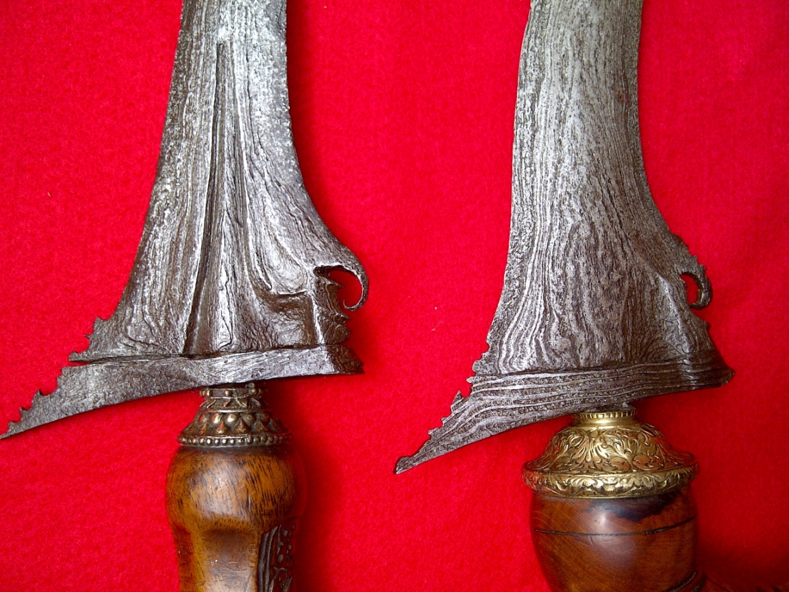

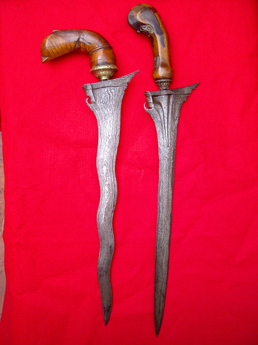

Friends, I realise you might think I am embarking on a folly here, but please bear with me. As you already know, I have these two kerisses, a Javanese one and a Bugis from the Straits/Riau areas. Please see the pics, which I hope I have taken and arranged in a clear & big enough form. The question I want to ask you does not revolve around monetary value, neither do I require a valuation of any sort. But I do want to know something about the "worth" of these two items in comparison to one another. By "worth"-comparison I rather mean something like:
1 As genuine antique kerisses they are cultural items which I as their curator must conserve and protect, but can you collectors with knowledge and experience far superior to mine, discern that one of these two might be older than the other? It does not satisfy that I am guessing they are both "mid-nineteenth century". They are too different and not deserving to be simply clumped like that.
2 Would collectors as a group be more inclined to collect or specialise in kerisses of Javanese origin? Or would more collectors be inclined to go for the more ornate hilts of the Bugis-type kerisses?
3 Would the fact that one of my kerisses has a wavy blade, make it more desirable in the eyes of the average keris collector? And in the eyes of the people of keris culture?
Perhaps there is another aspect of keris comparison that I have missed...?
Johan

Hello Johan,
I'd suggest you are trying to compare apples to oranges here: Both were done in different cultures with different aesthetics - thus, they are bound to look different even if they happened to be born on the same day.
Well, Alan originally set out to collect all keris - happily, he slacked off sometime during his project and left a few for us to play with...
I'd venture to guess that this mainly boils down to personal preferences and/or chance (like being born into a given culture or traveling to some region first, etc.). There may be many reasons one could think of to rationalize on our individual choices; while this may be fun, arguing about preferences won't help you - just keep collecting what you like to live with! (And do leave a few keris for us... )
The latter would heavily depend on which culture someone belongs to! I'm fairly sure, there is no average collector out there either!
Collectors in their early phase may be kinda driven towards wavy blades since they are looking more exotic. After a while, most avid collectors realize that quality is much more important than any detail like wavy vs. straight, age, you-name-it. However, how to judge quality is another can of worms or two...
I believe that it would certainly be worth trying to get both keris into an acceptable state for the culture of origin: The keris Jawa is complete but certainly needs warangan treatment to show all pamor details. The other keris will need more effort to complete its fittings but will certainly be worth it; it may also be a good idea to clean and etch the blade with vinegar (possibly several times to get a good finish).

Once again Johan, good and relevant questions, and Kai & David have given you good and relevant answers, as far as they were prepared to go.
You have asked several questions and I will try to answer those questions independently.
1) " --- one of these two might be older than the other? ---"
It is very difficult to put an age on any keris. There is a system in Javanese Keris Culture that purports to offer a method that can assess origin in terms of time and place (tangguh) but as its name implies, it is a system based in opinion, not in fact.
I have handled a great many keris that were taken out of S.E.Asia several hundred years ago, these keris were for the most part in "as new" condition. Considering only the blades it would be close to impossible for me to date these blades were they to be presented to me without any prior knowledge of the specific keris.
Only the blade is regarded as the essential component in the complete keris, only the blade is the keris, all dress items are just that:- dress, thus it is only the blade that we seek to date.
2) " Would collectors as a group be more inclined to collect or specialise in kerisses of Javanese origin? Or would more collectors be inclined to go for the more ornate hilts of the Bugis-type kerisses?"
Collectors in any field are as diverse as the things they collect.
With keris, personal preference varies from "everything" to, in some cases, something as narrow as only one type, style, or maker.
With the pure collector of keris, even though his preferences may vary, his basic philosophy is completely analogous with any other collector, say for example a collector of stamps, or coins, or sea shells.
However, some people who may collect, are not necessarily collectors as such:- the act of collecting is only supportive of some other objective. Using myself as an example, I started out as a non-collector, simply a custodian of a collection, I became a collector, then after I began to acquire some core understanding of what it was that I was collecting, my active collecting tapered off to an almost invisible involvement and became only one factor in a sociological/ anthropological quest for understanding.
It is probable that all of the people who are truly knowledgeable in the field of the keris have followed a similar route.
But of course, this extreme involvement is not required to simply collect, most people derive their pleasure from the object itself, and just as Kai and David have pointed out, some of us like oranges, some like apples, and some cannot get enough of either.
3) " Would the fact that one of my kerisses has a wavy blade, make it more desirable in the eyes of the average keris collector? And in the eyes of the people of keris culture?"
I don't think we can define desirability in terms of wavy blades and straight blades, this is simply not relevant either for people within a keris bearing culture or outside one.
For the pure collector there are probably two basic things that regulate desirability:-
A) difference, as in a style, form, age or whatever that is different to what that individual collector may already have
B) quality, this is something that we can learn and quantify, and it has nothing at all to do with either rarity or wavy blades
However, since the keris is above all else a socio-cultural icon, other factors can determine desirability for some people.
As an example only, I had a relative in Jawa who had a collection of keris, all of which contained the spirit of either a Pangeran (prince) or a Kyai (a respected or eminent man).
How did he know this?
If he bought a keris that he thought might contain a spirit he slept with it and the spirit came to him in a dream. No visit? Get rid of the keris.
So desirability is very much a matter of perspective.

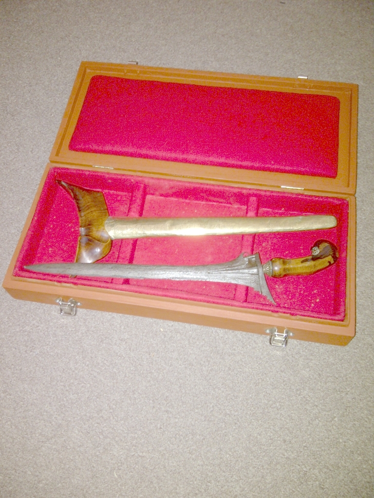

Friends, in concluding this thread I take pleasure in sharing with you a pic of the box I made for my Javanese keris and sheath. Although I am not a carpenter and do not have proper tools, I have enough to allow me to do this sort of thing. It was not easy, and I found I was hard to please! The box itself came out satisfactorilly the first time round, but I had to redo the inner case and red cover material, as I had gone about it the wrong way and it sucked. The pic should show that the job came out tolerably well. Still, I suppose the contents would have been deserving of a much nicer box!
The Bugis keris will get an identical box and innard, but first I will have to make a wrongko for it, and a buntut.

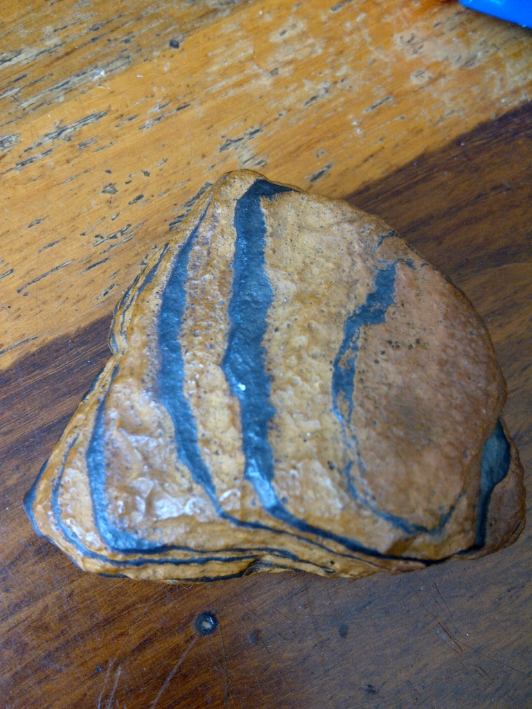

Now the final two pics....... dare I say here will be something to whet your appetites and lead to another bit of stimulating conversation? We know that keris blades are made with a pattern we call pamor, and that the easier pamor to accomplish is the form we call mlumah. We know the definition of mlumah. We also know what pamor miring is, and how it differs from the former. Now where do shapes similar to pamor mlumah and miring occur in NATURE? See the two pics for one possible answer.
Banded Ironstone is a sedimentary rock consisting of alternating layers of iron oxides and shale. I've had this sample in my possession for a long time. In the pics the layers are but millimetres in thickness. It seemed to me to be a natural representation of the patterns that had been crafted by the empus. The one pic shows the rock sample viewed from the top, as in "pamor mlumah", and the next viewed from the side, as in "pamor miring".
This observation struck me as being quite interesting, and perhaps worthy of sharing with you guys. Whether you agree, remains to be seen, but I have confidence.
