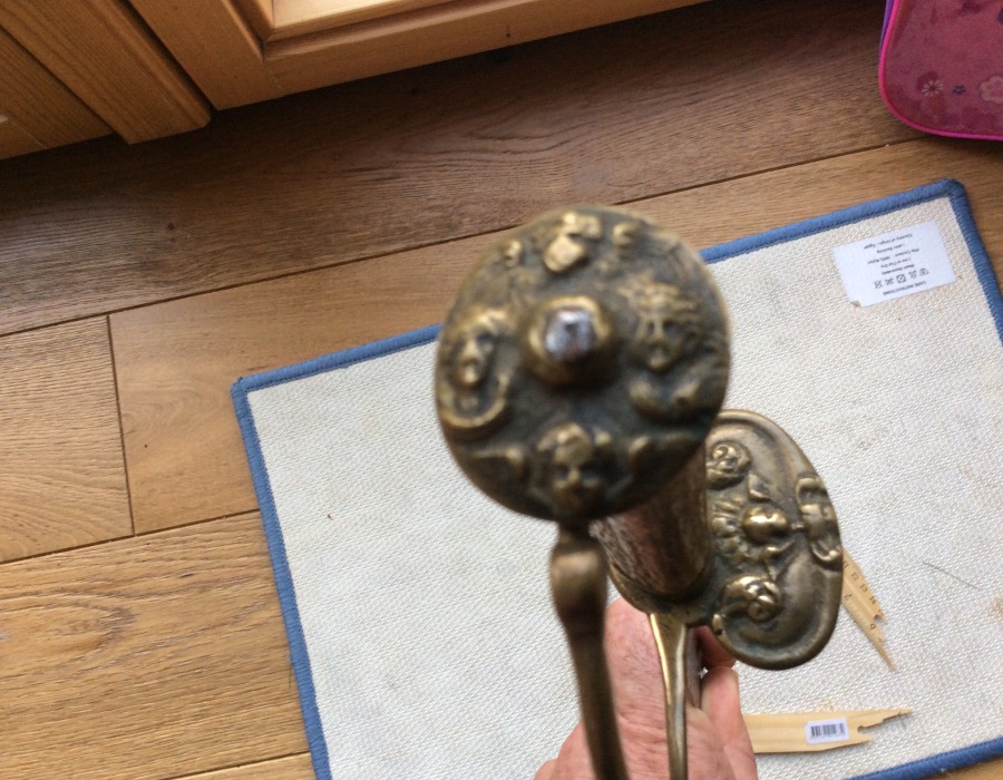

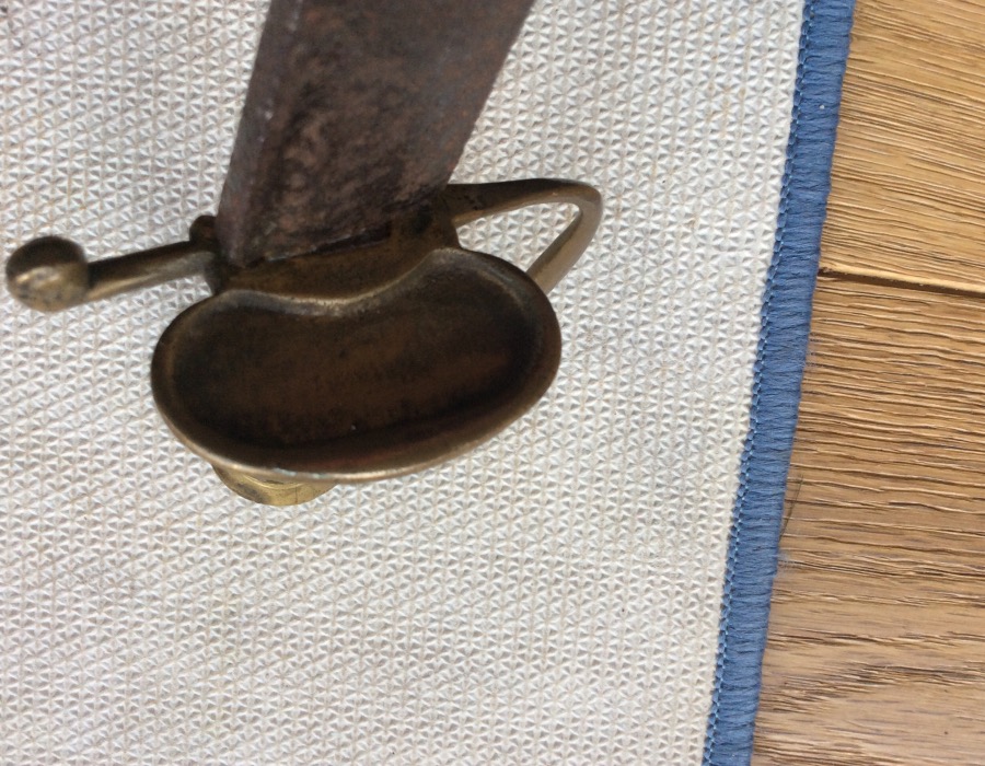

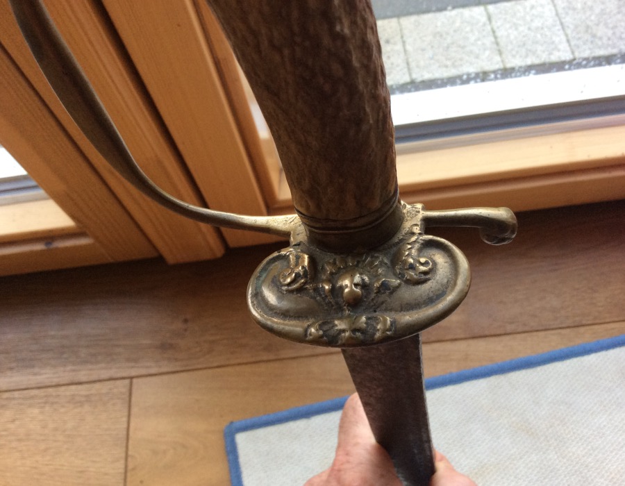

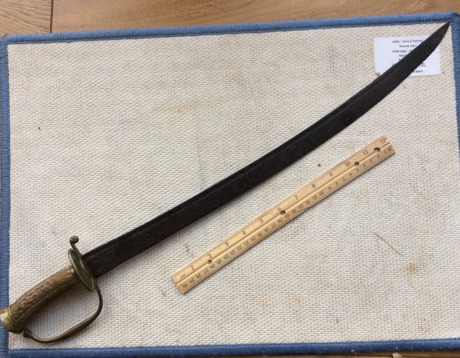

Hi
I just purchased the below hunting hanger at a local auction in rural Ireland
Blade and handle are very solid with no movement at all, feels very much an original purposeful weapon
The blade was very rusty and covered in grime but I cleaned all the active rust off and am pleased with the condition underneath
Overall blade length of 21 inches with fuller on both sides

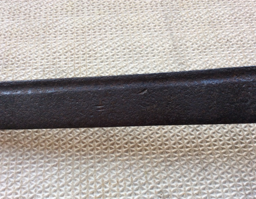

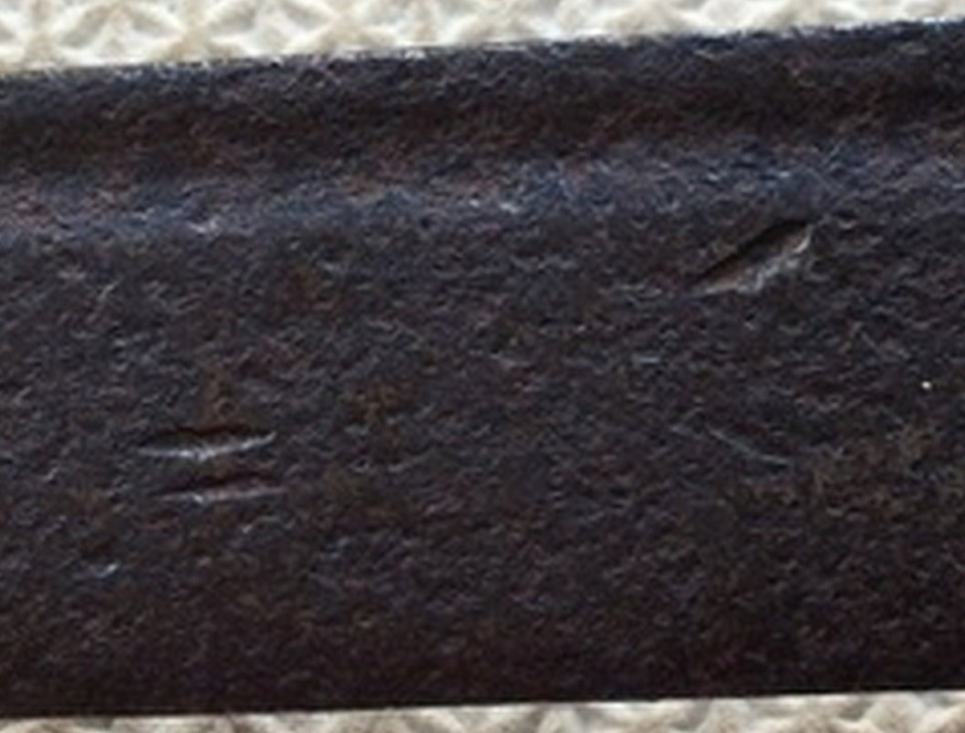

I think there is the remenants of a passau wolf mark on the blade but this may be wishful thinking, I would welcome any opinions

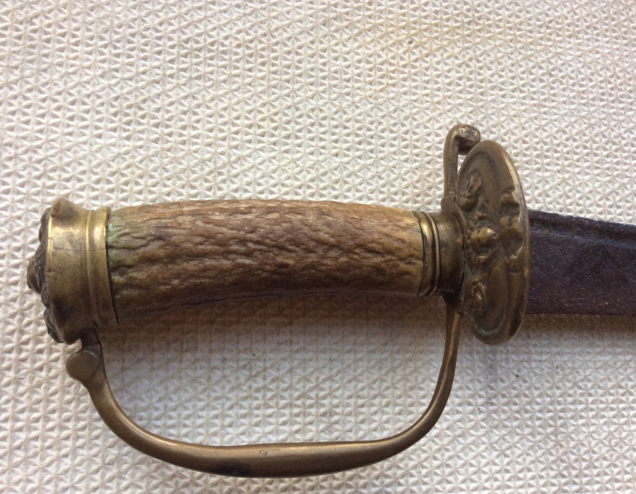

The handle is in very good condition and the brass is nicely toned
There seems to the heads of three angels or cherubs on the shell guard and a heart with wings which I take to be the sacred heart which is obviously a Christian symbol.
Pictures are poor as it is pouring rain and no natural light but I can try again tomorrow if necessary.
My big question would be could anyone give an approximate age on this hanger
Much appreciated
I have amended title as per information received below

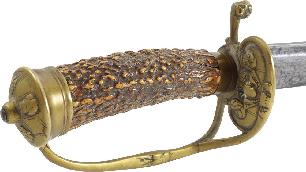

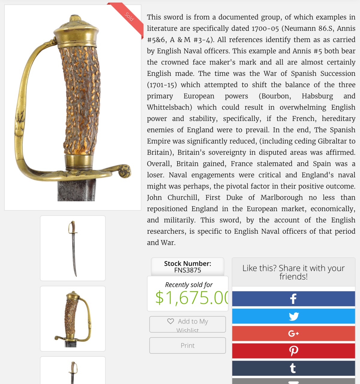

Fagan arms just sold one very much like this. Can I link to the sold sword mods?

Wow, that was impressive Machinist
Very similar indeed right down to the cherubs
Price is a lot different though from what I paid
I now have a search route to find out more, I was looking under German hunting hanger.
I will report back with any findings
Thanks a bunch

As per information received I have pasted in the image referred to in Machinist post.
Would anyone have a copy of either the texts referred to in Fagan Arms descriptor of items sold.
The likeness of the two hangers in very strong but I would love more information if possible.
Many thanks

As stated, an early English hanger circa 1690-1720. The king's head and crown are actually the mark of the Wundes smiths of Germany, who supplied fine blades to the English at this time. Every one of these I've seen marked have that king's head.

Here's mine, a variant style of the same type of hanger. Although very popular with naval, they were also used by infantry at the time. Note the references I mention in that past thread, if you wish more info and pics of these cool hangers...
Also note in that earlier thread the excellent info from Jim McDougall and Dmitri.
http://www.vikingsword.com/vb/showthread.php?t=17233

Very nice Ken, and I am sure you got the wolf mark right. Certainly looks like it to me anyway.

This is an extremely nice 17th century example of these hunting swords or hangers, which were not only used for hunting, but often carried by officers in various units particularly auxiliary and yeomanry among others. Naturally these are well known in naval service for their ideal size.
It must be remembered that 'hunting swords' were an extremely 'fashionable' weapon, and the reason so commonly interspersed between 'hunting' and 'military' use is that officers were of course gentry, and the hunt was a status oriented event.
As Mark has well noted, the period for this is likely as stated, 1690-1720, which places this nicely in piracy's golden age, arrrgghhhh!!!
I would note that the cherub motif is well described in the fantastic book on British military swords of this period by Stuart Mowbray.
If there is indeed a running wolf on this blade, the potential for this being a Shotley Bridge hanger is heightened as they were producing hangers in this time often using the running wolf. Solingen by this time had somewhat ceased the running wolf, curiously about the time the expatriate Shotley makers were using it.
The running wolf ended with the close of Shotley Bridge early 18thc and was not seen again until Samuel Harvey started using it with his SH initials c,1750.
The Wundes kings head was widely used in Solingen and it seems in equally wide variation as well as number (often in twos, threes and fours).

good catch, ken.
saw that one for auction online, almost bid on it except they did not offer a packing/shipping option and i didn't feel like tackling arranging that myself internationally. kinda damp drive from here to there anyway.
there does seem to be a wolf on the blade in the photos. i see front & real legs, tail, and a very vague head, back line & lower body line.

I had forgotten about Shotley Bridge using that running wolf mark, as Jim pointed out. I remembered Harvey and the early Passau wolf mark as we've discussed it on previous threads. I actually had never seen one of these types with the running wolf, most being unmarked or the Wundes king's head.
