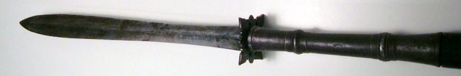

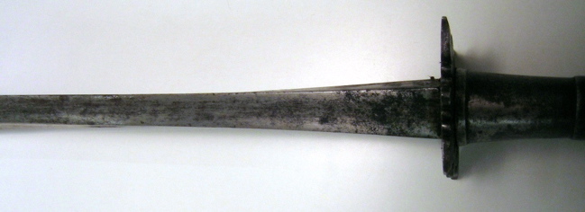

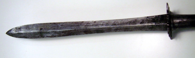

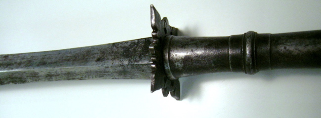

Hi all,
I found this spear last Spring but haven't been able to identify it.
Honestly at first I hoped it would be Malay or Sumatran but after some research I don't think so anymore.
Hopefully some of the forum members recognise it?
Is it Siam, Vietnam or...?
As you can see the lower end of the spearpoint, just before the tang, is square.
Old 5th March 2006, 05:36 PM   #2
WOW!! A VERY NEAT SPEAR/LANCE, UNFORTUNATELY I HAVE NO IDEA WHERE IT MIGHT HAVE COME FROM. THE SPEAR POINT DOES APPEAR TO BE MADE FOR PIERCING ARMOR AND THE WAY THE SHAFT IS MADE IT LOOKS LIKE IT COULD BE GRIPPED SHORT OR LONG FOR A STRONG THRUST. IS IT LONG ENOUGH TO BE USED FROM HORSEBACK OR CHARIOT? I WOULD SAY IT IS MOSTLY FOR THRUSTING NOT FOR THROWING THE GAURD ALSO KEEPS IT FROM PASSING CLEAR THRU SO IT CAN BE QUICKLY WITHDRAWN FOR MORE THRUSTING. I HOPE SOMEONE MORE KNOWLEGBLE CAN TELL US WHAT IT IS, PERHAPS A UNUSUAL FORM OF CHINESE OR JAPANESE SPEAR ,BUT I HAVEN'T SEEN ANYTHING LIKE IT. PERHAPS SOME CLOSE PICTURES OF THE SHAFT OR BUTT AND OF ANY DESIGNS WHOULD HELP GET A POSITIVE ID. GOOD LUCK
Old 5th March 2006, 06:09 PM   #3
Posts: 6,019
Fabulous! Could this be European? Could this be some kind of hunting or boar spear? Maybe Indian. It certainly looks heavy enough to be used mounted on a horse. I think it could be European, I will add a picture shortly. This picture got me thinking European or Anglo/Indian sort of area. The haft is so far away from the Malay/Indonesian spears I have seen, not that is a lot. This hunting spear is 18th cent? Tim

With a pole in bamboo.
I do not think that is European . vietnam ? china ? it is oriental!

Old 5th March 2006, 07:42 PM   #5
Posts: 6,019
Is the haft bamboo? I have seen 19th cent British cavalry lances with bamboo hafts. The stop at the base of the blade looks a bit European. Tim

I don't know why but the triangular cross section (does the spear have a triangular cross section? - in the pictures it appears to have one) and the shape of the blade reminds me of the Japanese Yari.

Old 5th March 2006, 10:05 PM   #7
Titus Pullo
Titus Pullo's Avatar
Posts: 123
I quite positive that's Siamese. The gurad on the spear is typical Siamese design. But I could be wrong.

Old 5th March 2006, 10:09 PM   #8
Andrew
Andrew's Avatar
Location: USA
Posts: 1,725
I think this is continental SEA as well. Thailand, or possibly Vietnam.

Possibly! But the guard is a typical and very common Siamese design. You will find that kind of flower like shape on temple walls, painting, carving, and just about anywhere if they can fit it in. that's why I really do think it's very Siamese.

Old 6th March 2006, 06:39 AM   #11
PUFF
Join Date: Feb 2006
Location: 30 miles north of Bangkok, 20 miles south of Ayuthaya, Thailand
Posts: 224
Definitely Siamese, native name is "Hawk". Mid Ayuthaya to early Rattanakosin (200-400 yo). The guard and blade shape indicated that the spear is footman's weapon. The square guard called "Chenk" should be loosely attached to the pole and can be freely rotated. But it 's possible to get ones are rusted or glued to the pole. The leaf-shaped blade was forged from a square bar. In your case, I noticed folded steel blade which indicates that the spear might be as old as mid-Ayuthaya period.
The pole made from specially cultivated Bamboo stick, which was carefully pruned for years. That means the bamboo was "born to be" a spear pole. This spear is a museum quality one and I 'm very glad that it is under posession of a good collector.

Old 6th March 2006, 07:21 AM   #12
Posts: 6,019
Indeed !!

VVV
VVV's Avatar
Posts: 1,637
Thanks for all the help in putting an ID to this spear!
It's also great to have a reference picture and thanks to PUFF for the further description.
The "Chenk" is a bit loose and can be rotated.
The bamboo pole/shaft is impressingly strong so it makes sense that it was cultivated as you described.

Old 8th March 2006, 08:37 AM   #17
PUFF
Join Date: Feb 2006
Posts: 224
Dear Andrew, There are two major constructs for Siamese spears. The first one is "Hawk" (or Horg), footman spear. The blades were forged from square iron bar and attached with a square guard (spear #1 and #4 in my 1st pic). You may notice thick square cross section 's left at the shaft-end of the blade . I think this profile 's designed for stab & twist.
As you may already know, traditional weapons were tailer-made. Lenght of each spear is usually about arm-rised height of the owner. The shaft can be wood or bamboo with no or little tapered toward spear 's blade.
Calvary units use another construct, called "Tuan", for their spear. Profile at the shaft-end of the blade is round. There is no "Chenk" but there are globe(s) on the ferrule with a set of tassel right above one of the globe. (see spear #2 and #3) "Tuan" 's shafts are longer then "Hawk" and can be tapered toward both end.
