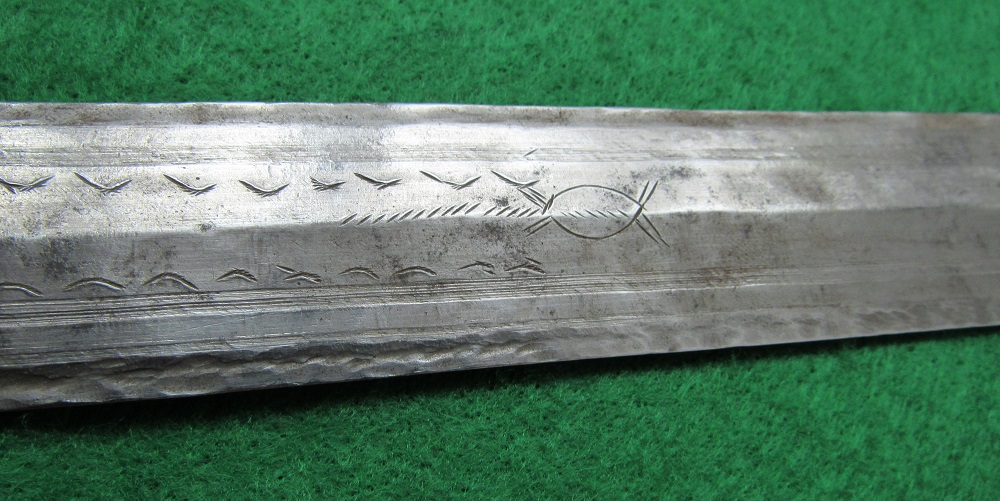

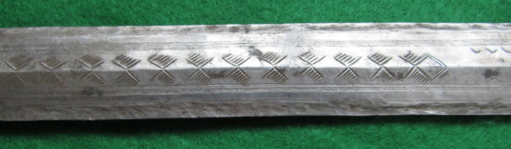

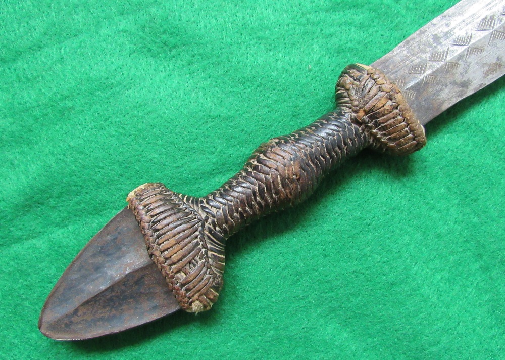

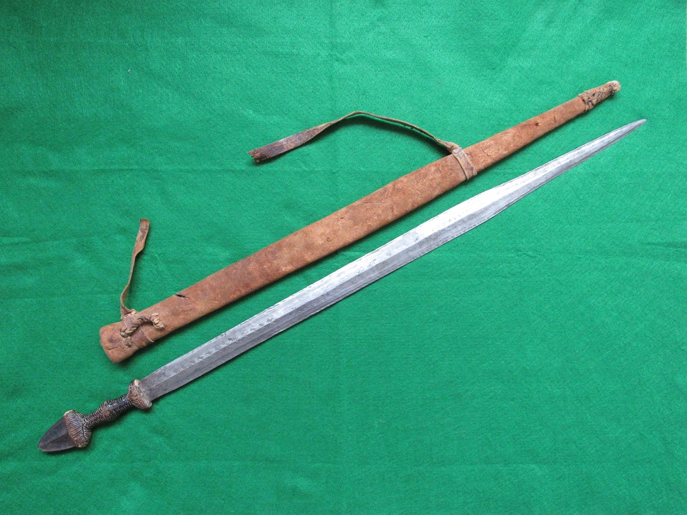

Here is a Tebu (or Northern Cameroon) sword for comment. It is 33.5 inches long with the hilt, with a 28 inches blade. The blade is of rhomboid cross section and quite heavy: the sword without scabbard weights 989 grams. I suspect the scabbard is a later replacement.
Where would you place this sword, chronologically and geographically?
Teodor

Nice, early 20th century, good antique now. I would have loved to have a piece like this when I was interested in Africa.
Old 19th November 2016, 09:21 PM   #3
Posts: 7,374
I like the blade engravings.

This is nice piece. I would say Chad (but I think this "Tebu style" is more spread than we think ...)

Fantastic blade! Locally hand forged and 100% authentic.
To me the scabbard seems to be the original too.

Thank you for your comments! One interesting thing examining the sword is that the edges were not formed by grinding, but by pounding.

But back to your sword: It is nice, both the blade and knitting on the handle are nicely preserved. I may be wrong, but I think this "knitted" handles may be older than the simpliest styles. But I would not determine the age. I think, in this cases of Tebu knives and swords it is not easy. I think they have been produced in unchanged way for very long time, till, probably, present.
