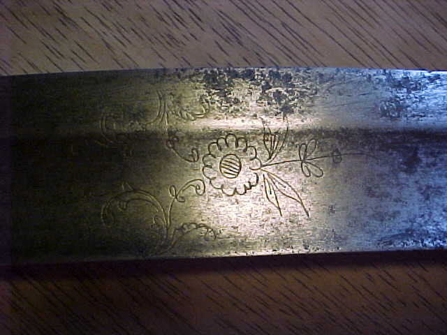

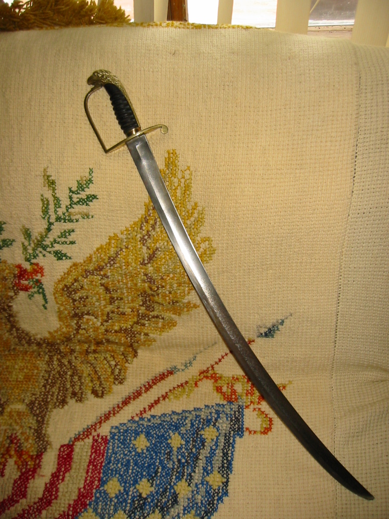

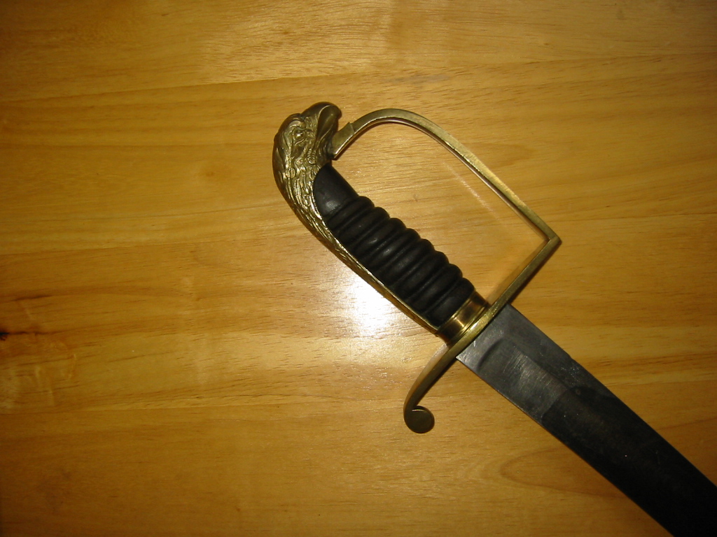

Default Early 1800's US Eagle head Sword

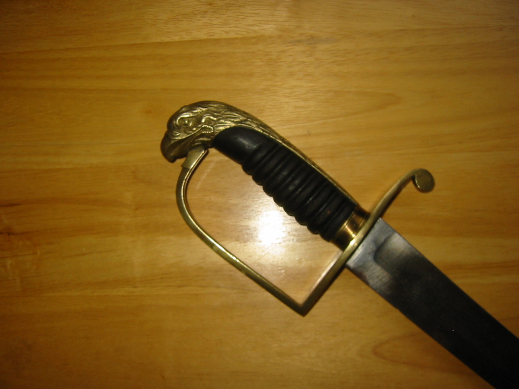

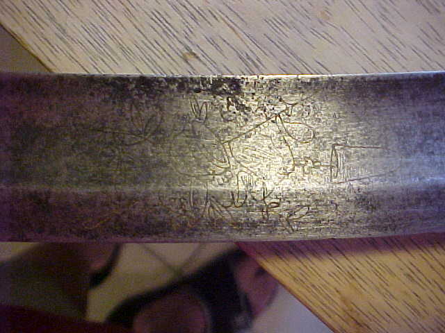

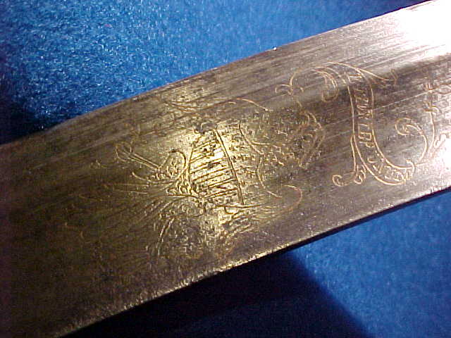

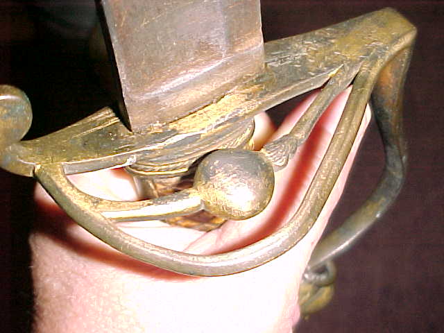

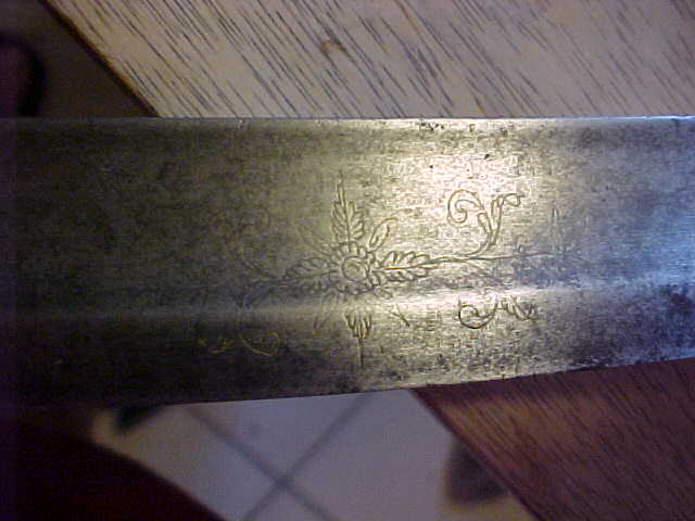

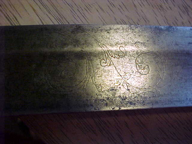

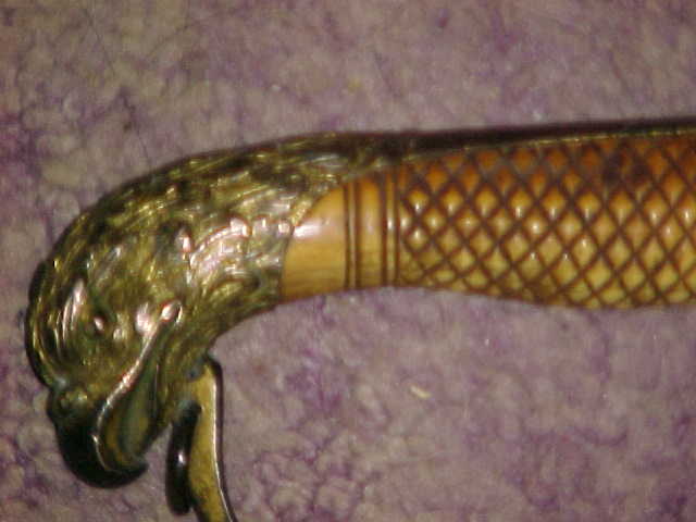

I picked this up a couple of days ago in a trade. I believe it is an Artillery Officer's sabre from 1800-1820. Of course missing scabbard. Has floral design on both sides with kettle type drums, crossed flag and pike with "freedom" capand the U>S> eagl withe motto on the other. Can't make out any markings, but thinking German maker. Has flamming bomb on bottom of cross guard. Your thoughts?

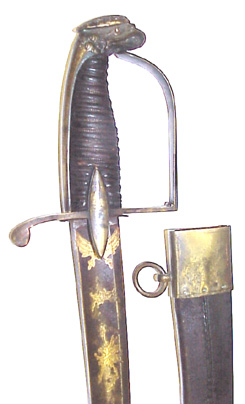

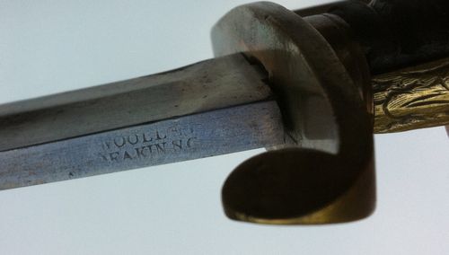

A very pretty eagle pommel from the first decade of the 19th century. I have one that is similar with a plain blade marked to Woolley Deakin & Co. Mine has leather over wood for the grip. John Salter of London sold similar eagle pommel swords. Even if it turned out to be a German blade, the bird is Brit ish
A worthwhile book for these is this title http://www.gunandswordcollector.com/..._EA_eagle.html
Without a maker or retailer name on the blade, there isn't a whole lot more that can be said. A flaming bomb motif usually marks a grenadier in Europe and while this is the first I have seen in the counterguard like that on an eagle pommel, I have seen a couple with multiple grenades chased into the gaurd.
IMO, one of the prettier eagles.

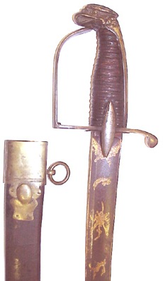

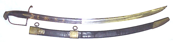

Mowbray dismisses these with backstraps as post war 1812 but my Woolley Deakin kind of puts that myth to rest. The floating pommel type sometimes regarded as a Dyer type. It has been so long since I have read the text that I might make a mistake but iirc, Dyer was New England.
I have a couple of other picture files of these with floating pommels. The French Captain's sword in Master&Commander was of this type.

Where oh where is that file. These floating pommel examples seem to vary more, cutler to cutler.

I'm glad you came in on this!!! Ive been going mad trying to find info on American eagle hilts, and discovered I don't have Peterson with me, nor some of the Man at Arms articles. As I have said for many years now...you are the boss when it comes to American swords!!!!

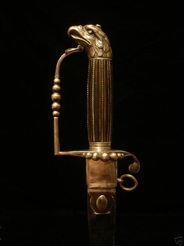

In searching through whatever info I could find on line, I did find that it seems most American eagle head officers swords pre 1820s or 30s were produced in England, France or Germany. One note claimed that examples with langets were typically German produced....is that a reasonable axiom?
For some reason this example seemed British to me, I think due to the cross hatch on the bone grips, which reminded me of other British hilts of this time.
I am curious on the eagles, while this one has a smooth head, the others, such as Ketland, have pronounced flat heads but I cannot think of the term.
It seems this has been rather appointed the 'American' form of eagle, sometimes called 'screaming eagle' ?
Just seemed like a good opportunity to detail some notes on American eagle head swords.

I would be careful with the langet attribution, as many past the 1820s were marked and cutlered on both sides of the channel. The Mowbray book still the gold standard for the early swords but there are some tdbits in Hartzler's Lattimer Collection book. Flayderman and the younger Mowbray publishing the Medicus Collection offers a very comprehensive (while sparse reading) flash card deck.
The early use of eagles with langets actually goes (in part} to Le Page and others in France.
Eagle types almost infinite. Below an older link to my eagle mania. Some misplaced on purpose, others simply misfiled, a general image dump of mine up to a few years ago. My current drive still updated almost daily, so this shared folder just a start
https://drive.google.com/folderview?...mM&usp=sharing
Just a for instance, one will find Dyer types in both the Salter folder and a separate subfolder under another category. Similarly, I have Bates and Bolton together. I may never publish more than these simple posts but I pretty much still live and breath eagle pommels. I don't think I'll ever have all the knowledge.
With the variety so, so diverse, it is much easier to discuss a paticular variety than speaking in broad terms.

Old 8th August 2016, 04:05 AM   #8
Terry K
Join Date: Feb 2014
Posts: 86

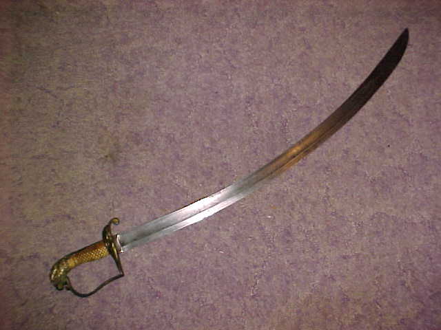

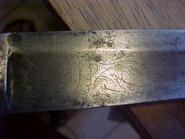

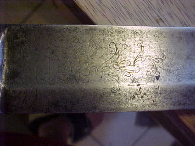

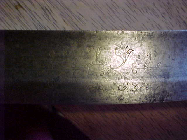

Here are some more pictures of the blade
Terry K is offline   Reply With Quote

last

As Glen has noted, this hilt is most likely British but blades in this period in England were often German. As I mentioned, the cross hatch on these grips reminds me of British swords for officers of this period. I would defer on any further notes on this outstanding sabre to Glen, as he is the master on the field of American swords.

Thanks for answer. I only thought the blade may be German as it has kettle drums on it instead of regular ones. Also I have seen numerous German embellished like thia, but have seen other ones done about the same. I've played at collecting for 50 + years and love learning every day.

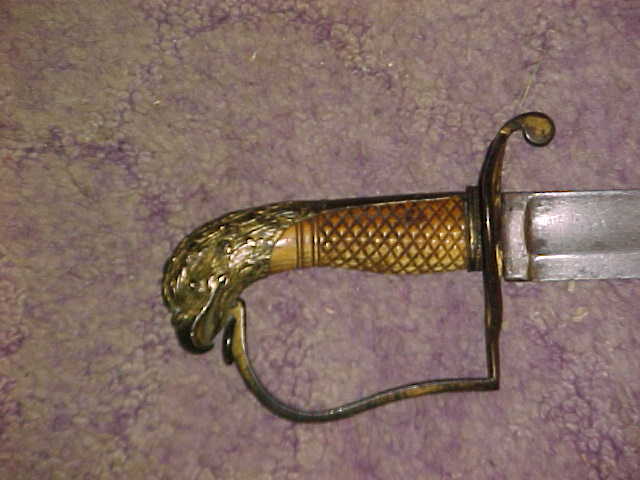

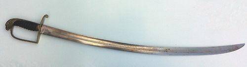

I had come across my example on Ebay and although priced very well, the shipping cost posted seems to have scared others away. I had contacted the seller before the auction ceased and they said they would reimburse any cost above actual shipping. Waiting pensively until the end, my single bid accepted and the sword with check arrived virtually untouched for two centuries.
There is a very brief passage in Mowbray mentioning these with backstraps and he placed them after the war, with a promise to discuss it in "volume 2". The best we have is the younger Mowbray working with Flayderman and the Medicus collection.

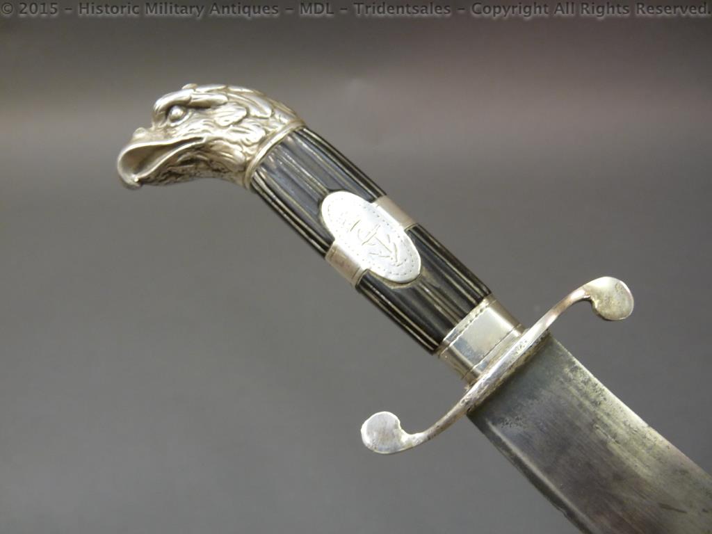

There is a faint chance these were cutlered in New York state, up the Hudson (where mine surfaced) but other traits remain that they were brief English cast versions. None I have seen are marked other than mine, with the Woolley Deakin blade mark. Your etching does appear it could easily be the same we see on Kirschbaum & Schimmelbusch (sp). There is still a K&S bird on Ebay but I have its twin in a picture file. I will post that along with mine as I found it. My short term memory is shot but it is a NY jeweler that I was thinking of, ah Issac Hutton of Albany. My acquisition thread here, with Dmitry's example.
http://www.swordforum.com/forums/sho...n-amp-Co-Blade
The K&S marked sword almost a Ketland type head with a backstrap.
Cheers
GC
