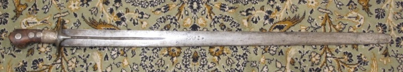

I was digging around in my image archives today and came across a couple odd images that I was hoping I could learn more about.
The first is a kaskara, but was labeled as Ethiopian. I know of another kaskara with this odd pommel configuration, I believe the MET has it.

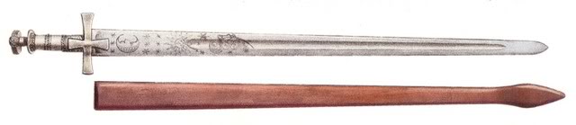

The second image is from one of the older churches in Ethiopia I think and is supposedly a king's sword.
Any further examples of this sort of thing - i.e. not the more typical horn hilts?

Not sure on the sword in the second photo, but it seems a number of otherwise relatively inconsequential sword types ended up as regalia swords in Abyssinia during diplomatic contacts late 19th century. I have an article around here somewhere on one of these kinds of swords presented to King Theodore around that time.

Hi Jim,
Thanks for the details on the strange kaskara pommels.
The second sword is more interesting to me as I honestly can't place from an outside source. Strange form.

Posts: 10,852
I agree Iain, the blade seems to favor the kaskara blades we were looking at which were Clauberg type from 1870s or so with that central ellipse fuller, but hard to say for sure. The hilt with those apertures at the crossguard ends is curious as well, and of course reminds me of something I cant place, it almost looks like a bayonet kind of hilt.
All the best,
Old 12th March 2012, 08:08 PM   #5
TVV
TVV's Avatar
Location: Bay Area
Posts: 1,761
Jim and Iain,
To me the hilt of the Ethiopian regalia sword looks very much like the hilt of a sword sold through Hermann Historica, pictures saved in this thread:
http://vikingsword.com/vb/showthread...ight=historica
There, it was described as a late medieval sword from Egypt. I agree with Jim that the single fullered blade looks very much like a Solingen made blade from the mid 19th century, but the hilt may be quite older. Or, the "mameluke" sword may be from a later period.
Teodor

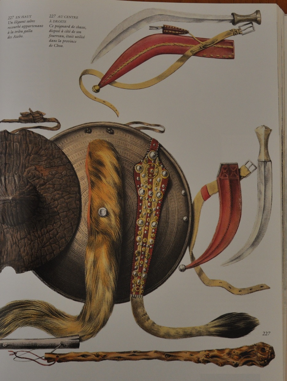

Hi Iain,
I have to resuscitate this old thread.
I asked recently some informations about a tabouka and a blade.
http://www.vikingsword.com/vb/showthread.php?t=21988
Because I had something in mind.
I think your first sword is Ethiopian and the museum was right (this time).
I will post some documents tomorrow to prove it.
When I say Ethiopian I mean found in Ethiopia and used by Ethiopians,
The sword was probably captured from a battle between Sudanese and Ethiopians and refitted with a new pommel later by Ethiopians.
Old 28th October 2016, 07:21 AM   #14

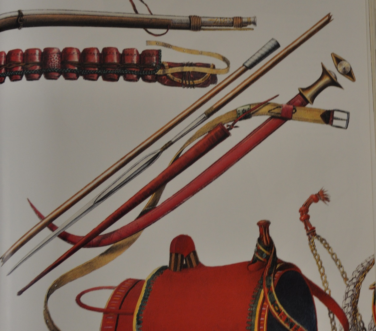

In fact your sword is not from the MET.

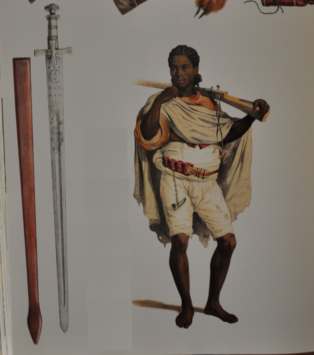

The kaskara from the MET is here.

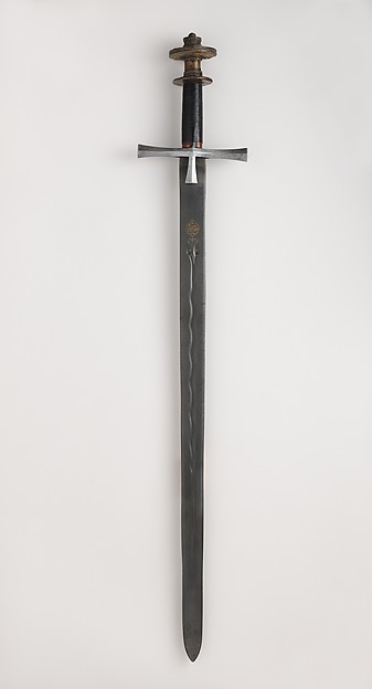

Your drawing comes from an old French traveller book, the author drawns and collected objects from Ethiopia, objects used by Ethiopians.
Theophile Lefebvre, Voyage en Abyssinie, 1845.
