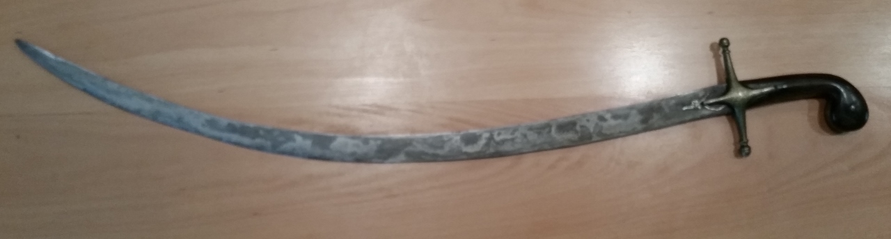

Hello to all,
I have lurked here for a while and decided to post this shamshir for review.

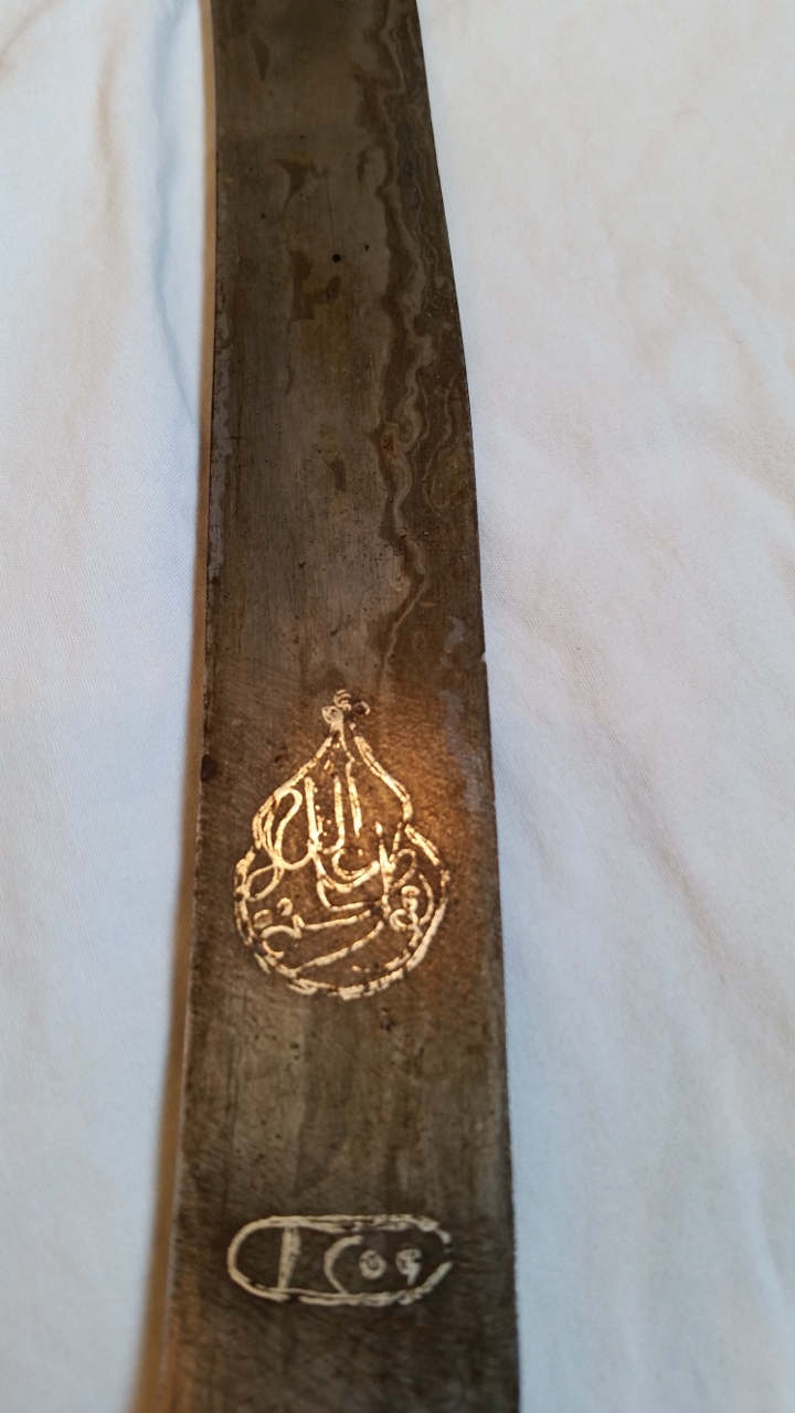

In hopes maybe that someone here could decipher what is written on the blade, I know that it wont be a prize winner !! however it at least to me is interesting to look at , the Leather of the scabbard is in rather poor condition and is cracked with age and not being stored properly, this may have however helped to preserve the blade. thank you in advance for taking the time to have a look at it, Kris..

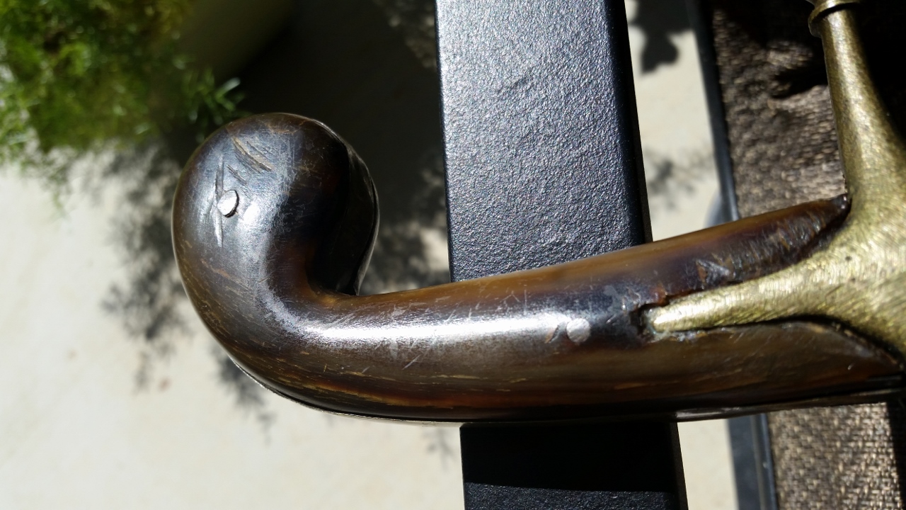

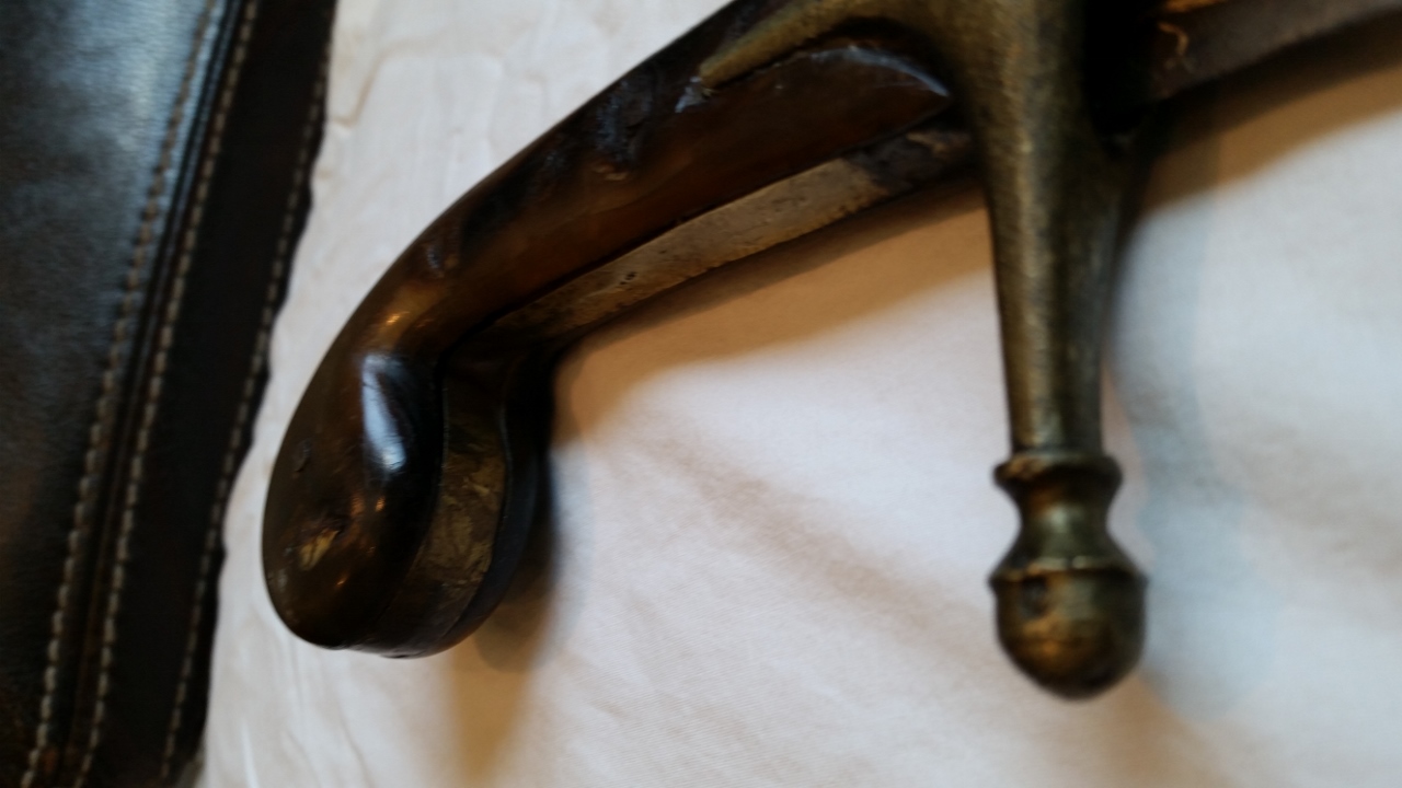

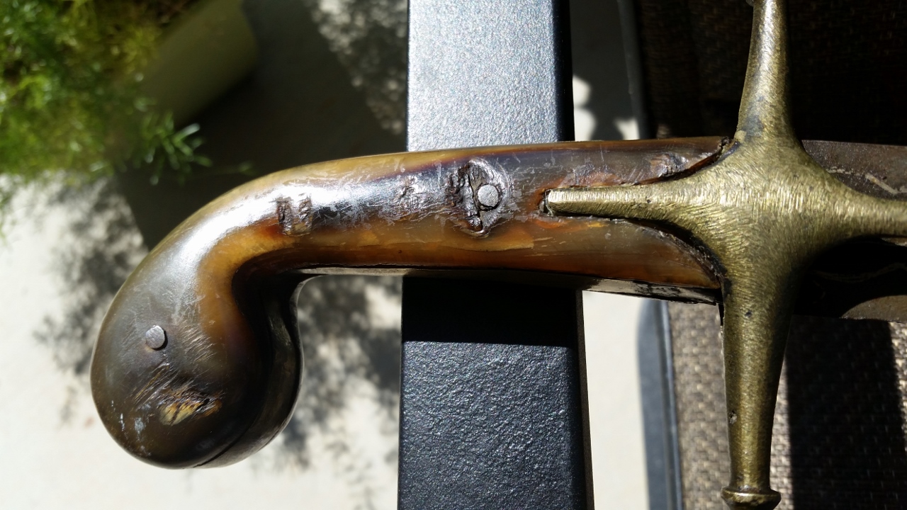

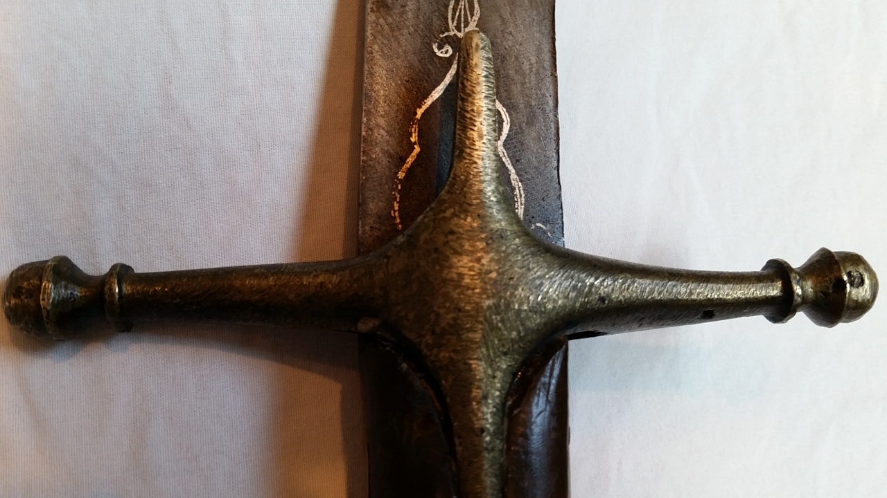

Is this not an Ottoman Shamshir? My first impression and in considering what happened to the weapon~ has it been in a fire? The Hilt looks part roasted The scabbard may have fire damage but appears to be sharkskin? The fuirniture is blackened (fire damage?)... The blade is saying Wootz but I cannot be sure as it looks rough. The hilt which could be Rhino has nails hammered into it and has deep scratch damage in places..The cross guard looks like it got hit with a dremmel wire brush....
The script looks like Allah with the addition underneath of the Talismanic "Bismullah wa Rehman wa Rahim"..The second smaller Cartouch is the Islamic date 1209. If you believe the date it indicates ABOUT 215 years old...(1253 = 1850 for quick referencing)

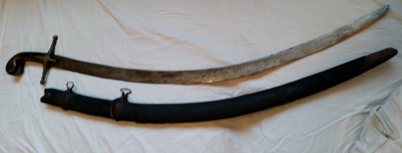

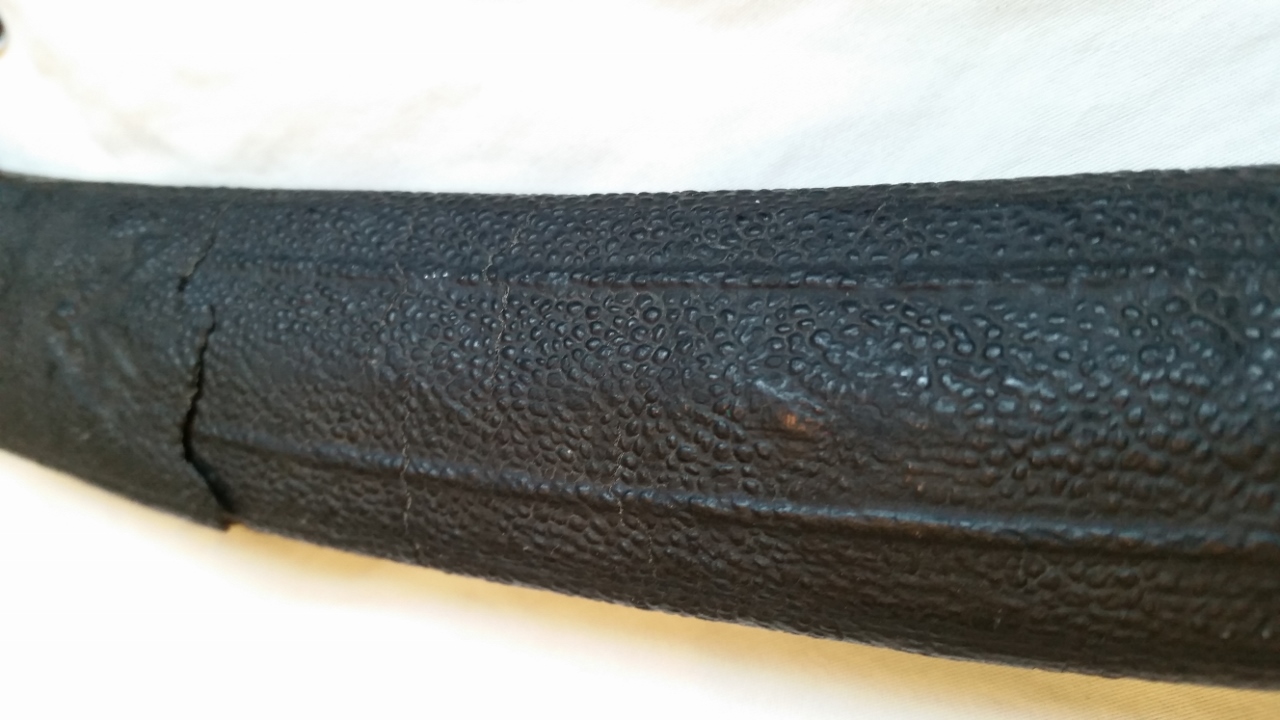

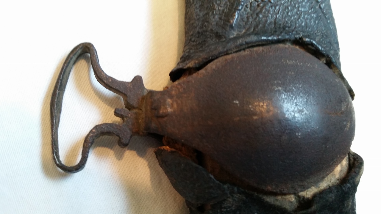

The scabbard is a pure and original Persian scabbard (leather and mounts)
I have some doubts for the sword, the general style is Ottoman/Turkish.
But something is wrong with the inscriptions & the grip (regular horn)...

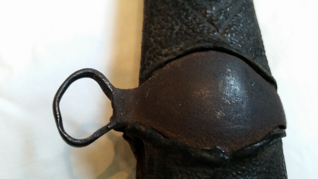

Hello Kubur,
The shape and style of the blade is of a Persian Shamshir, including the poorly immitated "Assad Allah" cartouche.

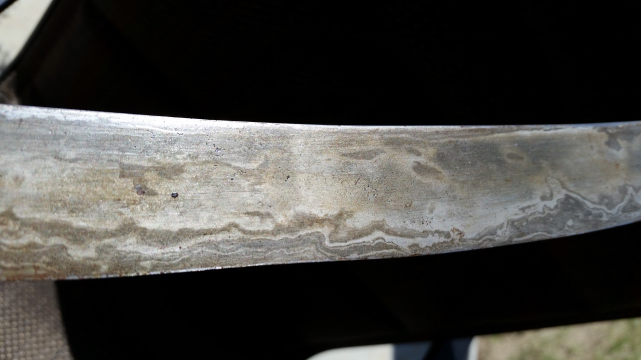

However, the blade doesn't appear to be wootz but pattern welded, and in my oppinion definitely not in Turkish or even ancient Indian style. It appears to be very poor quality pattern welded damascus.
So I suspect that it is a new sword deliberately abused to make it look old and antique. In other words a fake. A very poor quality fake...

Thank you all for taking the time and for posting your thoughts
Here are a few more photos

That date would make sense the other sword it came with was one of those Qajar period Kilij with the script covering both sides of the blade and the serpent as well and also the cross guard has the dragon head quillions. I believe it s known as a "Revival " type sword / at any rate I am glad to have something to post. The sword you linked to is stunning and obviously of much better pettigree.. I do know that these swords were in an old collection ( by American standards) and havent seen the light of day for a while.

The date is 1253 ( or, as I read it, 1259): 1837 or 1843.
It is a somewhat confusing creature: the handle is Turkish, the suspension rings and, likely, the entire scabbard , - Persian, the blade is a village-level craftsmanship. Dog's breakfast, IMHO.
Ain't no modern fake, but not an Imperial Treasure either. Local militia-type weapon, but almost certainly old and real. A legitimate part of collection.

in my honest opinion, the blade is no modern fake, it is at least from the period of around WW I.
I can see some pitting, which is not too easy to fake. The quality of the forging work seems pretty good, I cannot see any flaws, like open layers or so.
The pattern welded blade is also not a roughly forged blade. If the blade would be polished up to a grit of 2000 oder better 3000 and etched with high detail etchant, you probably will see much more and much finer details than now.
But the siganture, which was translated with "Assad Allah" is not real. Assad Allah was the most famous wootz blacksmith and this definitely no wootz.

The signature says "tawakaltu ala Allah" (I rely upon God)
So its not trying to be something that it is not. The blade looks legit with a crude handle and using an old scabbard. Not uncommon to find Ottoman swords with such scabbards.
