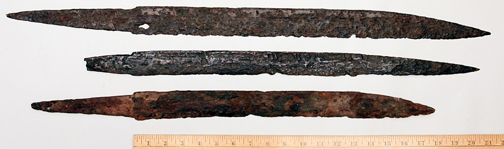

Below is a photograph of three excavated saxes, the largest with a blade length of just over 21 inches and a weight of just under a pound and a half in its present state (649 grams).

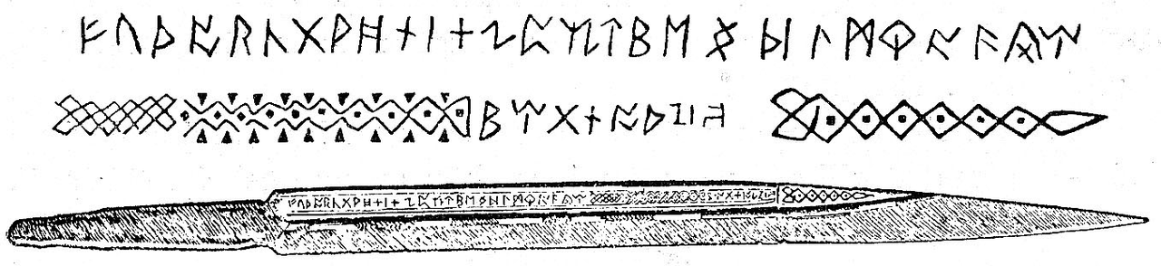

I added a picture of a Sax with some runes (https://en.wikipedia.org/wiki/Seax_of_Beagnoth).

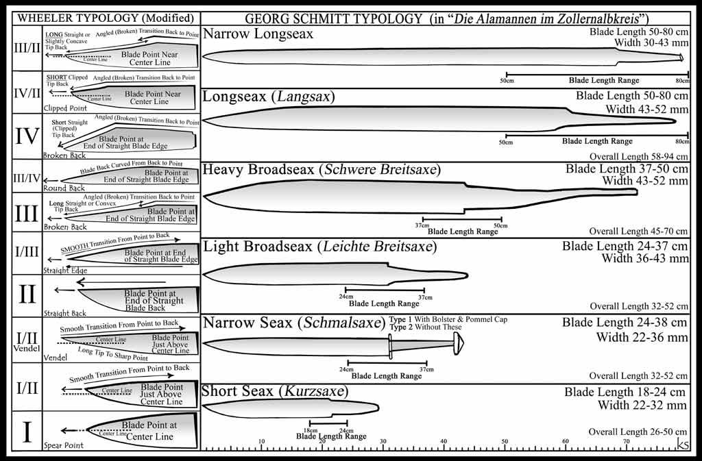

Hi Lee,
This chart may be of some use.
Norman.
P.S. I believe this chart was designed and compiled by a Mr Spencer using some existing typology.
