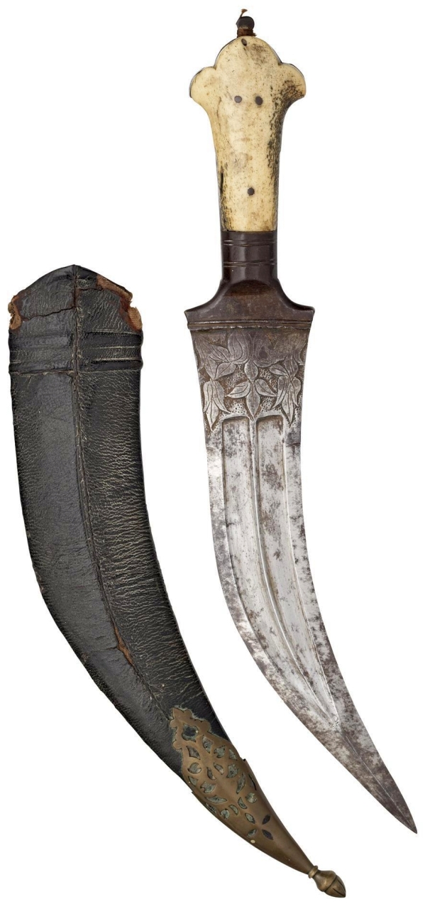

Dagger (khanjar) (1700-1799)
with a three lobed pommel.
Place: Persia

Old 12th May 2016, 09:05 AM   #2
Hi Strech
You are amazing to find pictures!
Very useful and first mistake they did it's a tiger dagger from Northern India.

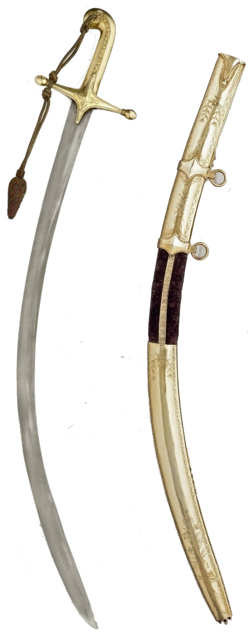

Here is another very weird thing they have done with several images, they surround the item being photographed with pieces of black paper? This is an Ottoman kilij, but they have labeled it as a
Sword (kilic) (1700-1799) kilic Persian blade European mounts 19th.century
you can see how it looks on their site and after I edited both images extensively, I just do not see any "European mounts" though and no evidence that I can see which would make the blade "Persian". Further down they describe the blade this way
the blade of the sword is single edge, curved widening slightly and becoming double edged near the point in the turkish manner.

Old 12th May 2016, 10:39 AM   #4
Oh i can tell you why they did these mistakes.
First the decoration is ottoman baroque, clearly with European influences, but it's not European. Second for a lot of people all wootz blade is Persian.
It could be...
It could be...

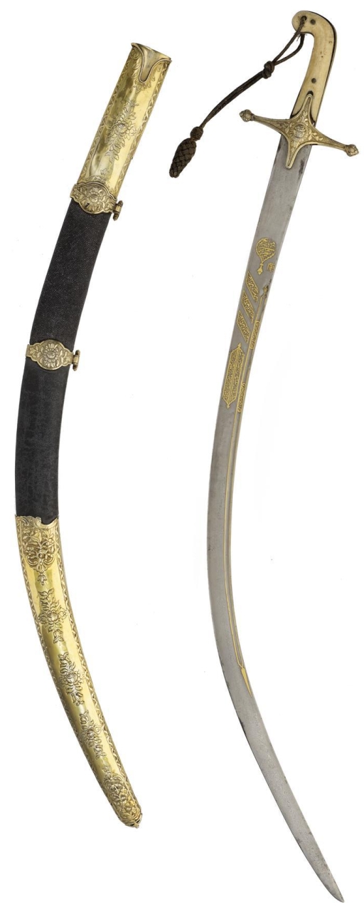

But this is the Royal Armouries, they have a lot of people with experience there, they never mention "Ottoman" either. Here is another one,
Sabre and scabbard (1615-1635) Mameluke-hilted sabre and scabbard Place: Turkey
I think if I described my kilij as a "Mameluk hilted sabre" I might get some laughs.

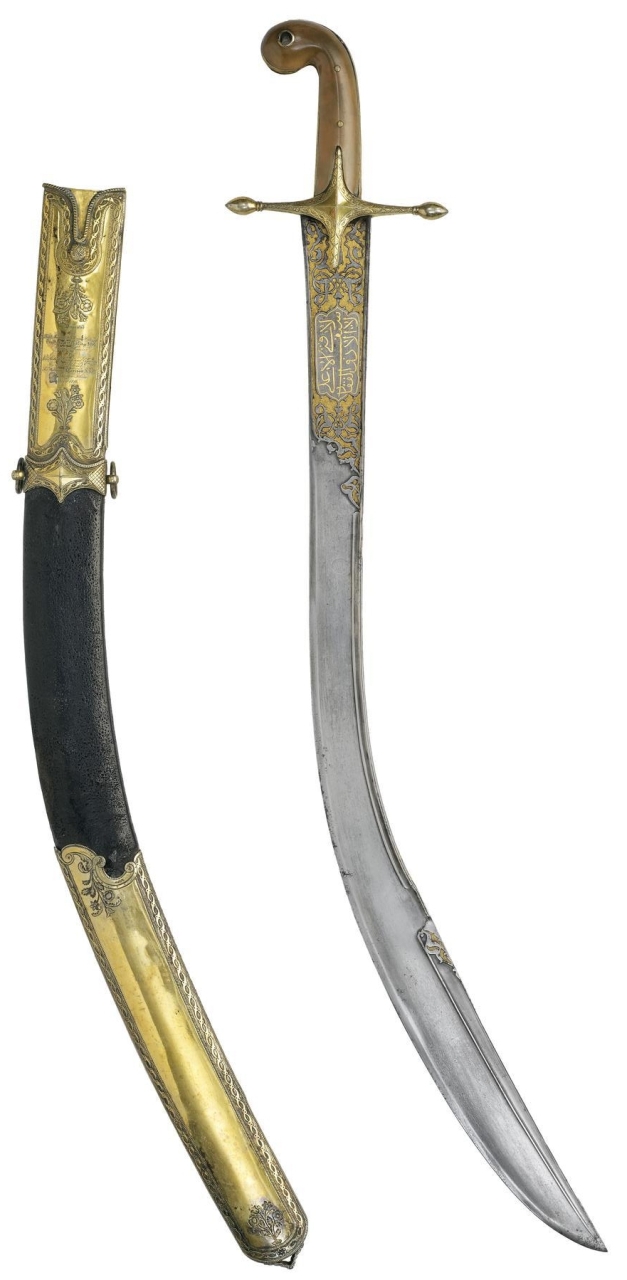

They do have some nice weapons and armor though. Here is another kilij, this one clearly has a Persian blade
Sword (kilic) (1772) By Ismail son of Asad Allah Isfahani. Place: Turkey
....at least be consistant!!

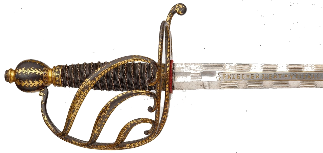

Here is an interesting sword...
German blade dated 1697; Indian hilt 18th century
....is this an "Indian hilt" or a European hilt with Indian decoration?

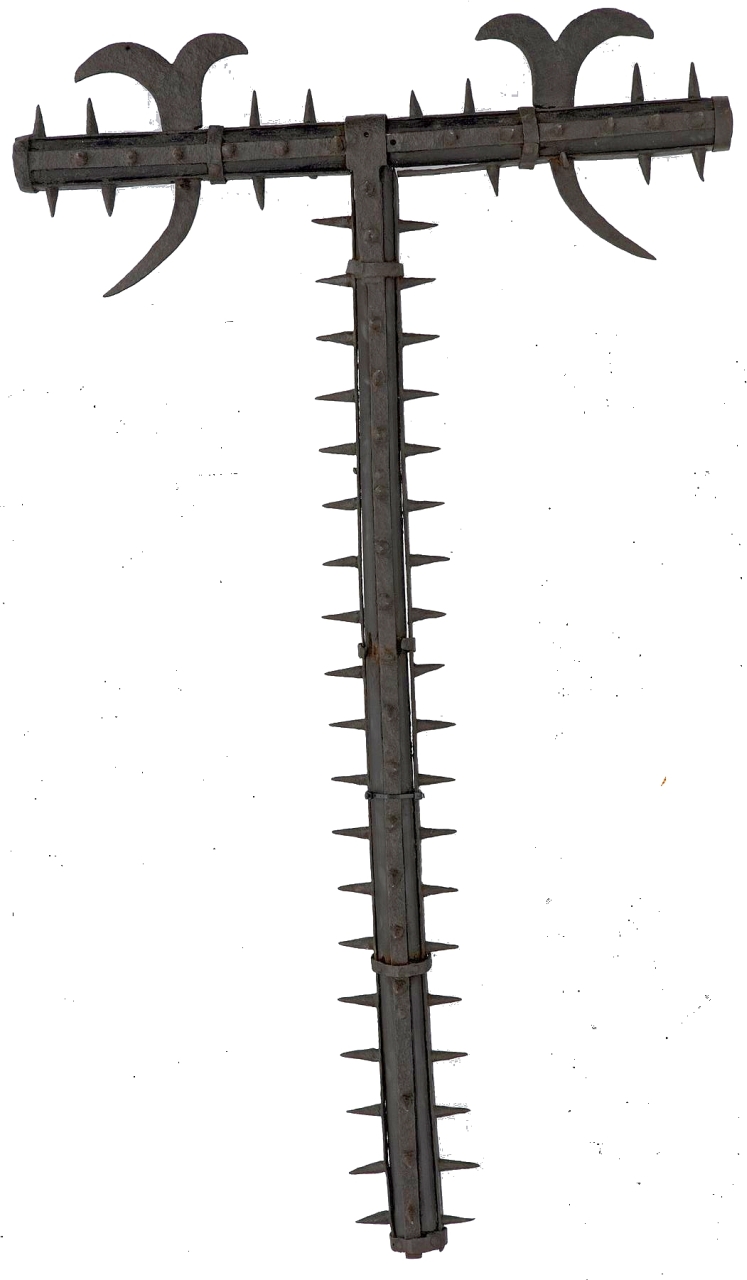

Here is another glaring mistake, this is a "tsukubo" but is it not a "sode garami", that is another type of tool used for catching / holding criminals, there are three such tools which together are called torimono sandōgu (three tools of arresting).
Catch pole (sode garami) (1800-1899) of the type called tsukubo Place: Japan
