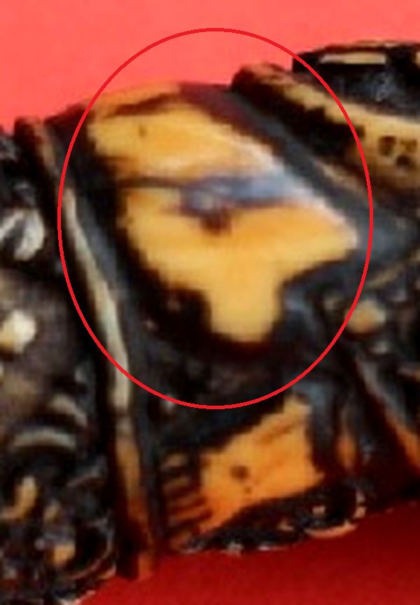

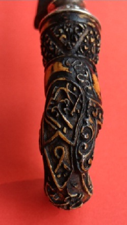

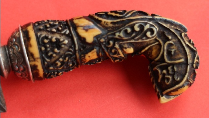

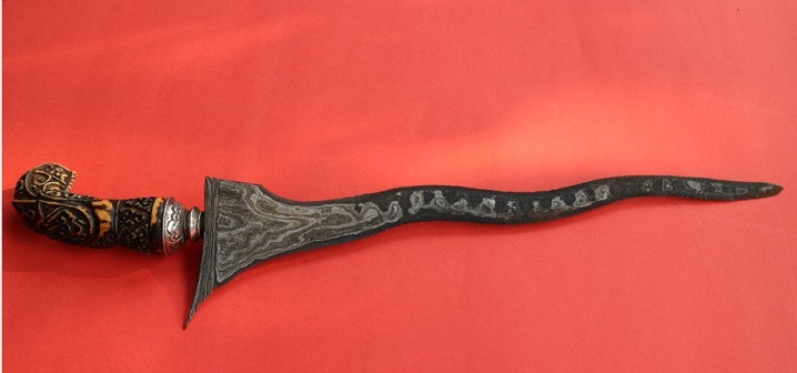

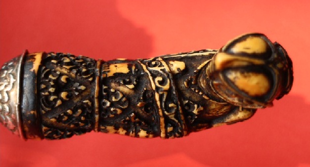

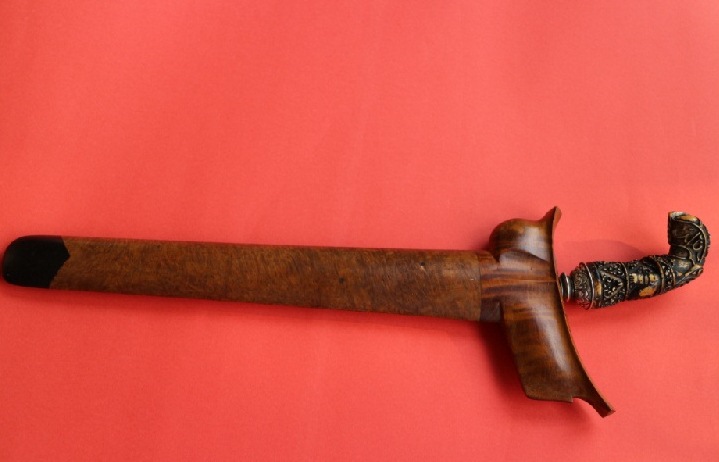

I bought this small keris for a modest price mainly because I like the quranic carvings on the hilt and probably it is ivory. The seller swear that the hilt is ivory and not some form of plastic. I have a lot of misgivings as I don't see any clear ivory charateristics although one can see one obvious crack towards the end of the hilt. But it did not look like a typical ivory crack but more like due to heat expansion or such like.
If one looks closely enough we can see v small cracks on the lines of arabic /quranic calligraphy and a few others but nothing v obvious.
So i need your expert help to give your opinion: (1) is this hilt ivory? please do not ask me to do hot pin test as the mendak is firmly glued to the hilt (2) why the black stains on the hilt?

I doubt that anyone can tell you whether it is ivory or not based on the photos you provided and considering the condition of the hilt where just tiny spots of the base material are exposed.
However, the colour of the exposed areas seem to be consistent with antique elephant ivory.
Please keep it in mind that at the time this hilt was made, ivory was not subject to so many restriction like now and it was quite available (albeit it was always on the expensive side).
Now, why is the hilt so dark, I have no idea but it might be that is simply dirty or maybe it was painted?!
However, I am just a novice when it comes to kerises.

I think that Marius is right.
The hilt is definitely no bone.
The color of the highlighted area is typical for ivory.

Resin materials can match the color of antique ivory (or any color for that matter) quite easily. Marius is correct that these photos reveal nothing definitive. I do find much of the blackness on the hilt suspect as it looks applied in some areas, not simply the natural accumulation of dirt. Have you tried to remove the hilt yet? A good view up the pesi hole might be more revealing.

I suspect the blackened hilt was done so as to provide a background against which the raised portion of the carving could more easily be read/distinguished. Wearing down the raised edges to remove the blacking would occur naturally through use, or could simply be polished off. I find it a visually pleasant artifice.

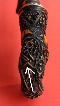

One further Q though,

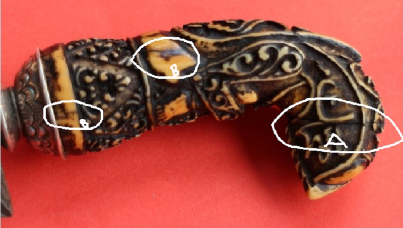

Do resin or bakelite or other plastic type non ivory materials give cracks and hair line fractures like in the pics below?

Posts: 7,303
I think it is less likely that this hilt is resin and perhaps more likely it is bone or maybe new ivory that has been artificially aged. It could still be old ivory, but i don't really see the point of all that added black stuff added to "age" the piece if it was really old. The black is definitely not natural aging IMO.
It shouldn't be too difficult to dissolve the glue that holds the mendak to the hilt. It would be what i would do if this were mine and then you could get a good look at the bottom of the hilt and maybe make a better determination.

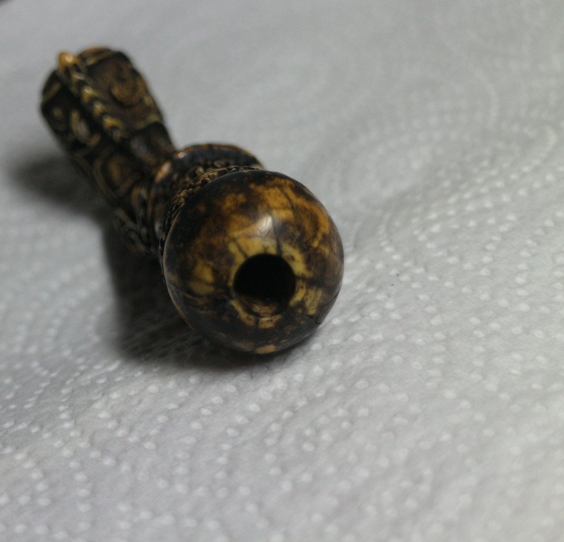

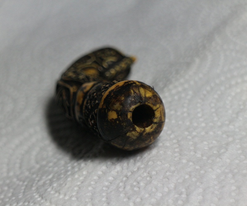

i finally managed to take off the mendak from the hilt. not me exactly but this is how it happened. I brought the keris to a few keris and scabbard and hilt makers here and many were of the opinion that it is either ivory or antler but all said to confirm it i had to take off the mendak/pendokok.but nobody wanted to try to take it off....until yesterday when i met one master carver here.
i explained that the mendak is glued to the hilt, he took one look and said sure it can be taken off and proceeded to use brute force without even by your leave and i was worried sick that he would tear off the delicate silver mendak but walla! he did it without any damage to the mendak... the glue was so dry and old that a strong force did manage to pry it off. but i wouldn't reccommend this method to anyone and i probably won't show any more keris with glued mendak to him
here are the photo of the end of the hilt and he confirmed that it is indeed ivory. an old ivory. So i'm pretty pleased....
but if any of you have a dissenting opinion i'd be happy to hear it.
