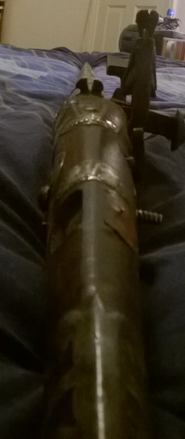

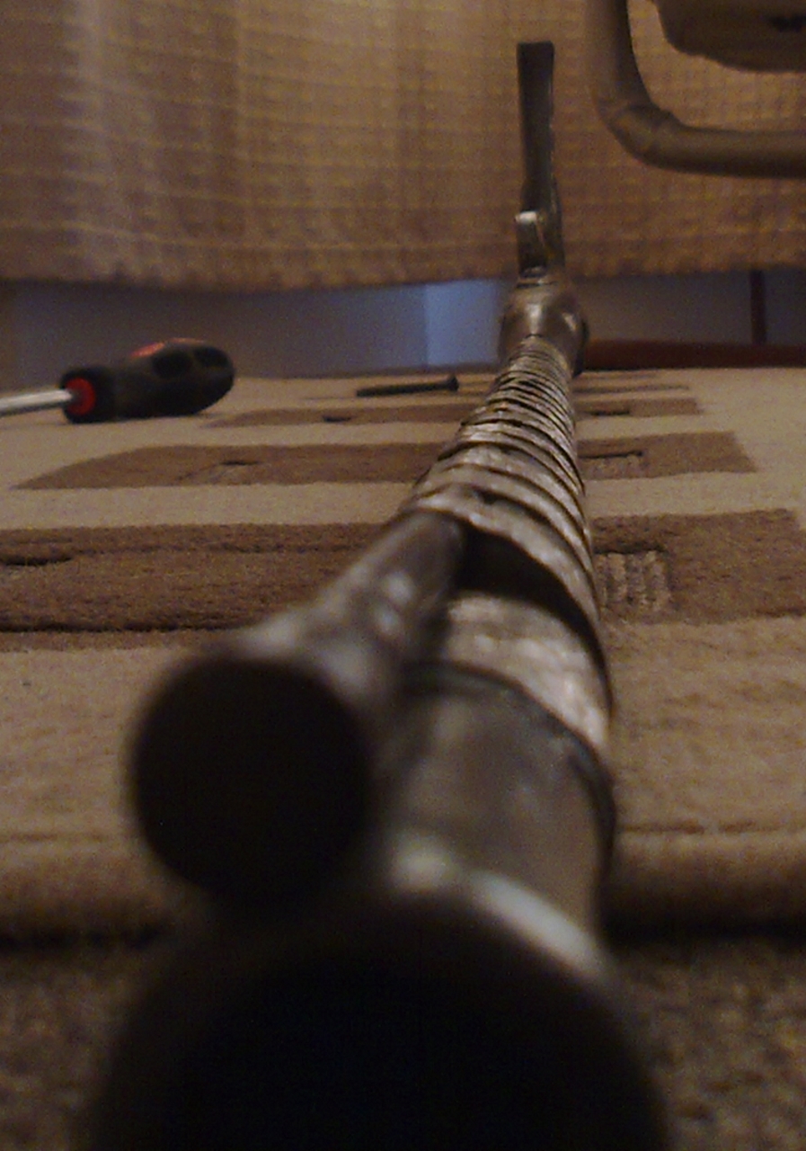

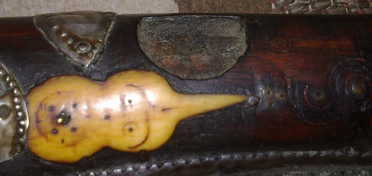

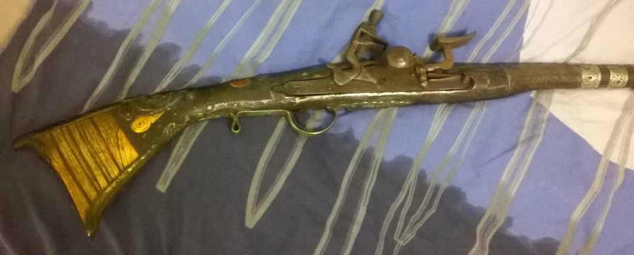

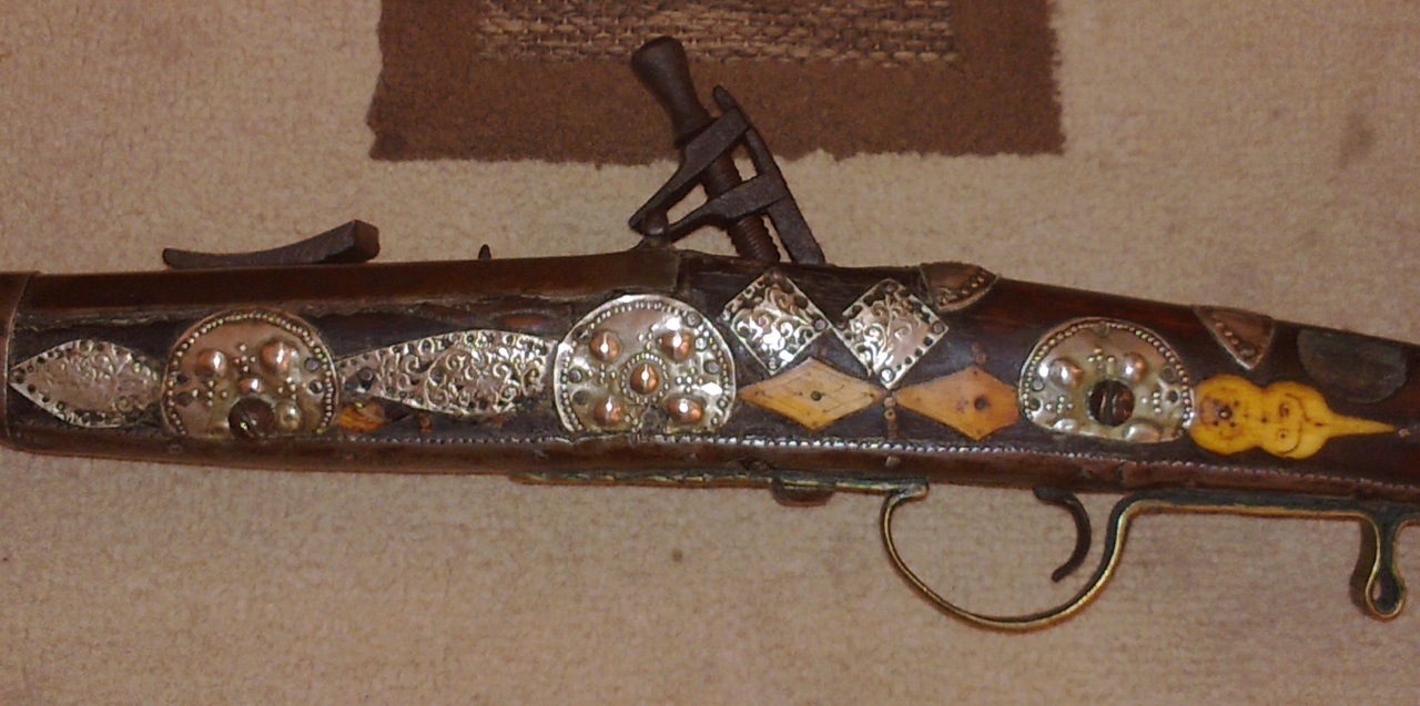

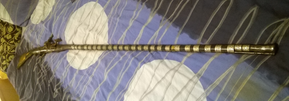

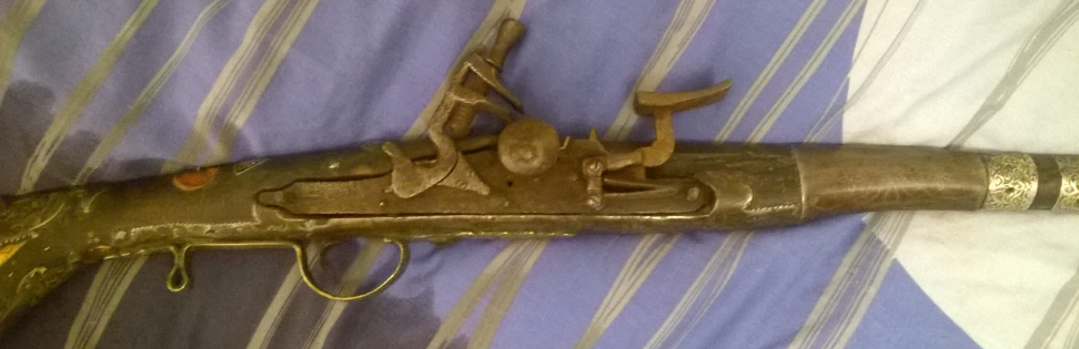

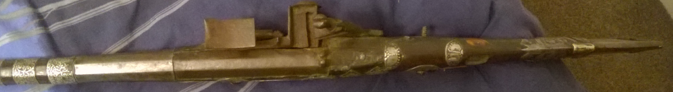

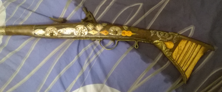

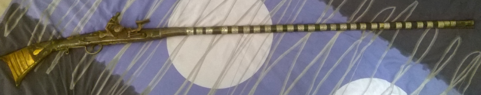

Well, perhaps like an idiot, I went and finally acquired one of these oddities in September last. Been meaning to post it on the forum since then but, well, you know how it goes...
Overall length 63in, barrel length 48in almost exactly; the bore's somewhere around .65 (or roughly 20-bore), but is actually ovoid at the muzzle(!) so it's a bit tricky to say for sure.
Snaphance lock semi-functional; when purchased, the corrosion had essentially jammed it solid, but oil and wire wool has removed enough of that to get the lock moving again. The sear nose has deformed sufficiently to prevent engagement with the cock, and doesn't actually match up with the tail of the cock (more on that anon), and the pushrod for the pan lid is sufficiently loose to wobble a fair bit when the lock works. One of the lock screws is ridiculously overlong but otherwise OK. Whole thing sits very loosely in the stock; could be a replacement?
Barrel's as crude as anything I've ever seen, being not particularly straight externally and, as mentioned, ovoid in section at the muzzle (ramrod wear?). Very long, narrow bored and surprisingly light. Smoothbored, octagonal over first 5 inches (or so) from breech, transitioning to round external section thereafter, with notch rear sight and brass bead foresight that's worn down to a stub but just about visible.
Stock and fittings are the real meat of this thing. Never seen as much bone or silver in such a short area. Most of the decorations are still in place; the biggest absence is a piece of bone which should be sited almost exactly on the centreline of the stock, roughly where the user's thumb would rest while shooting - probably explains its absence. Camel-bone inlay sections forming hindmost part of buttstock are extensively cracked (desiccation or heat expansion/contraction?) and yellower than a hundred-a-day smoker's two remaining teeth, but at least remain in position. Small areas of orange coral present on stock wrist. Extensive silver plating, covering underside of stock adjacent to lock, and used to produce sideplate to hold lock screws. Twenty-eight (count 'em!) barrel bands, of which one brass; first band appears to be heavily patinated silver strip of approx. 3in length, nailed to stock through leading corner. Iron ramrod with simply carved tip, unfortunately jammed in there like a limpet and resisting all efforts at removal. In fact, the entire gun's stuck together extremely tightly; I suspect someone has, in its long life, kept it clean with heavy use of furniture polish.
Pics! Apologies for their being small and rather poor; my good phone camera is dead and buried, sadly, and this is all I have to hand.

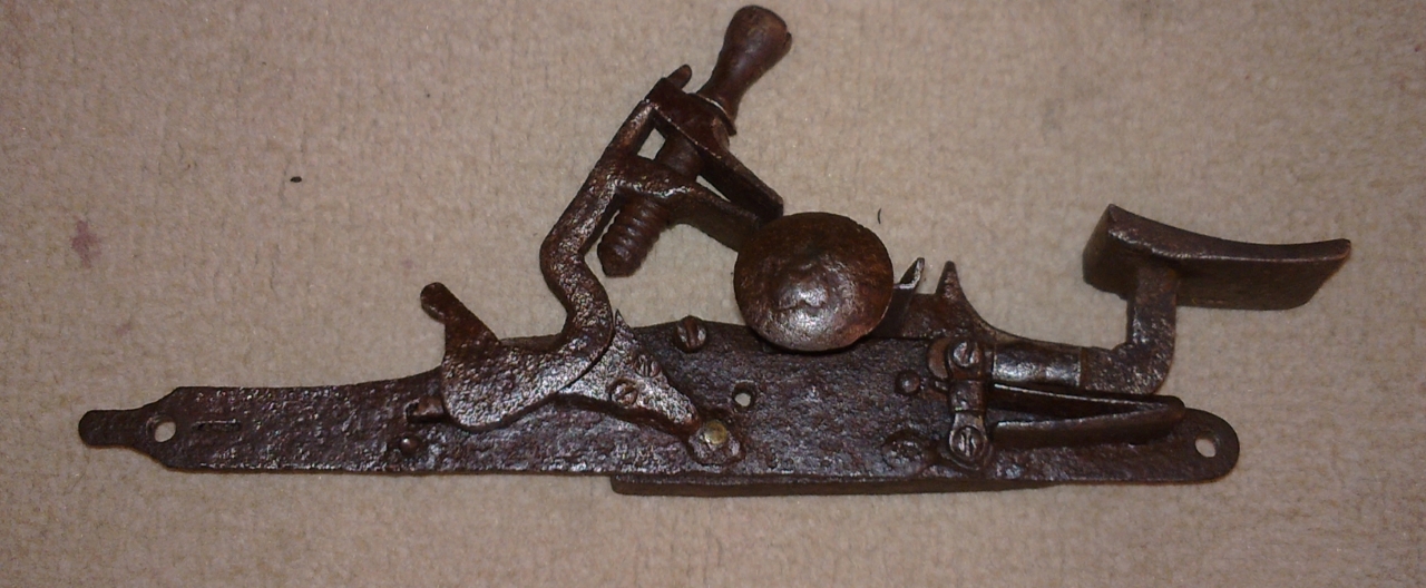

http://www.vikingsword.com/vb/showthread.php?t=21120

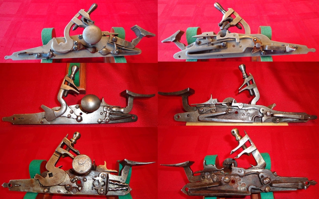

Your gun indeed appears to be a Moroccan Altit long gun from the Little Atlas Mountains Region. Could be anywhere from the 1st to 3rd Quarter of the 19th Century. (where as Blue Lander's gun appears to be an Afedali from the Sous Valley Region with a replacement lock from another gun).
The lock on your gun was made on the English pattern, which seem the most common on Altit guns. The lock on Blue Lander's gun is the Dutch pattern, and is common on Afedali guns, but I've seen both patterns used on Afedali styles.

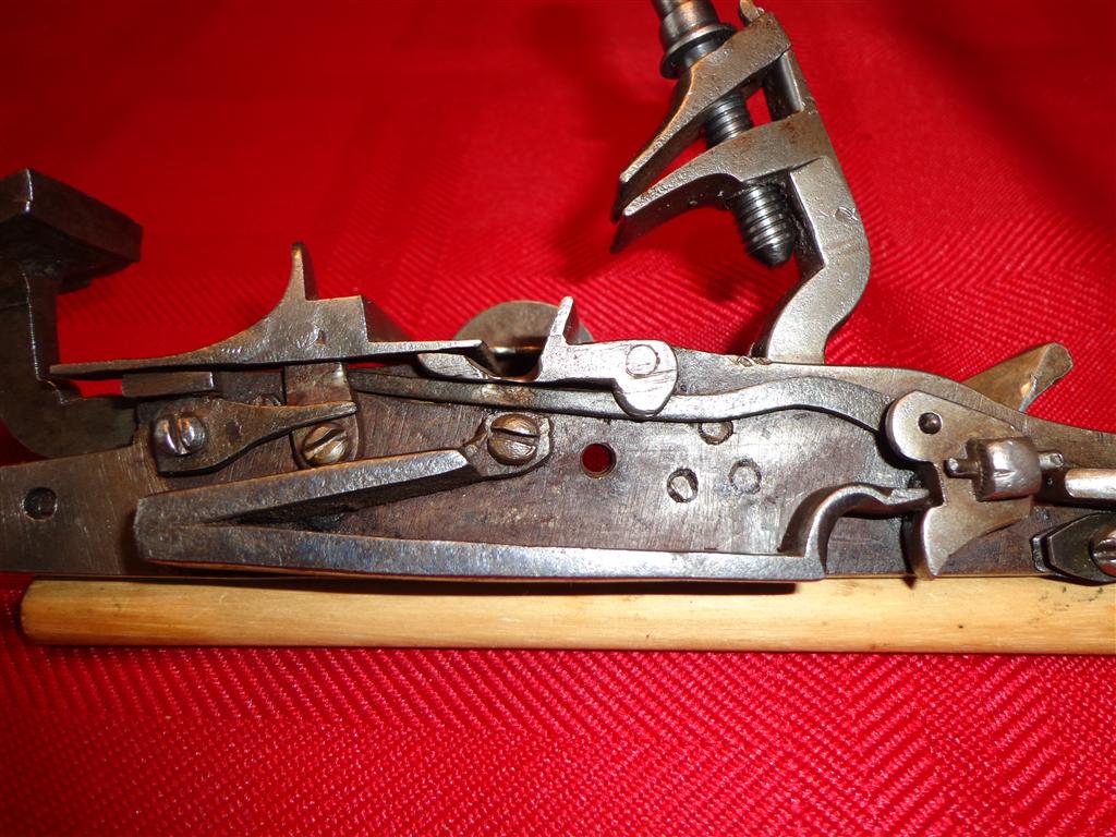

About these Snaphaunce locks: Having spent a few years working and having these locks repaired, the weak part is the sear to hammer slot engagement. The sears and tumblers on all these locks I've examined were simply not hardened. The sear would wear down short. The locks must have been in a constant state of maintenence and repair. The only way to repair this in most cases is to add metal to the end of the sear and file to fit, then flame harden the finished sear. Or make a new sear. While I'm at it, I'll have the tumbler hardened also. This makes the lock work much better.
Yes, the English style lock on your's does look like it may have been a latter replacement. The lock plate screws on these guns often extend out past the lockplate, but the screws on your's does seem to the extreme. By the way, are there only two lock plate screws on your gun? Can't quite tell from the photos. There should be three.
I'll post some photos of these locks below.

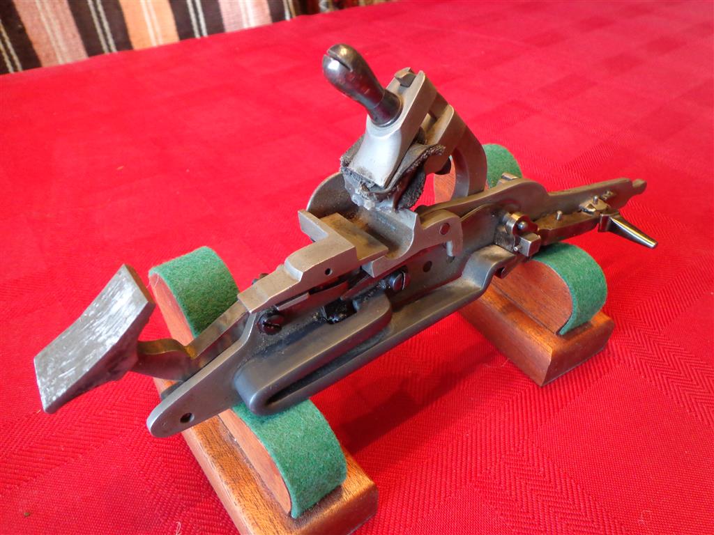

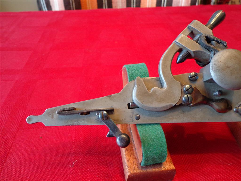

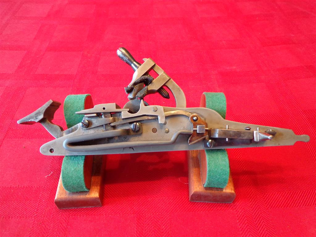

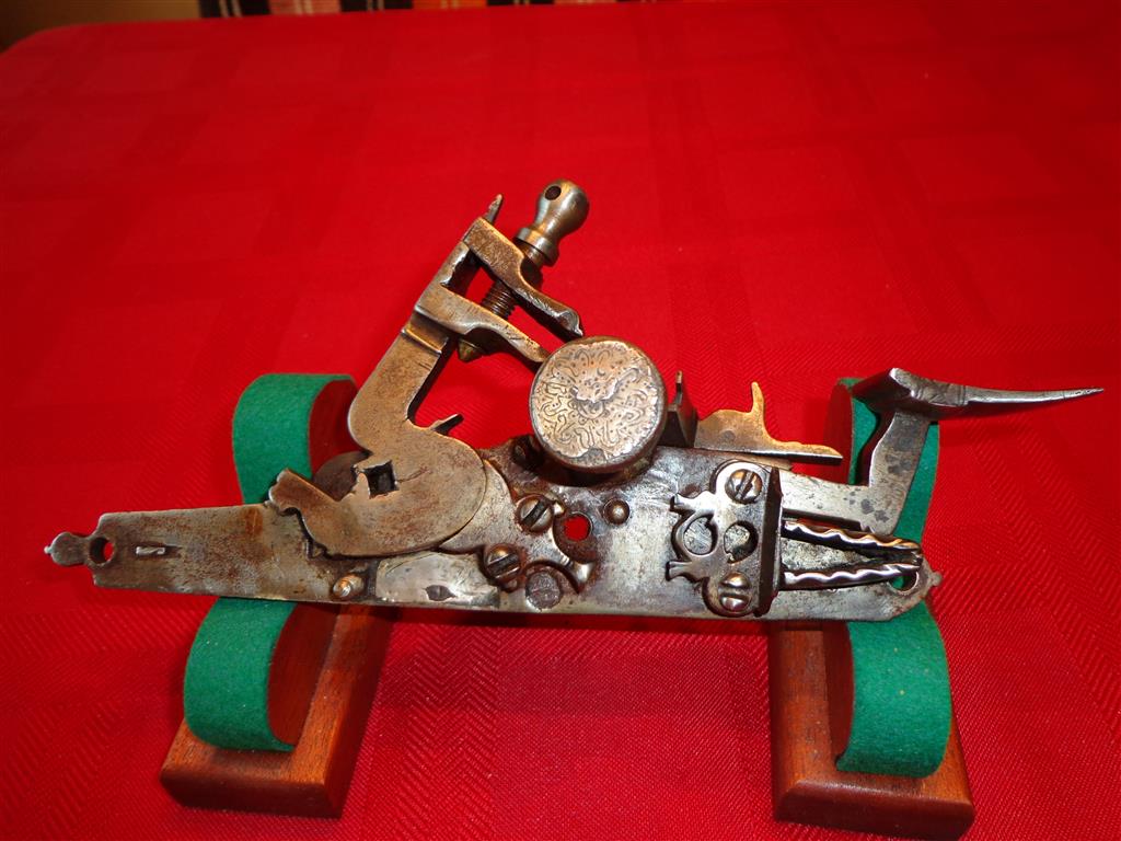

Here is an original Moroccan snaphaunce lock done in the English pattern. It is in un-used condition with a replaced top screw I had made that was missing.

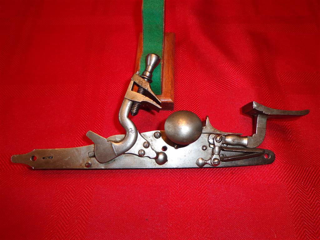

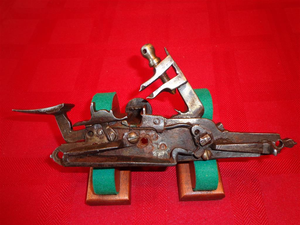

Here is an Original Moroccan snaphaunce lock done in the Dutch pattern. It has been used but is complete and working.
Rick.

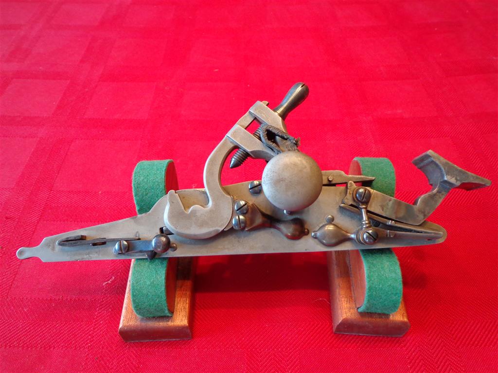

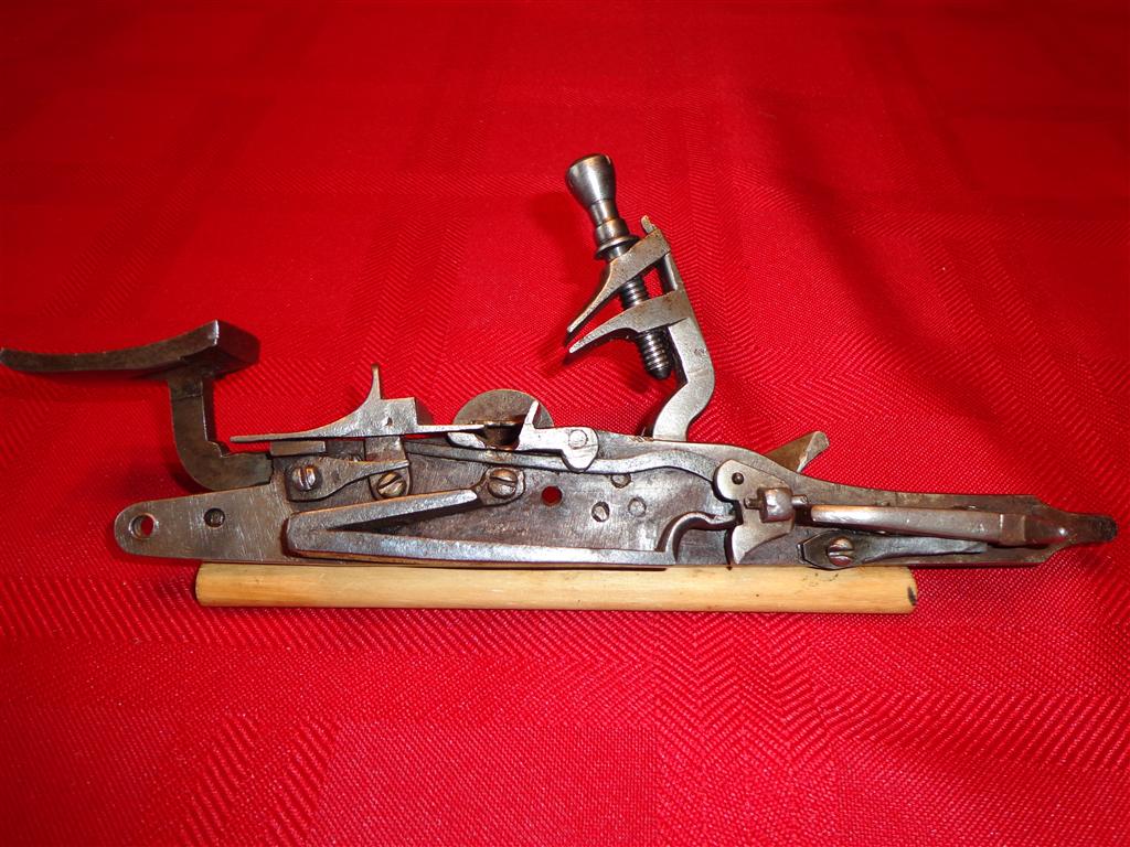

And here is an exact duplicate of an original English snaphaunce lock, copied from a rare surviving original English made long gun from the early to mid 1600's. There are suddle differences in the European made locks and the Moroccan copies. Note the swinging safety arm. The lockplate is wider to more easily accomodate the stock in converting an English matchlock to a snaphaunce. Where the narrower plate on the Morrocan locks would accomodate their narrow stocked guns.
Hopefully, the Moderator will allow the use of this replica in this case for comparative purposes? Thank you.

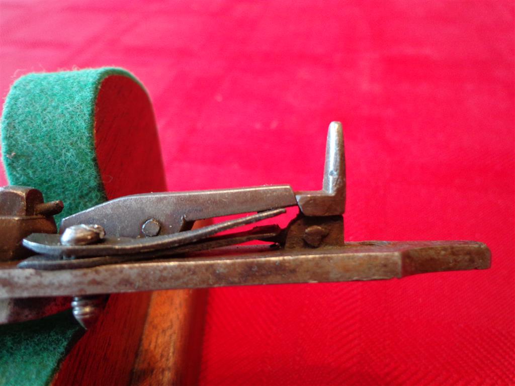

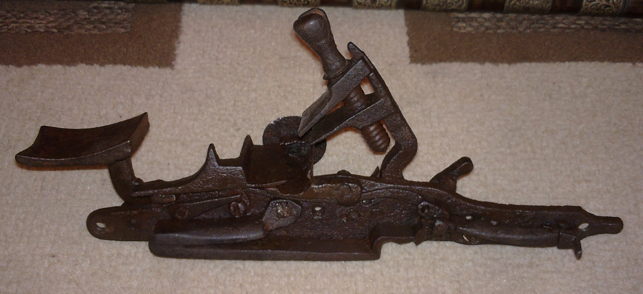

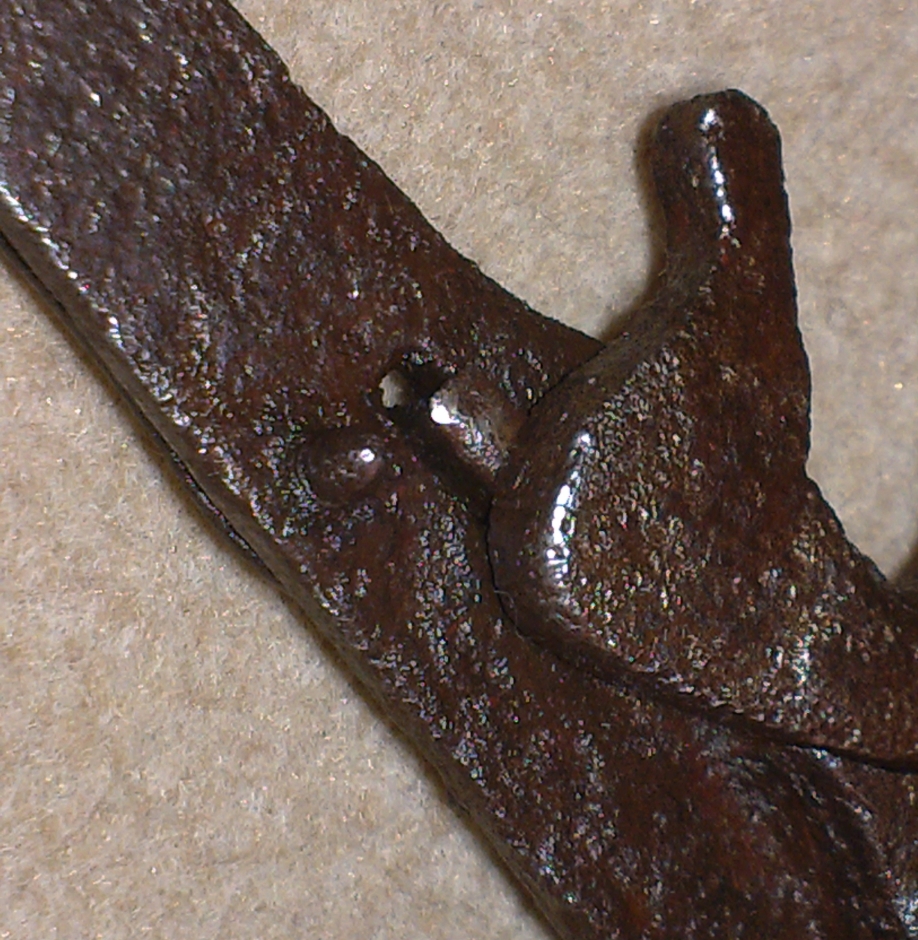

Thanks everyone, I'm learning a lot from this thread. I'm still a little confused how the sear is supposed to engage the cock. I don't understand what "force" is supposed to push the sear out into the cock when you pull it back.
Here's a closeup of the sear from mine. It appears to be bent?

Hi Blue Lander.
It's a bit hard to describe - in writing - how the sear action functions in these snaphaunce locks, but I'll give it a try LOL : The sear arm is in constant tension against the inside of the hammer. This is accomplished with the small V-Spring located between the sear and the inside of the lockplate. See photos below. So when the hammer is pulled back to the cock position, the sear pops out of the hole in the lockplate just slightly to engage the angled slot on the inside of the hammer. At the same time, the trigger bar will move slightly rearward. Once the trigger bar is pulled backward, it will cause the sear bar to return to it's original position and release the hammer. Hope this helps.
I can't really tell by your photo, but it appears your sear spring might be missing (?).
Most of these locks you encounter will have the sear worn down. You will also find tumblers worn fron the stress of the mainspring. This is because the sears and tumblers were never tempered/hardened. I can picture these guns being fired only two-three dozen times and already need a sear adjustment.
Hope this helps. Rick

Posts: 456
That's a very clear explanation, thank you. You're right, mine is missing the sear spring. It has the trigger spring, though. Hopefully it'll be an easy piece to replace.

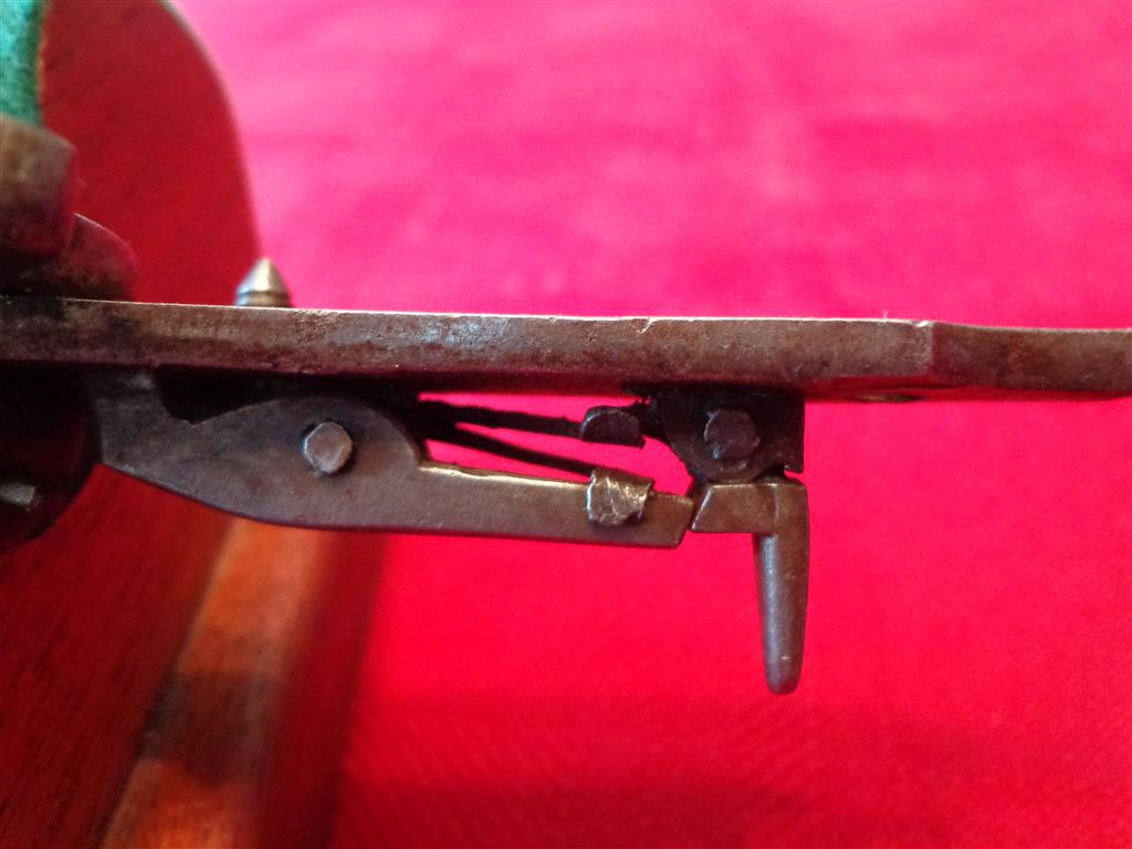

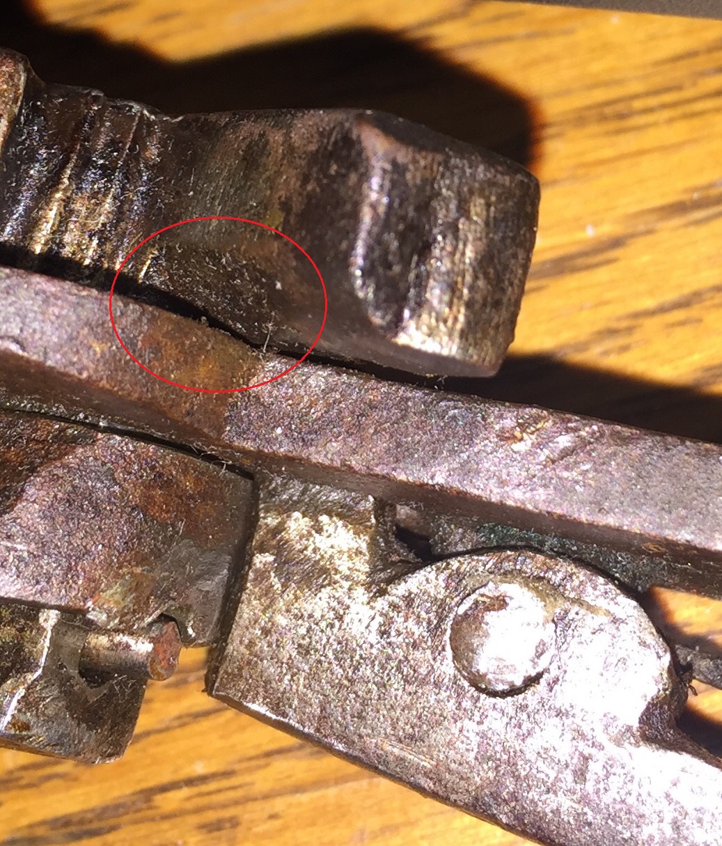

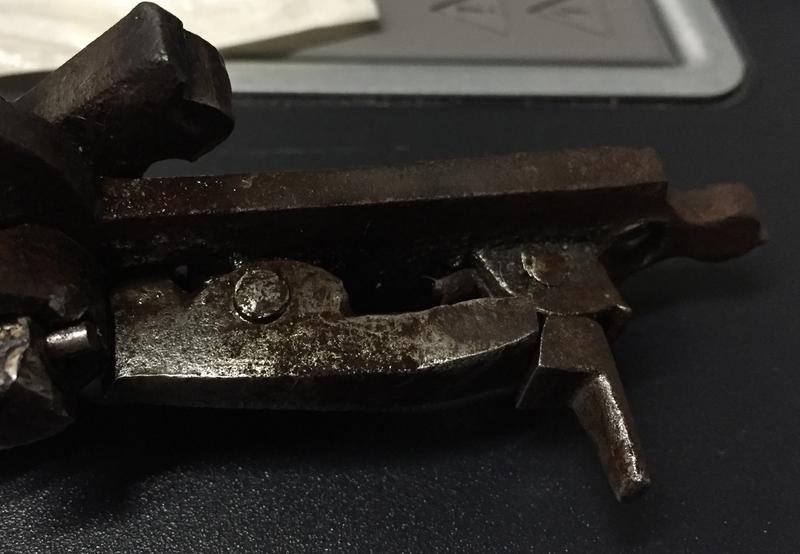

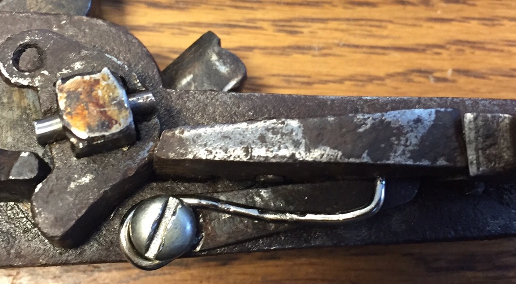

Here's a closeup of where the cock and sear meet. I don't see what I'd call a slot, it's more of a sloping ledge (I circled it in red).
Anyways, I took a binder clip and and put the "legs" between the sear so it'd act as a makeshift sear spring. I pulled the cock back and I felt the lock engage for a split second before the clip few out across the room. I have a feeling even with a proper sear spring, the surfaces of both the cock and sear are too worn down to engage.

Well, you do in fact see how the lock is supposed to work. Great. And yes, "ledge" may be a better word to use here. It appears the sear is both worn and bent. The gun was probably used all the way up until the sear/spring reached it's current condition. Aside from making or acquiring a new sear, the only way to repair it would be to heat the sear and bend the tail straight, and add a small amount of metal via small arc welding rod to the engagement end, and filing to fit. Although, as you mentioned, the ledge on the inside of the hammer may be so worn, that nothing will engage it. In that case, metal will also have to be added to that point on the hammer and filed to mate with the sear. Tough job. But it can be done since the lock and parts are forgings versus castings.
But it would probably be easier to just make new parts using the old ones as a pattern. A sharper cut could be made on the hammer ledge, and a new sear with a slightly longer engagement arm to make up for the worn hammer.
Again, during the period, these locks must have been in a constant state of repair/replacement. I don't believe they had a good knowledge of heat t eating of primary stress/wear points. That's probably also one of the reasons the mainsprings were made extra thick and strong. To make up for the lack of heat treating knowledge.

The replica was made by The Rifle Shoppe, in Jones, OK. Except for the springs and screws, the lock parts are exact castings made from an original lock. Eventually, I'll have a gun made utilizing this lock. They offer a number of early locks for guns.

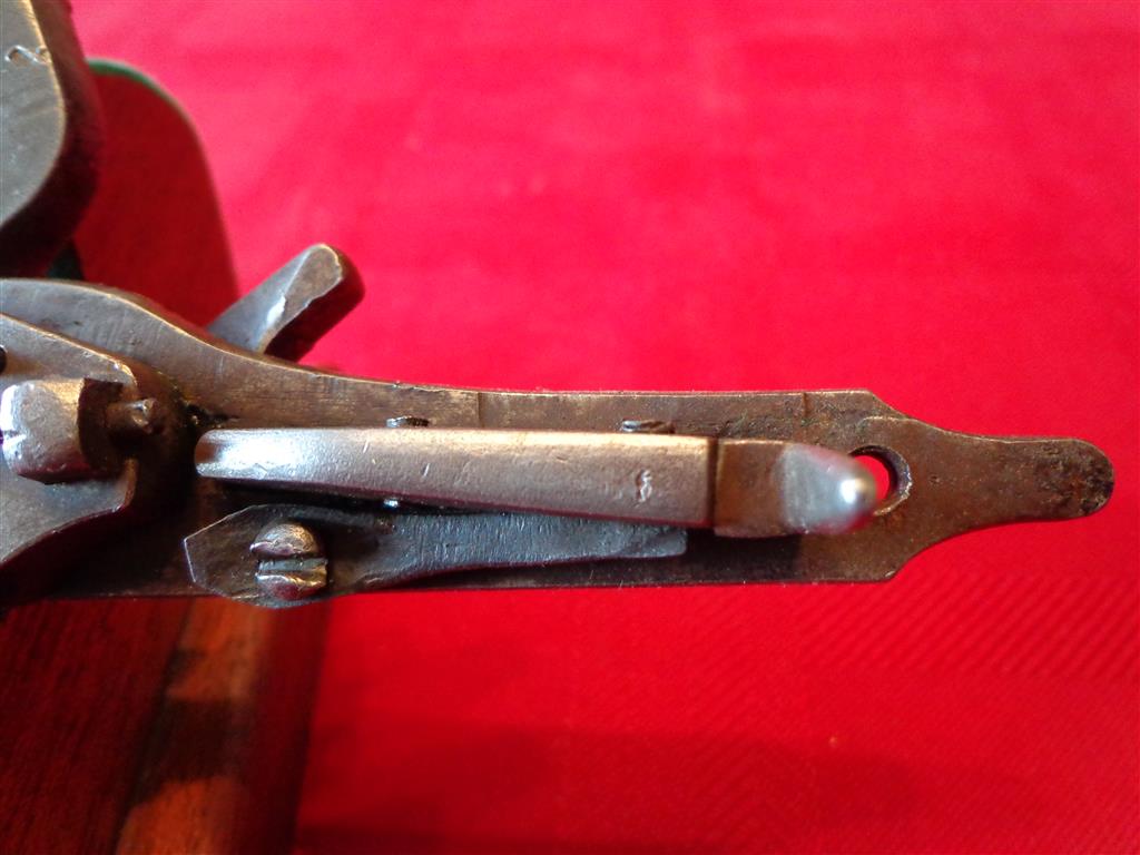

Default Locks
Hi folks,
First, thanks for the compliments; she's a nice old thing, albeit far and away the oddest single gun in my little set so far.
Second, re: locks: I can well believe that these things aren't heat treated; however, I'd be interested to see what the workmanship of the highest-quality North African locks was like. I know that one of my jezails has a native-made lock, and it too appears to be largely devoid of any heat treatment (or if there was any, it wasn't done very well), but my other two both have British locks in them, which unfortunately doesn't make for a good basis of comparison.

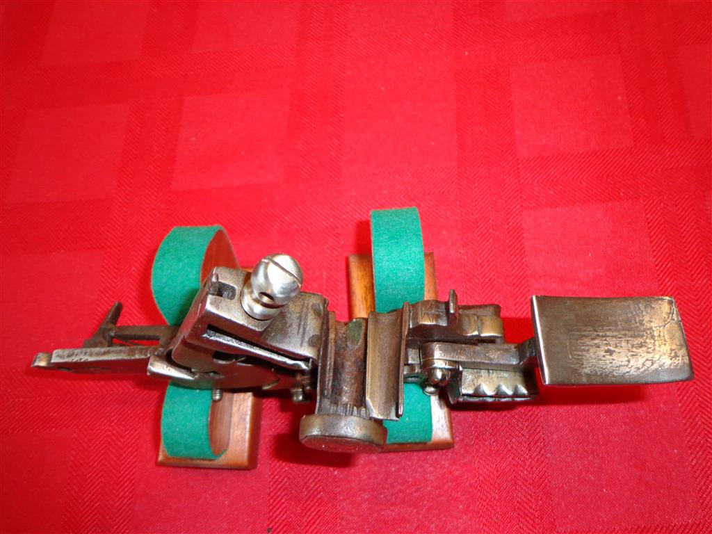

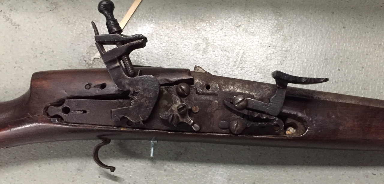

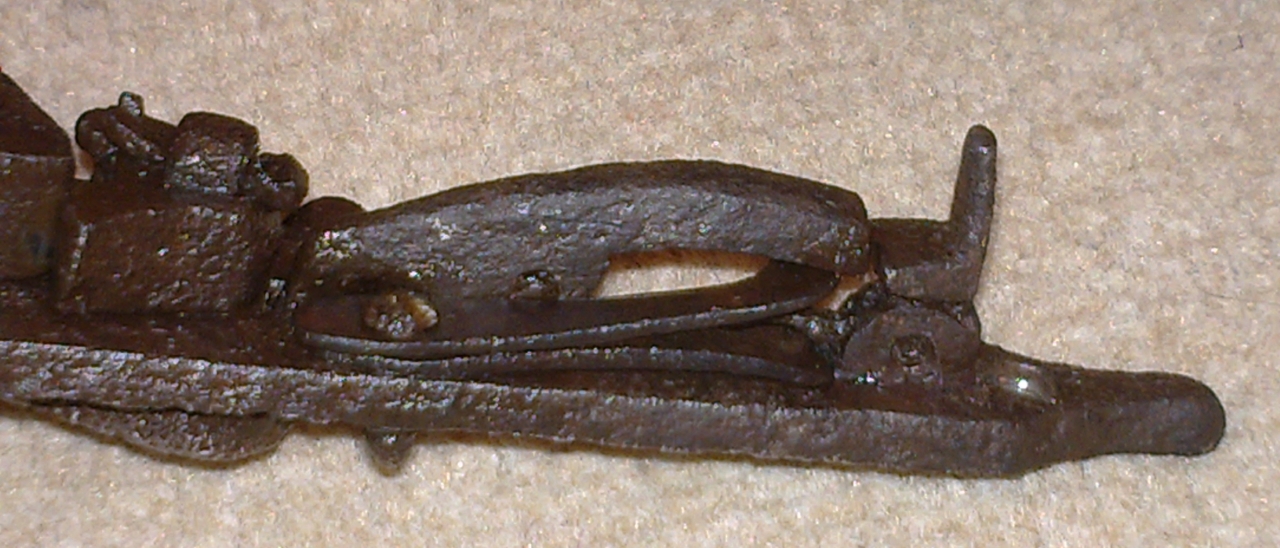

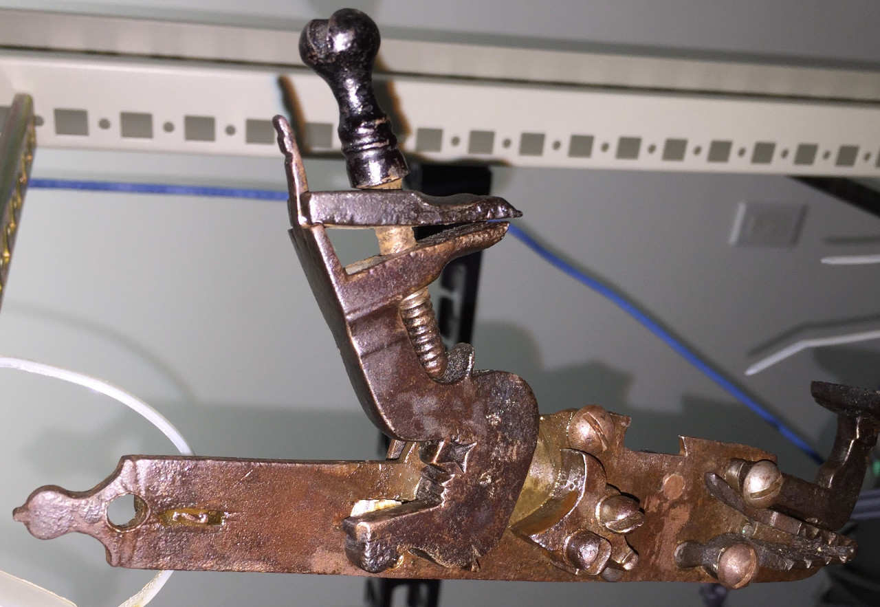

Below are some more detailed piccies of my lock. There's still a fair bit of rust on, as you can see, but the worse is gone and the lock can move, albeit a little slowly. The pan shows evidence of quite significant erosion, but whether this is by localised corrosion or the deleterious effects of powder burning nearby I don't know.
Oh, and rickstl: Mine appears to have been made with holes for three screws but attached to a gun with only two holes drilled in the stock. There's no evidence that I've spotted that there ever was a third, central, hole.
