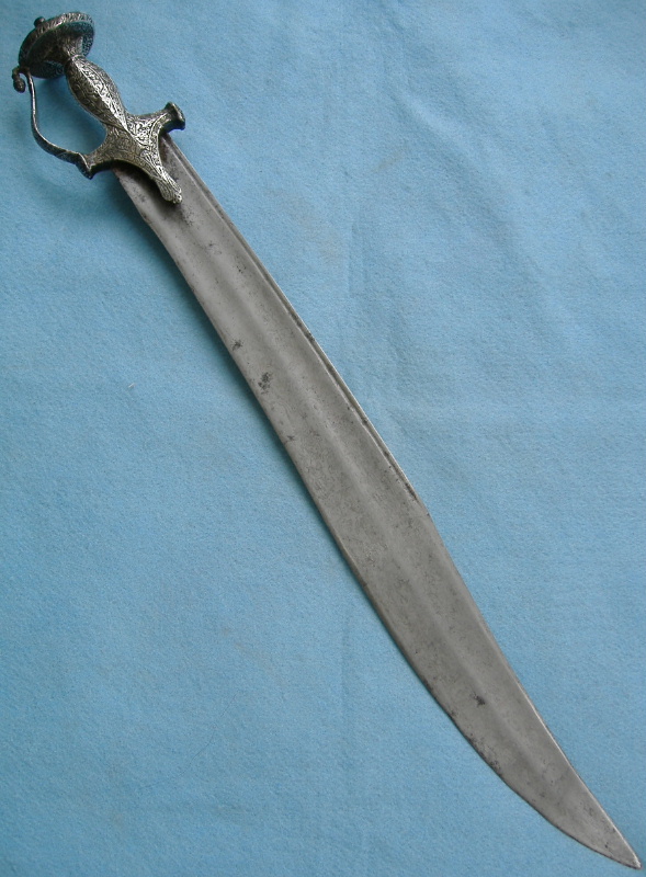

I recently purchased this piece from Ebay. I cleaned it up just a little bit.

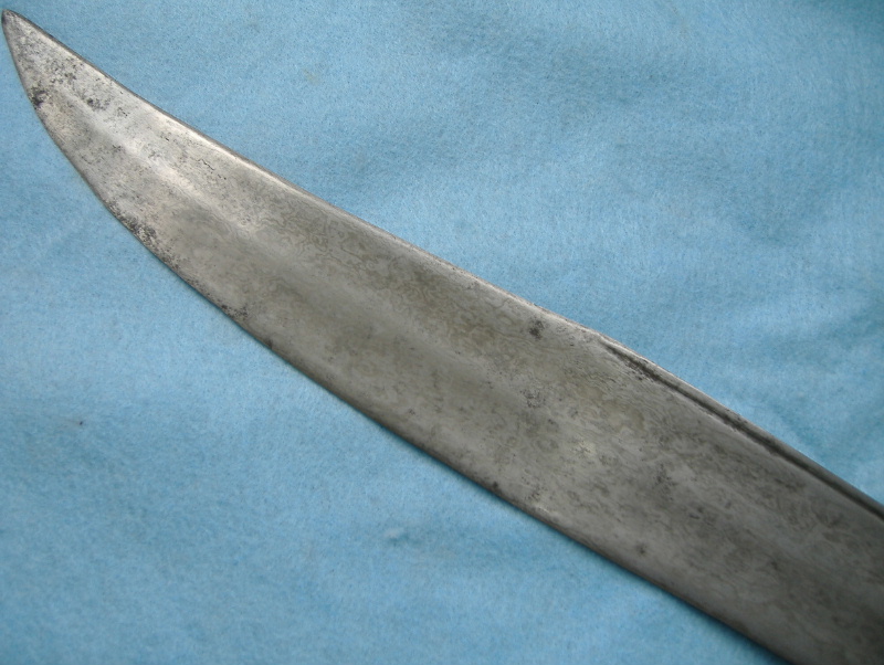

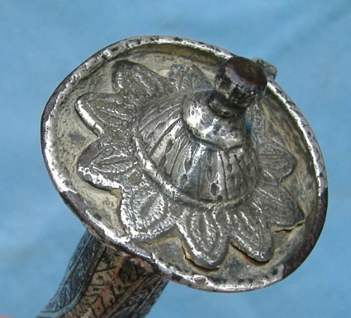

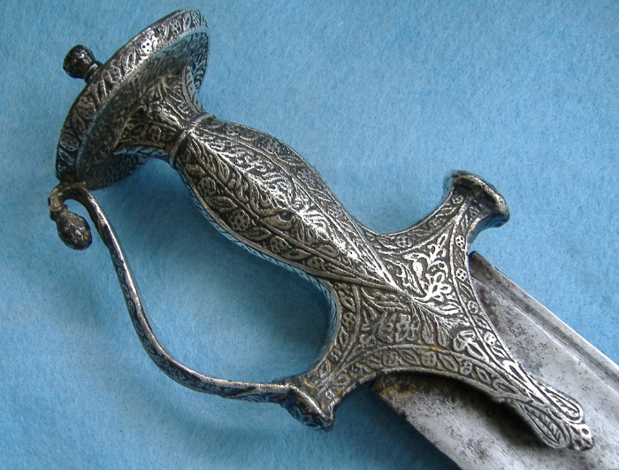

It is a small sword with a wide blade and the hilt indicates it was carried by a smaller person(like me!) It is 27in. in total length. The blade is only 23in. long, but it is just over 2.5in. wide at its widest point. Two shallow fullers are on either side of the central rib. There is a narrower fuller just below the spine. The blade shows a clear color contrast in its pattern welding and the pattern is pretty consistent and it absolutely rings. The hilt is iron chiseled in a floral motif and then covered in silver, most of which remains except for worn edges.
Does this sword, simply by way of its slightly down curved blade, qualify as a sousson patah???...or perhaps a form of a soussan patah. It has little in common with the sousson patahs that have a more traditional longer, narrower, yataghan style blade. Is there a possibility it could be regarded as something else entirely?
Any guesstimates regarding its age??? I am guessing early to mid 19th century.
Does the hilt perhaps give away the region of India frow which it most likely originated???
Looking forward to your insight and comments.

Hi Charles,
I think it's earlier than you think. The hilt is 17thC or 18thC and suggests it is likely from Tanjore.
My opinion is that if the blade would be classed as a 'Kopis' blade, then it is a Sousson Patah. The alternative is a Kirach - and the blades are much straighter on those.
According to Rawson's descriptions - this would be a forward-angled blade, a more modern variation to a 13thC Hoysala sword - this would fit in nicely with the Tanjore attribution.
Good buy - well done!

Thanks for your insight Runjeet. I think the kopis concept is much more appropriate considering what has widely become accepted as a sousson patah. Interesting to learn that you think it was earlier.
The sword has lost some weight due to generations of cleaning, but probably not much and it is very comfortable to weld and very well balanced.
I have always had a weakness for these and truer 'classic' sossun patahs...and I know Battara feels the same way!

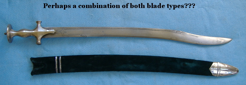

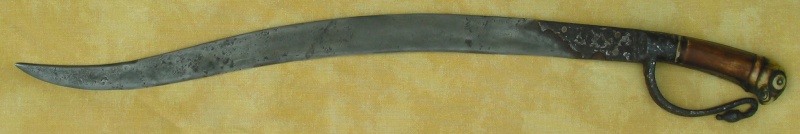

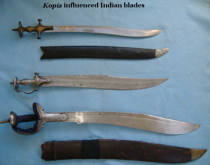

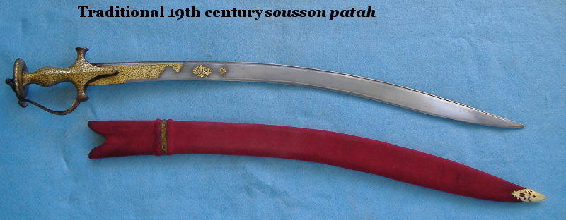

Based on the commentary above I am attaching pics that I believe illustrate the kopis influenced blade styles in several sizes, and the more traditionally accepted sousson patah of the 19th century.
The third picture may be a combination or "morphing" of the two blade types. It is also likely early to mid 19th century with chiseling to mimic a reinforced spine.

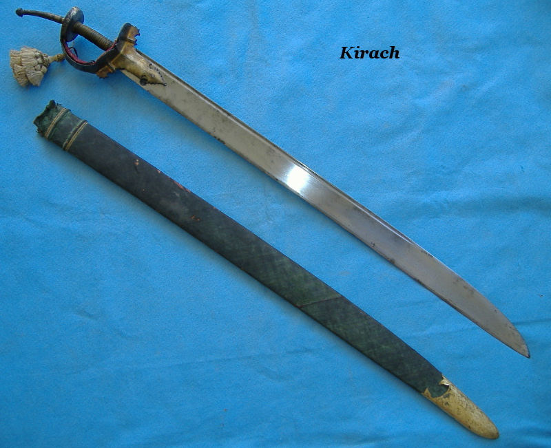

The last picture is of a massive kirach mounted on a khanda hilt.

I think the last blade is a local imitation of Ottoman Yataghan. Clumsy, but even with yataghan- inspired plates at the ricasso.

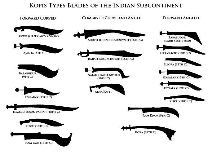

I have on knowledge of this except what I see being discussed on various forums. Maybe the term should be "kopis type" and not "kopis influenced"?
Kopis type blades of the Indian subcontinent. Adapted from Phillip Rawson's The Indian Sword.

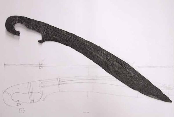

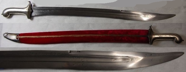

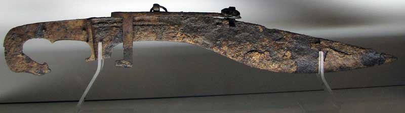

I guess it would be helpful to have an actual Greek kopis here for comparison.
A Greek Kopis sword (from excavations) known as “Falcata” in the western Mediterranean. The Greek Hoplite sword was double-edged. The blade was wider in the middle of its length so that the weight was concentrated to this point. The Greek sword was used equally for perforation of the enemy.

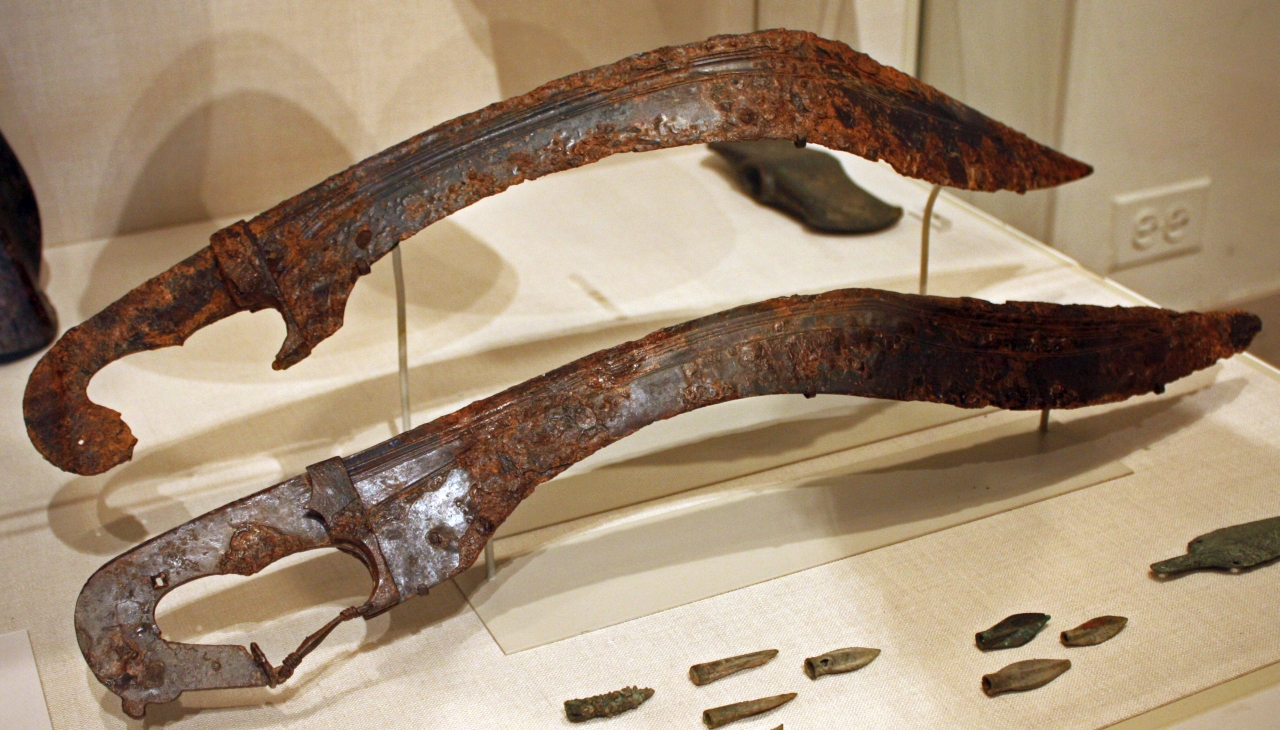

The two below are supposedly in the Met, labled as "Iron Machaira (sword)
Greek, 5th-4th century B.C", the last one is from a museum in Barcelona, labled as an "Iberian falcata".
