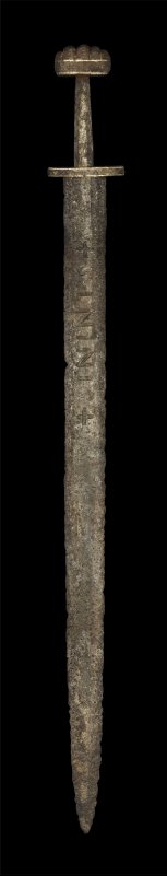

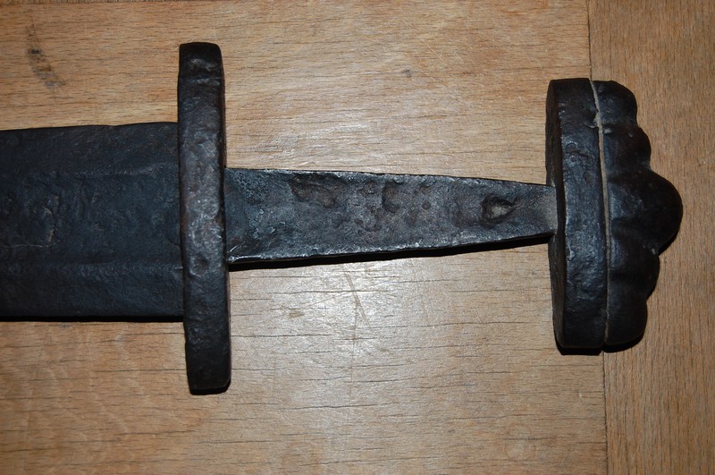

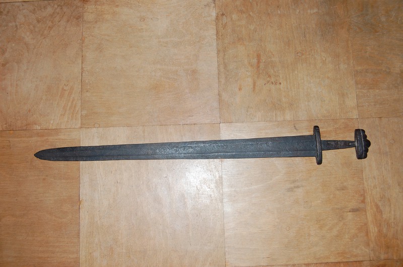

hi guys,
some days ago i saw an old looking sword. at the first view i thought it is an realy old viking sword but my second idea was if it is an mew maded antique looking sword? the reason for these opinion is that the surface form the blade and also from the guear looks to good, the guard is moovable at the angle an by an view inside the guard i could see new rust but no dark patina....
i know there are a lot of old looking sowrd at the market not only form the recent days, these fashion started in the victorian time when a lot of rich peoples in the western wolrd want to buy "old" weapons and armours for their smoking cabinets.
iīm very curious about the opinions from the other members in the forum.
medival swords are not my special branch, so i need your knowledge
thanks stefan

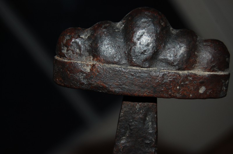

The lobed pommel worries me a bit. Usually these were in two parts with the tang peened through the lower part and then the upper part riveted on. I'm not sure that this is definite proof that it is a replica as I believe there were old examples with single piece pommels.

found this: Saxon/viking sword construction
info on two part and single part pommels.

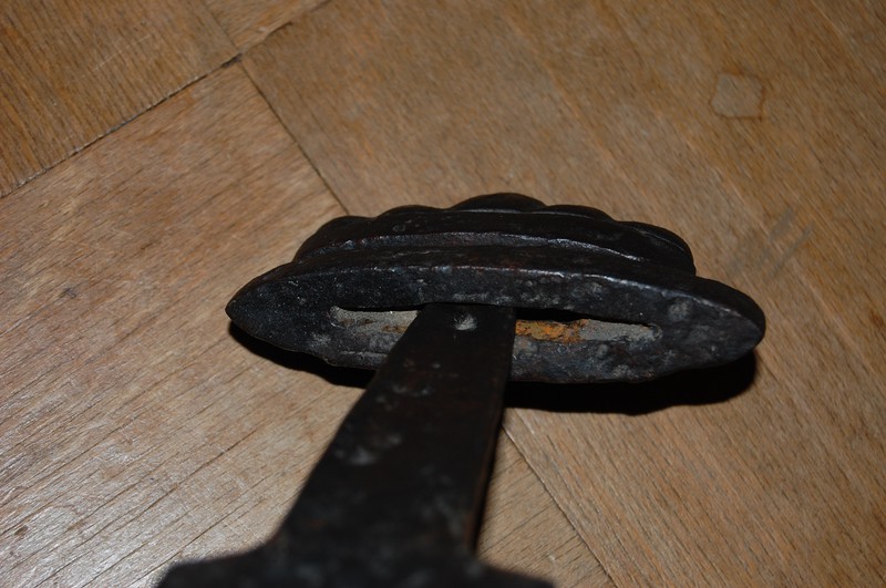

the wide hollow on the inside seems to indicate something would have covered it, which is missing and would have served as a pommel bar/lower guard.

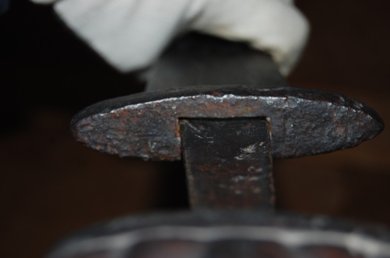

First, dralin23, your skepticism is justified. Only very rarely can I either denounce or confirm authenticity from pictures, and this is not one of those rare obvious exceptions. If this is a forgery, it will not date back to Victorian times, but will be from the last two or so decades and most likely from eastern Europe where the forgers are growing ever so more proficient.
The overall form and relative dimensions appear to be within authentic limits. Your concerns about traces of active (red) rust in concealed places are well founded, but not absolutely denunciatory. The long hollow in the last picture appears to be a typical inset for the blade (the lower guard being loose and having been slid up against the upper guard for the photo).
Often forgeries will be over-decorated in hopes of fetching a higher price, but this sword appears to lack such elaborations. However, usually a Peterson type K (5 lobed pommel with parallel lobes) will have added decoration.
So, in the end, I do not know and I am not even sure that I would know if it were before me in good light. Is there any evidence of an iron inlaid inscription in the blade or traces of perished hilt non-ferrous overlay?

i was looking at the blade and the pommel and the guard too, there are no one trace from an old inscription or an pattern at the surface. maybe it is covered with these thik patina or old rust but i wouldnīt like remove it.
i will ask the old owner from these sword in the next some days, maybe he could tell me something about the circumstances from the purchase. it is intrested to know how was the way from these sword since it come at the open market( years ago). where was it sold in the past, was it an well reputated auctionshouse

one good way to test your sword without destruction is a x-ray investigation.
If it is a viking sword, it must show laminations, an inserted cutting edge or a mechanical damascus pattern. Many vikings swords have laminated high quality steel for the cutting edge and a beautiful mechanical damascus pattern for the rest of the blade.

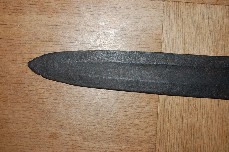

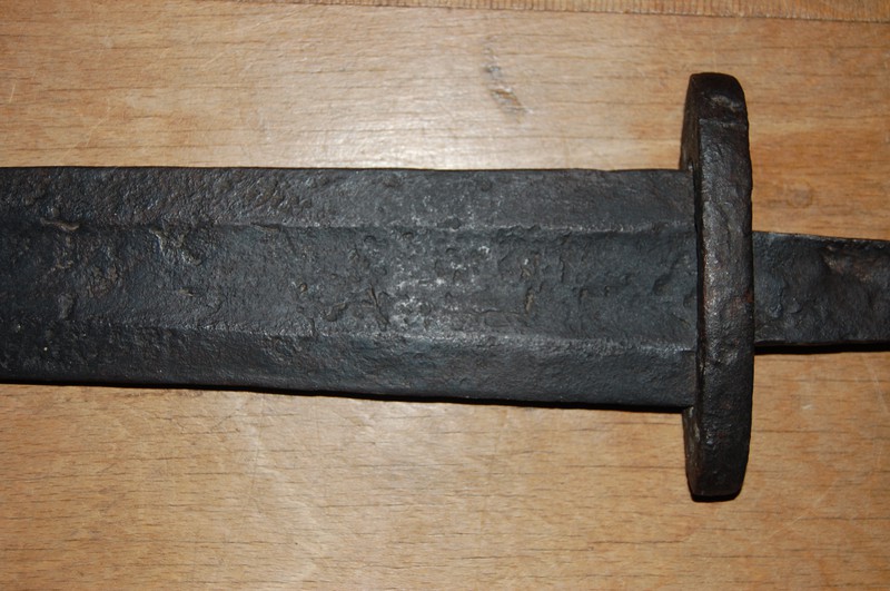

Judging by the patina, as a reenactor smith, I would say that this sword is recently made, chemically rusted and then blackened with motor oil in the forge.
Just an instinctive, rule of thumb judgement.
That kind of black doesn't come from some museum grade compound like paraloid.
And the rusting is consistent with modern steel rusting, some granularity and a few welld efined craters.
Ancient steel would rust in a less defined manner in my experience, with depressions having soft sloping.
Not to mention the lack of pattern welding.
Also the pommel lobes are quite crude if compared to examples that can be seen on the web, being photographed in well known institutions.
Bruno is offline   Reply With Quote

I support Bruno's observation regarding the patina and how the process oxidation / rust is a slow long process that can be read when looking at oxidation by ageing.
Difference in oxidation on Viking swords often depends on where they where found. If they have been lying clay in a fresh water river. If they have been in a grave close to a salt water sea. How much oxygen and water has moved trough the excavation site. What type of dirt the sword is surrounded by and its density and chemical composition. Temperatures trough the centuries in combination with the above. Regardless of the above the process of oxidation on steel that is over 900 - 1300 years is the same. Oxidation might look a bit different depending on the circumstances the sword has rusted in.
The condition of the sword above is what should raise the most suspicion. This Excellent plus condition for a Viking sword. Although I will not dismiss it 100% but this is a above museum grade quality sword and that in it self is reason for suspicion.
I would have the steel carbon dated. Understanding of Metal surgery is a must if collecting early items.
I agree with this... there are some other subtle details that individually might count for little, but taken together the overall result seems just slightly "off".

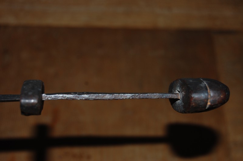

Comparing with known examples of type-K, I can't find a single one where the tang has the convex outline seen here. The tang usually tapers evenly, or has slightly concave sides. The fuller also seems to extend into the tang for an unusual extent?
The shape of the guard is also a-typical at best... a more rectangular shape is expected, whereas the oval shape seen here is more usual of other types (H, V, ...).
The sword shares some of these features with another dubious (in my mind) type-K sold at auction. A456 in the Wallace Collection shows the "correct" details. The pommel in particular is similar to the sword under discussion, but much superior in execution as Bruno has pointed out.
