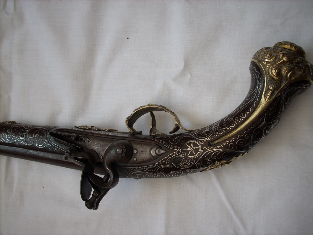

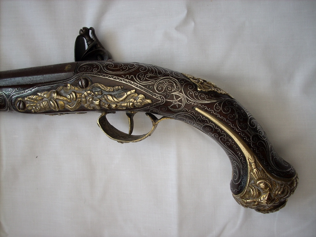

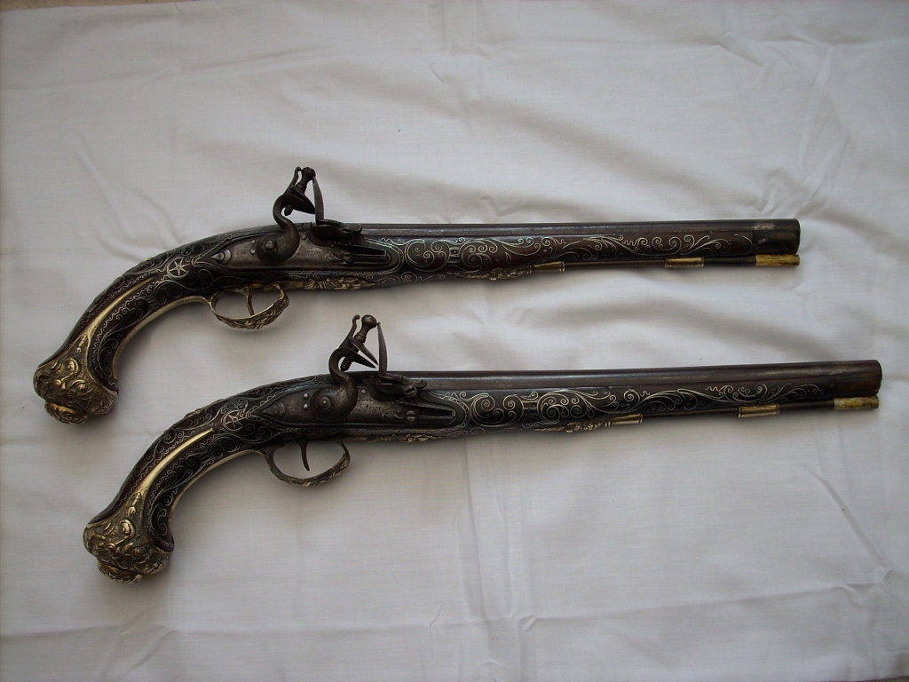

Hello Everyone.

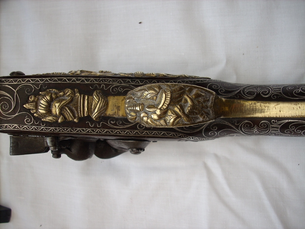

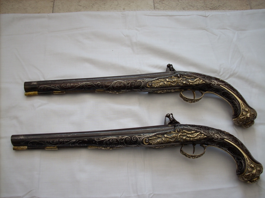

I would like to share these with you for comments and information, if possible.

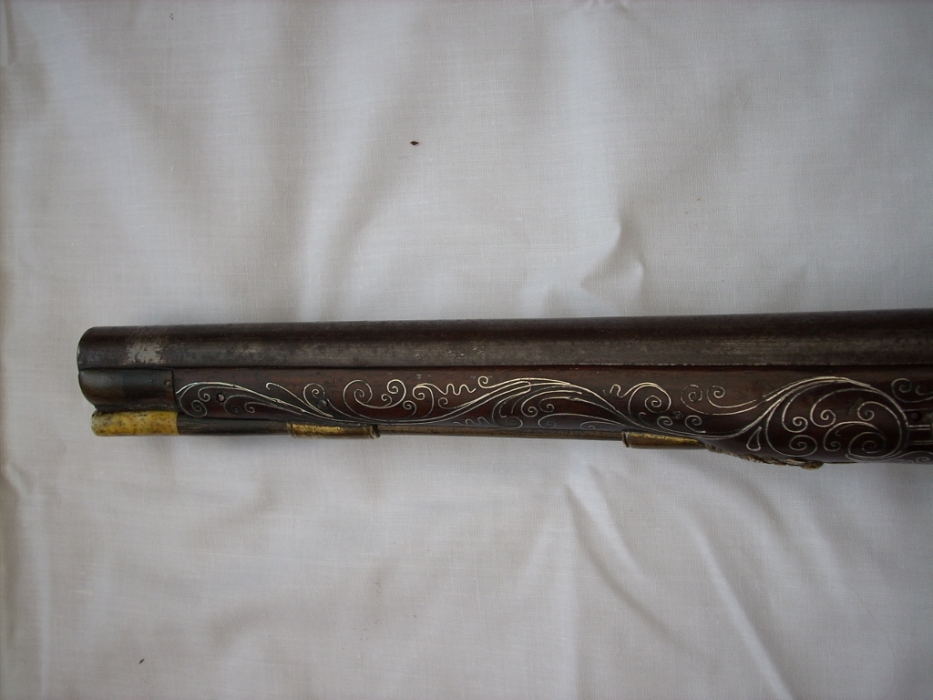

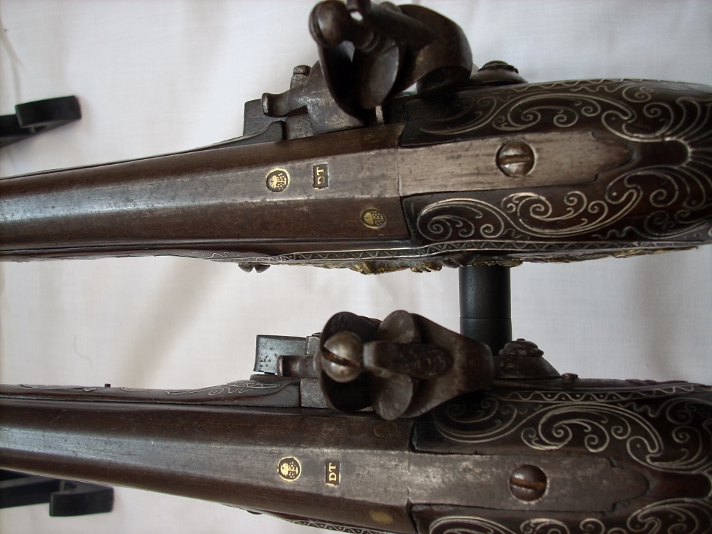

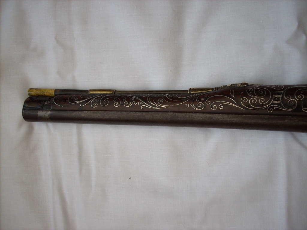

I was told by the Dealer, when I purchased them, that they were Turkish and that is all I know. They both carry clear stamps on the barrels and have the word `ROSSI` stamped on the lock plate. The fittings look like gilded brass or bronze and the stocks are decorated with silver wire. The ramrods are dummies made from wood with bone sleeve at the end. From the light patch in the patina at the muzzle end of the barrels it looks as though they may be missing a band for decoration and or securing the barrels.
These items were and still are a complete departure to my edged weapon collecting but on the day I saw them I was pretty flush and just could not resist them as I liked them so much and still do, I suppose its what is called an `impulse buy`. Anyway I digress and would ask the more knowledgeable members of this type of weapon if they could provide more information on them. Thanking you in advance.
Miguel

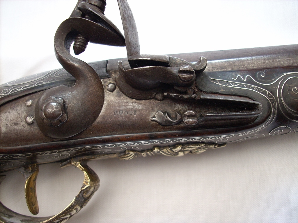

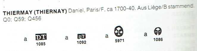

In the "Neue Stöckel" there are 18 gunmakers with the Name "ROSSI" in the area of Brescia and Genova/Italy. Francesco Rossi has been working at Brescia in the years from 1775-1788 and Lorenzo was 1743. So it is thinkable that the lock has been made by one of these.
The mark "DT" together with the other mark belongs to a Paris gunmaker named DANIEL THIERMAY who was working there from 1700 to ca. 1740.
So it is clear that the pistol has been made out of parts with different origins. Who this made and where this pistol has been assembled I cannot say but lots of these pistols have been made not only in Turkey but also in the area of Napoli/I

That is a very nice looking pair of Ottoman styled horse pistols. And, thanks to the information supplied by Corrado, we could place these pistols in the second or third quarter of the 18th Century, which would be a real plus. (Assuming the locks and barrels were not re-used later to re-stock the pistols. But I don't think so in this case). And I note the brass European style triggers. Giving us another clue to possible European assembly. But they could also have been assembled at one of the gun making centers in the Balkans, utilizing the European locks and barrels. We'll probably never know for sure. But these pistols give strong clues of possible European manufacture for export to the Ottoman market.
Noting the missing patina, the wood, and the location of the front barrel pin, it does indeed look like there were originally reinforcing bands at the muzzle. Which would also be common for these pistols. Curious they are missing considering the great condition and completeness of the rest of the gun. Hmmm.

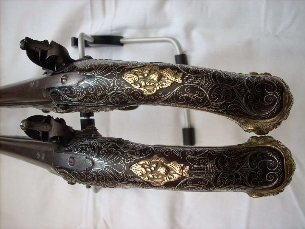

Another interesting note: Notice the lack of a screwdriver slot on the outside of the decorative hammer screws. This leads me to believe the hammer is held fast to the tumbler from inside the lock. It's not unheard of, but you seldom see this feature on locks. Very interesting.
Again, great looking pair!!!

Hi Rick,
Re the hammer screws....have you considered the possibility that the petal shaped edging could be to facilitate the use of some sort of "key" to attach the hammers?
Stu

The missing slot in the hammerscrew is very common at locks made in Brescia, where the gunmaker ROSSI has been working.

Hi Stu. No, I was under the impression that the hammer was secured to the tumbler, in some form, from inside the lock.
Corrado: Thanks so much for the photos and information. I just learned something new on Italian guns. Very interesting. Thanks again.
Miguel: Yes, super nice pair of pistols, with more ID than usually encountered with these pistols. The barrel and lock ID are a real plus. Congrats.
