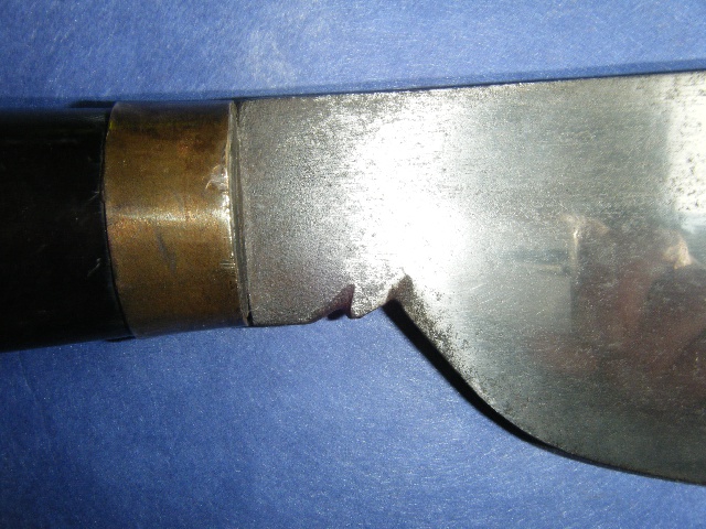

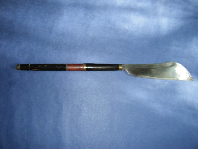

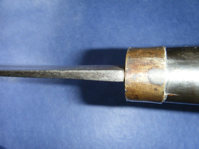

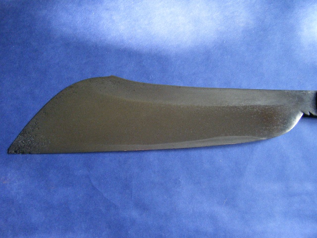

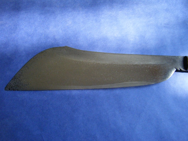

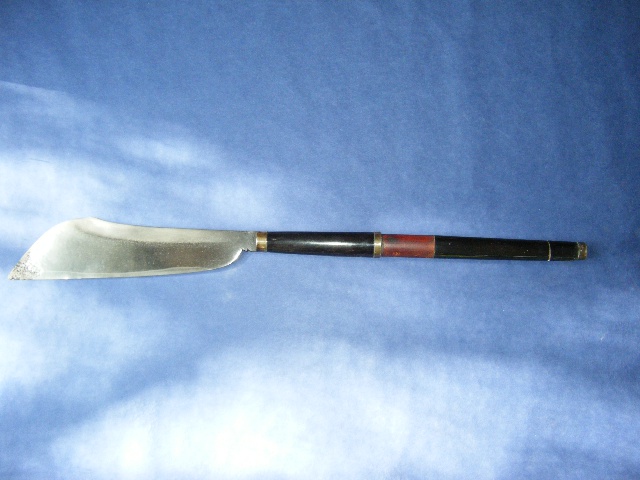

By my last trip to Indonesia I get a completely rustet stick sword from Solor (see Albert G. v. Zonnefeld, Traditional Weapons Of The Indonesian Archipelago, page 129). I have had removed most of the dark rust. After I have shown this sword to our member Roland M he offered a polish and etch of the blade. So a big "Thank" to him for the great job he have done. The blade show surprisingly a hamon at the edge. This blade is a high quality forged blade. Enjoy the pictures of this very rare weapon.

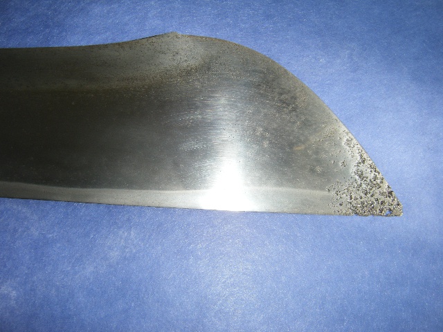

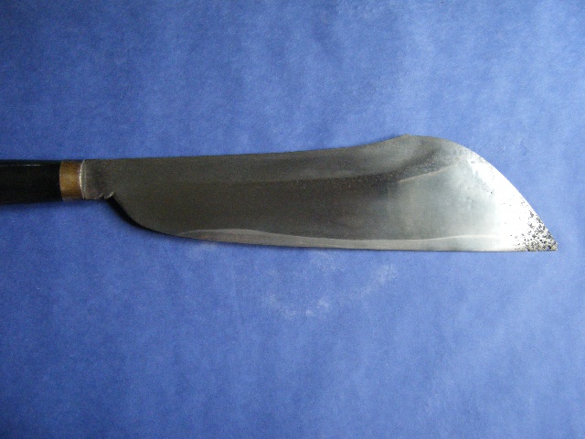

I just ask: why is it surprising?
Old 13th March 2016, 11:41 PM   #7
Posts: 9,727
Hello Timo,
a hamon I know from dha but I have seldom seen it by Indonesian blades, most of the time this blades are laminated. To create a hamon is not easy and I am nearly sure that this blade wasn't forged by a local blacksmith from Solor.
Sajen is online now   Reply With Quote

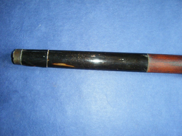

I have collected since the 70's and these are the only two I have ever seen. Both are horn, wood, horn although the horn is wrapped around the wood on the pommel end so I think they are one piece wooden hilts with horn decoration.
Sajen, I think you are correct about their rarity. Not surprising seeing the size of the Islands.

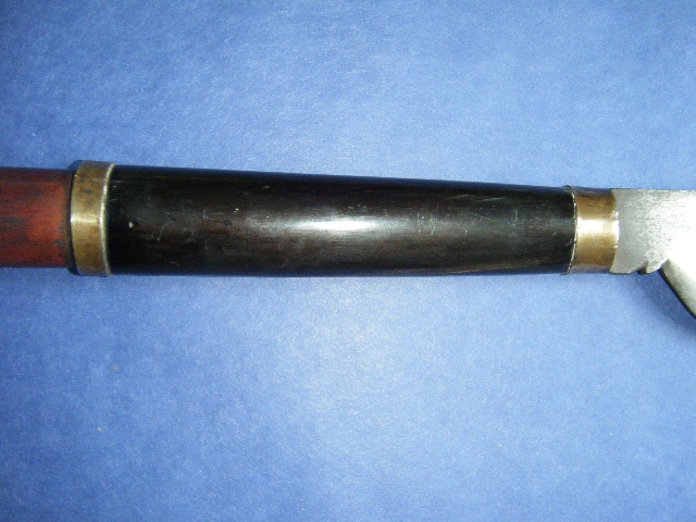

I forgot these two photos. Note how the pommel end shows wood with a thin layer of horn wrapped around it.
For low-tech metalwork (i.e., unknown carbon content, no thermometers or temperature controlled ovens), differential hardening can be easier than trying to achieve a uniformly non-brittle hard blade.
Hi Timo,
This blade is no low-tech metalwork, the blade is thin, tough, very sharp and absolutely flawless forged. This blade was forged by a master blacksmith. It is made from unknown type of crucible steel with very low contrast structure, possibly wootz. The high resistance against abrasion is an indicator.
A skillfull differential hardened blade has a very uniform hardness along the cutting edge. Differential hardening with clay on the blade is always more difficult than uniform hardening, especially if hardened in water. Many things are important like the temperature of water, the hardening time, the consistance and mixture of the clay and so on. The volume of hardened steel is bigger than unhardened steel, this causes tensions in the material. Even the best Japanese swordsmiths have lost blades during the hardening process because of hardening cracks (Hagire).
The temperature of hot steel can be controlled by its color. Well trained eyes do this with a precision of +- 10°C.

In my opinion this blade is clay tempered, otherwise it would not have such a clear and bright hamon.

Originally Posted by Royston
Yes, I know, I am being greedy.
Roy
Hello Roy,
thank you very much for posting your two nice examples, the one in up seems to be very similar to my posted example. May I ask how long it is overall and the length of the blade?
It's most interesting that the handles are not simple wrapped with horn but the horn is covered with a piece of horn without a joint, a technic I never have seen before. This is also the problem by the restauration of my other example.
Again, two very nice and rare examples you own!
