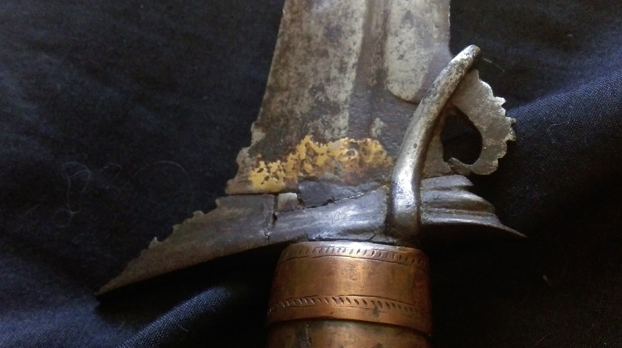

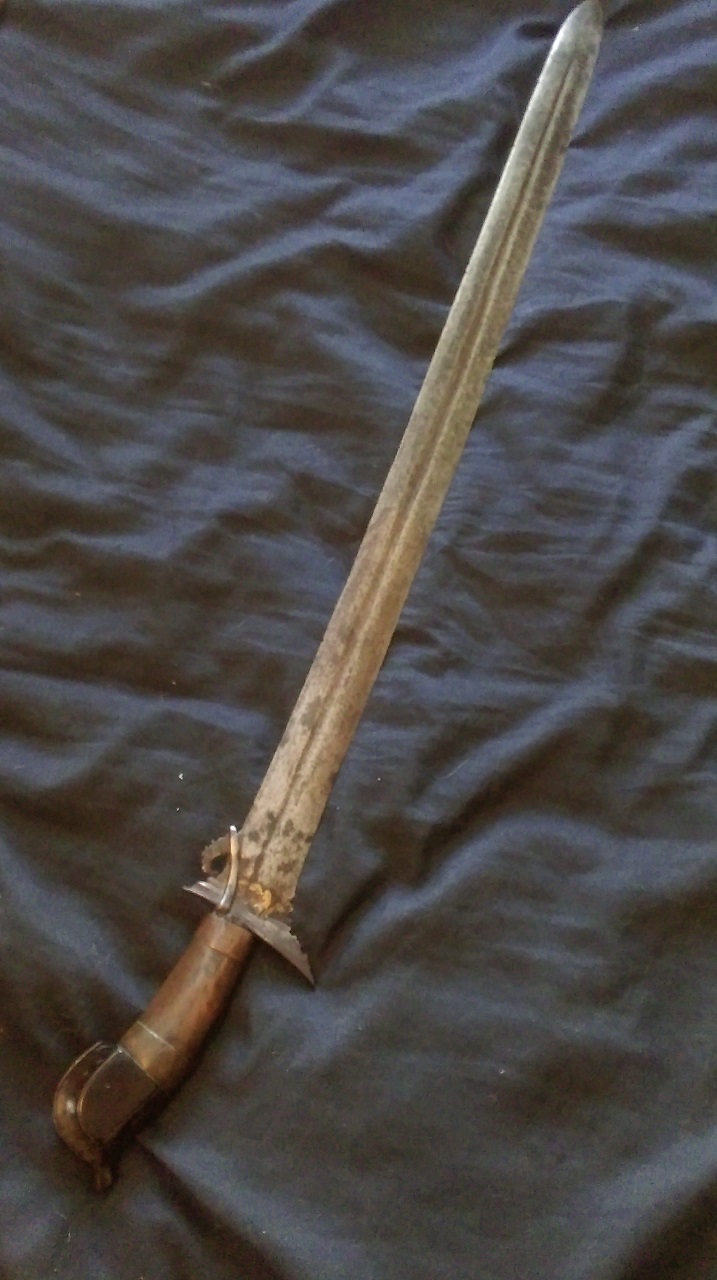

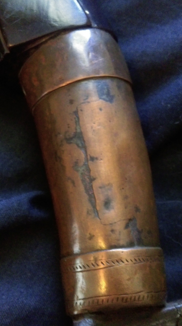

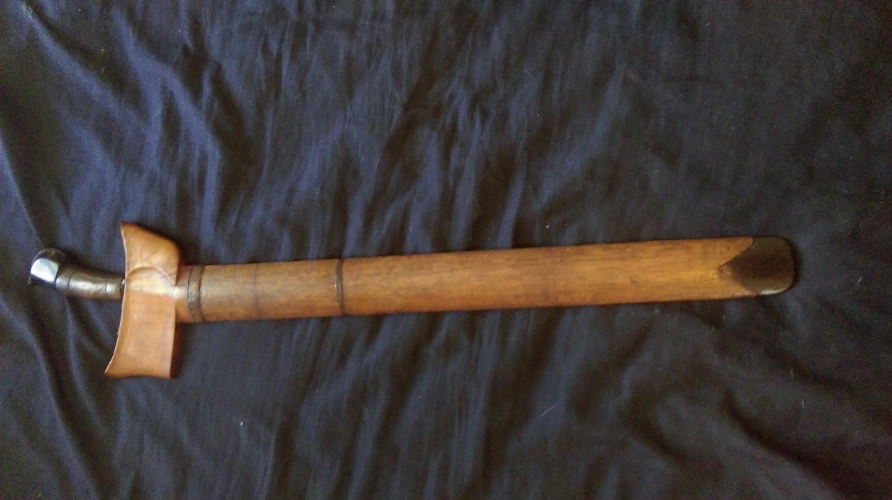

A recently acquired Malay sundang that I finally got around to taking some pictures from. Purchased from a fellow forum member, who thought it might date to the late 18th/early 19th century, but I'm happy to hear any dissenting opinions.

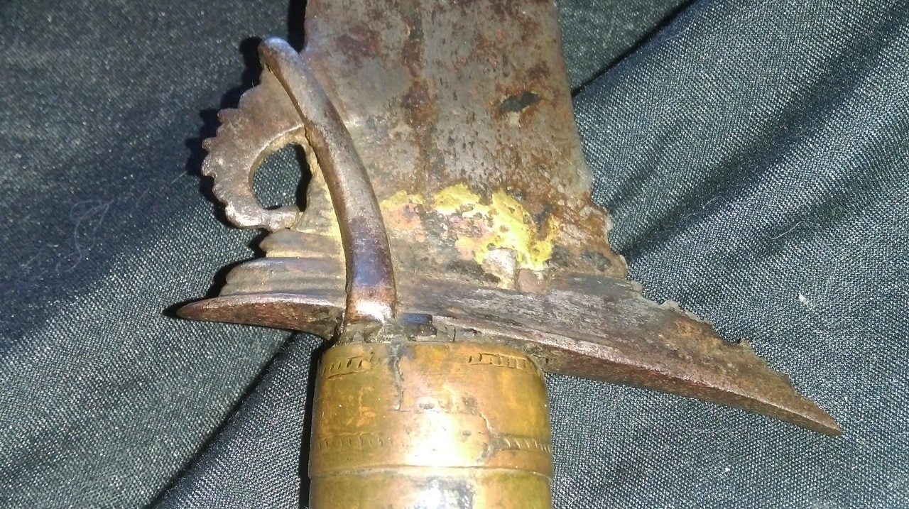

27 inches long over all, blade has a single fuller, and an old repair to the ganja/blade, probably done with brass. Blade has a single "stirup," which looks like silver. Handle is copper with a simple engraved design around the edges. Pommel is a small kakatua, probably of a dark wood. Scabbard has a copper band, and several bands of twisted copper wire. Scabbard also a horn insert at the end.
I plan to spend some time with this in the future, polishing the copper and the silver, and cleaning up the blade a bit.
I'd be happy to hear any and all comments on, or tips on clean up of, this old warrior.

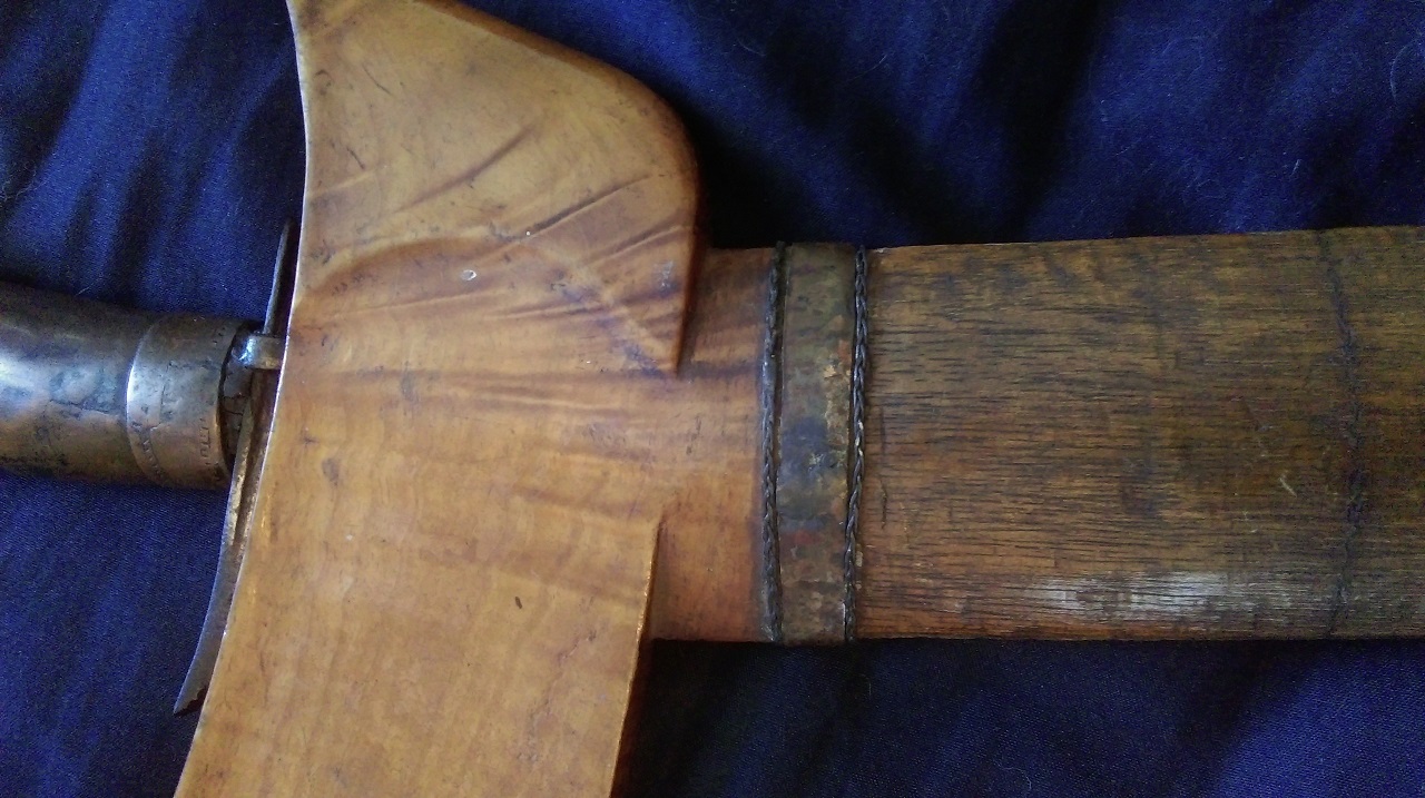

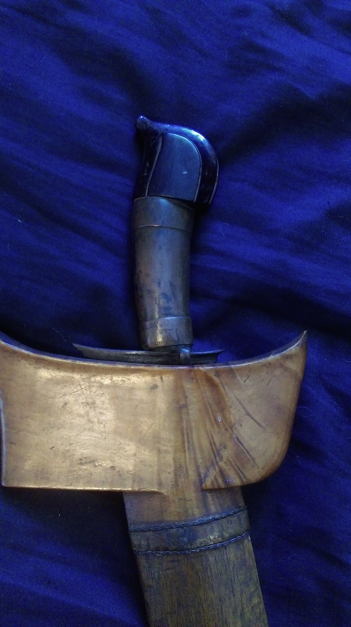

nice old one, the braised tang repair if done correctly should hold it together reasonably well, but it's probably not up to full combat efficiency. should clean up well for display tho. the scabbard bands appear to be braided 3 strand turks head style, not twisted, which you could replicate for the one that appears to be missing. here's a link to an excellent thread here on how to make them in rattan, which if you are careful and practice for a year or two would work for wire.

I assume he meant turn of the 19th century (1890ies/1910ies)? For Malay sundang we don't have any established chronology nor specific stylistic details to go by when trying to date a piece. The straight gangya line doesn't make this an early kris, I'm afraid.
I could live with a rough guesstimate of the blade being probably antique or possibly close. Also the crosspiece and probably the pommel do seem to have some age. The stem of the scabbard as well as the grip look like more recent work IMHO.
I'm not sure the tang is affected/repaired as suggested above - looks more like a part of the gangya broke off?
For working up the blade, I'd suggest to completely remove the hilt and the clamp. The base with the repair will be difficult to work on; if you go for polishing the whole blade, it may be worth also cleaning/polishing up this area (removing most solder on the blade) and repatinating the remaining brass(?) after staining the blade. Maybe an exploratory cleaning and etching of the upper half of the blade might be a good idea to look for laminations and decide how much effort to invest the whole blade?

I think you're absolutely right, when comparing how they look to Tito Gunong's absolutely fantastic, I agree, they are absolutely braided 3 strand turk's heads. I'll need to start practicing....

Yes, I agree, I looks like the ganjo was definitely damaged at some point. However, since brass is present on both sides of the blade I think that maybe there was something to the base of the blade as well?
re:cleaning up
Can I assume that the blade is held firm via some sort of pitch-based resin in a Malay context? And if so would the method of holding the blade to a candle method work for removing the blade? I'm not sure I'm skilled/equipped enough to remove solder. Removing the hilt might be near my current limits...
To be honest I was mostly intending to just do the whole increasing grades of sand paper over the blade into 0000 steal wool, and polishing the copper and silver. Would it be worth trying to etch the blade? I thought lamination was fairly rare on pieces like this. Any recommendations you (or anyone else) have on this would be fantastic.

I'm with you and also strongly recommend heating the base of the blade with an open flame: either a candle and lots of patience or a very gentle/flickering torch flame and being even more careful! Once the heat dissipates into the tang, it is usually fairly easy to remove the blade. Don't worry, the flame doesn't hurt the blade but try to get as little direct heat at the hilt. I usually wrap the grip with some cloth and wear gloves. Especially for the pommel this is a way more gentle approach than the cooking procedure described above! (Not needed for any SEA blade I tried to remove and I also doubt it is really called for when working things khukuri - heating Nepali blades did for me so far but my experience is admittedly very limited.)
The clamp is quite loose (looks a bit large for this kris) - once the resin softens due to the heat, it should be easy to gently bend it aside so that the blade can be removed from the hilt. When the tang starts to wiggle when gently pulling and twisting blade vs hilt, keep gently heating the blade until the tang comes off easily. If it doesn't, let it cool down and try again next day; even stubborn ones do come off after a few cycles.
Old 9th January 2016, 01:29 AM   #13
Hello Leif,
Nope, I believe he meant 1790s-1810s. Part of why I solicited dissenting opinions. Though he may have only been referring to the blade.
I was also focusing on the blade: IMHO it is very unlikely to be 200 years or older (based on workmanship, etc.). It does seem to have some age though and also some wear.
It's possible. To me it looks more like a pretty sloppy job though which probably was supposed to fix it to the blade again.
I'd probably only try to remove the solder smeared onto the blade surface - that will interfere with polishing and etching! It's rather soft, so it's not that difficult. However, I'd strongly recommend an exploratory etch to verify that the effort is really worth it!
Yes, that will help a lot! (However, it's much easier to work on the bare blade rather than trying to work around the clamp/etc.)
BTW, I don't think steel wool will do much good once you move into the finest sandpaper/stones. Use a polishing compound if you really want a perfect finish - usually not needed though, especially before the first etch this is almost certainly overkill. No power tools - only elbow grease!
I'm pretty confident that this blade is laminated - give it a try!
