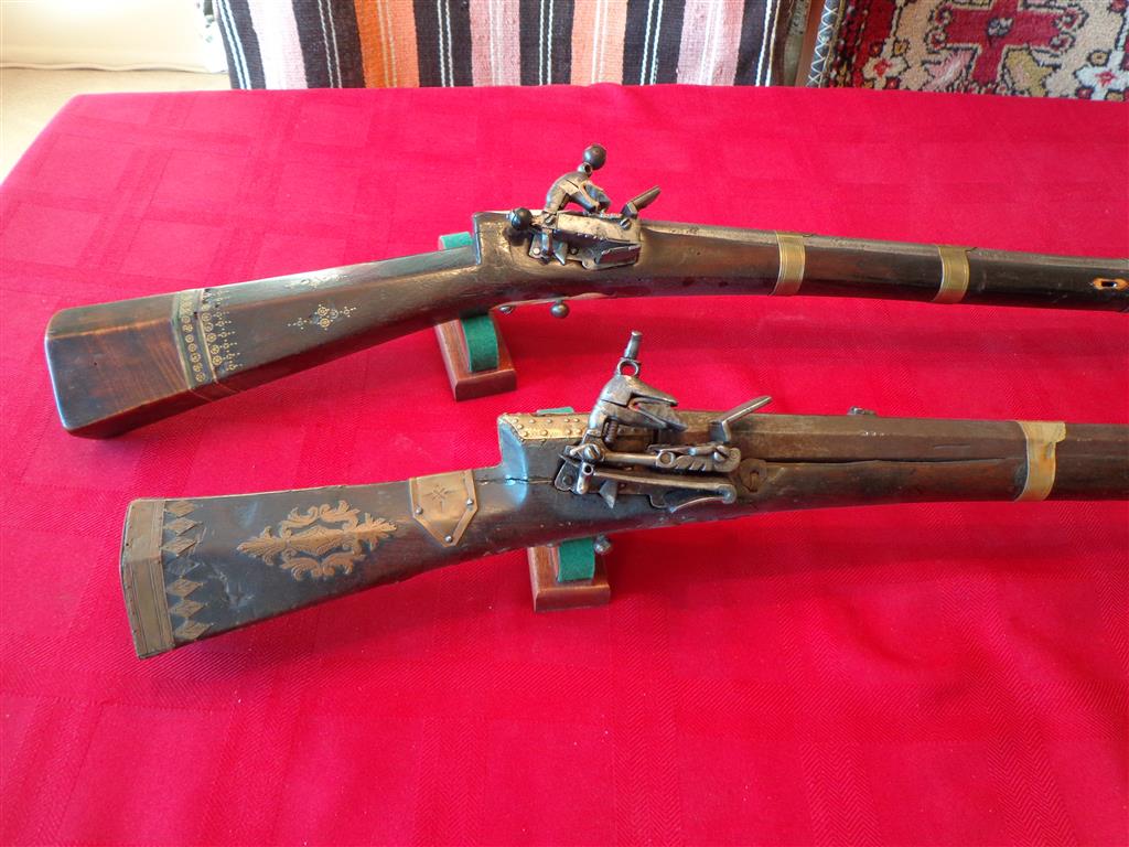

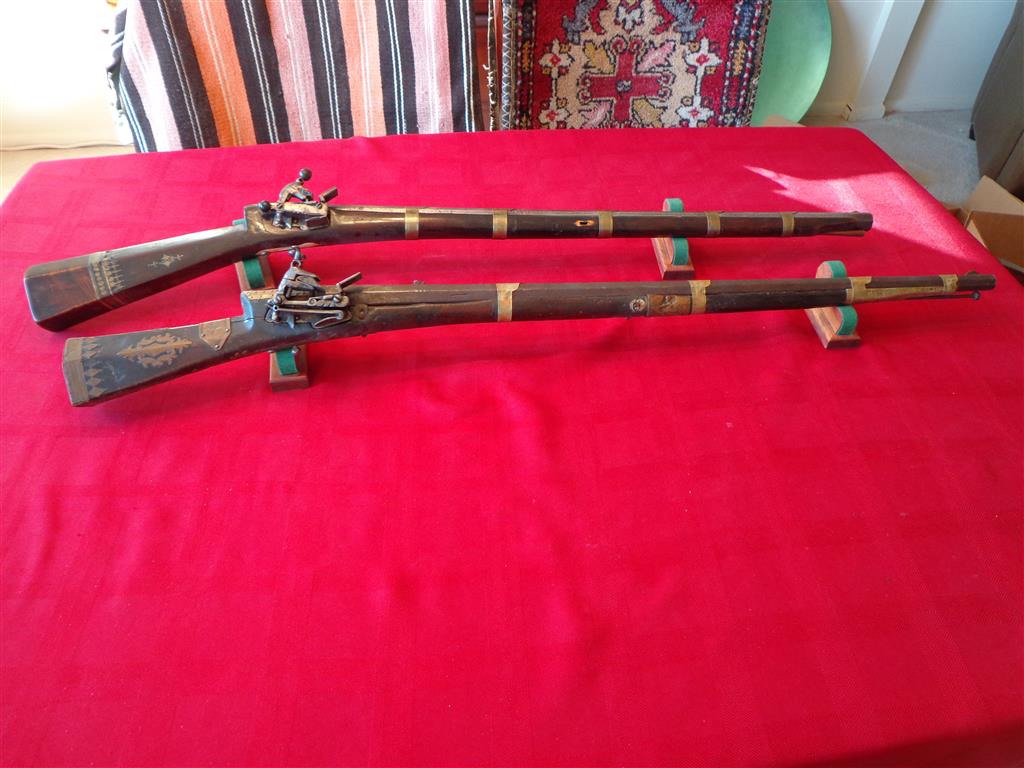

Here are two typical Ottoman style long guns. The top one is a rifled barrel, and the lower one is a smoothbore. The top gun has a Length of Pull (LOP, as measured from the trigger to the rear of the butt stock) of 12" (30.48cm), which I have found common for these guns, and is probably about right for the stature of an adult male in this Region during the 19th Century.
However, the lower gun has a short LOP of only 9" (23cm). Which is a full 3" (7.62cm) shorter than the norm. Yet it does have a rear sight for aiming.
So my question is: Why the very short butt stock? And I'm sure that some of you gun enthusiests have noticed how some of the Ottoman guns were intentially built with these short butt stocks, yet have more or less full length barrels. If you try to shoulder and aim the gun in the normal matter, wheather from the shoulder pit or the upper arm, it's a very uncomfortable, un-natural postion. And your face would be way to close to the lock when firing. Yet the barrel does have a rear sight. Meaning it was designed to be aimed. So, I can't really understand the purpose of the very short butt stock ??
My only theory so far is that they were designed to fire from the cheek ala Japanese matchlock style (?)
Would appreciate hearing other opinions. And thaks for looking.

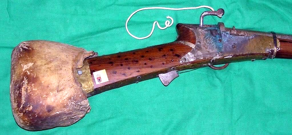

First, the butt was protected by something like on the photo attached.
Giving you more confort and distance from the lock.

Some interesting suggestions you offer here. Hmmm. The leather recoil pad would make sense. But I've never really seen one of these used on an Ottoman style gun, like you do on the Arab/Omani style guns. The wall/rampart idea is possible. But these are usually, as you mention, the very heavy barrel wall guns with the wide/thick stocks.

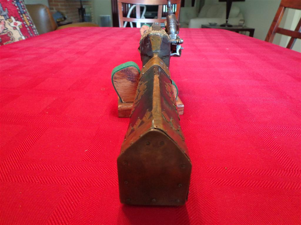

Hi Grendolino: Yes, I know exactly what you are saying with the rear of the butt stocks often being made in sections, and decorated as you mentiond. But in this case (and others that I have handled and seen in reference material) has a butt plate nailed to the stock. And the patina of the brass matches the rest of the brass decoration exactly. So this short stock gun was made this way.
Hi Estcrh: See pic below of the short stock gun with the brass butt plate.

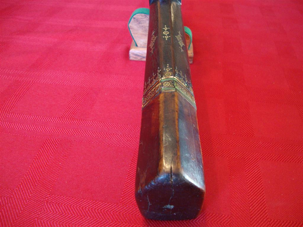

Also the butt of the first gun with the full length butt stock with no evidence there ever was a butt plate. Which would have possibly kept the crack in the stock from forming.

If you bring the short stock up to the cheek and aim the front and rear sights, it aligns perfectly. Since both of these guns are live shooters, I can attest that the cheek stock gun is actually a bit faster to aim and fire than the shoulder-stocked gun.

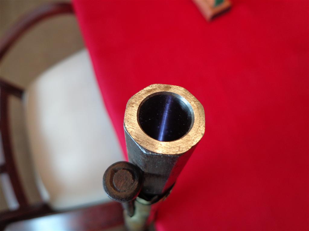

The cheek stock gun was originally a smooth bore, and now has a new smooth bore liner. The shoulder stock gun was originally rifled, and now has a new rifled liner.
