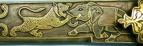

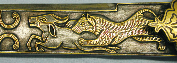

Decoration on blades have during time been very different, sometimes the decoration was ‘only’ the watering, sometimes it was inlays or maybe koftgari, but now and again it was something quite different – animals cut out of the steel, and inlaid in gold or other precious metals, and the artists were good - very good, they were masters.
Have a look at this.

wow! That's a tulwar?

Oh, my. Those animals are carved into the blade.
Jens, will you post photos of the full sword, please? I'm eager to see more.

Interesting that both animals being attacked art domestic animals, bringing the hand or representation of man into the struggle. I don't think a leopard will really attack an elephant; it may be "same as a lion" (my favourite name, I think, for an animal; "what's that animal?" "It's equal to a lion." 'nuff said about it.) but I don't think a lion will do that either; I have heard that a tiger will upon ocassion, or lions in a gang....nice carving though, and there seems to be some evocation of the purpose/excuse for an heroic/armigerous class in the attack of domestic animals by wild ones.

I like the Indian blade with carvings, the animals are not made stiff, they are moving, and you can see it – true artists make carvings like this.
Most blades showing animals fighting or walking in procession are hunting swords, which of course does not mean, that they could not be used for other purposes. On both sides of the blade is an inscription, one in Farsi and the other one in an Indian dialect.
A strange thing is, that the hand guard can be screwed off, but it is clear that the screw thread is handmade. In Leo S.Figiel’ On Damascus Steel, pages 104-5, you can see a hilt very much alike, but whether this hand guard can be screwed off is not known, as he does not mention anything about it.
