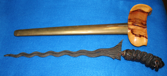

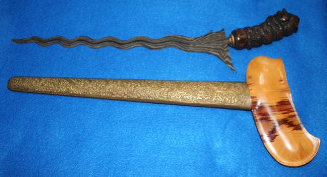

This is a fairly recent purchase. I believe it is from Java, but only because the seller thought so. I imagine is was meant as a display item, but could also have been a tourist piece. It is not a weapon (IMO). I like the split blade and the little guy that serves as the hilt. He looks like he is wearing a baseball cap, which I find amusing. Comments welcome.

I wouldn't call it a display item or a tourist piece Harry. You haven't really provided very good photos for a better assessment though. I do suspect from what i can see that yours is a fairly recent one, late 20th century or later. Very hard to tell without clear close-ups though. The crack was probably intentional rather than being a forging flaw, but it is hard to tell in the photos.You are probably right that this keris was not intended as a physical weapon, giving this long crack in the blade. Keris serve many purposes within Javanese culture and sometimes their purpose is more talismanic than practical. They also serve as an aspect of formal dress. So no, this wasn't made specifically as a wall hanger. There is some lore about the mystical power of gazing through such openings made in the blade. When these openings are made with this purpose in mind it is called combong.

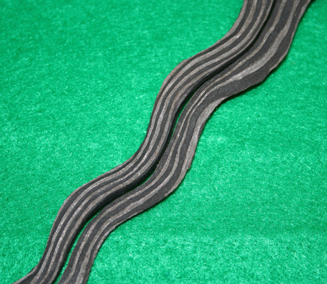

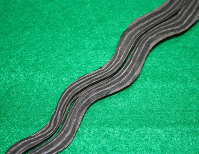

Default Better photos

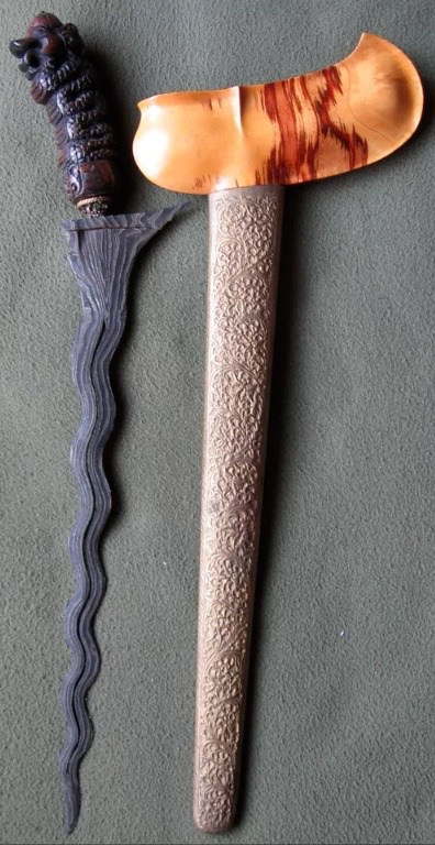

Thanks David. Here are what I hope are better pictures. I agree about the split blade being intentional. It makes the piece even more interesting. I like it, whatever it's intended use. Here is the info the seller provided:
"Indonesian Keris from Yogyakarta region (Java). Carved wooden hilt represents mythical serpent Nanga Sasra. The Wilah (blade) is wavy (13 dapor lok) with elaborated forging pattern (pamor) and a slot representing the mythical serpent Nanga Sara."
harrywagner is offline
Old 14th November 2015, 01:30 AM   #4
Posts: 7,228

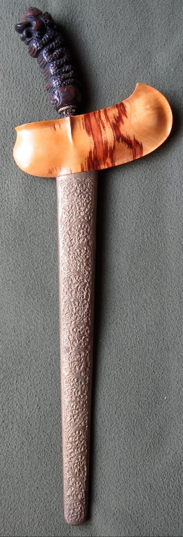

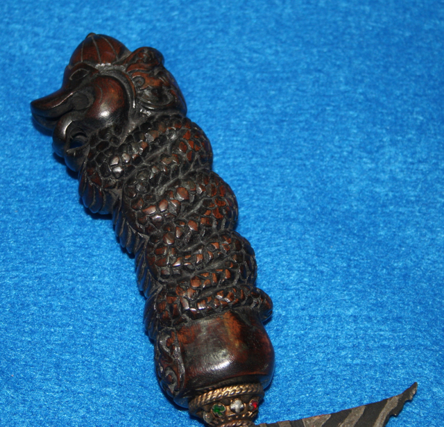

The description of this keris given by the seller is not quite accurate.
The blade is 13 luk, pamor is adeg in the body of the blade, and probably what we can call a "flame" pamor in the base ( I can give a Javanese name for this, but I will need to spend more time on analysis of this little patch of pamor in the sorsoran). It is probably a 20th century blade, but I cannot be certain of this from photos, no matter how good.
The wrongko (warangka, scabbard) is Solo (Surakarta) gayaman, which is the informal, everyday style, the wood can probably be classified as kayu pelet, it might be timoho, but I cannot tell from a photo. The pendok (metal scabbard cover) is bunton style, the photos are not good enough for me to identify the embossed motif, but it is most likely lung-lungan ( twining vines and foliage).

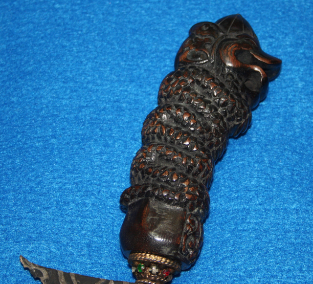

The jejeran (ukiran, hilt) is a Madurese style, depicting a serpent, it would be legitimate to describe this as a jejeran with naga motif. The mendak (hilt ring between hilt and blade) is a Central Javanese kendit set with pastes.
The only thing wrong with this keris is the hilt, it is totally out of place, it should be taken off the keris and displayed separately as a miniature sculpture. This existing hilt should be replaced with a Solo planar style of hilt, preferably a yudowinatan model.
Do this and you will have an absolutely correct Solo gayaman keris that could be used for wear on most occasions. It is a recent keris, but most definitely not "tourist", or "wall hanger". It is the real deal, but get rid of that hilt, it does not belong.

According to the EK and the Pamoratlas this pamor pattern with a triangular motif at the base and pamor Adeg above it is called Junjung Darajat and said to originate from Madura or East Java. Personally I am not convinced that the void in the middle of the blade is intentional.

Default Replaced hilt
Thanks A.G. and Jean. The seller bought the hilt separately, and it is a replacement. The original hilt, not pictured, is rather plain and also wood. It looks similar to the hilt I have seen on many Keris. I will post a photo as soon as time allows. Thanks again.
Sometimes "plain" is better Harry simply because it is more correct. These fancier naga hilts are not only recent carvings, they are newly imagined forms that are a bit untraditional. Doesn't mean they are unattractive necessarily or should not be collected as the tiny sculptures that they are. But Alan is quite correct that this hilt doesn't belong on this keris. Something like this would be far more suitable for this keris.
Thanks David. The original hilt looks almost exactly like the one in your photo.

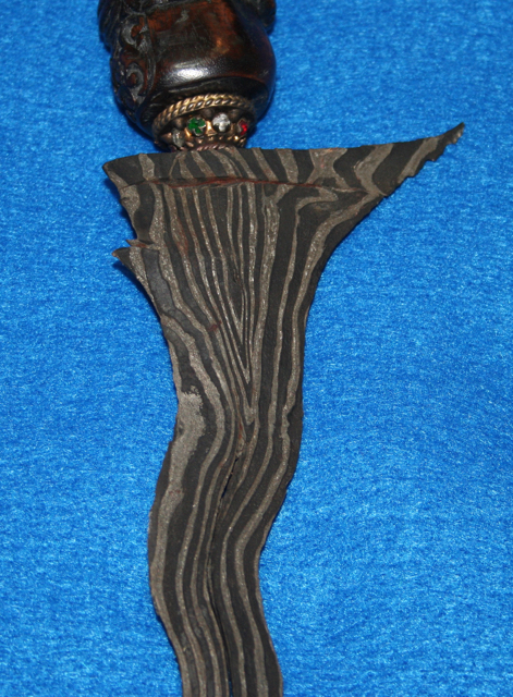

The blade is Madura or East Jawa, most likely Madura, but even so, the pamor in the sorsoran has several possibilities, and at the moment I cannot see it clearly enough to be too positive about what I'm looking at, I'm not at home right now and I'm using a very small, very cheap notebook.
The blade crack probably started as a cold shut --- a welding flaw --- but would then have been preserved and refined to make it into a magically charged complong that will capture beautiful women and late model Maseratis for you, simply by looking through the crack at them and wishing.
A. G. Maisey is offline

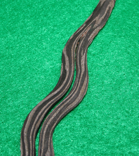

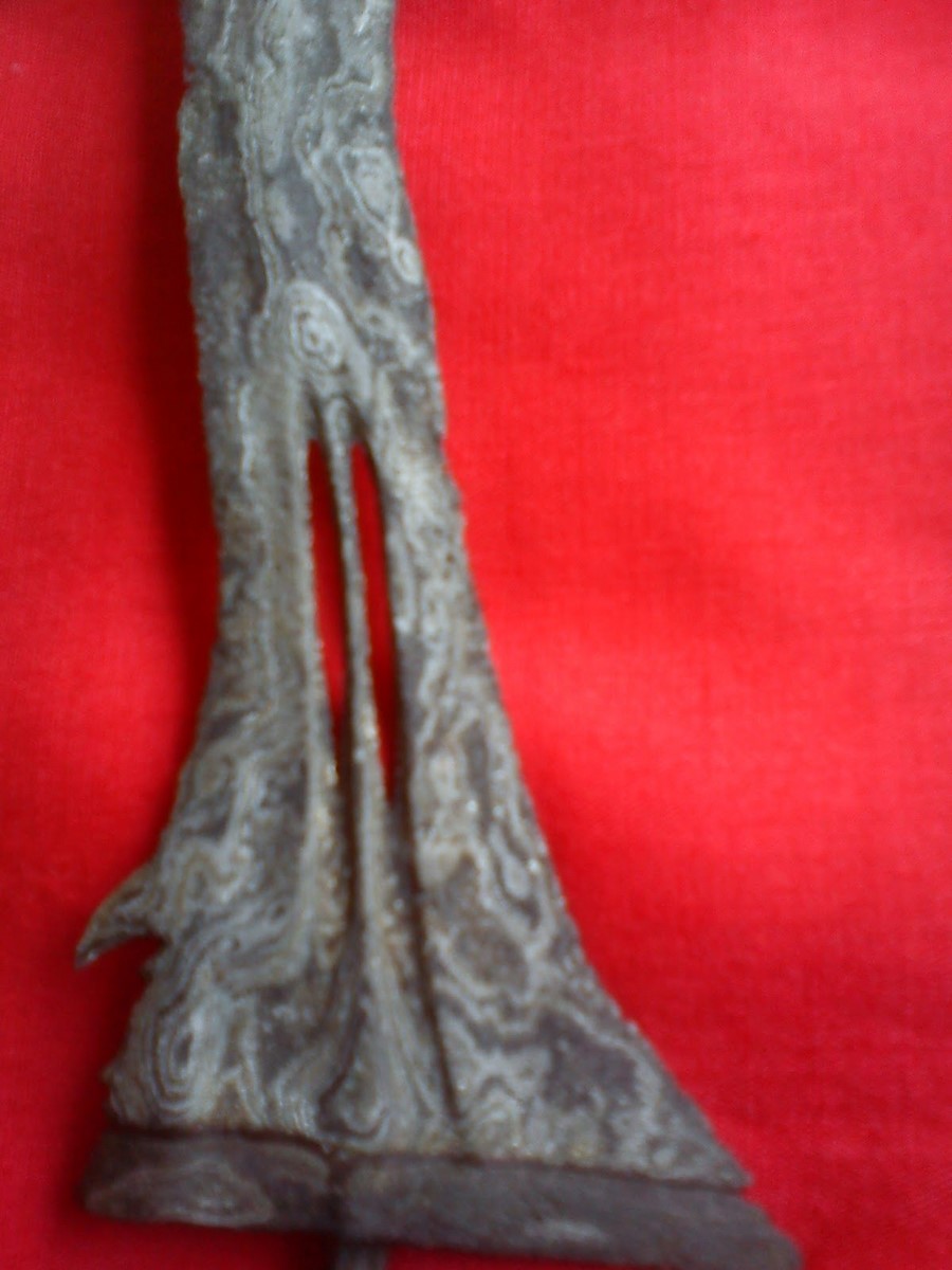

This post concerns the pamor motif found in the sorsoran of Harry's keris.I've now been able to see it clearly, and I've been able to access my records.
Jean has nominated junjung darajat.
I have never seen junjung darajat, but my understanding is that it combines a small patch of ujung gunung, which is a miring pamor, with one of the mlumah pamors, my notes do not mention combination with another pamor miring.
Personally, I am inclined to regard this keris as having dwi warna pamor, that is two pamors in the one blade.
One of those pamors is adeg, this is clear, but the other pamor?
I feel that we have 4 or 5 possibles:- Putri Kenurung, Bawang Sebungkul, Sombro, Pengasih, and maybe the outside possibility of Slamet.
From these I'd be inclined to put my money on Pamor Sombro. When Sombro is combined with a second pamor the two pamors together can sometimes be given another name, but there is only mention of it being combined with mlumah pamors, not with miring, thus I feel we must regard this blade as dwi warna:- adeg sapu + sombro.

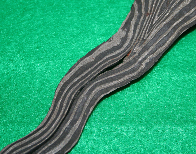

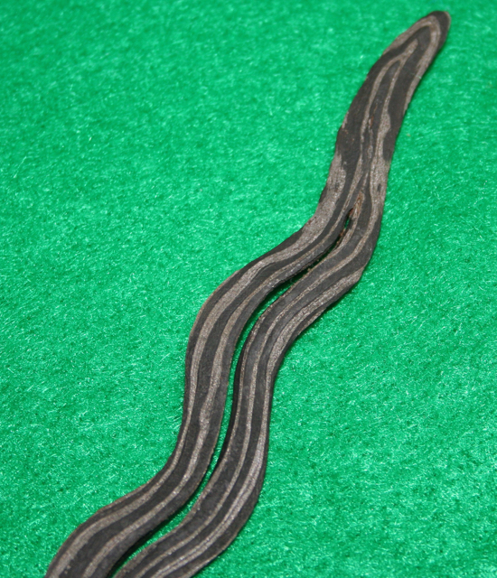

Hi Jean,

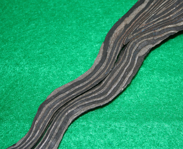

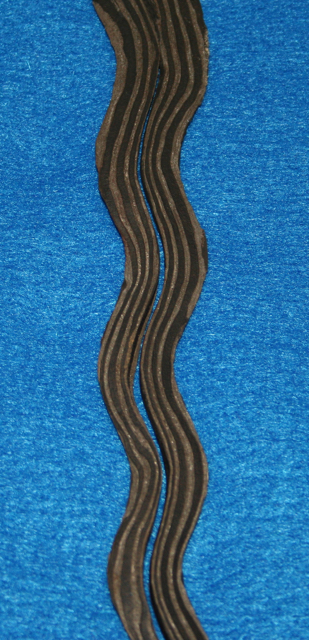

Here are some close-ups of the blade. The seller thought the split was intentional. I think it adds interest to the knife, so if it was an accident, it was a fortunate one!
Harry

Hello Harry,
Thanks for the pics, I maintain my opinion that the split is accidental but if you like it, that's OK!
I attach the pic of a typical blade with combong, as you can see the void in the blade is due to the wear of the grooves in the sogokan.
Jean is offline

Posts: 7,228
I agree with you Jean:- is is accidental, but it did not look like it does now directly after the weld failed. It started as a cold shut, an accident, but it was preserved and improved into a magical blade feature.
The thinking is:- this was given to us by God, who are we to refuse it? no, I won't try to get the weld to take, I will accept God's gift and enhance it.
