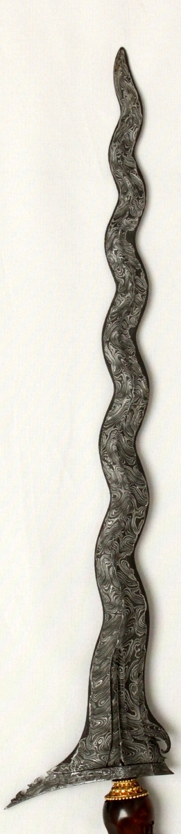

In a recent thread the owner had a doubt how many luk his keris had. Alan then mentioned the "old" and the "current" versions of counting luk ( the current one adds 2 to the old one).
I always thought that the correct ( being the novice in the field, the only one I know) way of counting luk is:
-Count first concavity on the janggut side
- Start zig-zagging from side to side and count each concavity
- Occasionally, the last one , i.e. at the very tip, might be of uncertain origin, in which case one might mistakenly count even number of luk.
Am I correct?
Thanks in advance for the lesson.

Yes Ariel, you are absolutely correct.
However the way in which we count luk is in my opinion a learnt convention, one that can be attributed to the collapse of Hindu - Javanese society, and the rise of Islam in Jawa.
You can read my thoughts on this here:-
http://www.kerisattosanaji.com/INTERPRETATIONPAGE5.html
this link will take you directly to my thoughts on luk, however, reading the previous pages will assist in your understanding of where I'm coming from.
I would venture to say that at the present time I am probably the only person in the world who holds this opinion in respect of the luk count.

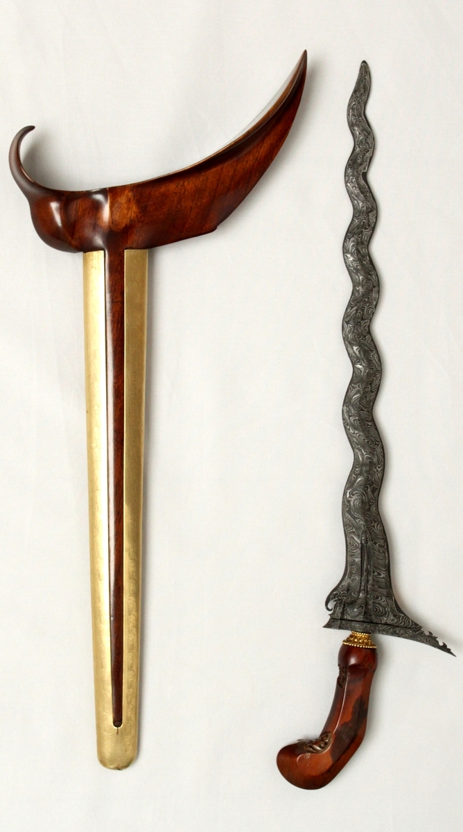

Vanna Ghirighelli mentions in her book that she has two 12-luk and one 10-luk kerises. She further states that the number 12 is the indonesian ideal of harmony.
True?

Ariel, i have certainly heard the idea of 12 being a significant number in Javanese Mysticism and that one can find the occasional rare 12 luk keris, but i can't say that i ever saw one that couldn't be interpreted as either actually 13 or perhaps a 13 luk keris that has been worn down sufficiently over time and now only appears to be 12. This is not to say that a 12 luk keris does not exist, but when you ask if this is "true" i think you enter into a fluid territory. If you read Alan's treatise on the subject you will note his hypothesis that the number of luk are based upon certain Hindu principles that were part of the Javanese culture at the time of the origin of the keris. At some point since the advent of Islam Java this system/method of counting underwent a change. So, do we count Ms. Ghirighelli's 12 luk keris as 12 or 10? Does it matter if the keris being counted originated in a Hundu or Islamic Jawa? Is it more likely that a keris breaks from the long tradition embraced in both the Hindu and Islamic influenced Javanese cultures of odd numbered luk or that the blade simply worn down over time to appear as an even number? I think what is "true" in this case might depend upon what belief system you choose to embrace.
Old 25th October 2013, 03:21 AM   #5
Posts: 7,209
Ariel, I have often heard of keris with an even number of luk, but whenever I've actually seen these even luk keris they have invariably appeared to me to be as David has suggested:- older keris that have been altered, perhaps because of damage.
In no keris tradition of which I know, is the existence of a keris with an even number of luk a valid occurrence.
I have yet to hear any acknowledged ahli keris in Jawa accept the existence of an even numbered keris, however, I have quite frequently heard of keris with an even number of luk from salesmen and those who dwell on the fringe of the World of the Keris.
My personal opinion is that the keris with an even number of luk was never created as an original and valid production. However, as with many things associated with the keris, all are entitled to their own opinions.

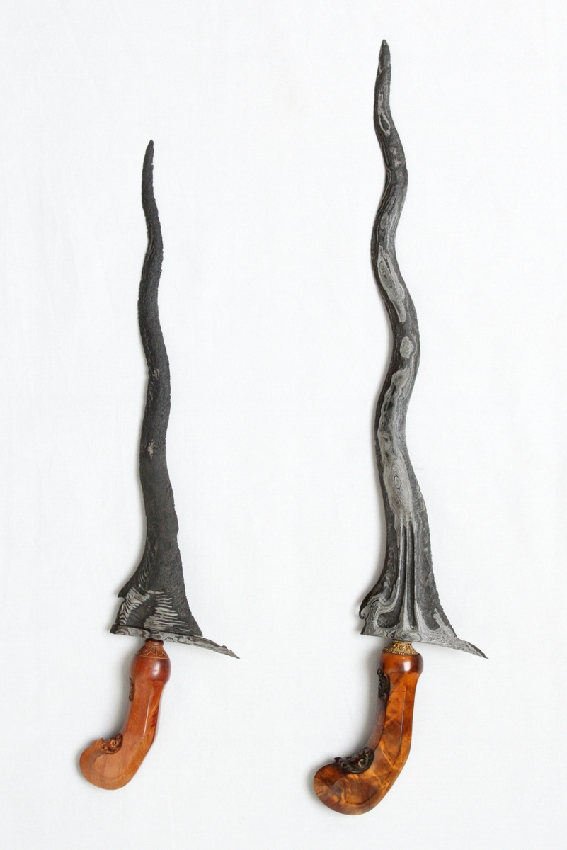

IMO (which may be argued) these two blades can be interpreted as having an even number of luks (respectively 6 and 12 luks) according to the modern counting method. However they have an odd number of luks (respectively 5 and 11 luks) according to the Hindu method. This is the case everytime the last luk points to the back of the blade (wadidang) and not to the front (ganja). The first blade shown has been worn-out with age but the second one is a recently made piece.

I count by the old blade 7 luk and by the recent one 13 luk.

If you start counting the luks from the first concave one above the gandik I wonder how you can find 7 luks on the first blade? However for the other one I admit that the 13th luk can be interpreted although it is not clearly visible.
I agree Jean. By the "contemporary" method of counting i would interpret the new keris as 13. It is true that it does not make a full swing to the front of the blade at the top, but it also doesn't point back. So given that even numbered keris are generally not acknowledged by ahli keris i would lean towards the odd alternative. Your old keris appears presently as 6, but could have easily have lost a luk through either time or intention.
Hello Jean,
have learned that I have to start from the first concave above the gandik and have to end at the same side and this with an uneven figure. See picture. It seems to be an old and worn blade and I think the last luk is too worn that you still can see it.

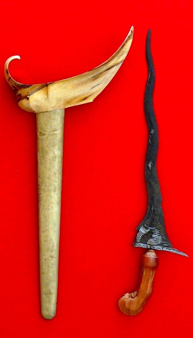

Originally Posted by David
I agree Jean. Your old keris appears presently as 6, but could have easily have lost a luk through either time or intention.
Hello David,
I agree that the old blade most probably had 7 luk initially and was shortened due to wear.

Jean, to my eyes both the keris posted by you as examples of possibly even luk keris are not in even the slightest degree able to be interpreted as other than a 7 luk keris and 13 luk keris when using the current convention of count.
The form of the point on the 13 luk is very usual for this style of blade and the 7 luk blade is simply not able to be counted as anything other than 7.
I do have a Pengging blade that could be counted as an even luk blade, because the final luk takes the point back towards the back of the blade, and the blade is not eroded to the degree where we could plead that this has been caused by the passage of time. However, the current convention of count (CCC) demands that the count finish on the same side that it started, ie, the gandhik side or front of the blade, so even where you cannot see any clear turn back to the front of the blade you are compelled to add the additional non-existent wave.
In the most simple of terms:- if we follow the CCC it is impossible to produce a luk count that gives us an even number. Just can't be done.
Incidentally, how long is the 7 luk keris?
Hello Alan,
Thank you for your reply.
I acknowledge that according to the CCC the small blade should be interpreted and counted as 7 luks and although I do respect conventions and religions I am sorry that I can see and count only 6!
The blade is 28.5 cm long, it is a skeleton blade which probably had a normal lenght of about 35 cm originally. I have shown it alongwith another very old blade with 7 luks and a similar ganja of exactly the same size (7.6 cm long, probably a bit longer originally). In my view the short blade had probably 9 waves originally and not 7, what do tou think?
