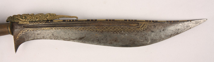

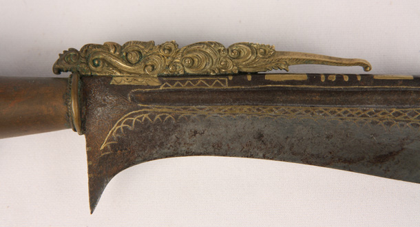

Dear All,
finally it has found his new owner, and I think, it would be interesting to start a discussion about it:
http://www.ebay.com/itm/ANTIQUE-INDO...item19d74a7316
At first sight I thought it would be the real thing, but then... one thing for sure: it would be the first one of this kind I see without the "Banji" (swastika) ornament. And there are some other strange features.
Is this one an attempt to cheat or just a less fine or more recent example of its kind?

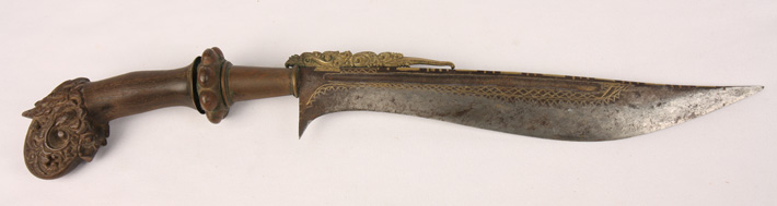

Pics continued:

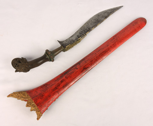

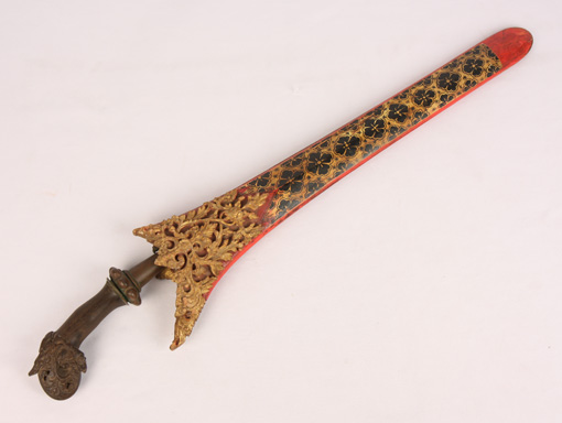

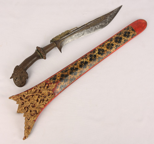

And more:

Hi Gustav,
It's a nice knife, shall we call them 'Wedung'? I know some do and some don't.
Artzi had a similar one on his website some time ago:
http://www.oriental-arms.com/photos.php?id=1812

I have two 'cousins'.
Sadly neither comes with the oversized ceremonial scabbard, the "party dress".
One of mine is 'naked' and the other only has it's 'everday' scabbard.
Both of mine have the 'swastika' geometry.

Hello Gustav,
have found this thread: http://www.vikingsword.com/vb/showth...ght=bali+knife
The one from Artzi was discussed here: http://www.vikingsword.com/vb/showth...ght=bali+knife
The one you have posted look original to my eyes and like the both threads show they don't need to have the swastika ornament. But honestly I have state that I don't know to much about them.
Attached a picture from the first thread.

Hi Detlef,
That's interesting.
The example you found has not got the 'monster' on the spine.

Detlef, I think, you are wright. The knife in van Zonnevelds book don't have ornaments on blade, Schmeltz also describes a plain blade with grooves on both sides. So perhaps we can see some logic here, regarding this and picture in #4:
No "monster" head = no further ornaments on the blade.

I have noticed that the old ones usually don't have the swastika pattern, so maybe it's the other way around?
Here are two blurry cell phone pictures I shot when visiting the Klungkung palace museum. There seems to be a difference between the ceremonial axe and this "household knife", both in use and name.
PS I have one and used to have an additional that I traded. One is plain and the other have an ornamented blade. Both of them have this kind of scabbard, old style makara hilt, the "monster" protrusion and inlay on the back of the blade.
I suspect that the makara hilt, more than if there is inlay on the blade, is an age indicator.
