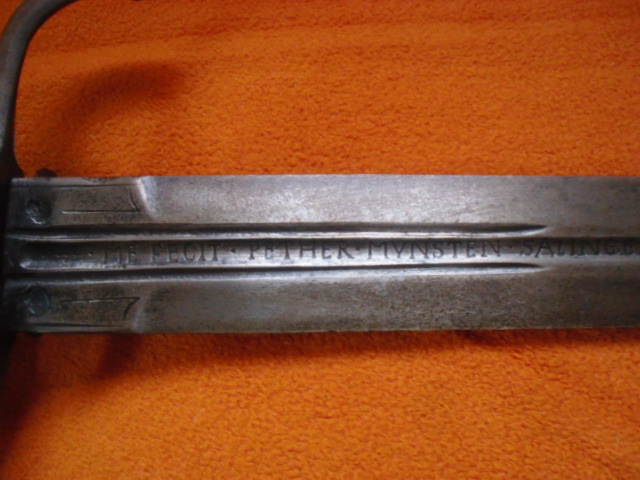

Dear All,
I am very interested in you opinion about this sword. The blade is engraved with "VDACES TORTUNA IVAT 1602" and "ME FECIT PETHER MUNSTEN" as well as two markers (maure heads). The overall length is 90cm, Blade is 73cm and 5cm wide
Do you think this is a genuine and matching piece or a composite or later replic?
Looking forward to your thoughts!
Best
Andreas

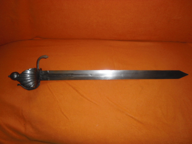

By the way Andreas, don't you think the point of that blade looks odd ? .

Better pictures would help but I think the blade looks newer to me. I could be wrong though. My experience is fairly limited.
Maybe we can get a detailed pic of the end of the blade?

Thanks for the replies so far. Indeed, for me also the point of the blade looks a bit strange. I requested better pictures.

While I am hoping that Ulfberht and Jasper might comment on this as their exposure to these weapons is far greater than mine, I wanted to add what I can.
The blade is indeed somewhat disturbing as far as the curiously and dramatically reprofiled point, as if the blade had been cut down and the point added.

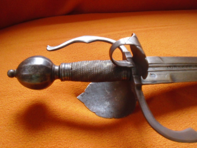

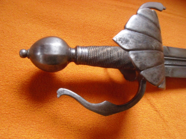

Also I would expect to see Turks heads on the wire wrapped grips rather than ferrules.
In checking the usual compendiums of markings, it seems the Munsten family had interesting complexities.
I would note that the markings Fernando shows in post #3 were puzzling to me (they are in Gyngell, 1959, which I always thought reliable) as the date 1516 is too early for the recorded Munstens. Andreis and his brother Peter were born in 1547 and 1552, respectively. Thus the Gyngell date is far too early and the head mark seems more attributed to Andres than his brother Peter.
While Andres went to Toledo in 1587, Peter remained in Solingen where he died in 1628. His son Peter (the younger) lived 1580-1629.
Though a Peter Munsten is supposed to have gone to Hounslow, the name does not appear in the records of the makers there as far as I found. Also, the Hounslow factory began around 1620-34. But as this sword is presumed to be Solingen made, the point is moot.
As for this 'PETHER MUNSTEN' the only one I found using that spelling of Peter was 'the younger', His mark was the Virgin and child, and his stamped markings included xx IHN x SOLINGEN.
The 'Solingen' in all of the markings I located was always properly spelled without use of the majuscule 'A', though the 'V' in place of 'U' was used in the according words.
I am assuming the 'maures' heads intends to mean 'moors' heads or 'blackamoor', marking symbols which were only used by Andres, but not by the Peter's.
The placement of these stamped marks paired at the ricasso as what seems part of the profiling lines on the ricasso 'shoulders' seem unusual to me also.

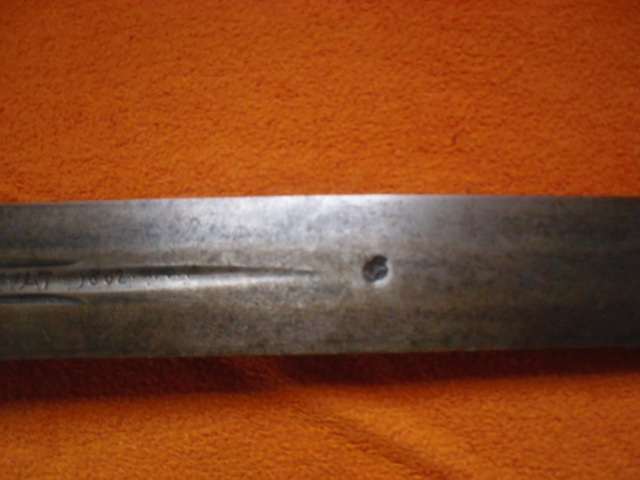

The date '1602' seems incongruent with the rest of the lettering, as if placed as addition, but does correspond to the period for this maker.
While there are compelling aspects of this sword, these are the elements I find uncomfortable, and as noted, I look forward to observations from the others.

The pictures as they are now are not clear enough to be conclusive on the materials used , I will wait for better pics for further comment.

Ulfberht, thank you for your kind comments, and I agree, it is very difficult to determine further on this weapon from the images, and I look forward to more from others.

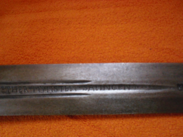

... Which inscription in any case seems to have an odd configuration, with the 'me fecit' before the smith's name, the unusual mispells, like Salingen (?) the date inserted in that niche with a so reduced font and all.
I will see to it that the date in the Gyngell image is deleted, so that will not misguide readers .
It would indeed need better pictures for knowledged members have a go at it.
