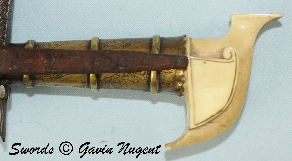

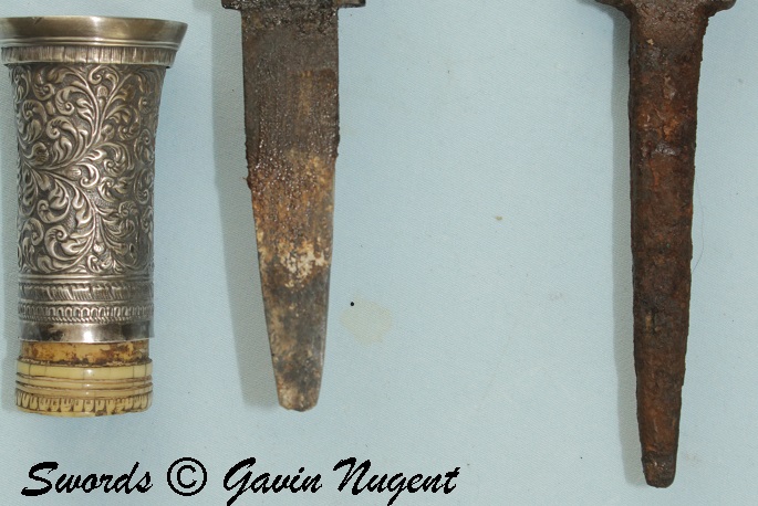

I noted my experience with various tangs and here is an image of a couple of items from my own collections to support my thoughts about resin alone.
Currently on the bench for restorations; The Laos Dah is for crushed silverwork repairs and the Barong for similar and a proper blade polish whilst it is out.
The Laos Dah;
Its an elegant blade and not a heavy weight by any stretch of the imagination. Its tang is 7.4cms long and the types are only resin set. The material the tang sits in governs the real strength of the sword in combat.
The Barong;
Its a large, thick and heavy blade with a much narrower tang. Its tang is 9cms long. Pound for pound the barong is a much heavier blade than a Sundang or Kris and generates a massive amount of force for such a "little" weapon (compared to a sword). The barong are only secured with resin.
Although not a Sundang or Kris tang, I have overlaid the barong tang to help put things in to perspective.
When considering forces that a heavy barong blade can deliver compared to a Sundang or Kris, it is easy to see that the asang-asang are certainly not the key factor in play in keeping a blade and hilt together and not really needed at all for a functional weapon.
