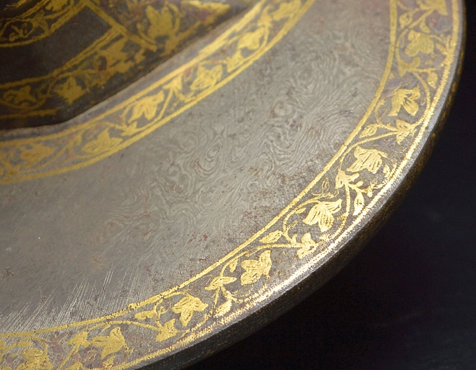

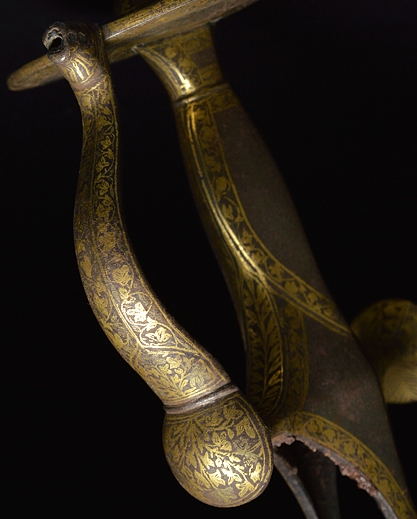

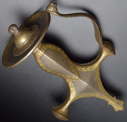

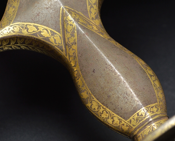

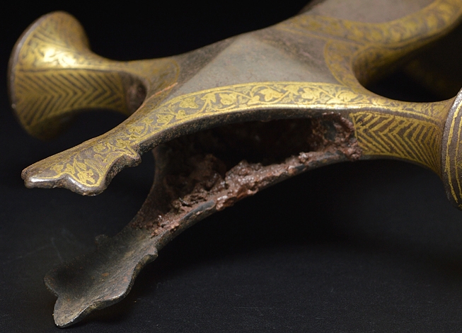

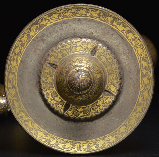

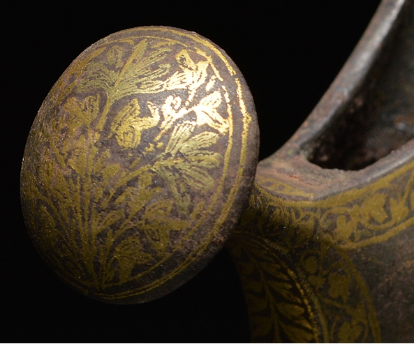

I was asked if this tulwar hilt is authentic, I thought I would post it here to see if there were any opinions as I am not as well versed on tulwar hilts as some other forum members are.

estcrh:
What are you asking to be authenticated? Age, materials, place of manufacture? Can you be more specific please?

Ian, just whether this is a good reproduction or an antique.

The owner is Japanese and does not speak very good English, he acquired this and has no knowledge of them, he asked me if it was modern made or antique, that was all he asked about it.

I vote for recent manufacture. There are some good reproductions coming out of Rajasthan these days and they are obviously working from antique models. It can be hard to tell new from old in online pictures, but the pattern of the steel does not look like wootz to me--more like pattern welded--which makes me think it is a recent reproduction. The gold work is well preserved (usually something is missing here and there), and not of the highest quality.
That's the best I can do from pictures. Really need to have these in hand to get a good idea of age.

I'm pretty sure, that we see a tulwar hilt from early to mid 19th ct. and made from wootz.
The last picture shows clearly wootz for my eyes. https://en.wikipedia.org/wiki/Wootz_steel
The state of corrosion is further sign for wootz.
But I also know, that they are able to make wootz since a few years in India, so it is quite complicated to make safe statements. Ugly wootz and easy to identify but they constantly improving their skills.
Roland

I'm not an expert, but I think this one is authentic, 18-19th c.
I'm the proud owner of two ugly wootz Indian style and at least I know what is bad...

This is definitely genuine antique wootz hilt, 18-19 Century.

We could really use Jens here, as there are few people who know tulwars as he does...but I would say this is indeed an authentic tulwar hilt of 19th century probably earlier and could be latter 18th. It does seem to be of wootz, and the koftgari is something I personally would not consider of the modern Rajasthan wares.

It strikes me as unusual that there is no wear at all on the gold work.
The pattern I see is more Damascene than wootz, which has more granular inclusions, or so it appears to my unskilled eye.
The scratches that appear in the close-up in the last picture are beneath the gold work, and appear fresh and without any sort of corrosion, which seems a bit odd.
I hesitate to draw any conclusions from these observations.
I agree with Alex definitely looks genuine to me.

Thanks everyone for your opinions, if anything this shows how difficult it can be to adequately judge the authenticity of some items due to the high level of reproduction craftsmanship that has been seen lately in some parts of the world.

actually, this one is not difficult at all. It has nothing to do with the level of reproductions... it's all about level of knowledge and experience, always!

There is no doubt in my mind that this is a real thing: 18 century, first half of the 19th at the latest.
Thank Heavens, our Rajastani brothers still do not know how to make anything even remotely comparable to that!
