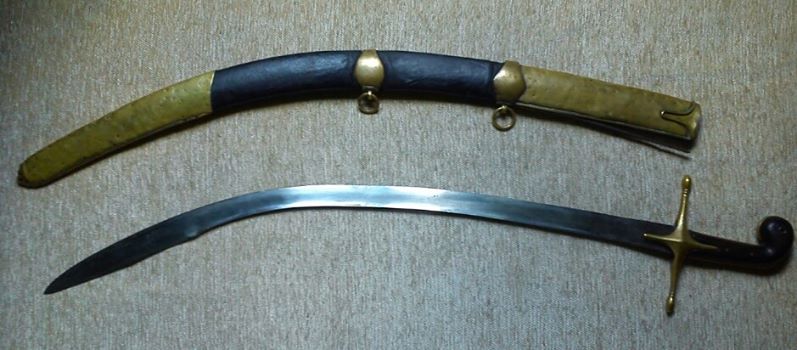

This Pala is made in Bosnia!
Kurt
http://www.vikingsword.com/vb/showth...highlight=Pala

The inscription says that the pala was made for an Ottoman governor, a wali, in Bosnia. But it is not written that the pala was made in Bosnia. Your pala looks like the Ottoman Turkish pala. IMHO

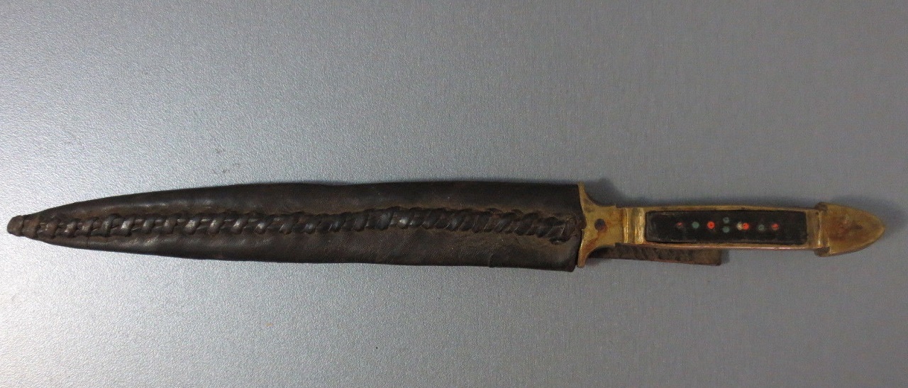

Hello Kubur.
I think the sword pala became known in the balkans in the late 18th century and which was known balkan swords Kilij thin and Slim blade (photo).The pala sword come in the balkans, as blades and that the balkans had this great production yatagans and knives,balkan had large centers decorate these weapons to other markets in empire .I think some differences with turkish swords there but not sure at all the same because the artificial joint text had on the market throughout the north and east empire.The balkans had differences in handle and suspension points, in others we see religious symbols yet the scripture and not in Ottoman blade.
Stelios
I suspect this Pala is made by a local blacksmith.
His name is "Osman ibn al hac Mohammed "
Also, the blade is not wootz, but like the most Balkan Yatagan made from torrisons Damask.Also the inscriptions similar those of Yataganen.
Kurt

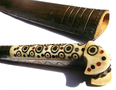

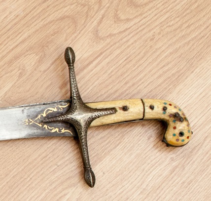

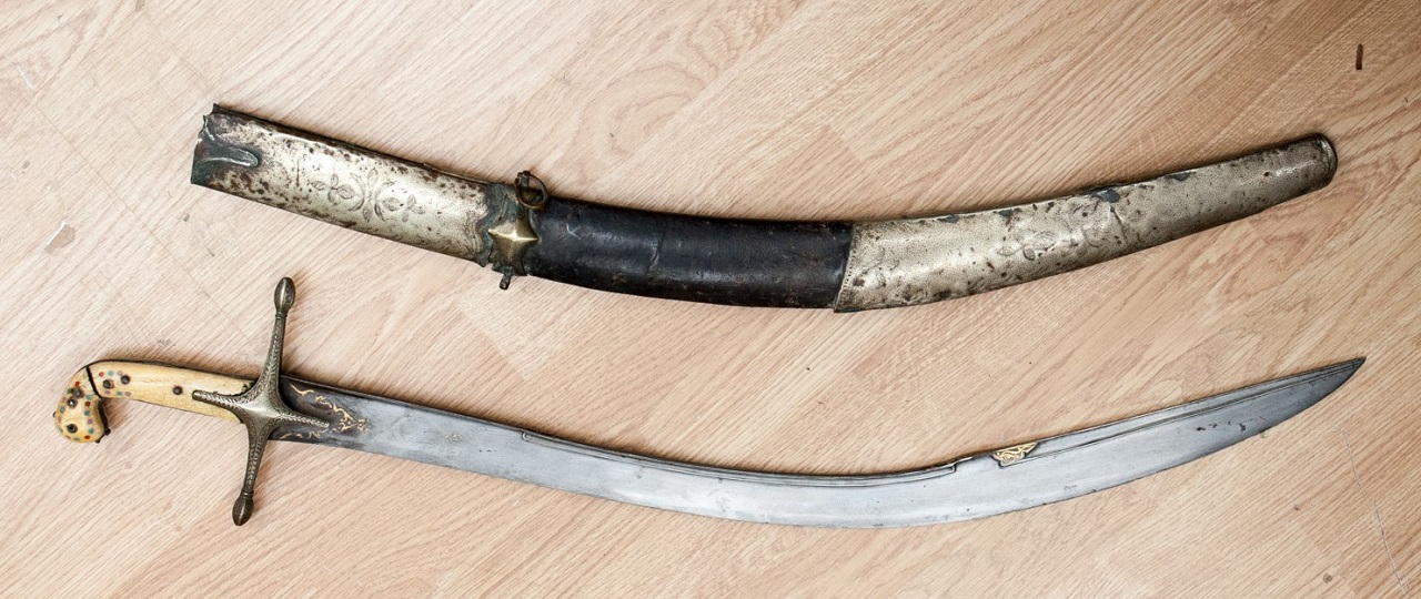

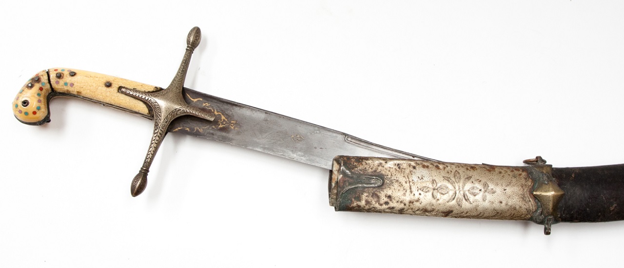

Hi Guys,
Now you will understand my question...as I received my Pala.
I was looking for a pala for a long time.
This is not the best one and far bellow Kurt or Dominique examples.

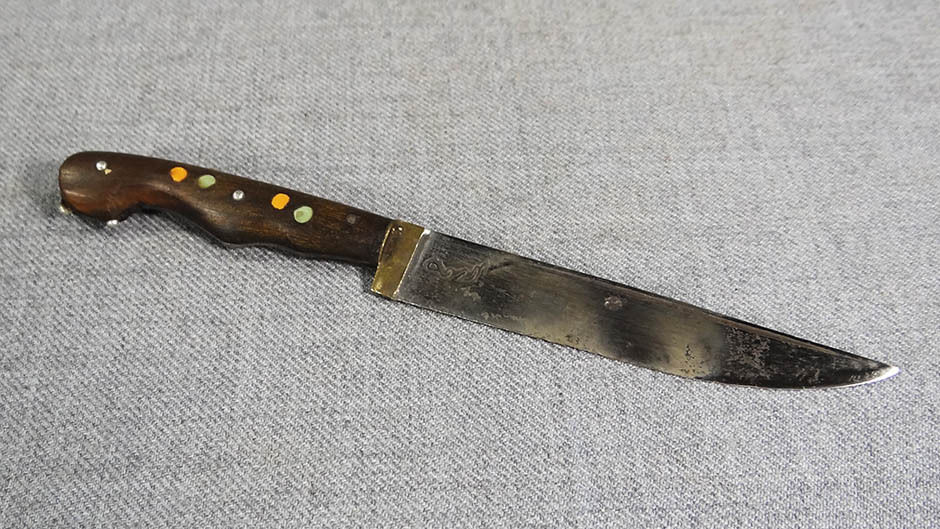

No beautifull and fancy inscriptions on the blade but at least it's an original piece. This one has a very strange grip lile the Ottoman knifes from Bulgaria or Bosnia. I looked for other examples like this, but I couldn't find any...
I will be grateful to any member who can provide me any similar example...
Old 6th September 2015, 01:27 PM   #9
estcrh
estcrh's Avatar
Join Date: Jun 2012
Location: USA
Posts: 1,492
Your pala grip has that Bosnian look to it, first one like it that I have seen. Is the grip walrus ivory or something else?
Old 6th September 2015, 04:22 PM   #10
Look is like walrus ivory IMHO.
Old 6th September 2015, 06:01 PM   #11
Hi

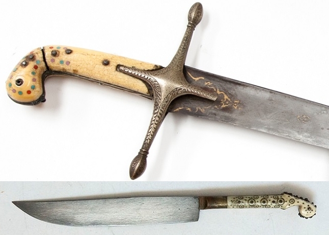

Yes it's walrus ivory and absolutely the look is very Bosnian, despite the fact that I have seen some Bulgarian knifes with the same design. It's more likely Bosnian because if the small "nails" on the joint of the grip...
Old 7th September 2015, 06:37 PM   #12
estcrh
estcrh's Avatar
Join Date: Jun 2012
Location: USA
Posts: 1,492
Originally Posted by Kubur
Hi
Kuber, from the looks of it you have a Balkan pala, I can not remember seeing another one like it. It makes sense that the grip would be the distinguishing part.
Old 7th September 2015, 06:55 PM   #13
stelio
stelio's Avatar
Join Date: Jul 2011
Posts: 97
I have never again seen in Pala such a handle. Although the Balkans knives were with this decoration in the late 19th century. The colors in the decoration are close to what they have knives from Bulgaria in my opinion .
Stelios
stelio is offline   Reply With Quote
Old 7th September 2015, 09:08 PM   #14
Hi Both,
I'm like you very confused.
For sure Balkans, in between Bosnia and Bulgaria.
Maybe Macedonia? It's in the middle...
Another funny stuff is the big crack on on the both side of the grips.
The grips are fixed with the same little nails that you can see on the joint.
To my opinion, the grip was broken before the craftman fixed it and he had to put more nails to maintain the different parts.
It reinforces the idea that the grip was done by a knife specialist more than a guy used to do grips for swords...
Is it make sense for you?
