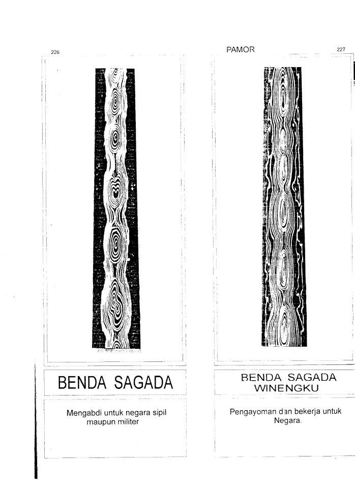

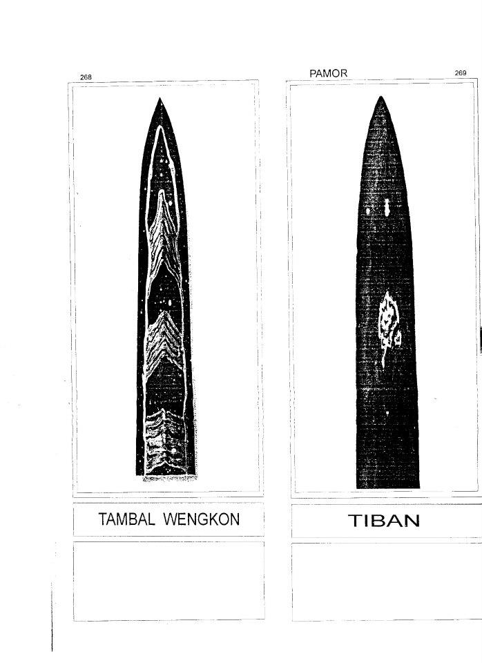

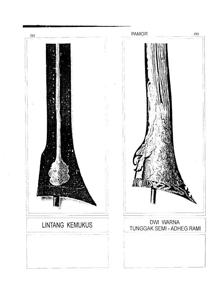

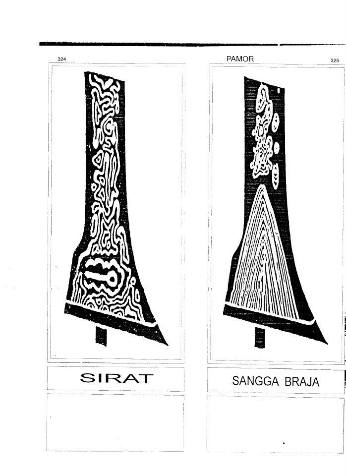

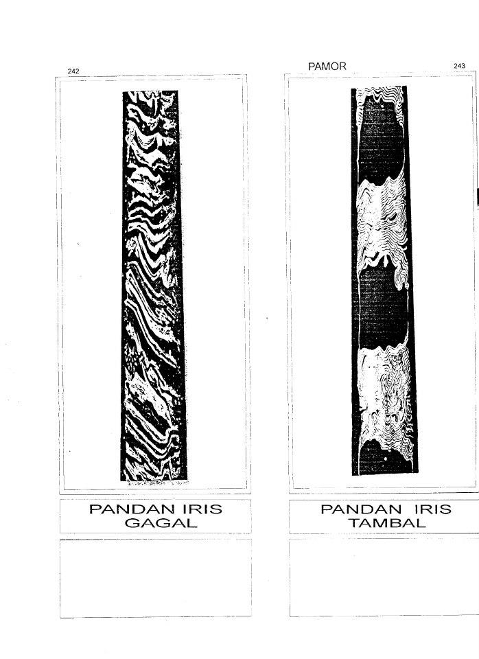

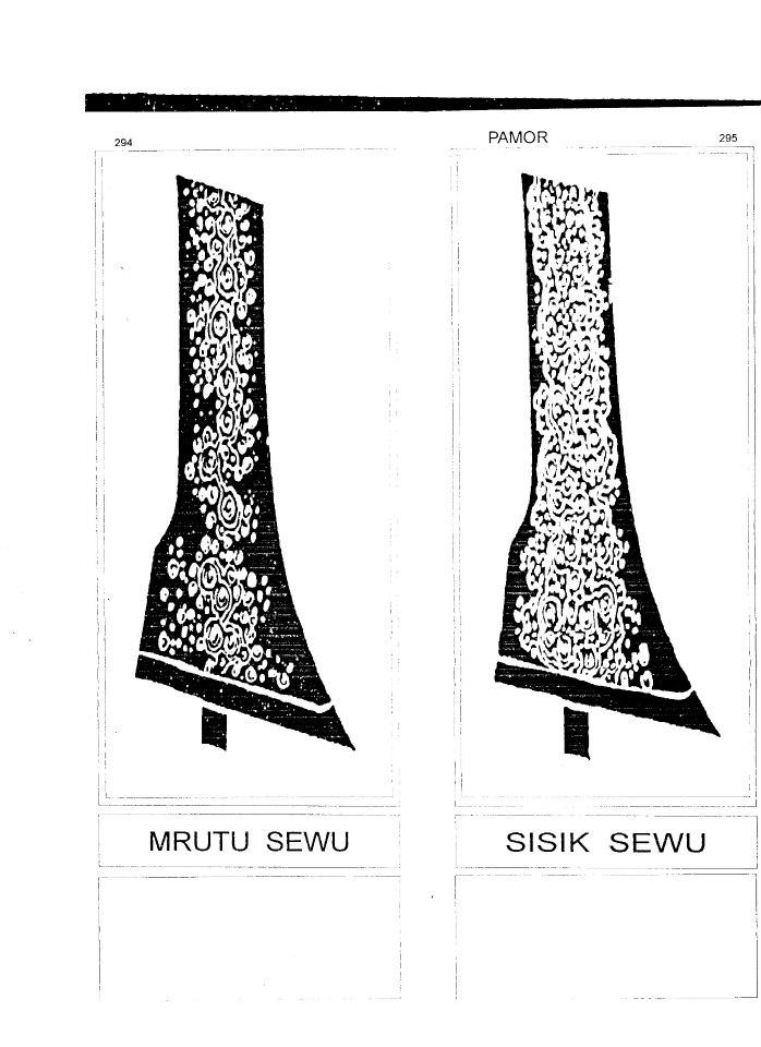

As I am a very new and uneducated keris collector, I would appreciate if any forrumers /experts /collectors can show their keris with good pamors . This will helpfully aid me in understanding pamor better and choosing better specimen to buy to upgrade my sorry collection.

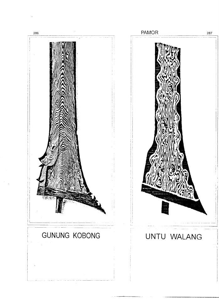

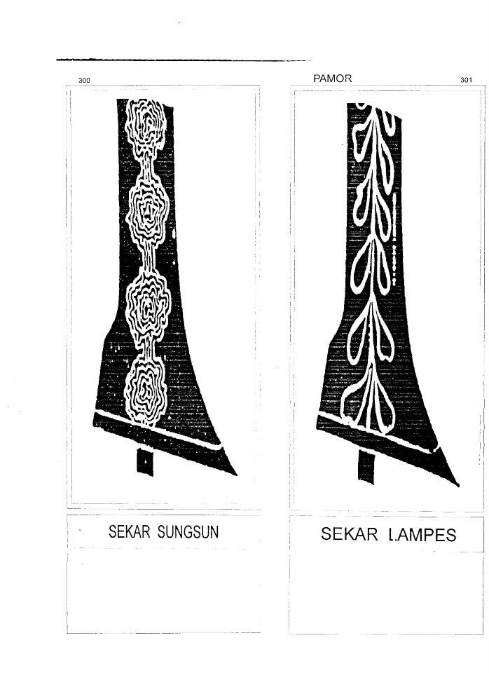

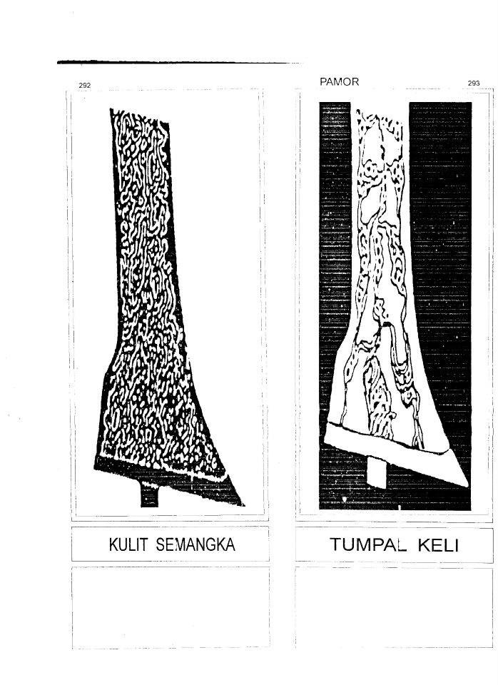

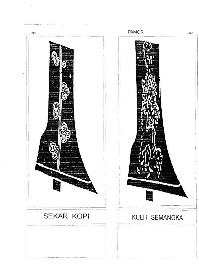

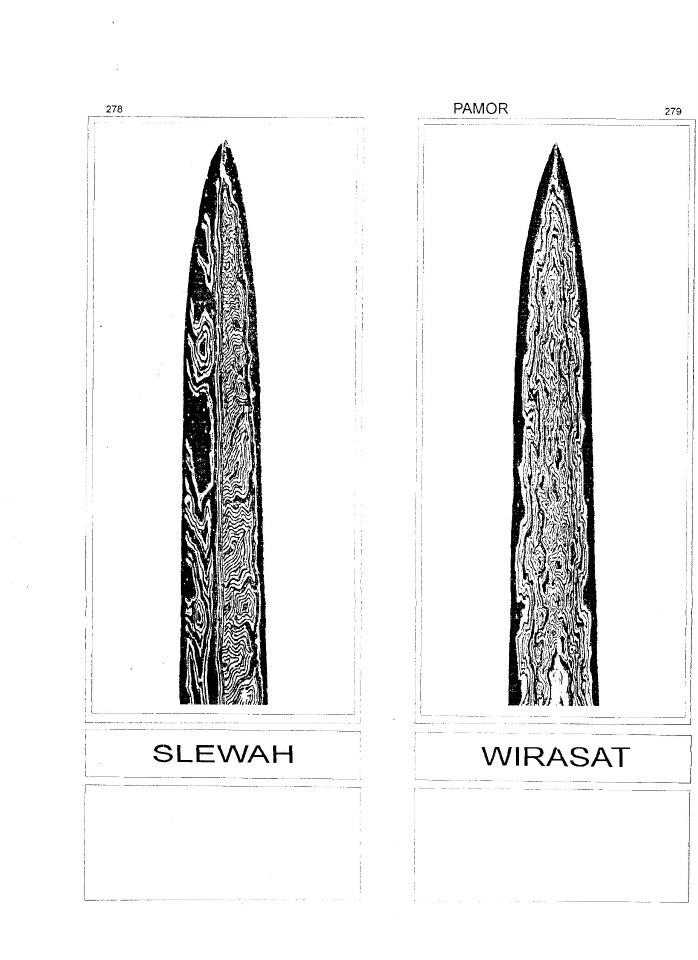

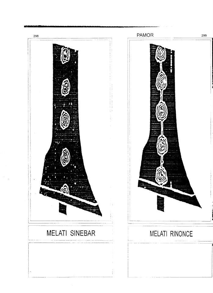

Pamor types are many, very complex and confusing to identify .Attached are some pics of pamor types/identification taken from an indonesian keris blog but I'd really like to see photos of real keris with good pamors from any of you. thanks.
